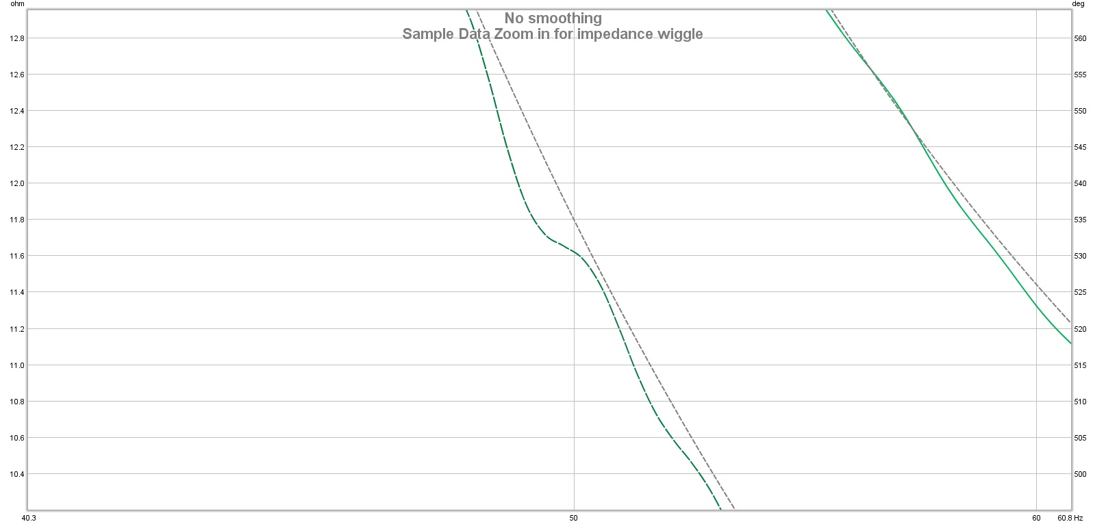

So a little fooling around with a sample data set from REW
REW will let you zoom in to the division of 0.1 ohms. And then allow a further expansion of the data in terms of the physical distance between the vertical lines.
Pretty nice really.
You should be able to see the small impedance peak in your planars. And possibly any impedance variations present in measurement.

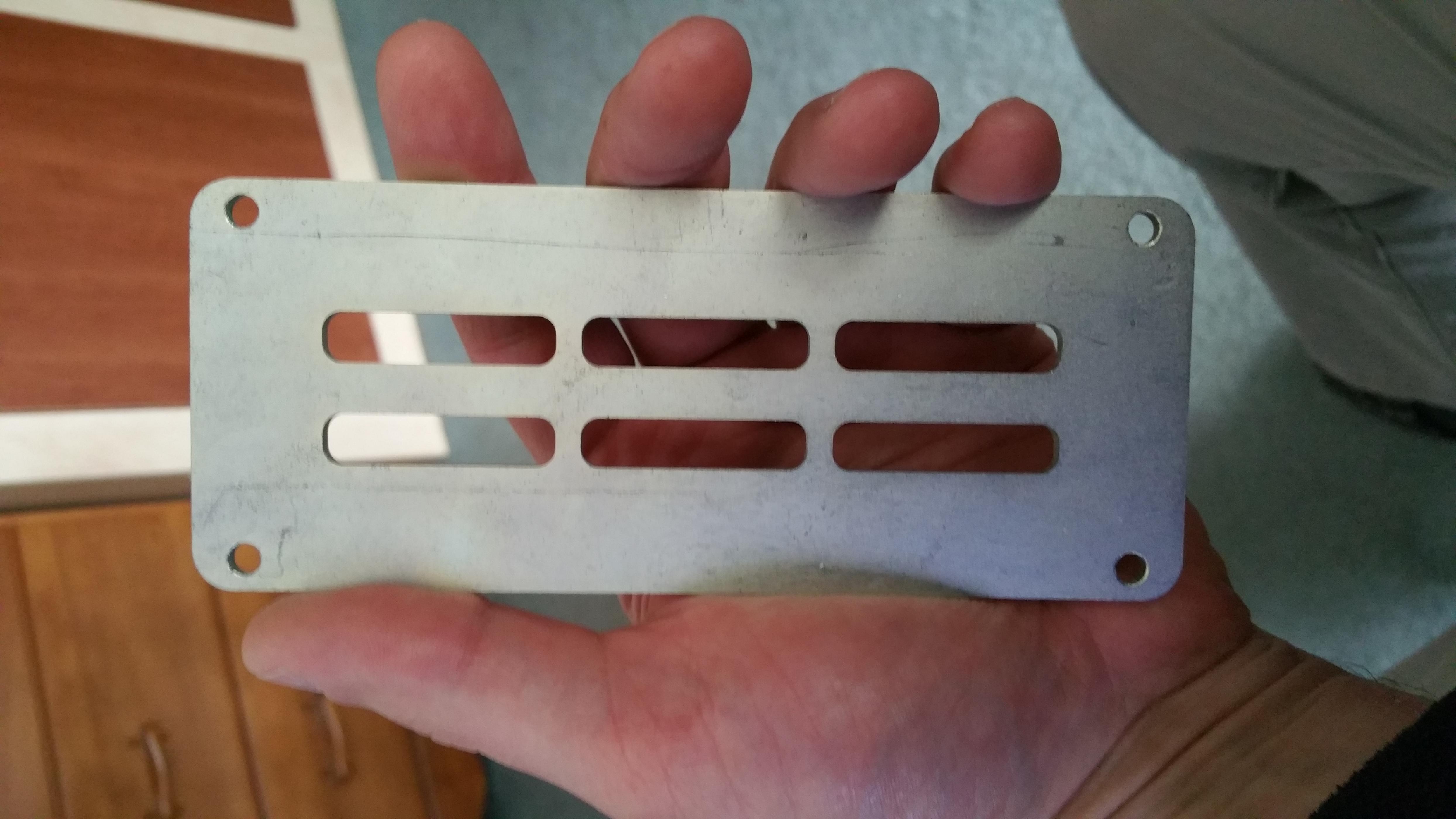

Well the motor return plate in my hand was laser cut out of 1008 steel.
Not that hard to do even with a scroll saw and steel blades.
If you tape two together at the same time you can do a front and back at the same time for push pull operation.
This size is a bit small for a wide band. I have listened to it. It works decently to about 120 hertz. Like the Monsoon system it is best with a small subwoofer.

Planars are difficult. But with phase frequency and impedance really zoomed in you can find correlations in what is going on.
You end up looking first at the frequency response. When there is a ripple or more to the point a dip you will usually be able to find a mechanical reason. That should show up as an impedance variation or at the very least a phase variation.
Doing this kind of sleuthing gets you information into the possible reflections and mechanical tension problems. Depending on drive level you may even find some problems in the distance between the motor and the diaphragm.

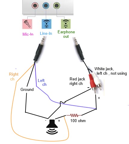

The interface between the soundcard is indeed through the headphone output.
If I remember correctly you are advised to use a decently high value resistor.
I'll send you some information. It's a little complicated to send it via the forum.
One way that works.
The resistor is 100 ohms as this is a realistic load for a conventionally designed headphone amplifier.
The principal of operation is a voltage divider. So a little higher value resistor will work as well.
A metal film resistor is best. If you have something more exotic great. But the principal in choosing a resistor is to keep it noninductive. So a wire wound would be a poor choice.

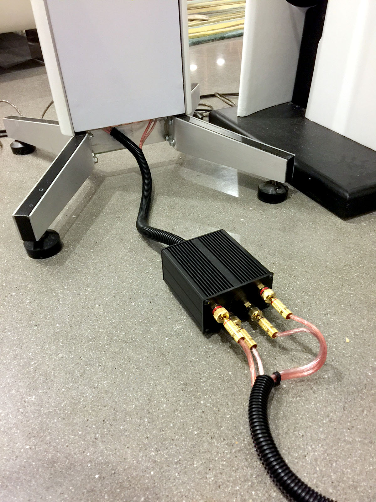

I finally finished cleaning up the wiring to the speakers. I didn't have a convenient baffle to mount connectors onto so I bought some Penn aluminum boxes from Parts Express. I could have done something a little simpler but back when I purchased them I wanted to keep open the possibility that I'd incorporate some passive crossover components. The boxes would let me do that without creating a mess. I need to tweak the cable lengths to neaten up the final product but I want to finish a cabinet that will hold my amplifiers and other electronics first in case that necessitates more cable adjustments.
