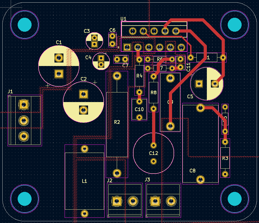

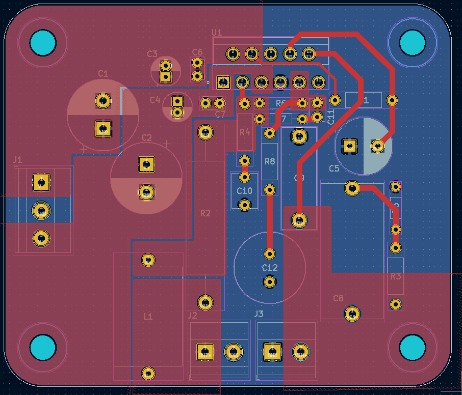

I think I have to do the whole layout again, considering dimensions again and copy what neurochrome did with the layout. It got a little more expensive then what I wanted...
Updated the pcb layout, changed a couple of footprints and rearranged everything.
Made copper zones where I could:

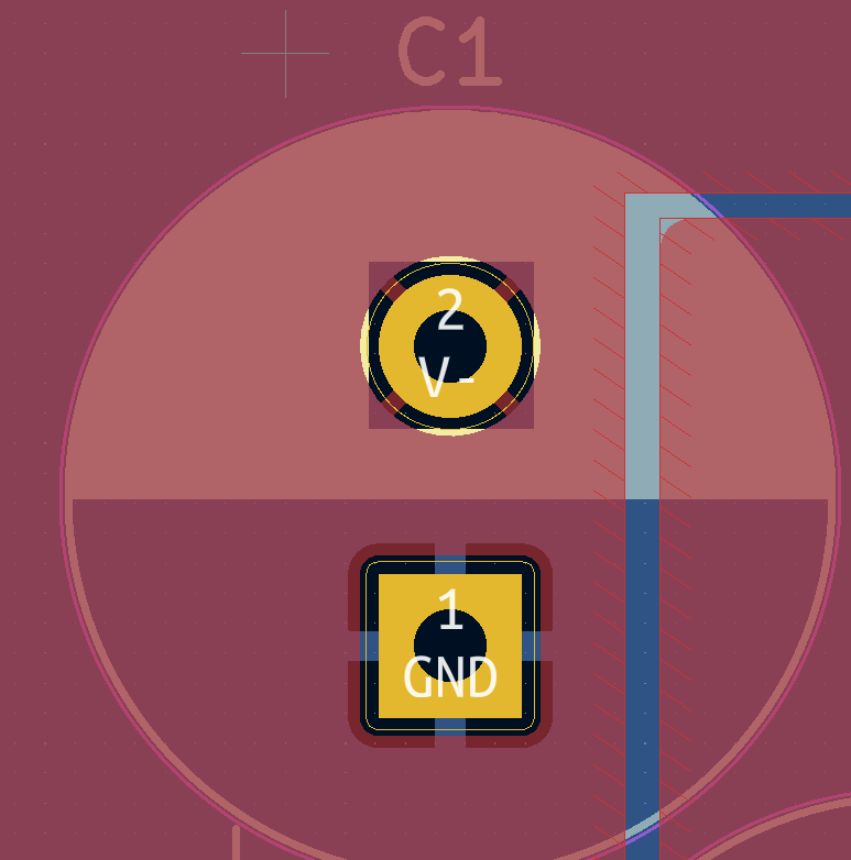

They are not shorted, kicad places a thermal relief (i believe its called) around the pin that is not connected to the relevant plane.C1 , C2 , C3 , C4 , C6, C7. both pins are connected togheter ?. seems like they are in short.
The V- pin is "crossed" with a X to the relevant pin of the cap, the GND pin is "crossed" with a + sign to the relevant pin of the cap. The software is also not warning about any shorts.
But thank you for pointing it out anyways, i ordered the PCB's, they should arrive on the first week of february 🤩
Sorry , I did not know that, I don't use kicad. For what I do EasyEDA does just fine. better alternatives would be Altium but you have to buy it or " become a pirate " .They are not shorted, kicad places a thermal relief (i believe its called) around the pin that is not connected to the relevant plane.

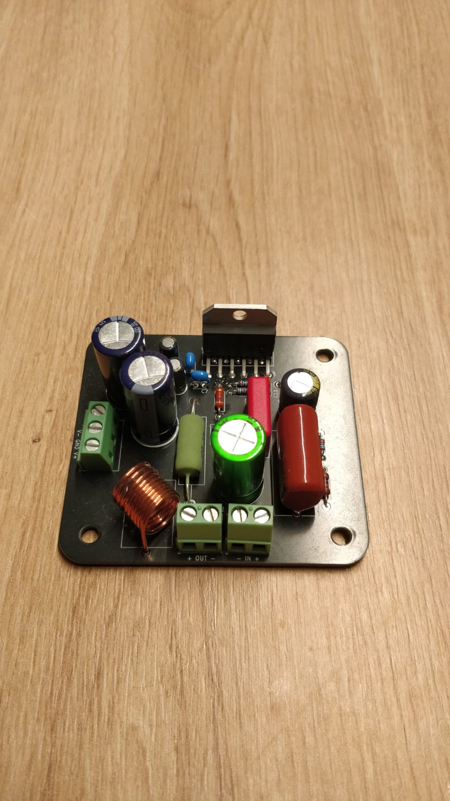

Hello again,
I am GENUINELY sorry if I was not active for a very long time, I had to solve some other little problems...
little update on my situation, I assembled the board and here it is:
i was not able to test it until now, the reason for that, is that i firstly ordered the wrong stuff from amazon, then i sent it back and reordered it.
This week the rectifier board should arrive and the order is complete, so i can give it a test.

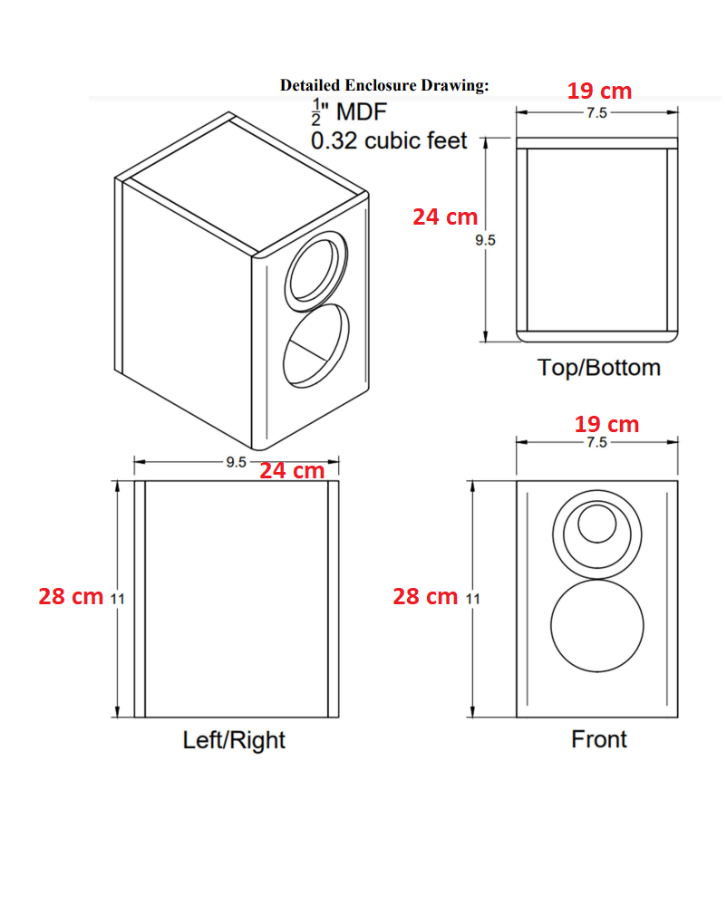

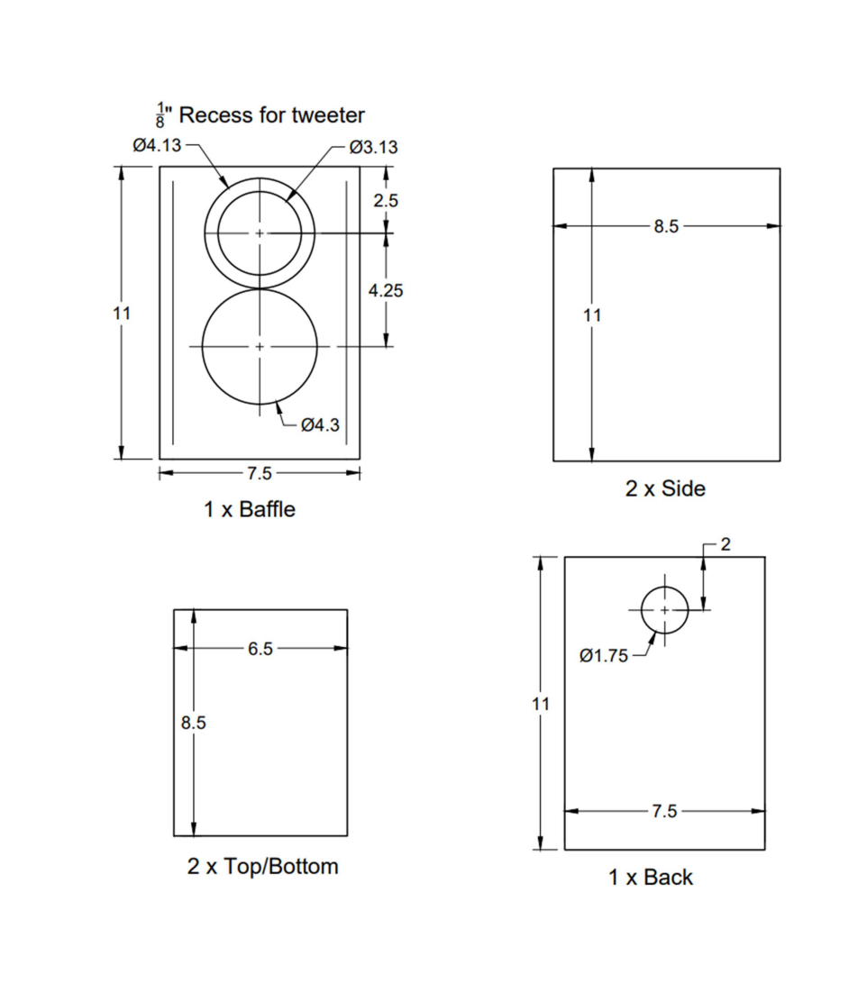

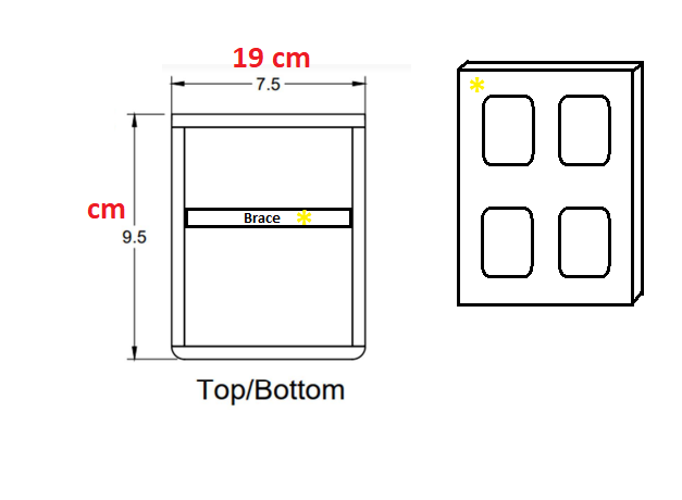

In the mean time I was looking for the measurement of the single cabinet, but I only find the build plans for the speaker in inches, and recalculating them in metric values gives some strange numbers...

@fancy_user_123 Board looks nice !.

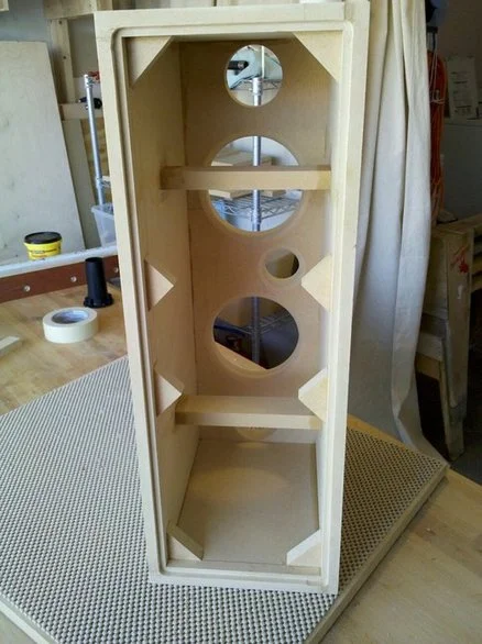

Just round the numbers , 11 inches = 27,94cm so 28cm . 9.5 inch to cm 24.13 so 24 cm . Original plans are for 1/2inch mdf , 12.7mm MDF , if you plan to make them yourself I would make them from 16 or 18 mm MDF . And use some wooden braces to reinforce the cabinet as well , two pieces inside the cabinet from wall to wall ( lateral walls ) or something like thisIn the mean time I was looking for the measurement of the single cabinet, but I only find the build plans for the speaker in inches, and recalculating them in metric values gives some strange numbers...

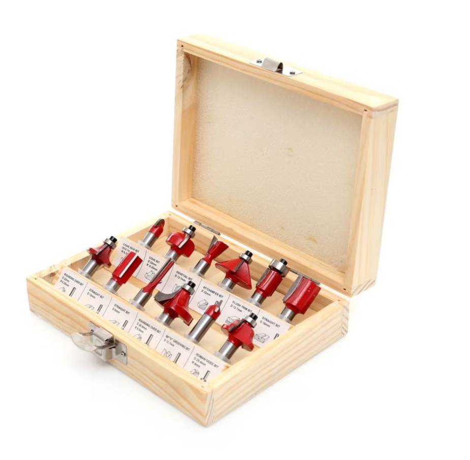

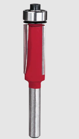

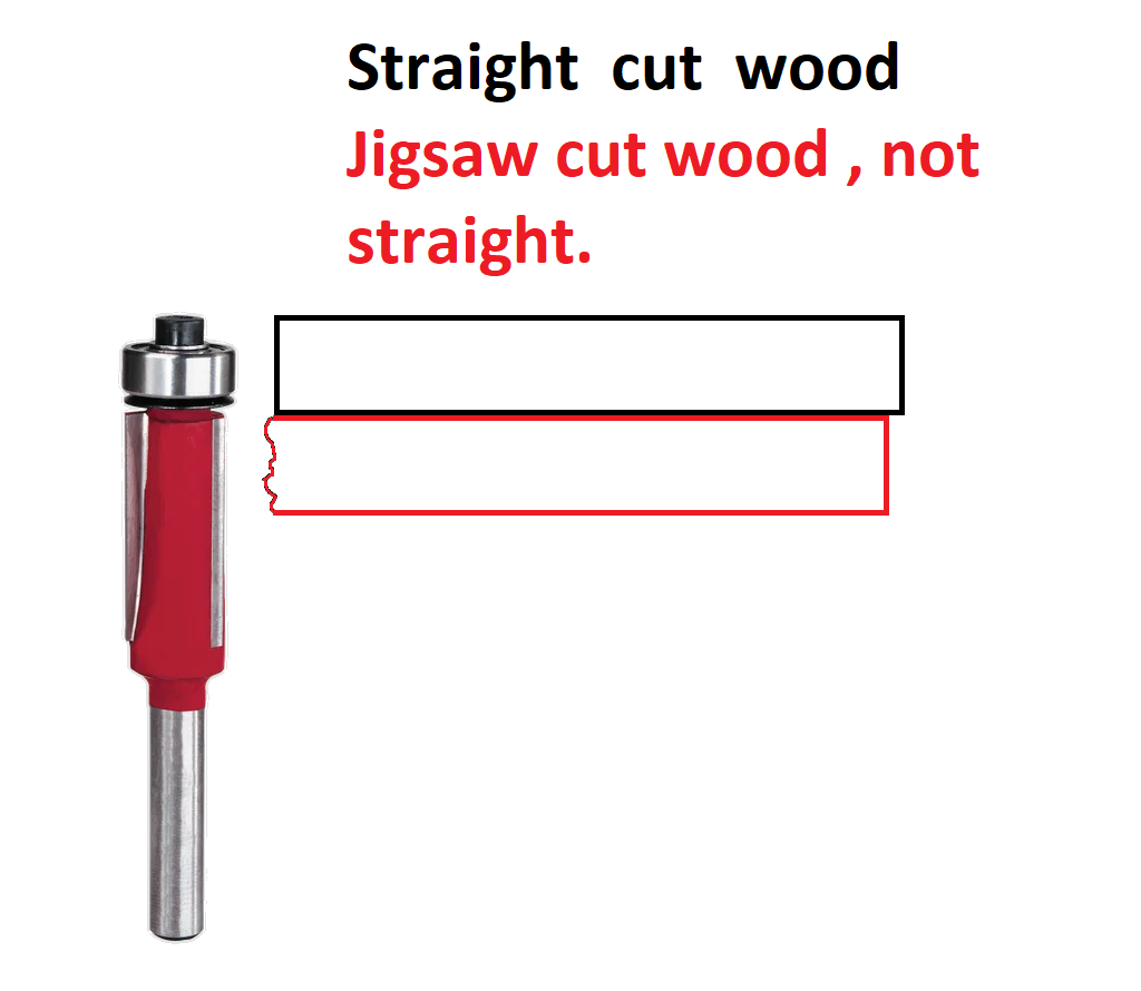

You can find a shop to buy MDF I'm sure , as for tools a router drill and a cheap set of bits . Cutting the board would be harder if you don't have access to a table saw. electric jigsaw will do but it won't cut so precisely.
Thank you 🙂@fancy_user_123 Board looks nice !.
@xXBrunoXx you convinced me, I am going to build them myself. I can get the boards in a shop already cut to the measurements needed, so the biggest part of the job is already done.
I just do not remember at what thickness I can get the mdf board, do the measurements of the speaker change based on it?
