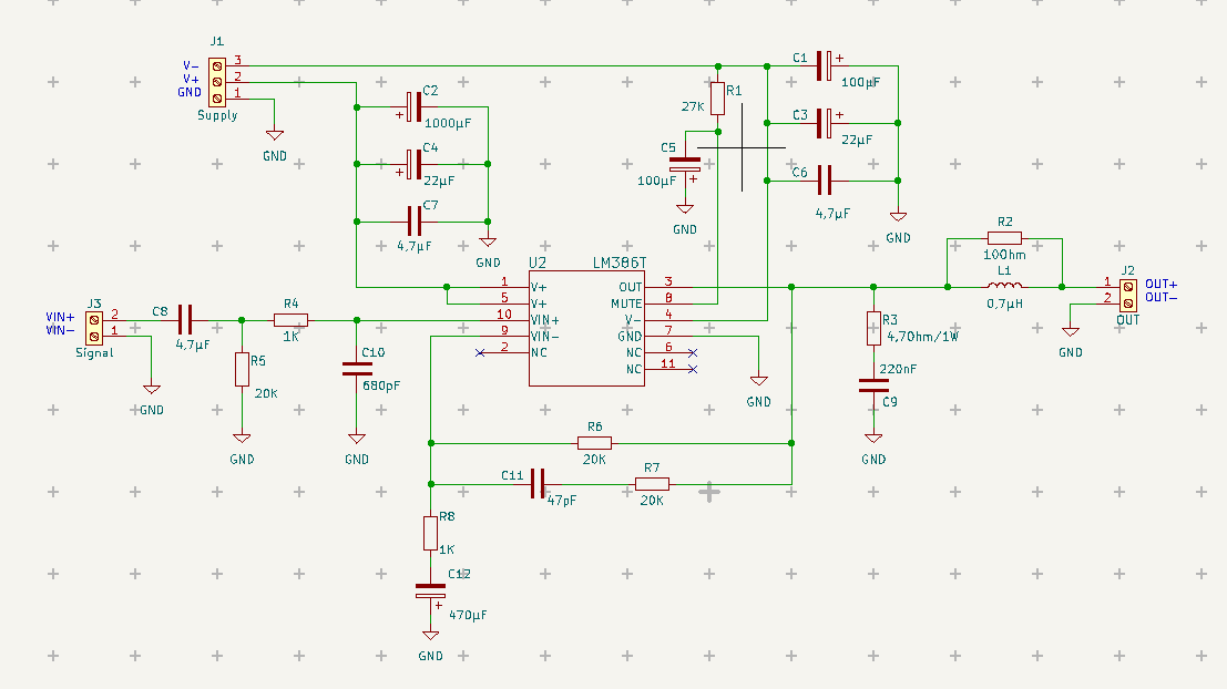

Allright, I managed to pick the components for the amplifier circuit and would be happy if someone would review that first part.
I decided to order from digikey, since conrad did not have multiple components I needed.

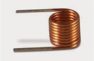

And I am having a hard time finding a 0,7µH Air core coil. Do I need to wind it myself? I never did that...
This is the schematic:

@fancy_user_123 Realistically any cap would work, if you want to spend a bit more on Nichicon for better quality parts, won't hurt.
for C12 , frequency is calculated by R8 and C12: fc = 1/(2*pi*R8*C12) , with 470uF and 1K you get = 0.34Hz
47uf for C12 and 1K R8 will give you 3.39Hz .
This is the bass response.
47uf -100uF is enough.

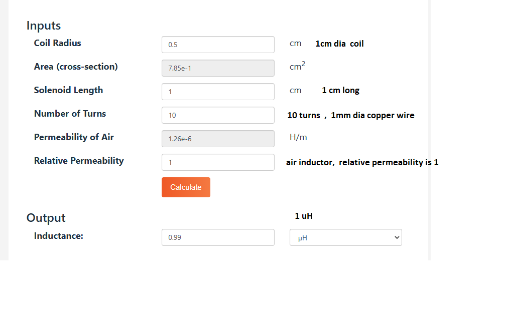

https://www.allaboutcircuits.com/tools/coil-inductance-calculator/And I am having a hard time finding a 0,7µH Air core coil. Do I need to wind it myself? I never did that...
Just wrap a few turns of copper wire on a marker pen or something , and use a bit of glue, super glue after so it maintains shape.
1uH is also good

When I am winding the coil, does the wire need to be anything special, or can I just pick any random one (with the right diameter) from my home depot store?

enameled wire, copper wire with a varnish , laque coat.
1mm in diameter not section.

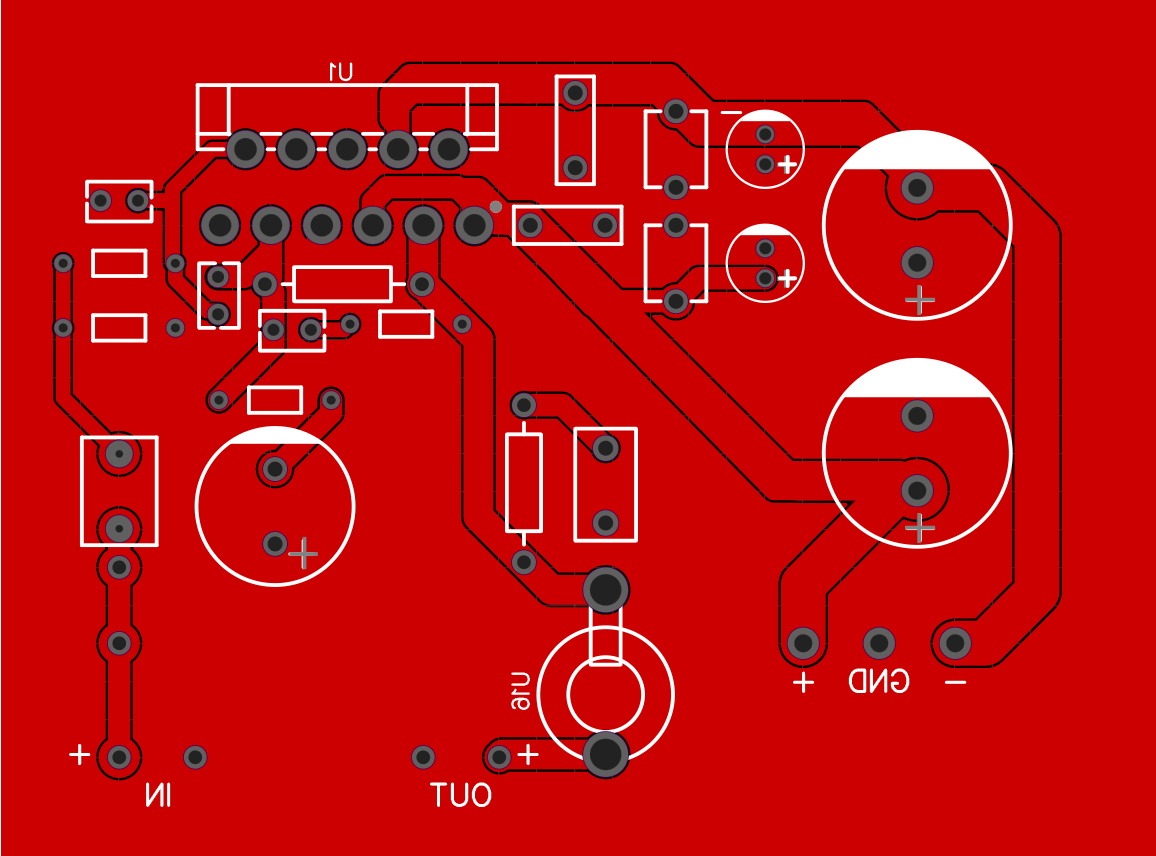

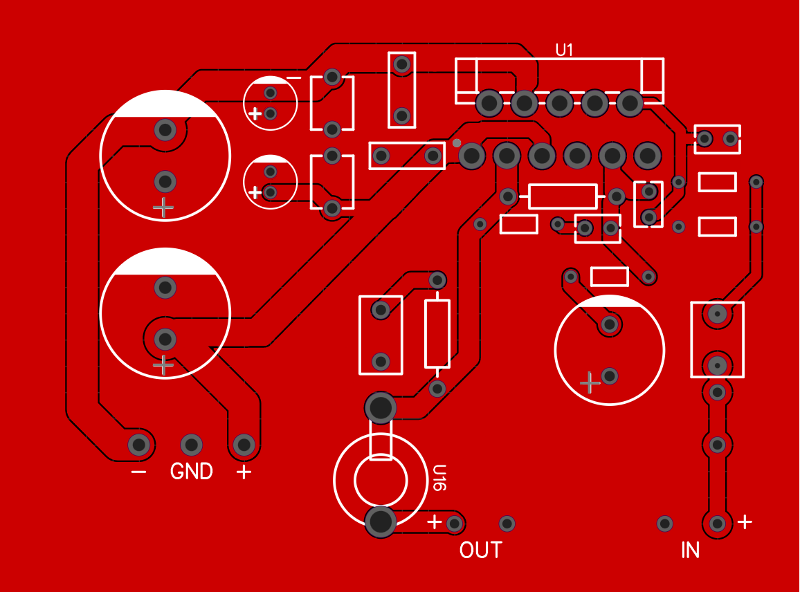

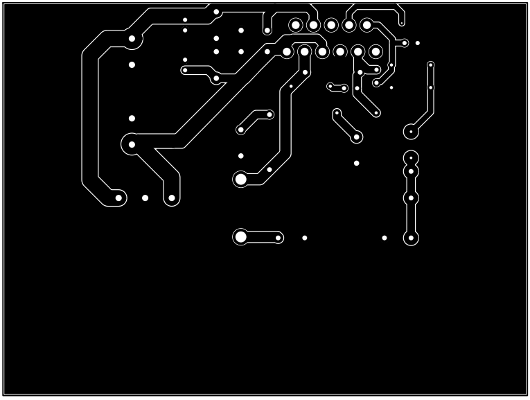

I wouldn't bother with a separate gnd for signal , if not done right it can do more bad than good.
A 2 layer pcb, on the bottom the traces for the all components, the lm3886, and on the top the ground plane where you connect everything that needs to be connected to gnd .
Don't solder the LM3886 on the both layers , it will be a pain , the gnd pin and others make them on the bottom and connect them with " via " to the top copper ground plane.

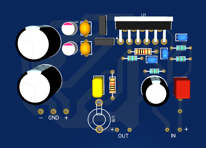

You can get it with one layer as well, here is what I did so far .
Note that the traces must be on the bottom , flipped. This is the view from top. Mute circuit is missing as well . This is an example, i haven't finished it.

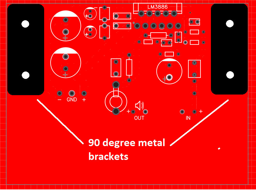

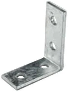

I plan to use 90degree metal brackets to mount the pcb on the heatsink . So the tension is not on the LM's legs.

To be honest, I am pretty happy that this can be solved with a 2 layer PCB, as you mentioned it is a pretty delicate story.
Now that I see an example layout from you, I realized the traces have to be pretty big...
If I remember correctly Kicad has an internal calculator for it and definitely going to copy the brackets too.
I hope I get some time this weekend to start the layout...

A question again about the capacitor that controls the bass response.
I got this value so low because the guide I am following states:
"The cutoff frequency of this filter should be 3 to 5 times lower than the Fc of the Cin\ Rin high pass filter at the input. If the Fc of this filter is higher than the input filter, the amplifier will pass low frequencies to the feedback loop that it can’t handle"
So I guess I need to adapt the input capacitor too?

The input cap with the resistor to ground ( C8 R5 in your schematic ) form a high pass filter, 4.7uF and 20K = 1.7hz
R8 C12 form the low pole, for frequency response to say so. if it's set to 20hz, logically it won't play anything lower than that.
with 470uF and 1K you get = 0.34Hz , it is 5 times lower than your input 1.7hz.
220uF and 1k is 0.7Hz , still good.
I did not hear about the " The cutoff frequency of this filter should be 3 to 5 times lower than the Fc of the Cin " .
Usually set the R8 C12 to 1 , 2hz will reproduce a 10-20hz without a problem.
And you don't need such a low frequency to be reproduced.

Thank you, good to know. But I think I am going to stick to the classix build.
So I guess 220µF is the final cap value I have to use right?220uF and 1k is 0.7Hz , still good.
You can try different values if you like. See if bass is affected, or you have different results.So I guess 220µF is the final cap value I have to use right?
