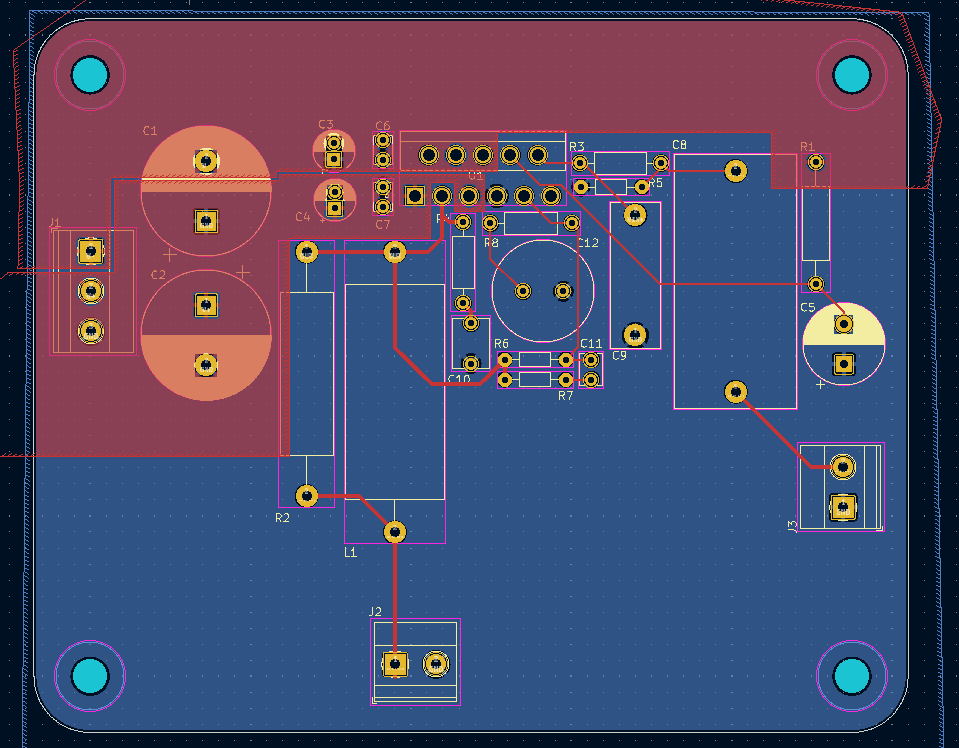

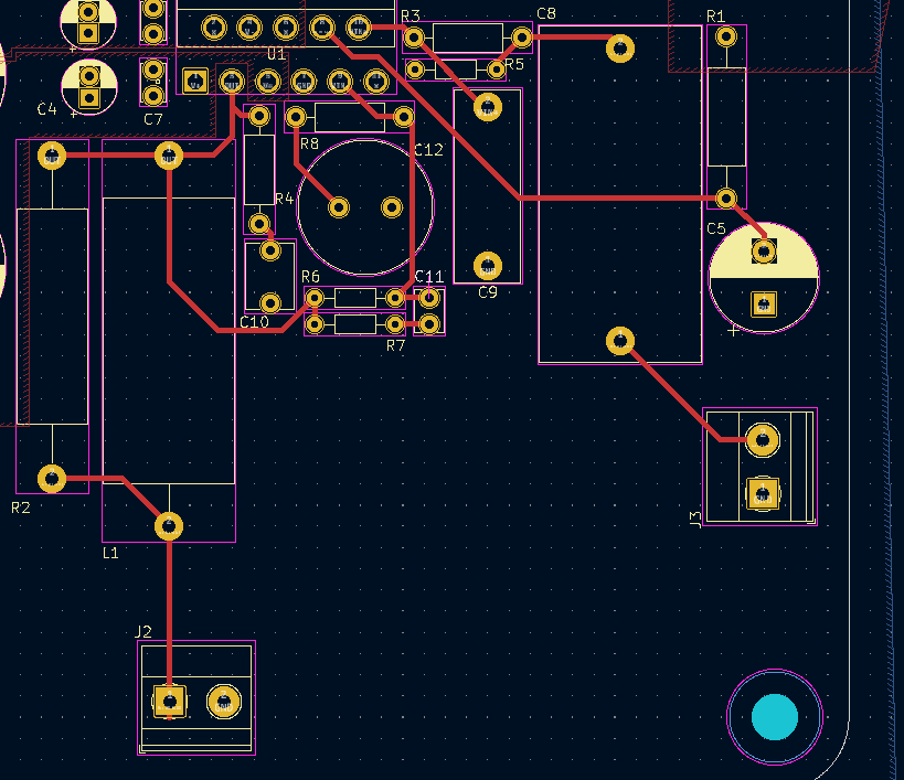

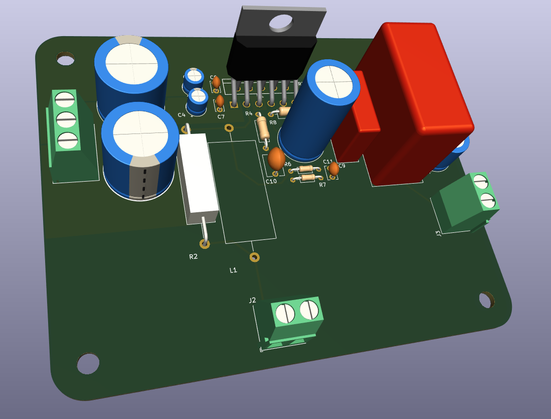

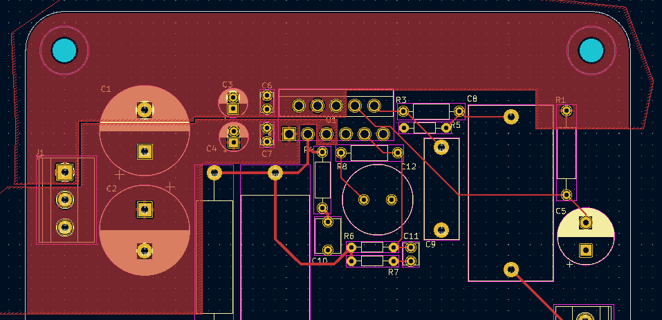

Allright, this is waht I managed to do with the layout...
It is a 2 layer board, GND on bottom and all the rest on top
I decided to go with filling zones for the V- and V+ input line, because the component layout allowed for it, but I do not know if this is a good idea...
The rest of the connections are 5mm traces, I tried to keep them as far apart and to avoid having them in parallel.
From what I understand, reading the recommended article and further online articles, the feedback loop has to be as close as possible to the output of the amplifier, so I placed R8 and C12 as they are.
Same with the zobel network, R4 and C10.
For the heatsink support, I thought about leaving some extra space behind the amplifier, so it can rest on the PCB, as alternative for the mounting brackets.
In general I tried to keep the components as close as possible to the amplifier.
This of course is just my layout, I have never done a layout for an amplifier circuit and therefore am open to any suggestions.

Hi, I was wondering what you've been up to , with the amp, I did not get a notification on your last post . Sorry for late reply.
also, Happy new year !.

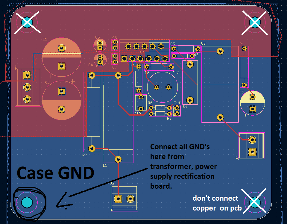

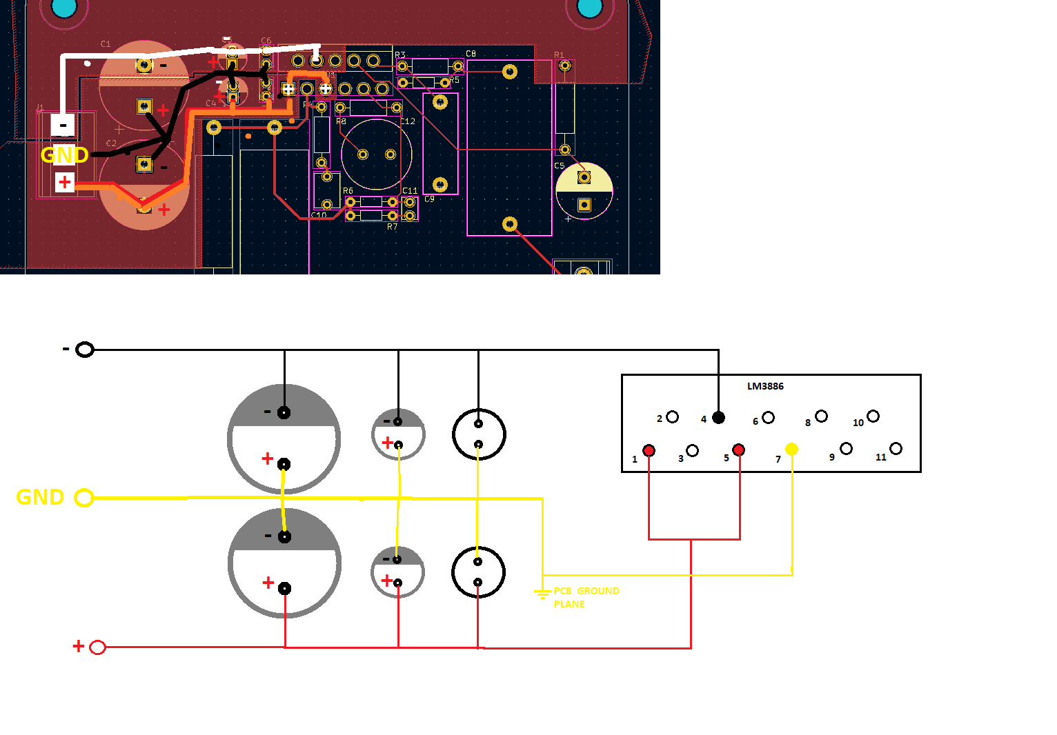

- Your capacitors are wired wrong from what I can see., one terminal to + one to - , and the other remaining + and - terminals are tied togheter to GND.
Re-arrange them.
- Resistor from pin 3 to pin 9 should be close to the ic .
- For easier soldering of the LM3886 I recommend having the traces on the bottom side , TOP side GND , and not having to solder the ic on both sides of the PCB.
!!!! Having the V- on the PCB holes , will connect them to the case ( amplifier enclosure ) !!!! you will short the V- to case ( amplifier enclosure ) GND !!!. . Usually you have GND on the PCB holes. The case of the LM is connected to V- , ( normally ic's would have GND on the case and heatsink. ) DO NOT Connect the top holes with copper fill . Isolate the heatsink from the amplifier case ( amplifier enclosure ) . or use mica to insulate the LM's from the heatsink. For better thermal connect the LM's dirrectly to the heatsink and insolate the heatsink from the Amplifier case. from the 4 holes on the PCB , only connect one with copper fill to GND, and connect it trough the screw on the case , make there the connection with the transformer / power supply rectification board GND . Leave the other 3 holes with no copper on them. !!!

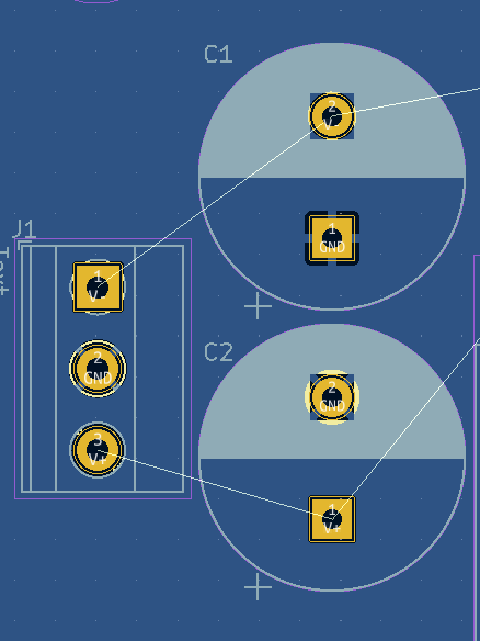

Hello again, happy new year!
- If I understand it right, you mean the filter capacitors for the input voltage of the IC, going from C1 to C7, right?
If I compare them with the schematic you mentioned here:
No problem with that.
They should be connected the same way, or am I missing something?
- Okay, moved the resistor closer to the IC, are there any other components with priority that should be connected as near as possible to the IC?
- So I guess I have to do the whole layout again, what trace width are you using/recommend using?
The 4 holes on the PCB are mounting holes in Kicad, they have a extra symbol for it and are not connected to anything (or at least on the other PCB I made, a Buck converter, it was like this).
What I planned to do is to use a transparent plexiglas enclosure and keep everything in sight. But from the adapted picture you made, I guess I need to have one hole connected with the GND plane to be able to connect the PCB GND to the supplyboard?
Thank you again.
Using plexiglass enclosure won't matter then. So your ground plane on the pcb connected to a 3 pin header, with the + and - is fine. it connects to the power supply board. No need to connect wires to / trough the holes , screws.

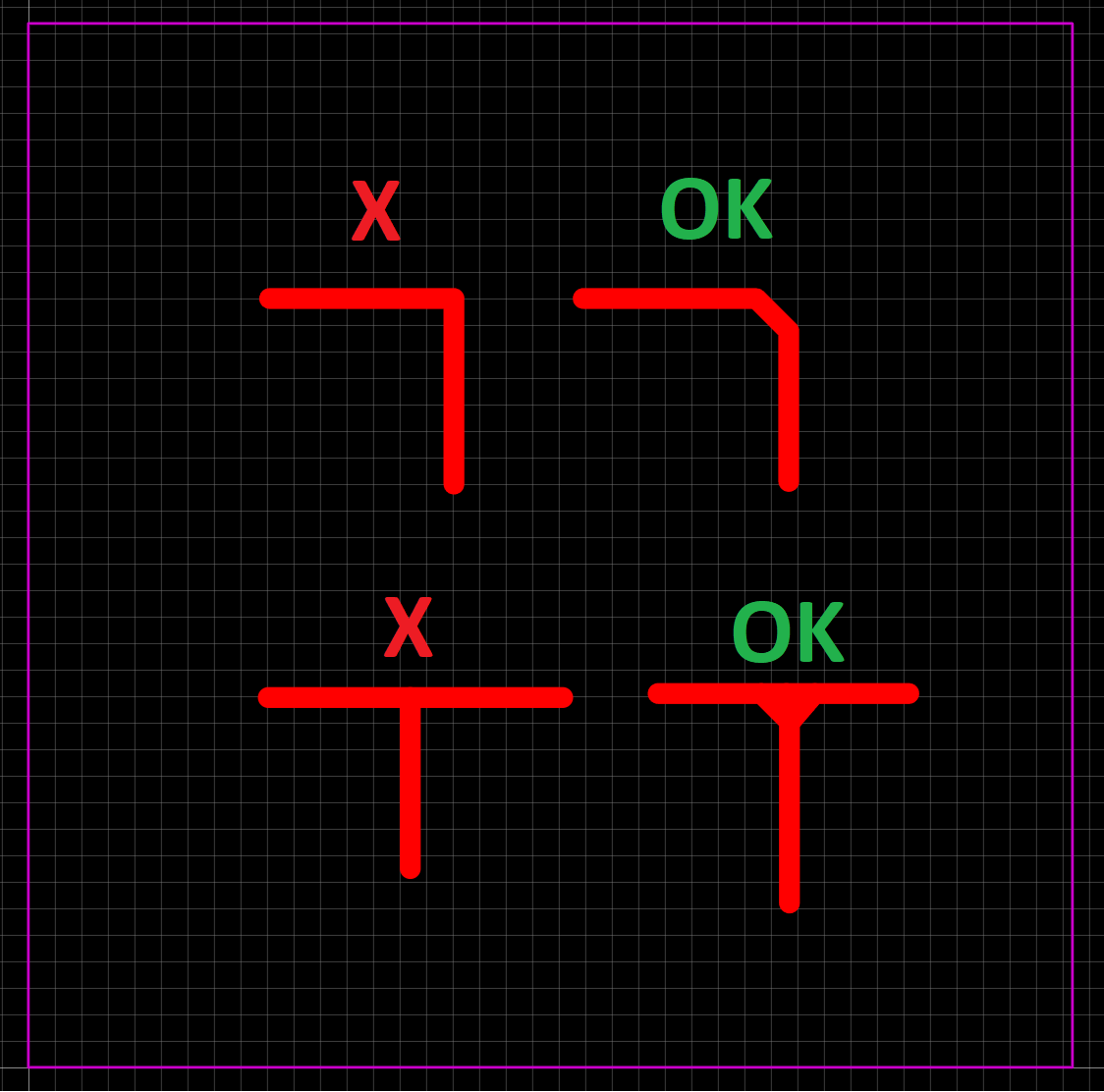

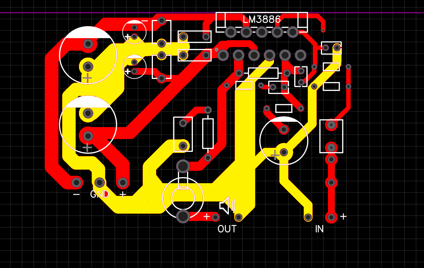

for signal won't matter that much how thick the traces are , avoid 90 degree bends.
For the + and - you can make them thicker , as much as you want, if you have space . on my pcb they are 3 or 4 mm. For the speaker output I used 2mm. even 0.2mm would be sufficent, because the traces are short, but if you have the space , why not make them thicker.
I have 1 mm traces for signal. You have the space make them thick, Filling the traces like you did for + and - is good .

Thank you for your detailed response!
However, I'm still a bit confused about which specific capacitors you meant that I may have connected incorrectly.
I've gone through the circuit again but can't seem to pinpoint them.
Could you explain to me again which capacitors you meant? Sorry if this may sound stupid, but I can't seem to find them.

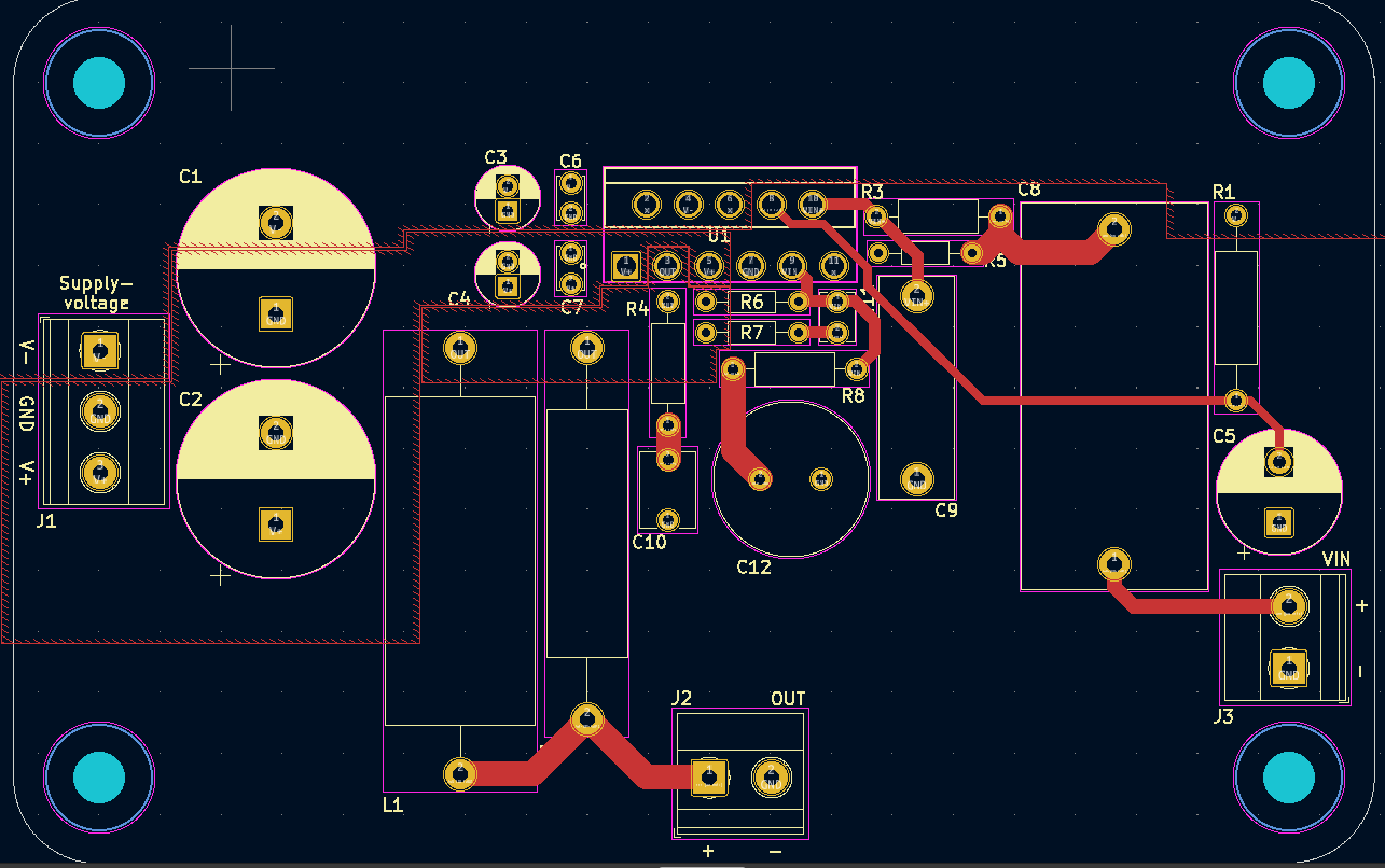

Hello,

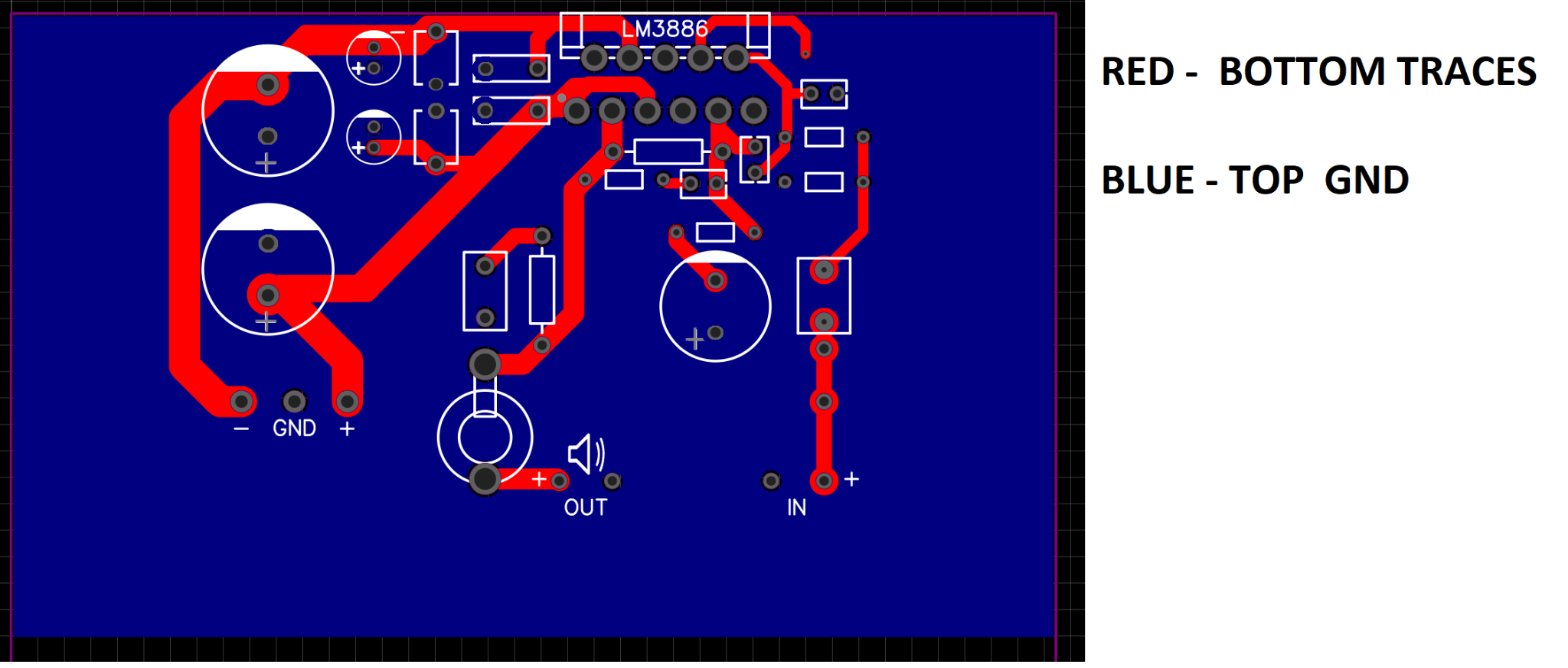

@xXBrunoXx I updated the schematic and PCB as you suggested, you drew a separate GND trace in the pictures, is the top GND plane enough or do I need a separate GND trace for the input capacitors?
Because from the past pictures you posted about your design, you made a separate trace, but the GND traces are all connected together, right?

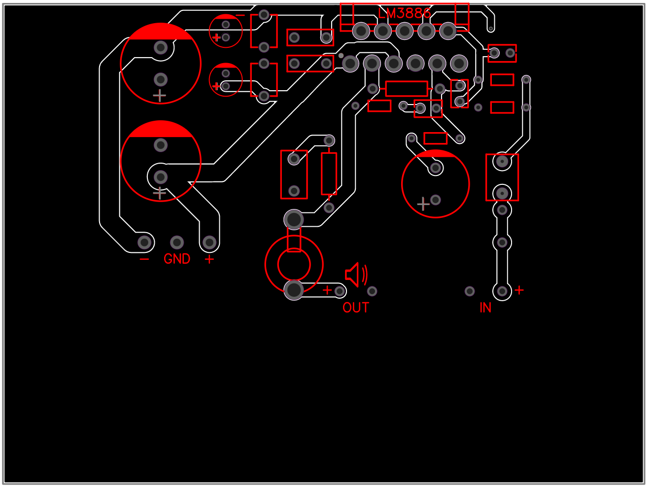

Allright, 2nd attempt
I switched the top and bottom plane, now GND is on top and the rest on bottom.
I made the traces thicker, up to 2mm.
I switched the position of R6, so that it is near to the IC.
I made zones again, where the space allowed it.
