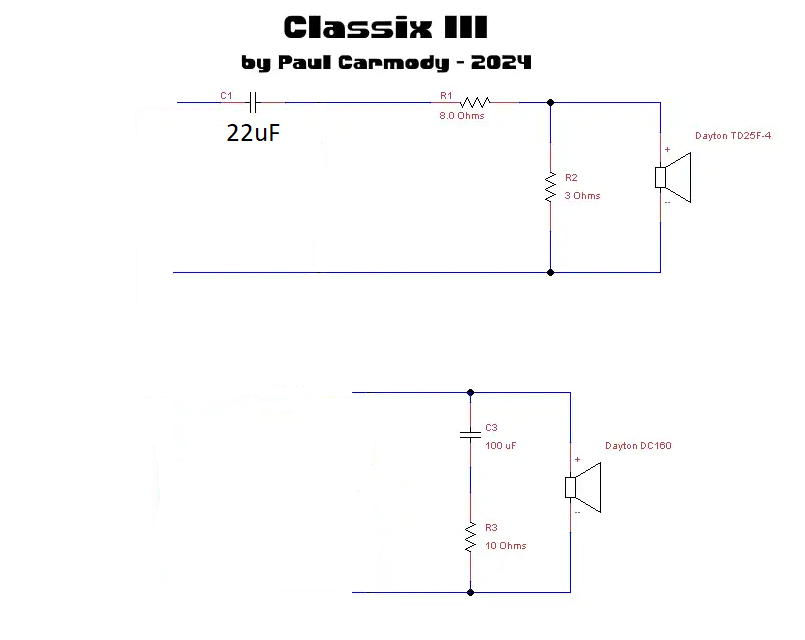

Okay, definitely choose the classix 3 build with its components.
I am going to build the variation with the front port.

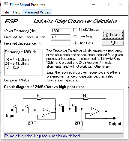

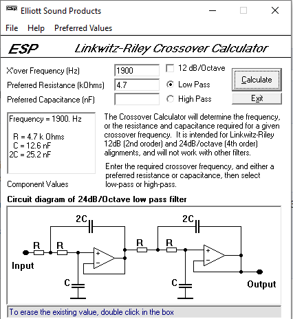

You can also bi-amp the classix 3 build , you won't need crossover anymore ( only impedance equalization circuit maybe )
active crossover https://sound-au.com/project09.htm
calculated the values for 1900hz .
impedance equalization circuit , needs to be calculated but something like this ( first picture ). There is always a good idea to have a cap between the amp and tweeter even if you bi-amp.
Or build them with crossovers and you only need a 2-ch amp.
Many options .

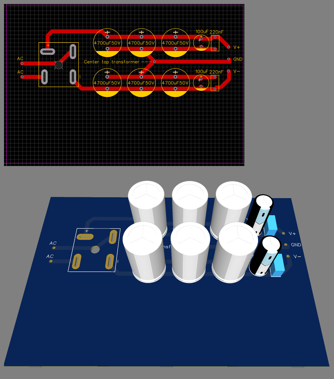

Quick PCB example:
The most expensive parts besides the speakers is the Transformer.
you will need a two winding secoundary, or " double tap transformer" .
LM3886 recommendations are DC ±28V for 4ohm, ±35V for 8ohm .
So +-24 to +-30v would be ok.
Transformer ac voltage multiply by 1.4142 you get the DC voltage after rectification , filtering.
So , 17 - 0 - 17 to 21 - 0 - 21 vac transformer, at least 150VA, 200VA+ would be nice.
Bridge rectifier , 20 - 25A 600V are cheap. ( the square ones with metal casing are/ might be " better " )
Capacitors, lower value more in parallel is better than one big cap, you reduce the ESR ( series resistance ) by doing so, at least 2x 4700uF 50V per rail is ok, more is better, but to much will only cost more and little to no benefits, it can also " stress" the bridge rectifier .( something like + 47.000uf per rail )
Parallel some small 100nF caps ( MKT, Ceramic ) and maybe one 100 - 220uf . On the LM3886 board you'll also need some 470 - 1000uF caps per rail with one smaller value 47 - 100uF and a ceramic ( you can read the article on supply decoupling https://neurochrome.com/pages/supply-decoupling).

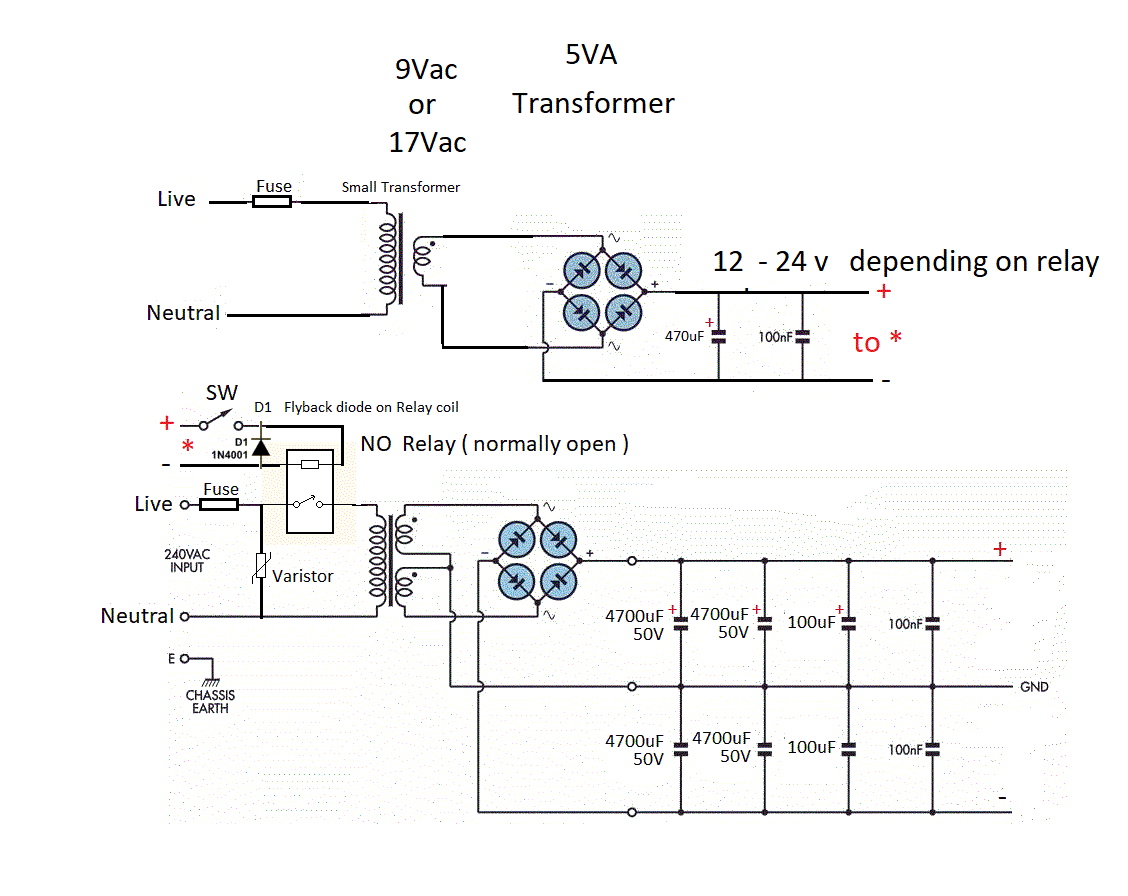

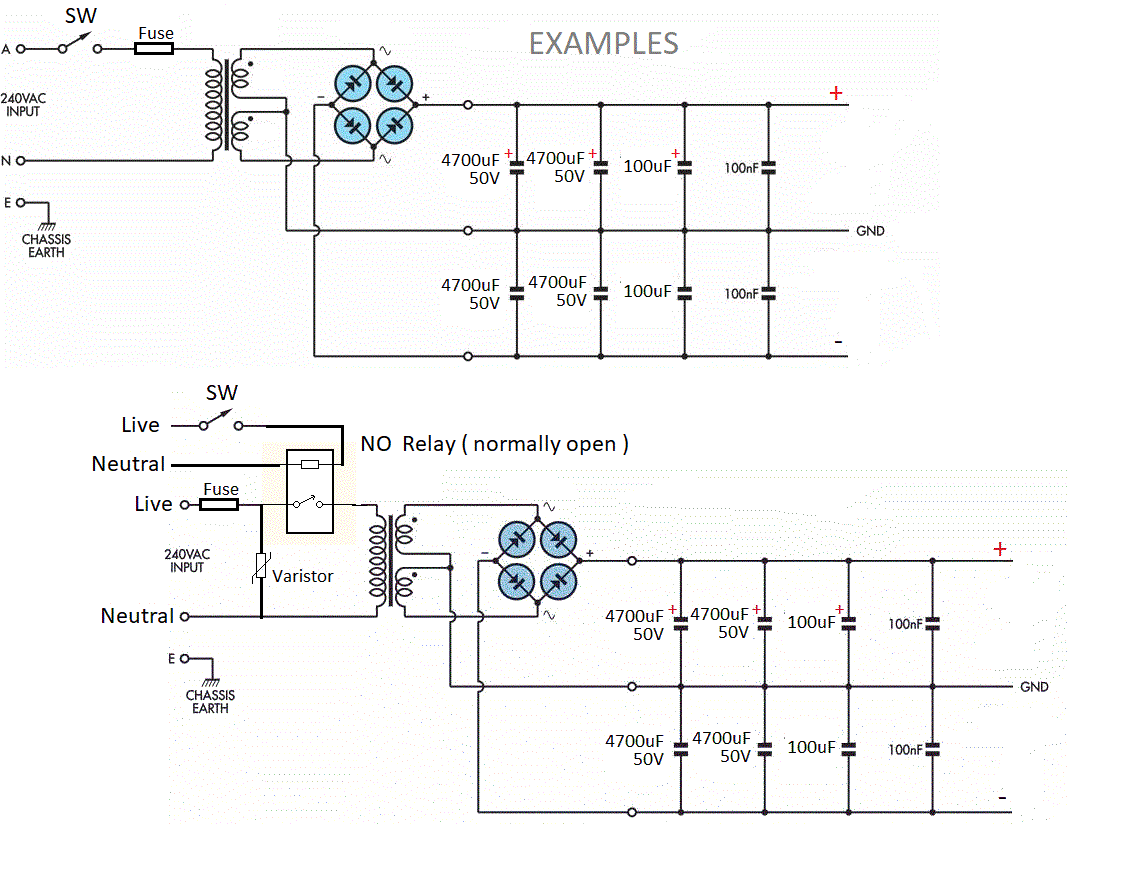

You will need a fuse on the transformer primary. one fuse per rail after the rectification board, can't hurt. but might be a problem if only one blows and depending onthe amplifier you might get DC on the speaker output, anyyway if the chip dies that might happen . A speaker protection board is needed and recommended!.
You can use a relay instead of the switch for the transformer, ( one that works on 220Vac ( so you won't need another small transformer for the relay coil ) and has a few amps, 6 - 10A ).
You can add a varistor in parallel , for high voltage protection, Lightning, etc.
Transformer examples:
https://www.tme.eu/ro/en/details/tst200w_2x17v/toroidal-transformers/indel/tst-200-008/
https://www.tme.eu/ro/en/details/tts200_z230_17-17v/toroidal-transformers/breve-tufvassons/
Using a second transformer for the Relay ( and use a 12 - 24V DC relay ) Will have the benefit that you won't have live voltage on the switch , somewhat safer. a small bridge rectifier and a small capacitor 470 - 1000uF.
- So for the rectification board ( bridge rectifier with capacitors ) you can find " finished solutions " .
The transformer you will need to buy.
A SMPS can also work , but here it depends on it's quality , reliability. I recommend the " old fashioned " transformer. Toroidal are more efficent/ better then I-E core ones.
Schematic drawings were made in a hurry ,.
Feel free to point if I missed something or ..
- Bruno.

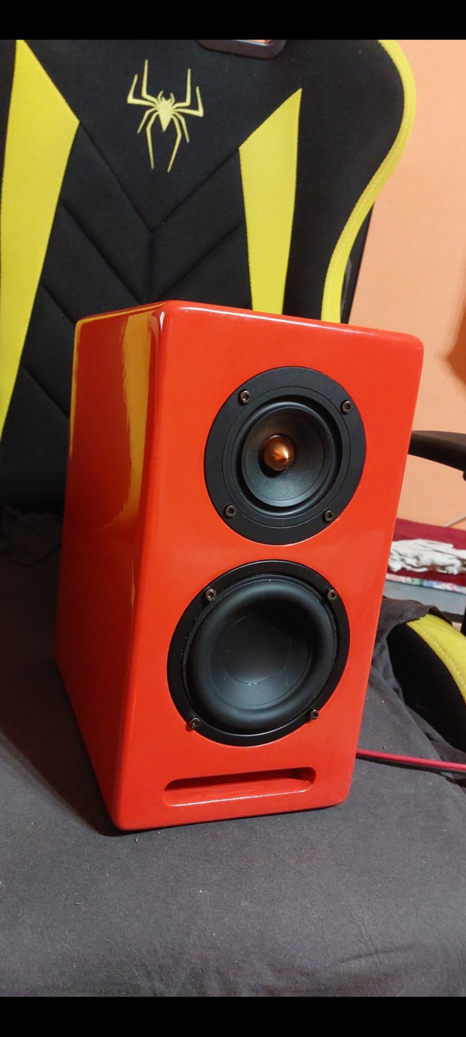

My desktop speakers are two way: Dayton audio ps95 as mid range tweeter and woofer Dayton audio TCP-115 , It's a budget build .
I have listened to them on my Pioneer amp, and also on my TDA7375 amp that has a " power brick " of 14v 2.5A ( 35W ) . And they get plenty loud and sound good . for PC desktop use , movies, games, you won't listen to more than 5W - 10W / channel .

So, I went through the answers you gave me.
Since I am from italy, and if I like quality electronic components, I order them from conrad.it/de.
Found components:
Transformer:
https://www.conrad.de/de/p/block-rte-200-2x24-ringkerntransformator-200-va-4-17-a-710747.html.
Output voltage, 2x24V and 200VAC as you recommended
Rectifier:
https://www.conrad.de/de/p/tru-comp...ichter-kbpc-600-v-25-a-einphasig-1581965.html
25A, 600V
IC:
https://www.conrad.de/de/p/texas-in...linear-ic-verstaerker-audio-tube-2994810.html
Regarding the protection board, I am going to look around google on how to size them for the speakers and so on.
I wont list all the smaller components around the amplifier without having a design for now.
Sorry if this may sound a little stupid, but I don't understand what you mean here. Where did you get the multiplication factor? Why do you jump from the recommended 28V of the datasheet, to the 24V and now to 17/21? What does 17 - 0 - 17 mean, the positive and negative output voltage?
From where do I get this value, is this kind of a allrounder or is it mentioned somewhere?
With the switching of the device, I have no doubt to find a solution for it.
And I would like to add that speaker you made looks pretty nice, this is not spraypainted right?
What I wanted to say is : LM3886 recommendations are DC ±28V for 4ohm, ±35V for 8ohm . So , an input voltage ( DC ) of +-24 to +-30v would be ideal. ( +- meaning two rails, two voltages, one with + and one with - respect to ground . )
You don't want to be very close to the maximum voltage ( more heat, needs bigger heatsink ).
17 , 21 was the AC voltage not DC. ( that would be around +-24v DC , +-30V DC aprox ) .
By 17 - 0 - 17 I meant two outputs , 17 v to 0 ( Ground ) , because the transformer has two windings, outputs. You need two rails, +V DC and - V DC to Ground .
So, " 17 - 0 - 17 transformer " 2x 17V AC will be 2x 24 V DC .
and 2x 21V AC transformer will be 2x 30 V DC ( approximately ).
Your transformer https://www.conrad.de/de/p/block-rte-200-2x24-ringkerntransformator-200-va-4-17-a-710747.html voltage is 24 v AC,
that will be around 32V .
