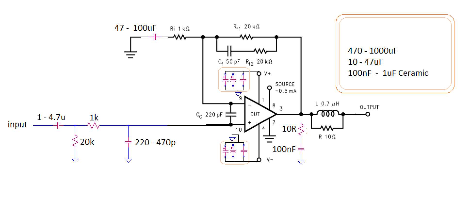

Reactions: jlinkels
@xXBrunoXx That is a nice circuit. I think it is a perfect match for a 50W speaker system.
You set a gain of 21 (26 dB). This is also in the TI application note. Usually amplifiers driven from a PC have a gain of 30 dB. And I find that even on the low side. The gain of the PC + final amp is often not high enough to get sufficient audio volume. Especially with some Youtube videos which recording level is simply low. And I have to add an additional pre amp of 10-20 dB. Is this low gain satisfactory for you? Just asking.
Now I also see that Ali Express has some very nicely priced (stereo) boards built around the LM3886. Those are prices I am totally unable to design and have PCB made, buy all the components and the heatsink. The heatsink alone is usually half of the total price. And since nowadays mainly complete assortments of active components are offered (of which 80% I'll never use, talk about waste!) I would not able to build this board myself for a price even close to that. Even if the board contains some fake components they are easy and cheap to replace.
I was planning to buy some TDA7293/94 boards as mid and hi amplifiers for my active speaker system. But these LM3886 circuits also look very nice. Any comments on which to prefer?

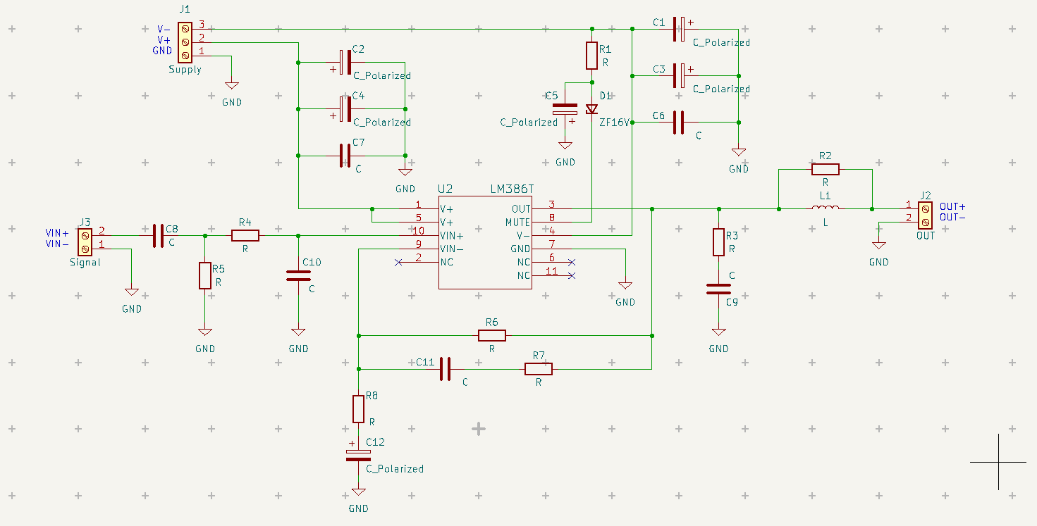

What I managed to do instead, until now, on Kicad is this:
It feels a little like cheating, but I found this guide on the internet:
https://www.circuitbasics.com/design-hi-fi-audio-amplifier-lm3886/#Things-to-Decide-Before-Starting
and it seems pretty good to me, I counter-checked a couple formulas and circuits with the datasheet, nothing to say against it...with my inexperienced eye in amplifier design. (I have not chosen the values of the single components yet, I am aware of it.)
If I am not totally wrong, what I did is even the same as what you did, just that I copied it from someone else and counter-checked the datasheet.
I am aware of that too, but I really like the topic and my ego/curiosity does not allow to just by the finished product...I want to build it and own it.
Reactions: xXBrunoXx
C12 you could use non polarized cap or if you use polarised, + should go to ground for LM3886 because of its internal schematic.

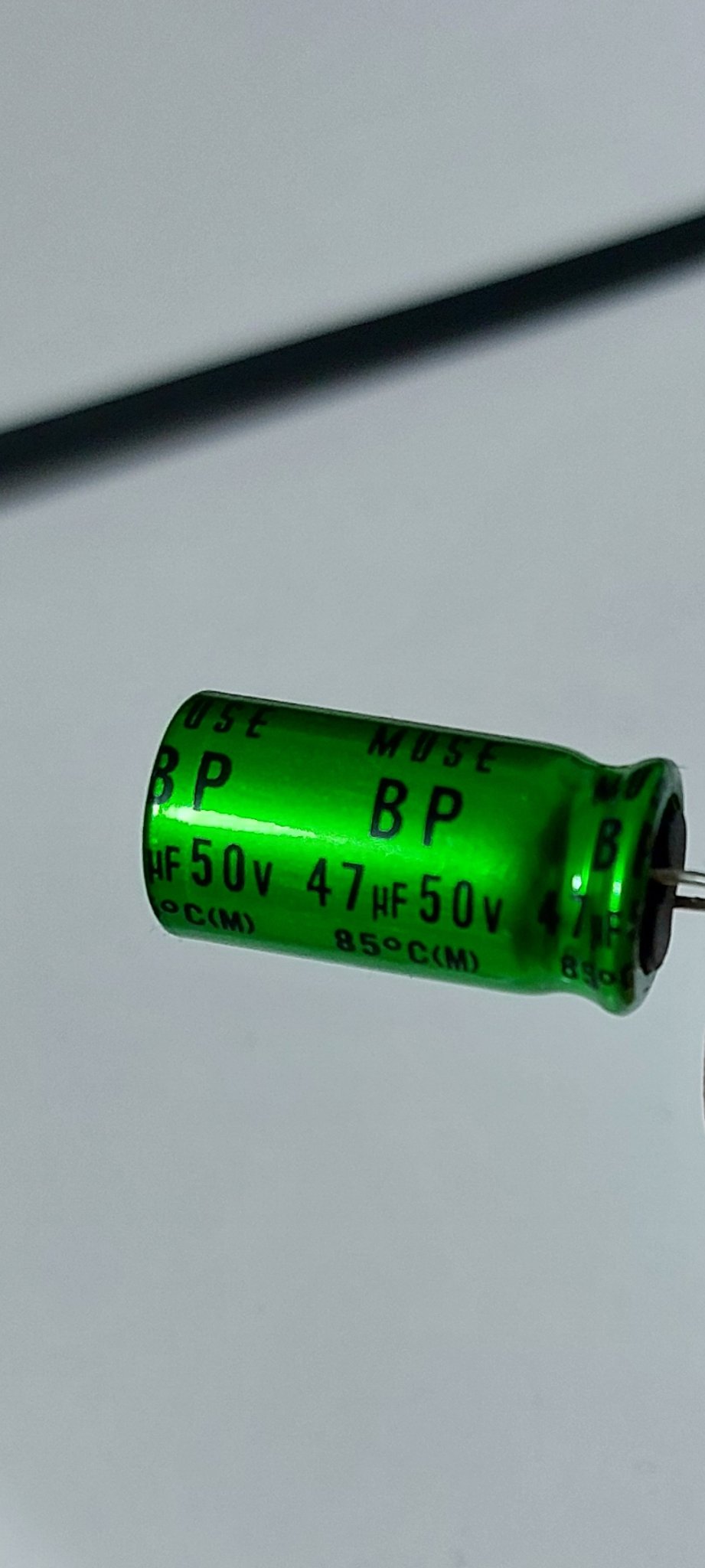

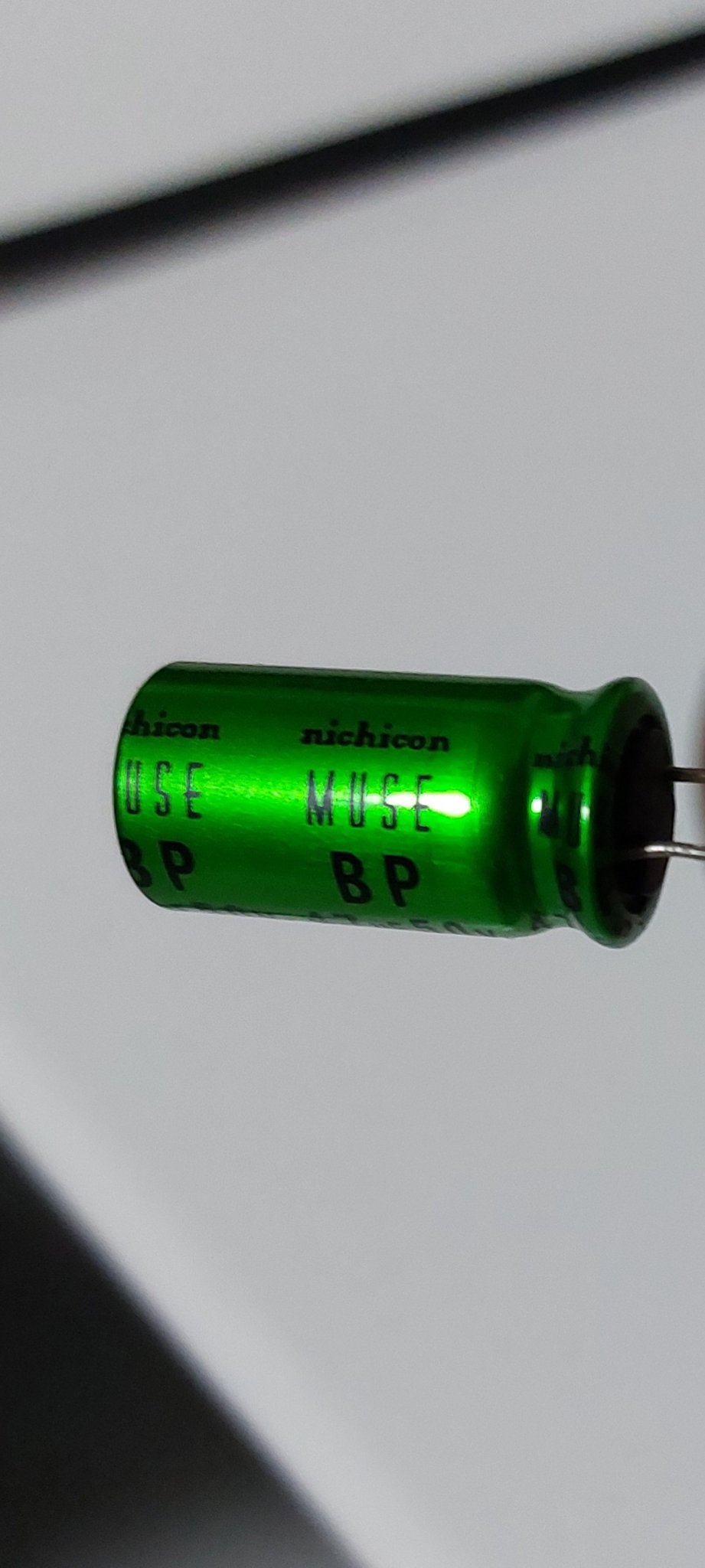

You can buy Nichicon Muse BP one of the best caps for audio .( the green ones)
For input cap C8 you can get a film cap, non polar.

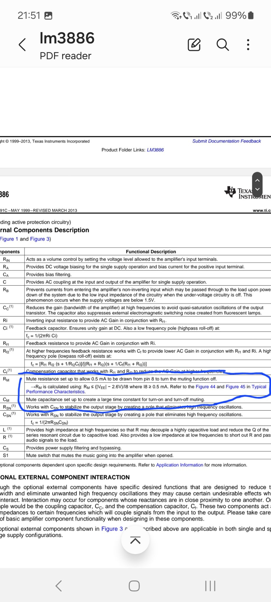

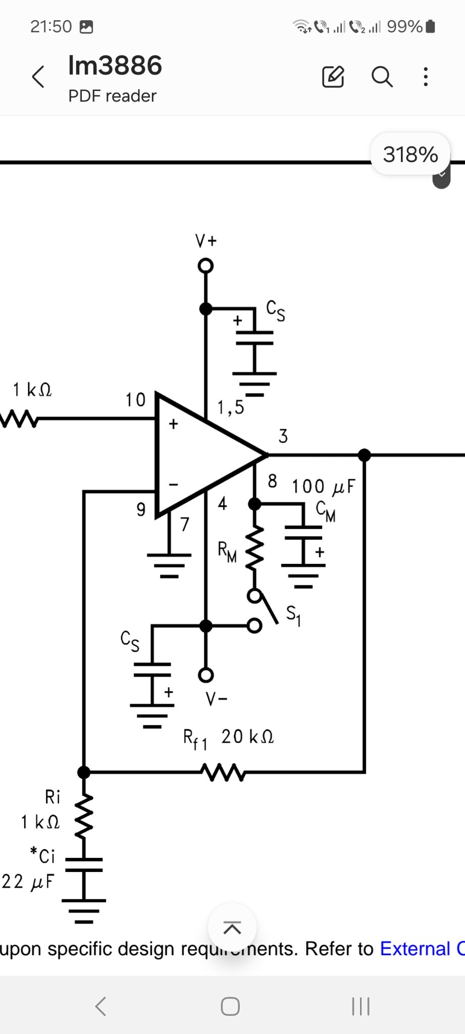

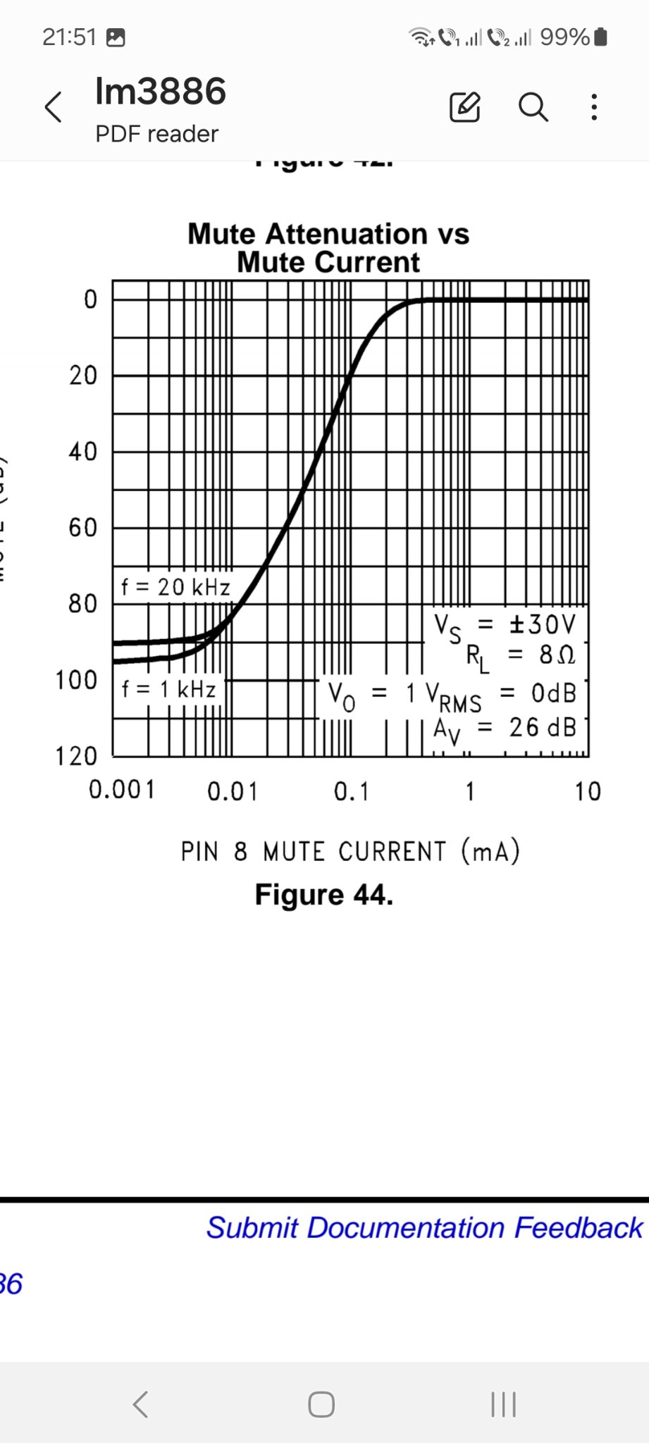

Hi, you need around 0.5mA on the mute so the amp turns on , unmutes.
You need a resistor fron mute to -Vcc , with a cap from mute to gnd. Look in the datasheet.
RM = 54.8k so a 51k res would give around 0.5mA at -30v
27k for RM would work for 1mA at -30v .
