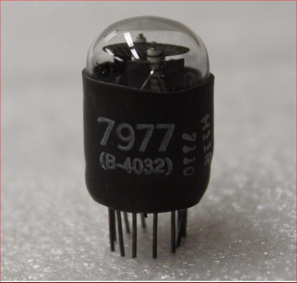

Is any way to utilize some trick or to create some workaround with an extra neon bulb for tubes without decimal point in 3rd position? I have B4032 BURROUGHS - smallest nixie made in US and SWISS, and see if I can utilize these somehow on your tacho. Please let me know.

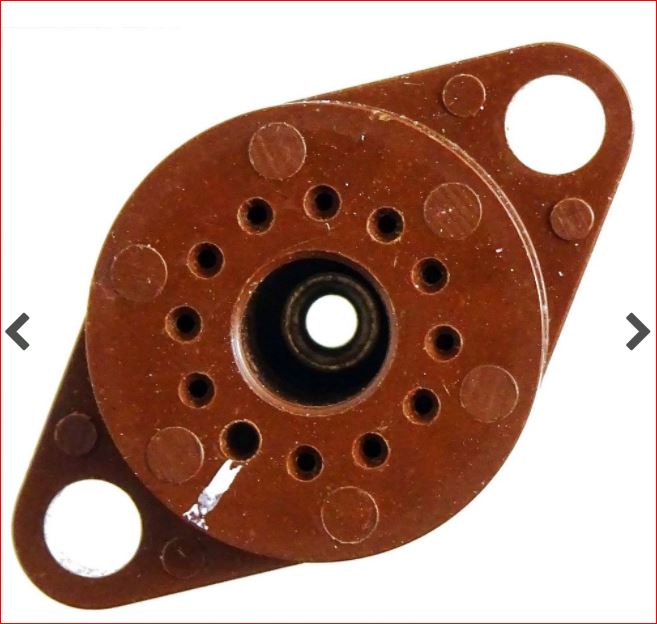

The pin out for the Burroughs tubes are different than the IN12 or IN16 so you will need to use wire leads between the tube and the PCB (or use the Eagle file and modify if for your tubes). The Burroughs tubes have no decimal point, so use a small orange LED with a larger value resistor to dim it (try 2.2K or larger) between 5V and gnd.

No change to Eagle File since I'm going to use dedicated SK-116 tube sockets anyway and need to wire them P2P. I rather to use small neon bulb instead of Orange LED for esthetics reasons (and that is just in case that PSU has enough juice to run both sets, like 5 small nixies and that bulb with Vdrop resistor for 70V operation). If PSU will sag or will be too warm due to excessive current draw, then I'll have no choice and will use advised LED.
