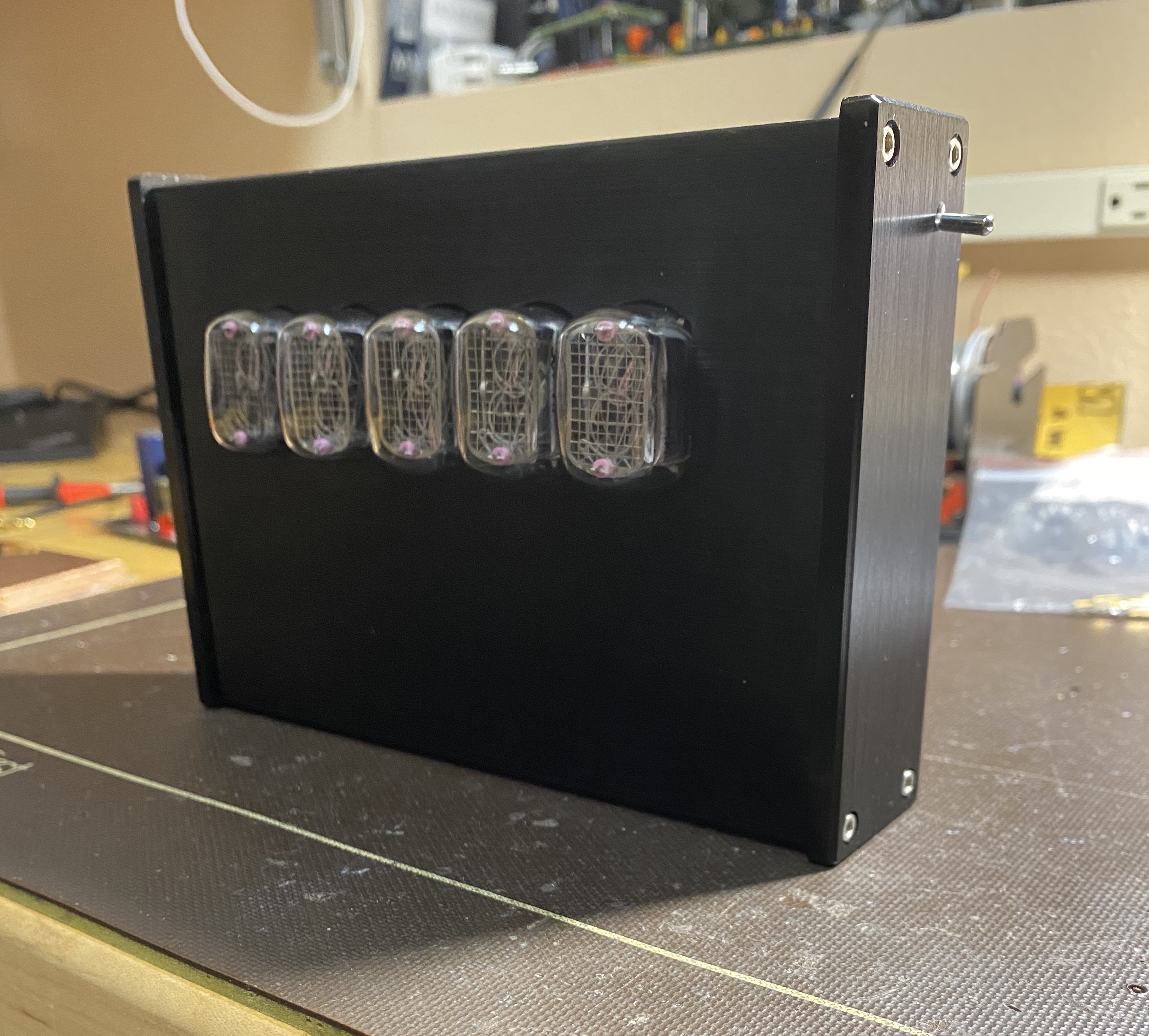

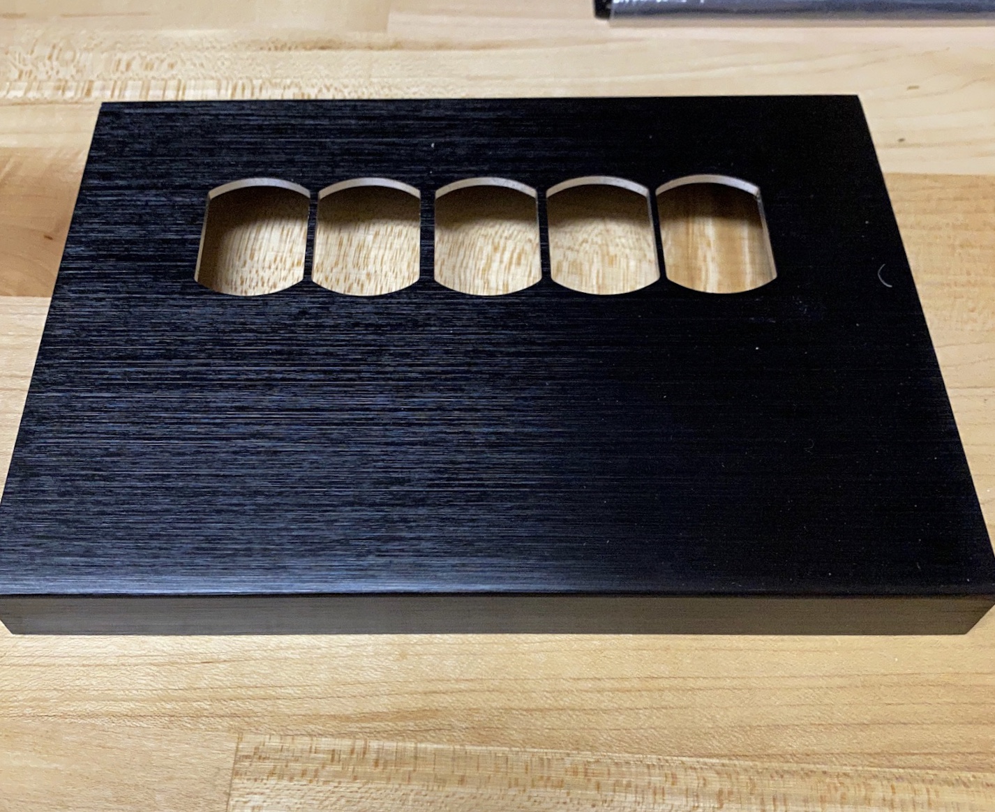

Pyramid—if I wanted to orient the IN12 tubes upside down (so that they were at the bottom of the board instead of the top), would that require a different PCB or a coding change?
Thanks.
Thanks.
It changes everything, hardware and software. Why would you want to do this? I specifically made it so it was easier to get the tubes to display in a window and make it easy to hide the PCB (and components) from view.
So that’s a ‘no.’
I’d like to integrate it into a DIY plinth in the bottom left hand corner.
I’ll come up with a different spot, that’s all.
I would go and use 3-4 inch wires to connect tubes as PCB requires and then rotate them to whatever orientation is needed on your panel-window.
