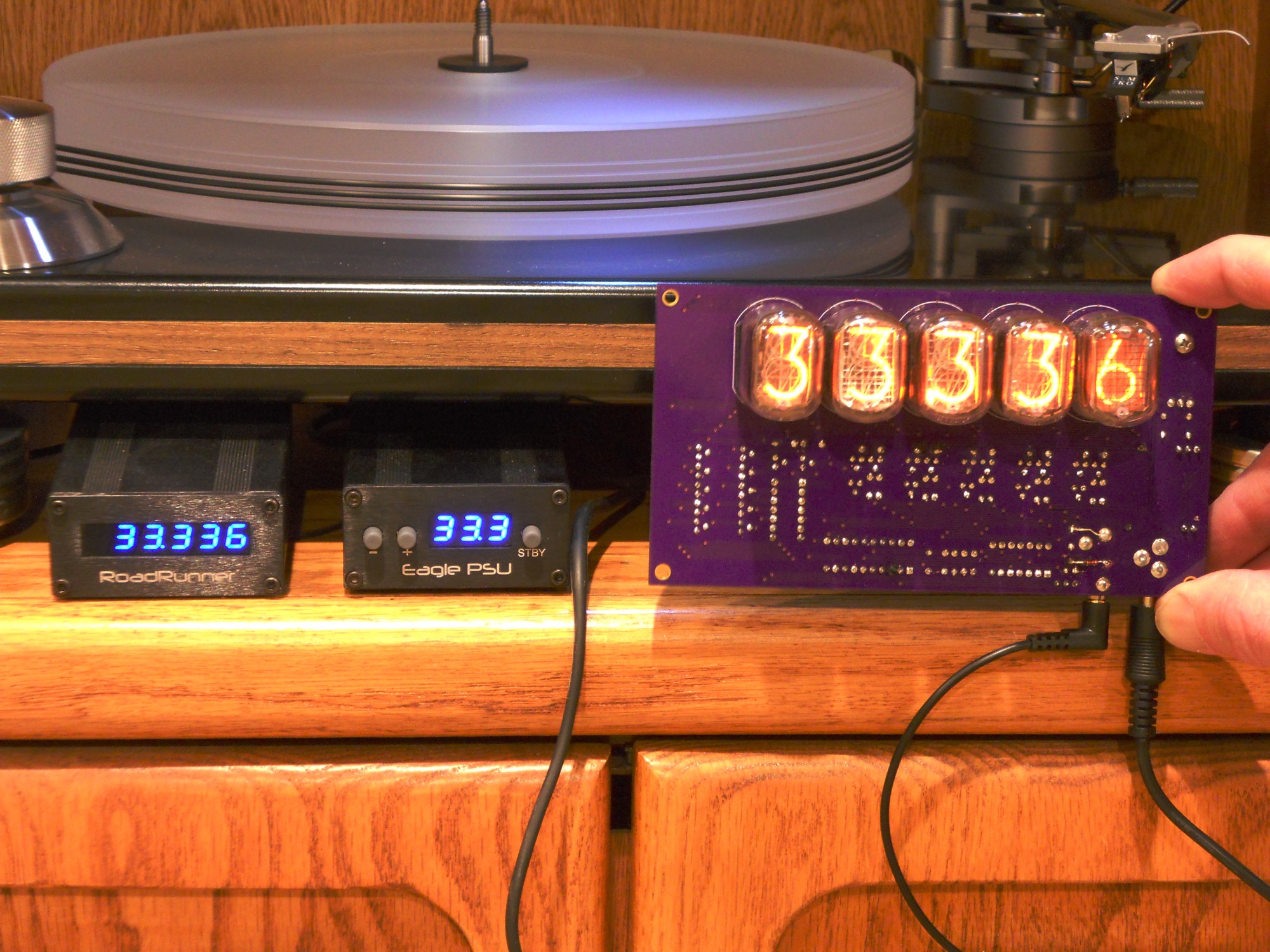

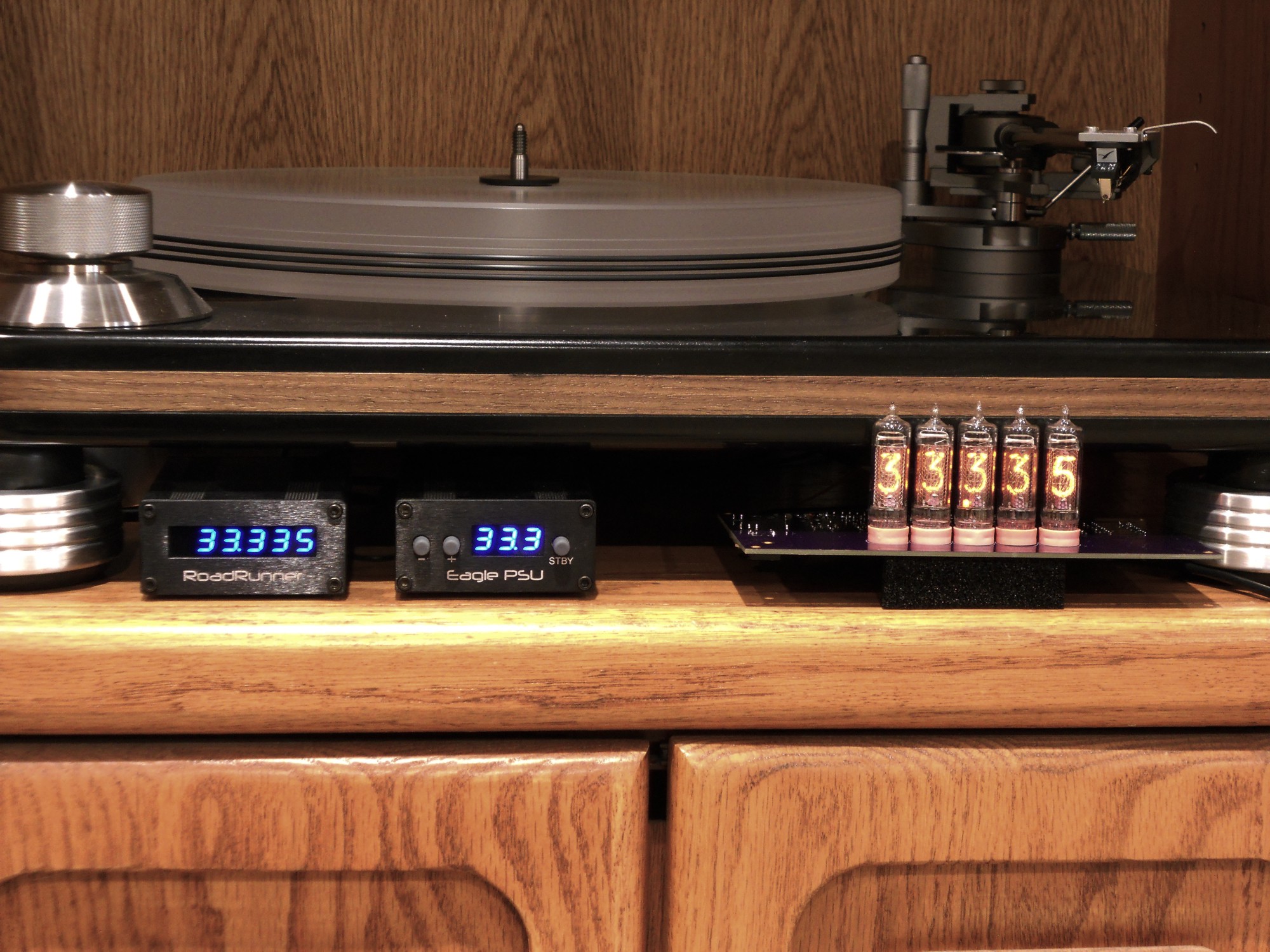

DIY Nixie Tube Display for turntable tachometer
This is a shared DIY project for non-commercial use.
This project is an extension of the DIY Arduino tachometer; several users have requested a Nixie tube display as an alternate to the LCD. There are currently two versions of the Nixie display, using IN12 tubes and IN16. I've included the EagleWare .brd file if someone wants to modify it for use with other Nixie tube types.
The PCB uses all thru-hole components for easy assembly, but some soldering skills are still required. The uP is a DIP package but there is a socket for it on the board.
The project consists of a bare PCB, a parts "kit" available as a shared cart from Digikey electronics, a uP with the operating system pre-programmed into it and the on-line documentation you see here. The two PCBs are identical except for the display tubes, so the shared Digikey cart works for either build. It is highly recommended to use socket pins for mounting the IN12 tubes, which are not included in the Digikey shared cart. You must add them to your order. The Digikey PN for the pins is ED90326-ND; you will need at least 60 pcs (12 pins per tube). The IN16 tubes do not (and cannot) use sockets, they are soldered to the PCB.

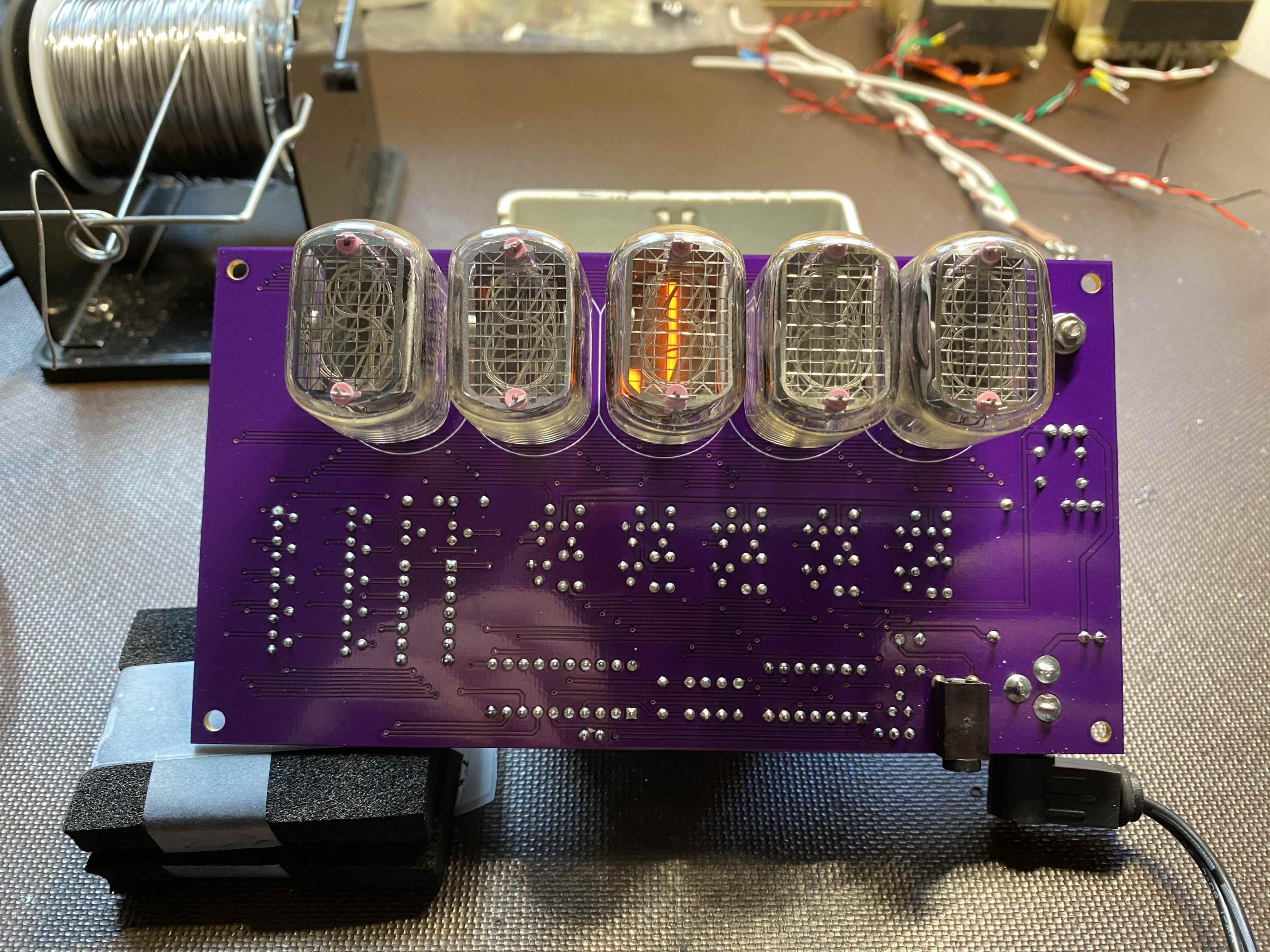

My OSH Park PCB set is back from their Fab and will be shipped in next 48 hours to my home. Will have all parts in hands then, beside uP. Is any ETA available for pregamed uP be ready for shipment? I’ll be not be able to test it without it.

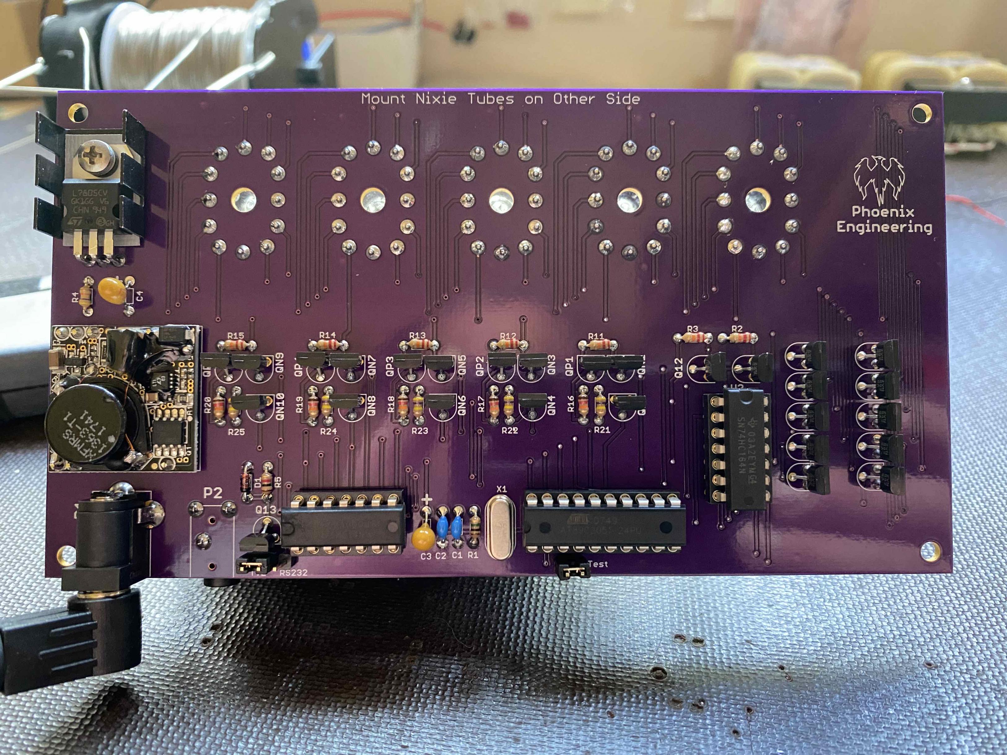

Assembly went very smooth (very nice PCB design) and I got no any issues during soldering parts.

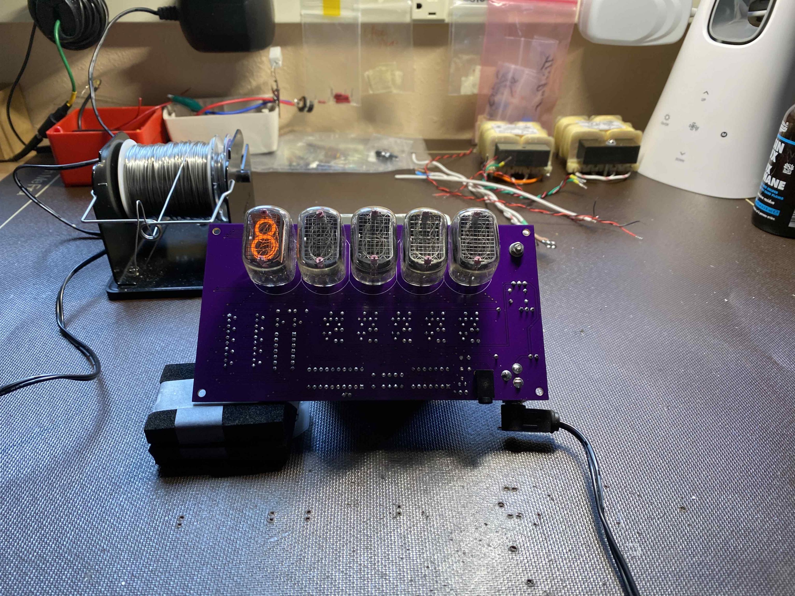

Tested it yesterday and it seems test mode is working fine. I'll upload some video to YouTube and add link to the thread.
Couple of remarks:
a. DigiKey Saved BOM has some extra pieces of varies parts. Not big deal and better to have inexpensive spares vs. missing pieces during assembly...

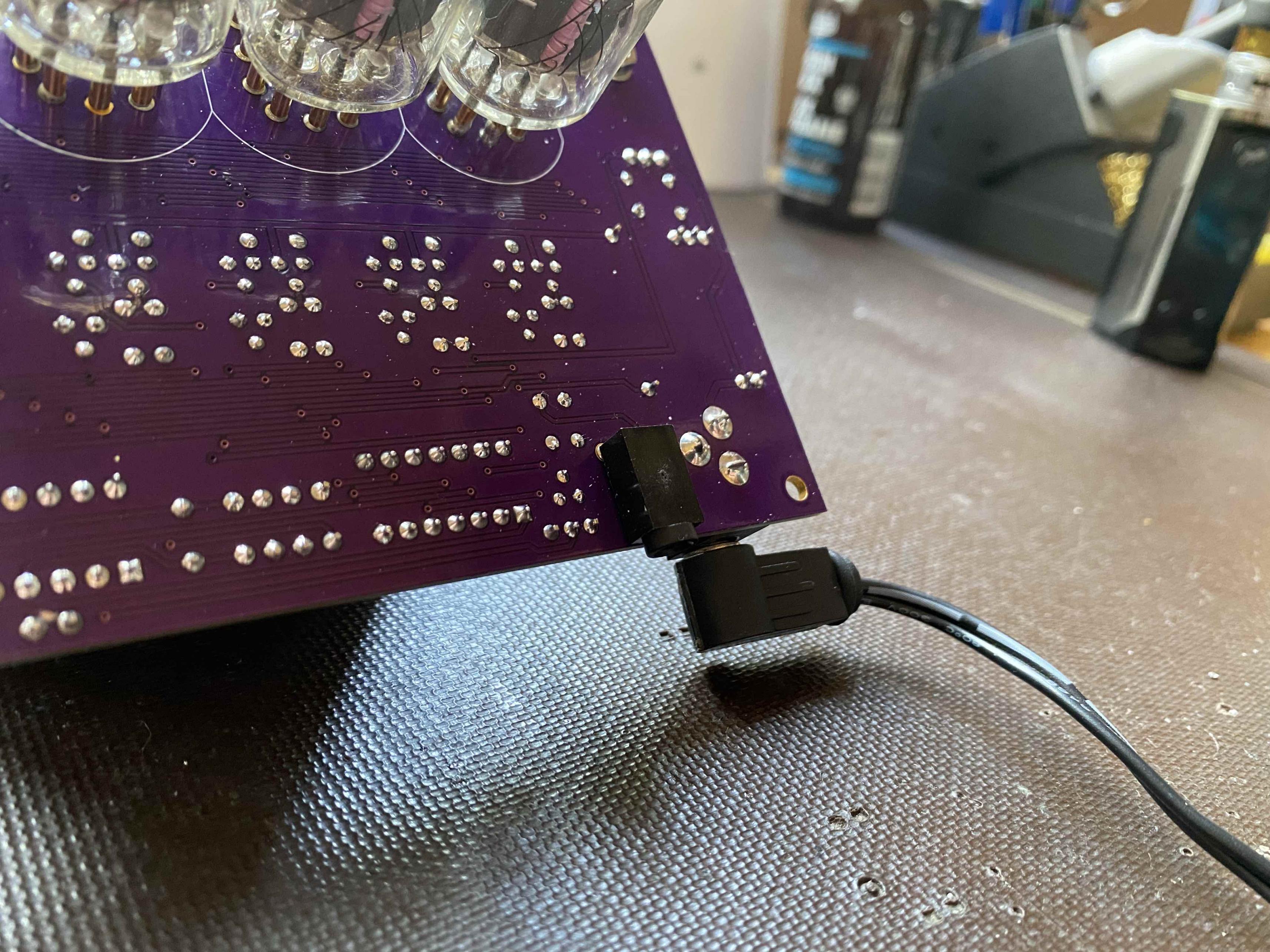

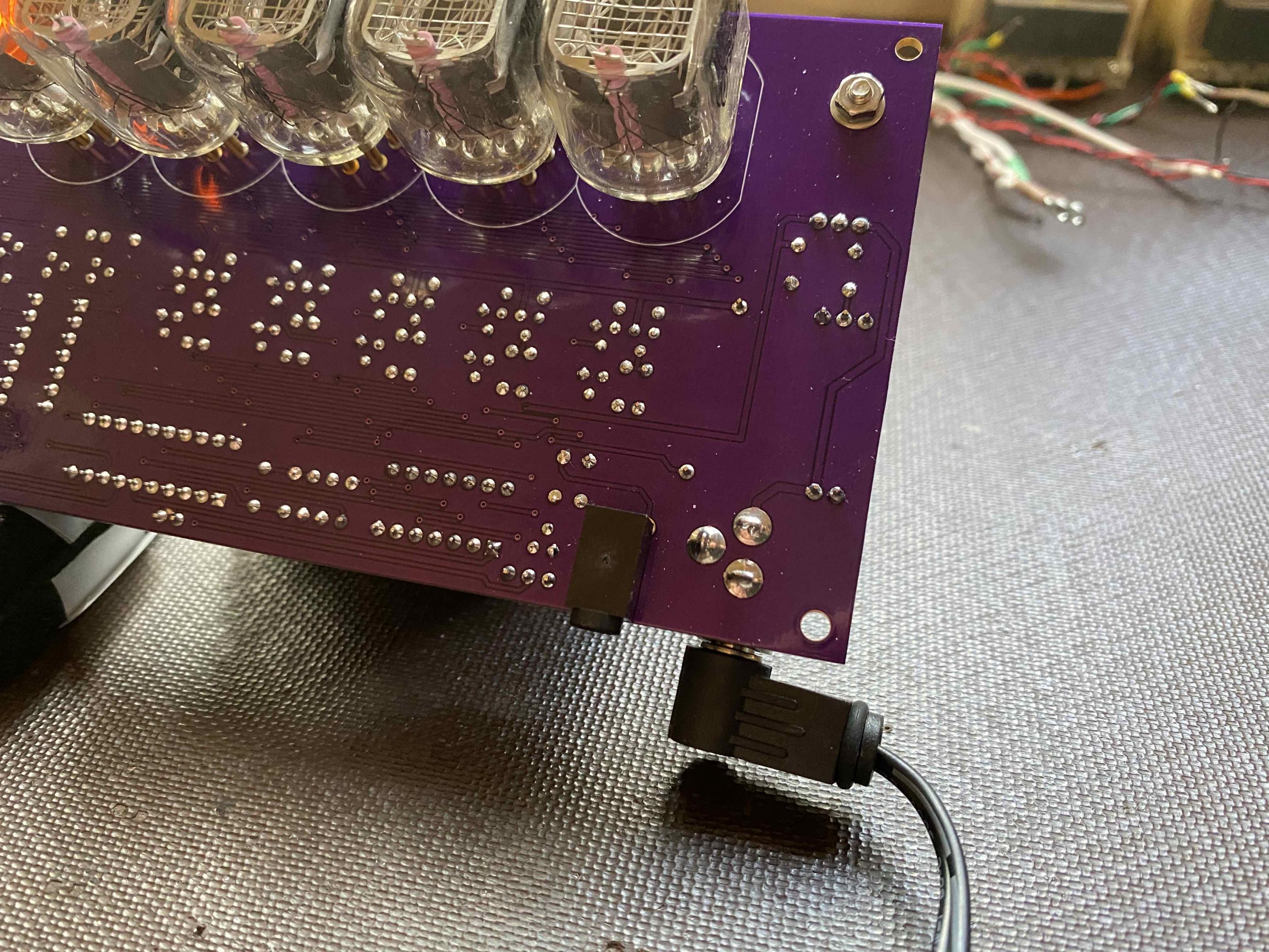

b. 3.5mm female connector for Tacho data is mirrored and I installed to the same side as all Tubes are connected.

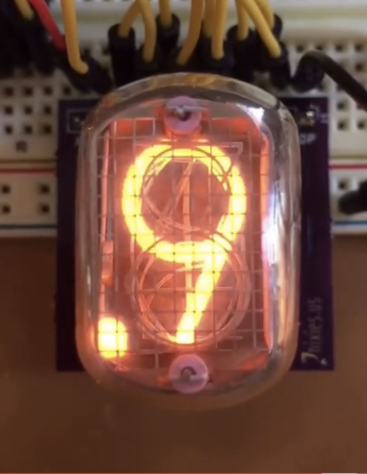

c. I have very small part of some number cathode (somewhere inside) bit glowing on 2nd tube when I ran test on other tubes. I tested with two tubes at that position and both show (first more than the other) very small dot. No issue at all, but I feel that I need to report that.

Remarks:
a. Some of the parts require 5/6 pcs and it is cheaper to buy 10. For the single parts, I still listed 10 as they are inexpensive & it's good to have spares.
b. I changed the connector I used from the 1st prototypes to the final version and did not spin another PCB to test it. I either misread the datasheet for the new connector or it was mirrored (probably the former).
c. In lamp test mode, you should not have any other cathodes illuminated in other display tubes. This can happen in normal operation as the display is multiplexed and some leakage can occur. I purposely made the anode drivers push-pull to prevent this, but it is unavoidable in these types of displays. I could only see ghosts when looking at the display up-close.

About remarks:
Parts order logic is clear and personally like spares. My glow (as I mentioned, it is not big deal at all) is quite dull and barely visible. It is about 2-3 mm in size.

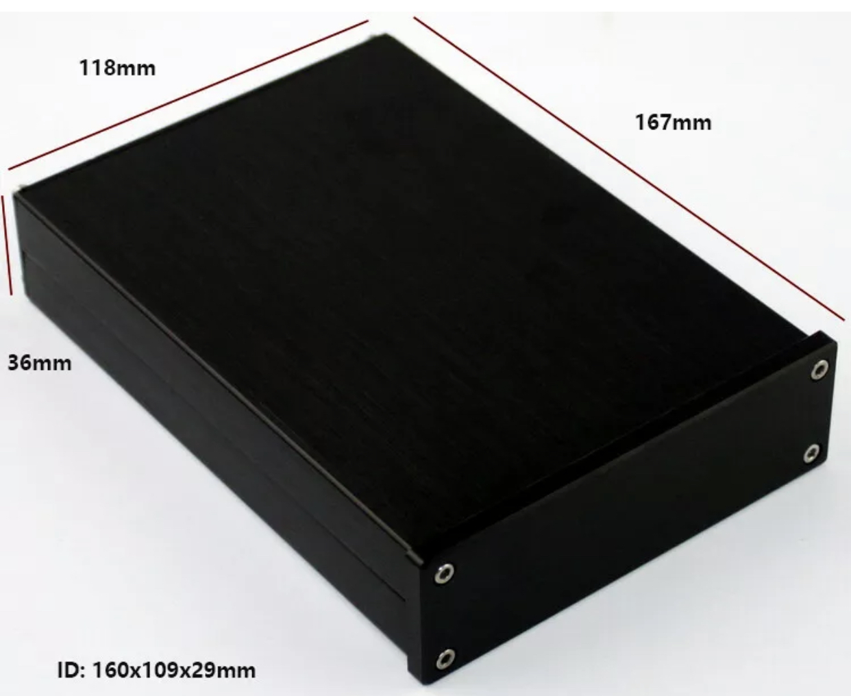

I ordered that box with one extra front panel (thick one) and will use it for my new tacho. It will be vertical standing unit.
Will see how to CNC needed holes for IN-12... Some eBay guys from China promote drilling per customer drowning... Let’s see...
