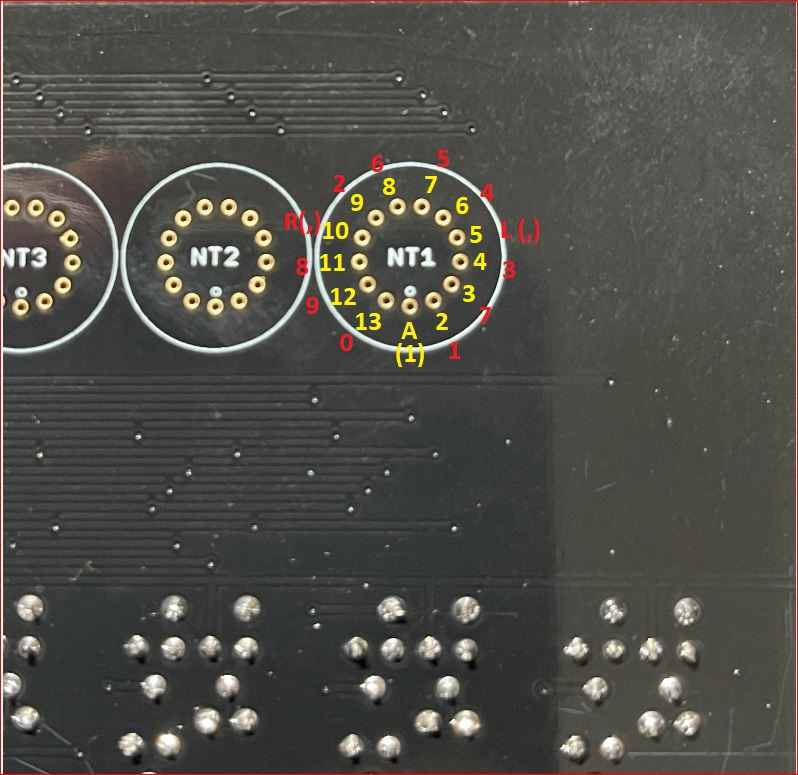

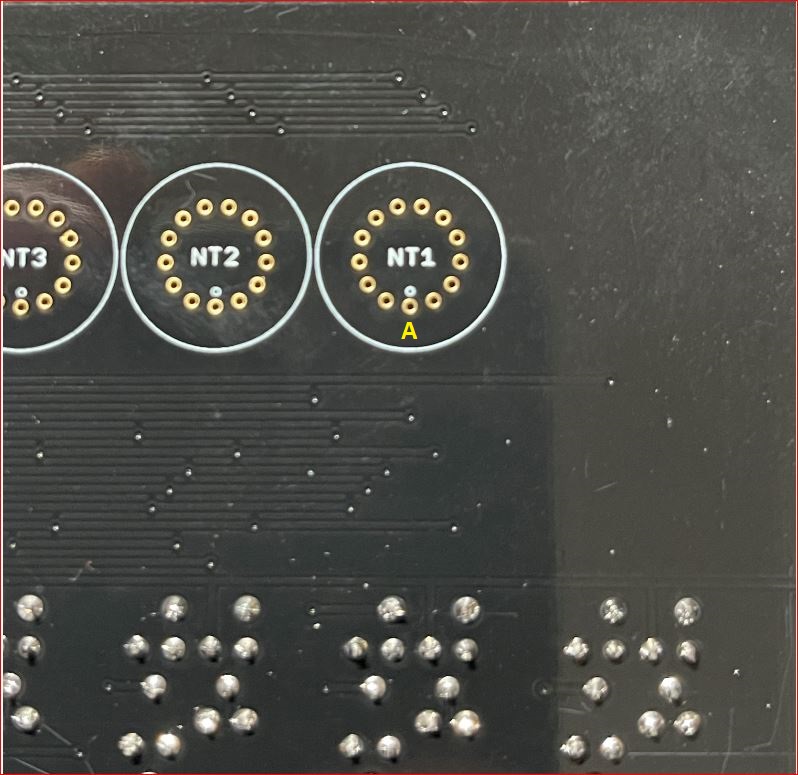

I tried to connect them via pint2point, but I'm totally mess-up with cathodes. Pyramid, can you please help me and mark VIAs on attached image with numbers?
That will make my assy way way easier. 🙂
I have IN-16 style PCB (BTW, I have many of these PCBs made in China Fab handy. Let me know if some of you interested..).
I'm not sure what you are asking; are you using IN12 tubes (or some others) with an IN16 PCB?
If you are using IN16 tubes, align pin 1 of the tube (the only one with white insulation at the base inside the tube) with the index mark on the PCB (marked 'A' on you pic).
If you are using IN12 or other tubes with the PCB, pin 1 is the index mark and the pin numbers increase as you go CCW from there; the schematic shows which pin # controls which cathodes:
Pin #
1= Anode
2= Cathode 1
3= Cathode 7
4= Cathode 3
5= Cathode Left Dec Pt.
6= Cathode 4
7= Cathode 5
8= Cathode 6
9= Cathode 2
10= Cathode Right Dec Pt.
11= Cathode 8
12= Cathode 9
13= Cathode 0

Hi Pyramid,
Thank you a lot. This is exactly what I need.
Just for reminder, I'm using 7779 (B4032 BURROUGHS - the smallest Nexie ever made) with IN-16 sockets setup PCB. I updated my image with your info, so it will be easier for people who is using "remote" tubes on IN-16 PCBs.
It worked out. All tubes dropped to sockets and connected trough wires based on the above diagram. Now I need to box all that together with Arduino. Hope, it will be one small box.

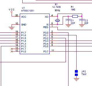

I am thinking to breadboard, later today a single uP and check if it initiates the test procedure along, without supporting parts, just the xtal caps and Vcc.
Something like the attached cropped image from the schematic.
The uPs kindly prepared for me from Steve in UK and remained in their package until some days ago when I finished the built.
Bad luck or a fault in my built that we have not discovered yet?

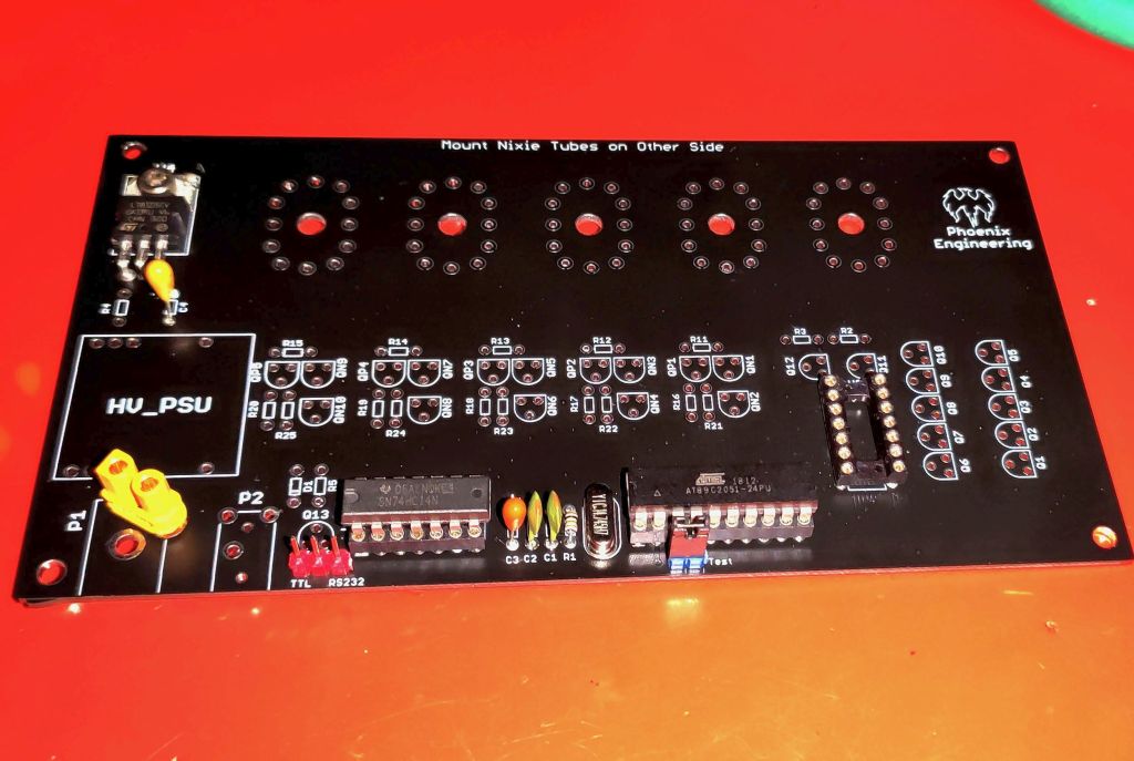

I have a new built as of the attached picture, C1,C2 are 47pF, that I had available C3 1uF and C4 2.2uF.
With U1 and U3 installed as in the picture, U1.p6 remains at 5V and U1.p1 comes up to 3.5V and then drops to 0.9V then jumps to 1.2 and drop agai many times.
After some on-off cycles of the breadboard, now the U1.p1 initiates at 3.8V and remains stable at 4V
Something is definitely not right. U1 pin 1 is pulled low internally through a high value resistor; C3 provides a temporary 5V pulse when first powered up to provide the active high reset signal, after that, it should go low and remain low (<1VDC).
Check that you have 5VDC at U1.p20 and 0VDC at U1.p10; also, all pins are making good contact with the socket and the socket is soldered correctly.
You have 3 processors, correct? Are all 3 doing the same thing?
Also, check the polarity of C3; the positive side should be connected to 5VDC (Vcc) and the negative side to U1.p1.
