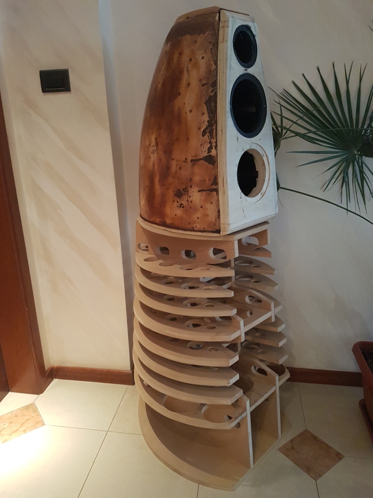

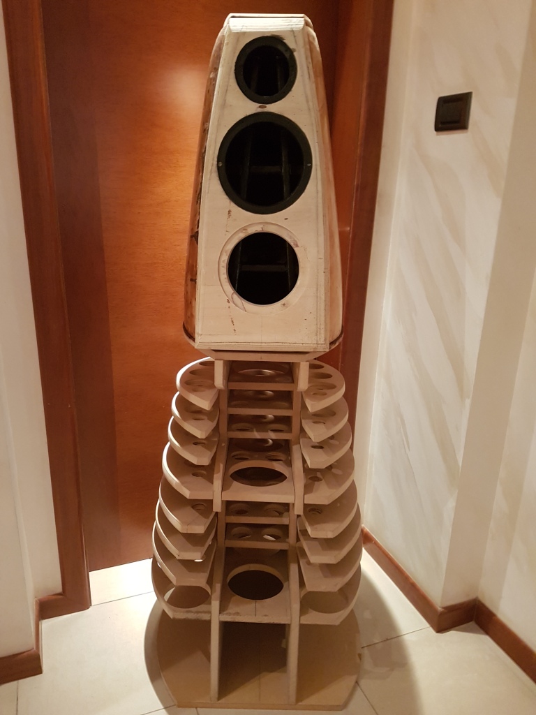

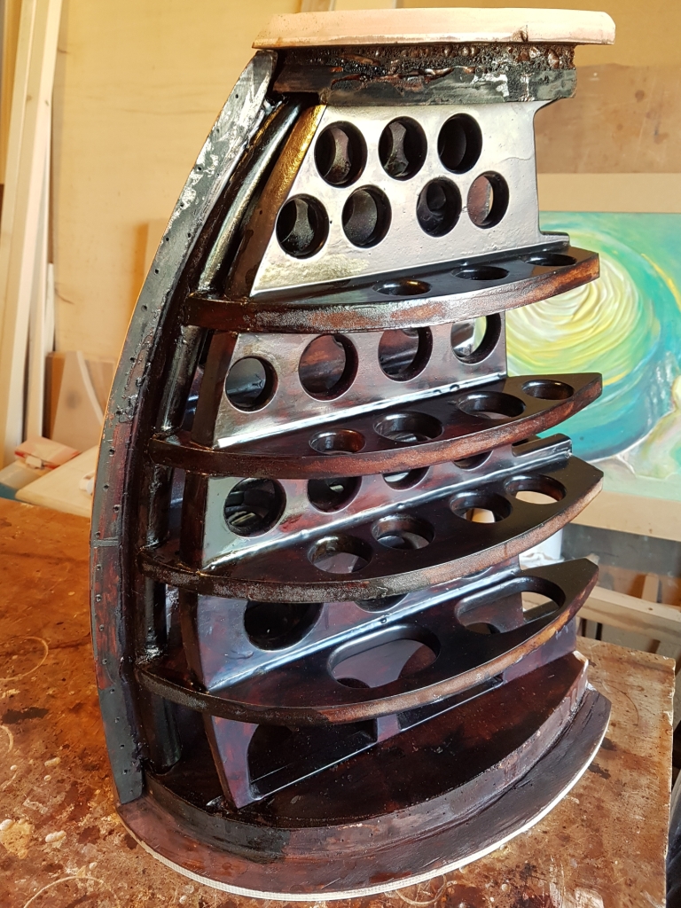

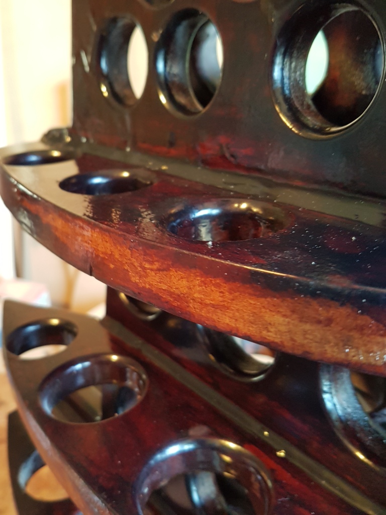

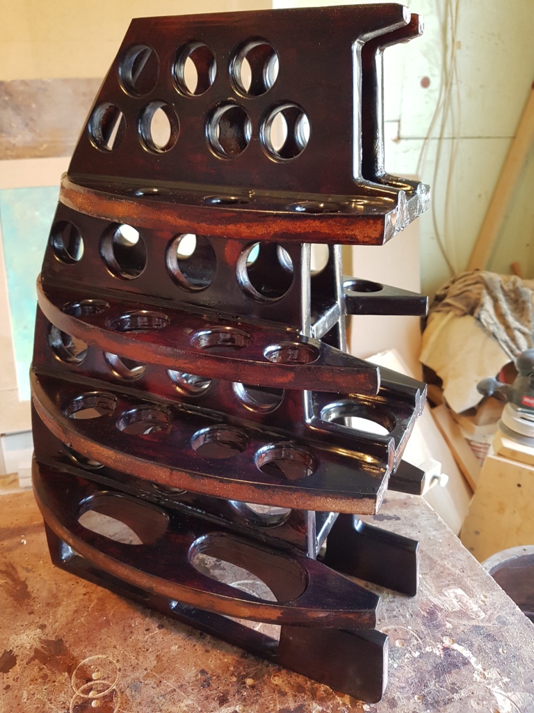

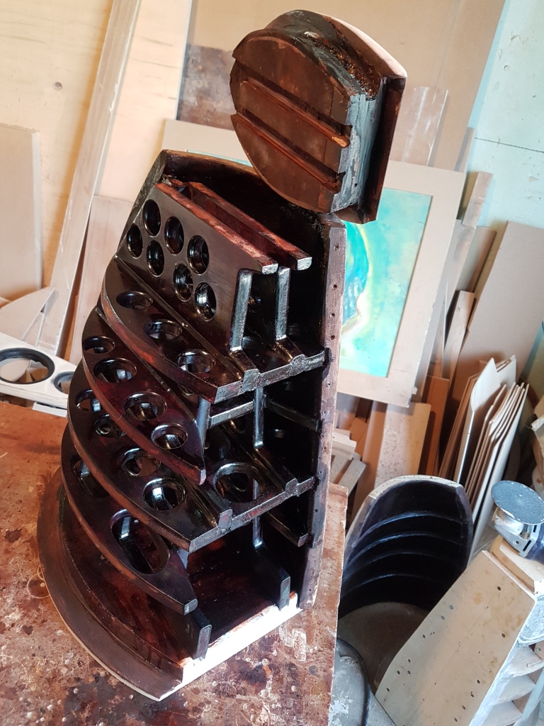

Preprocessing of the internal ribbing;
I can now start collecting the cabinet;

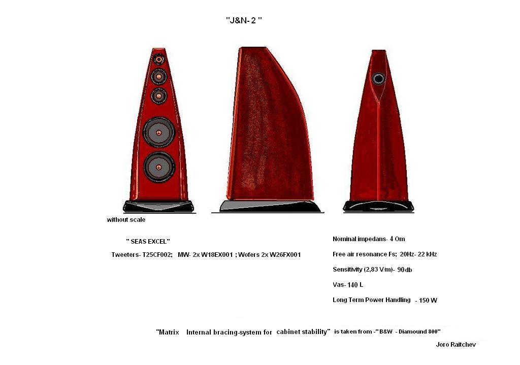

Why two midrange drivers?
I think everything is explained in post # 74, but you may not have come to it.
So, especially for you;
SEAS Excel W26FX001has a sensitivity of 87 dB / 2.83V, m /
2 x W26FX001= 90dB, 1x W18EX001 has -88db, that is, at the one same level of volume amplifier, we will have more bass and we will not have enough environments. For this reason, I even wonder if I cannot change the highs with
T29CF002.
T29CF002.
Shouldn't baffle step compensation require that woofer sensitivity be higher vs mid/tweeter?
http://www.diyaudio.com/forums/mult...vity-versus-woofer-3-1st-post.html#post987350

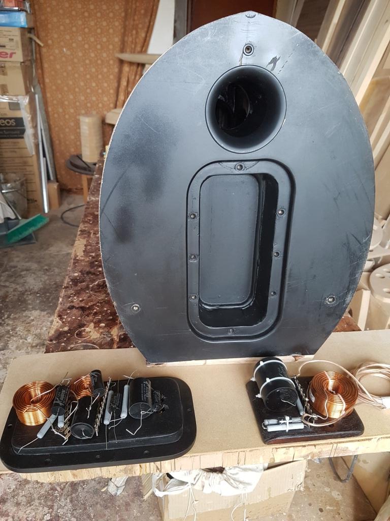

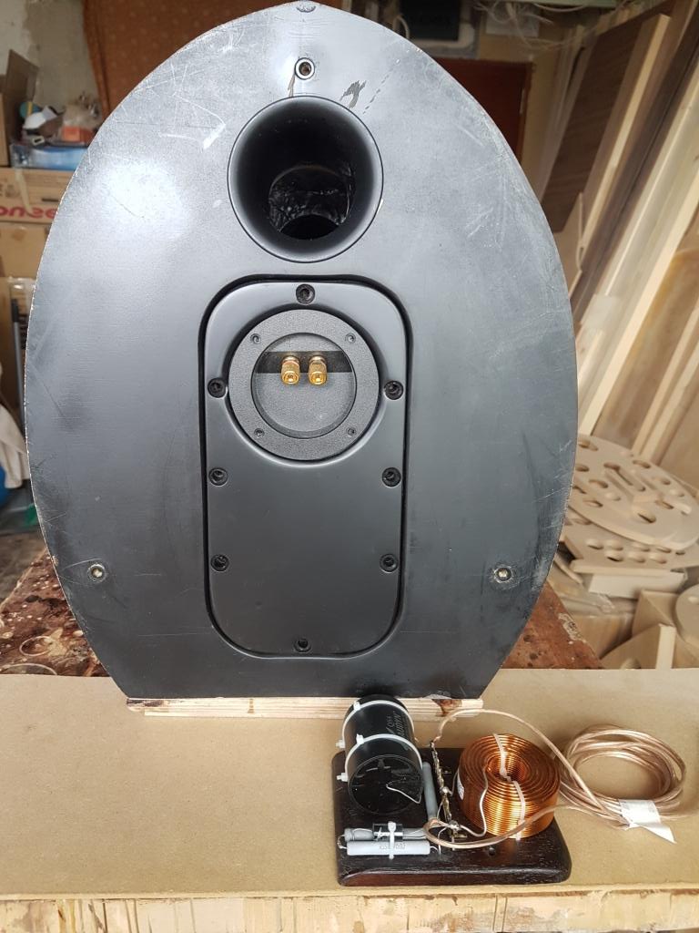

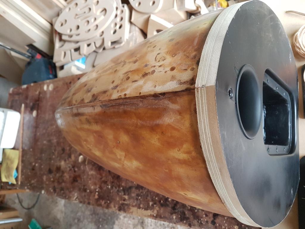

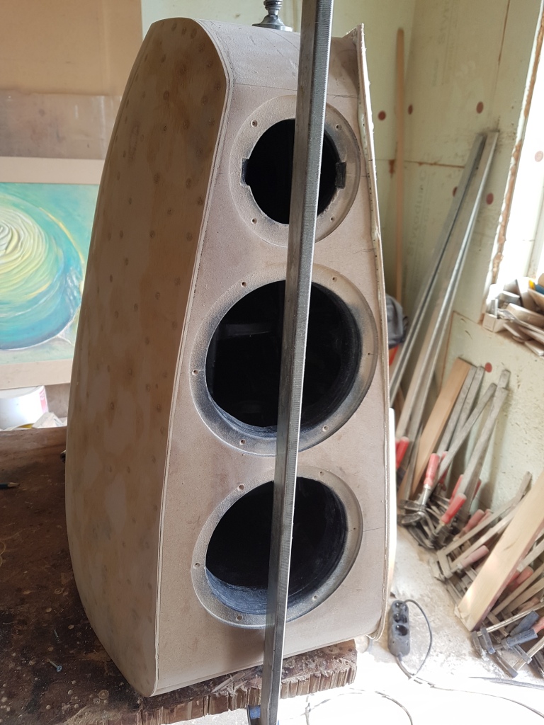

continue with the collection of the cabinet;
Now I can make the exact measurement of the volume
And that's 31.5l, just as much as I need!
Oh, l forget to show you what I did to get that volume!
I maked a filter compartment (for the MW and TW), the W section will be in the box;

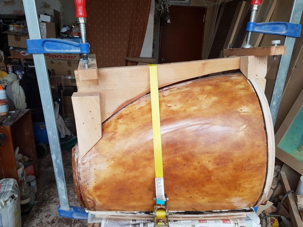

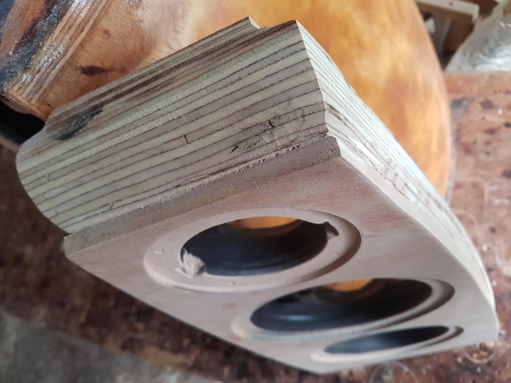

previously make the last layer-10 mm MDF / to get a sandwich construction / on the front panel and the bottom;
Last constructive action ,I will install the last layers of 2 x 4 mm bent MDF.
