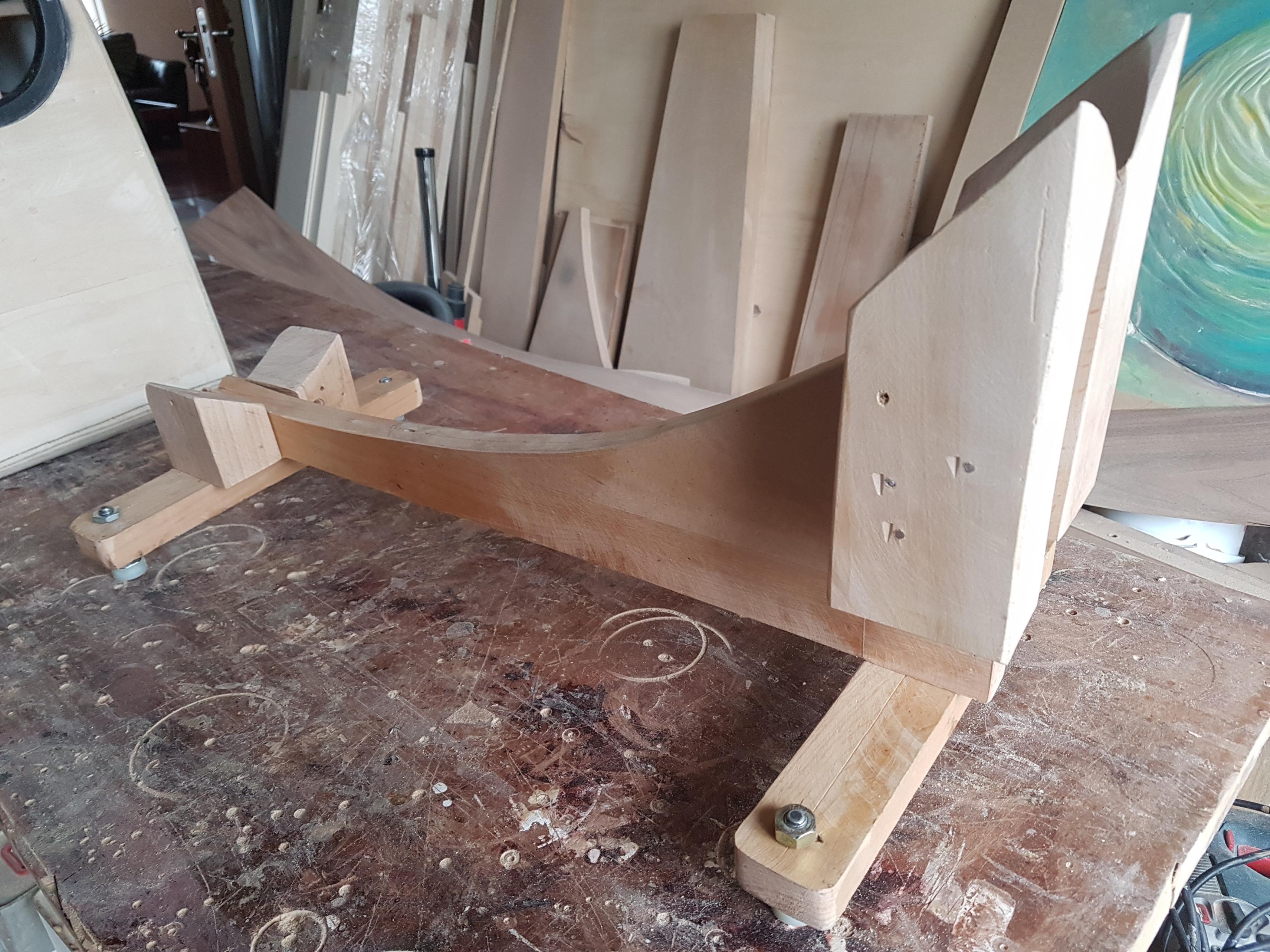

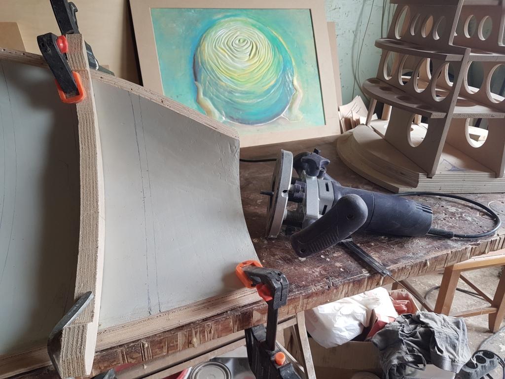

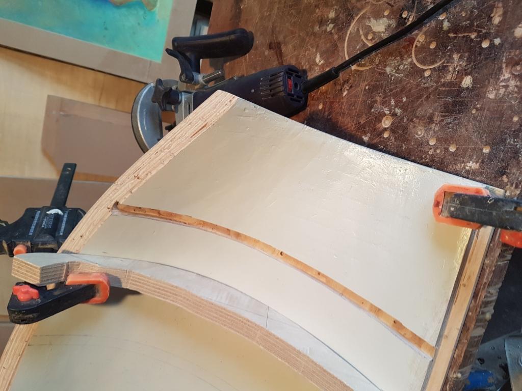

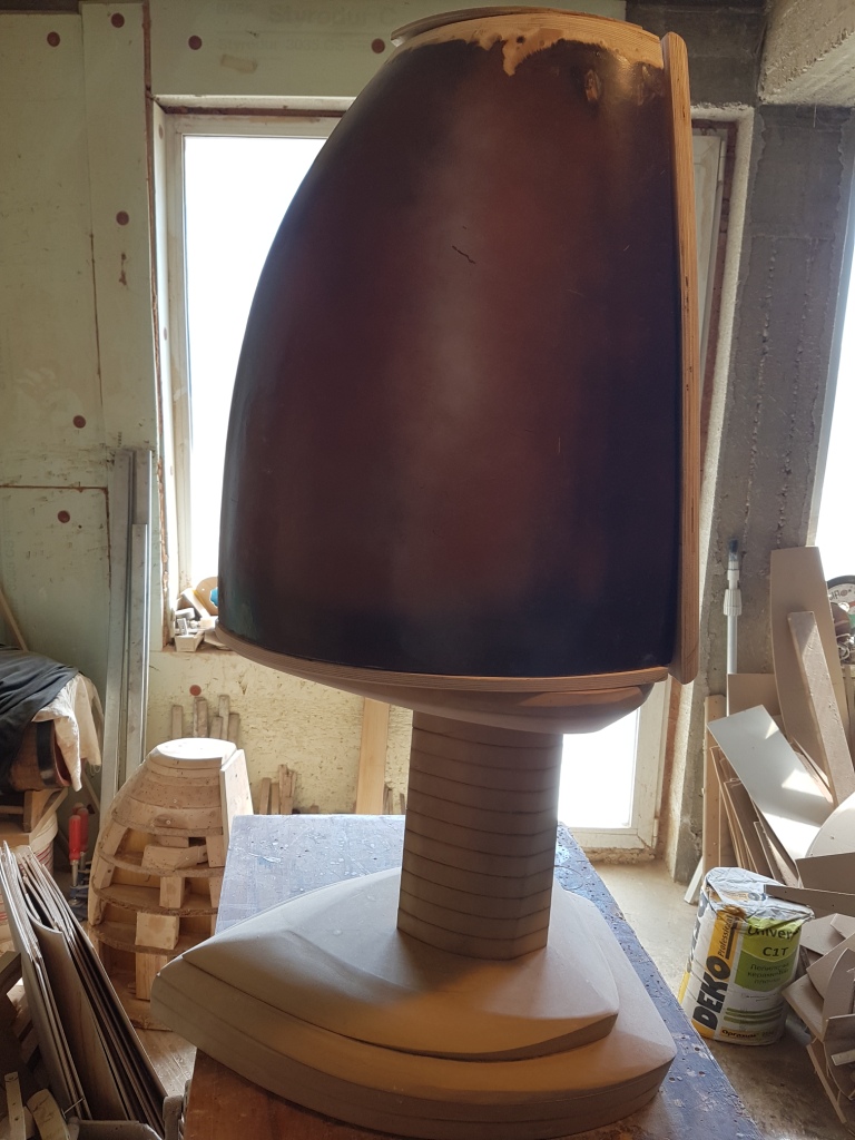

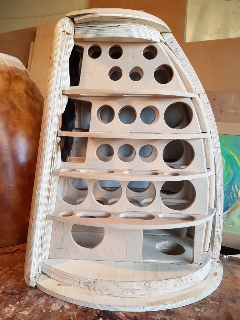

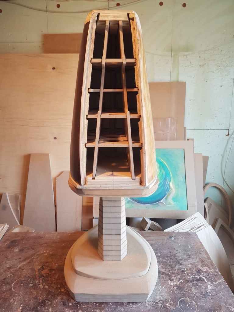

How did you bend these curved plywood boards? Or did you build them up from several layers of veneer that you bent around your bracings?
Best regards!

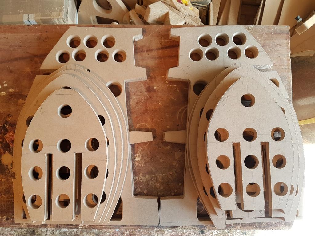

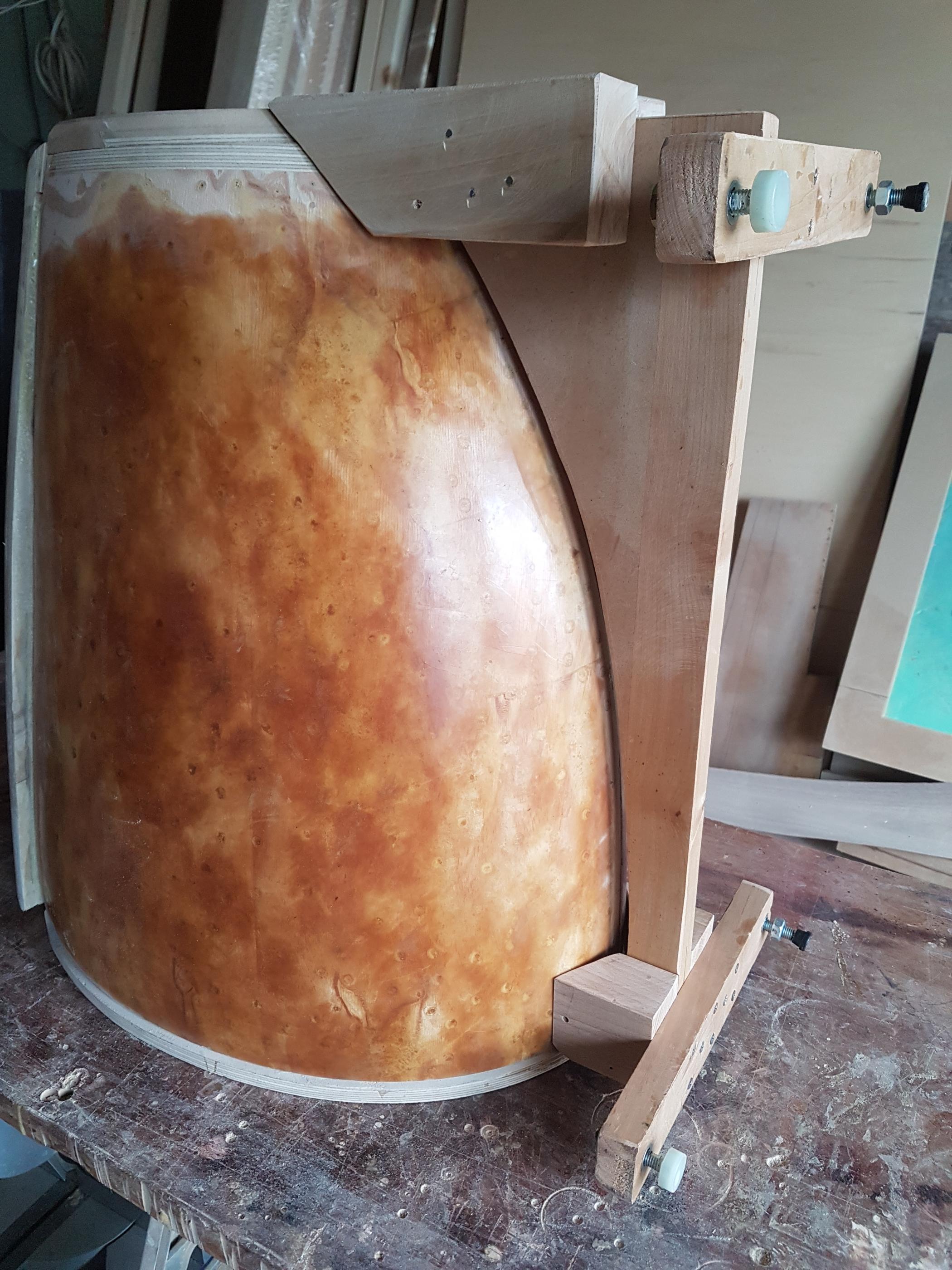

Correct "plywood boards",7 layers -4 mm thickness, curved on a matrix/ my work/

Nitrocellulose Laquer sprayed or brushed on will give you a finish as nice as that as well. It may not be as durable as an automotive polyurethane clear coat but it is much easier to obtain a glass like polished finish. Once you feel you have enough coats polish it to the glass like finish with something like 3M polishing compound. I used a Nitro Laquer on my guitar and it looks every bit as good as those speakers.
A speaker may not need to be as durable as a quitar since you don't bounce around on stage with a speaker. The other nice thing about lacquer is that spot repairs are easy. Lacquer melts into itself. If a small nick occurs lacquer can be painted on with a brush and then buffed to a polished finish that will be homogenous with the lacquer around it.

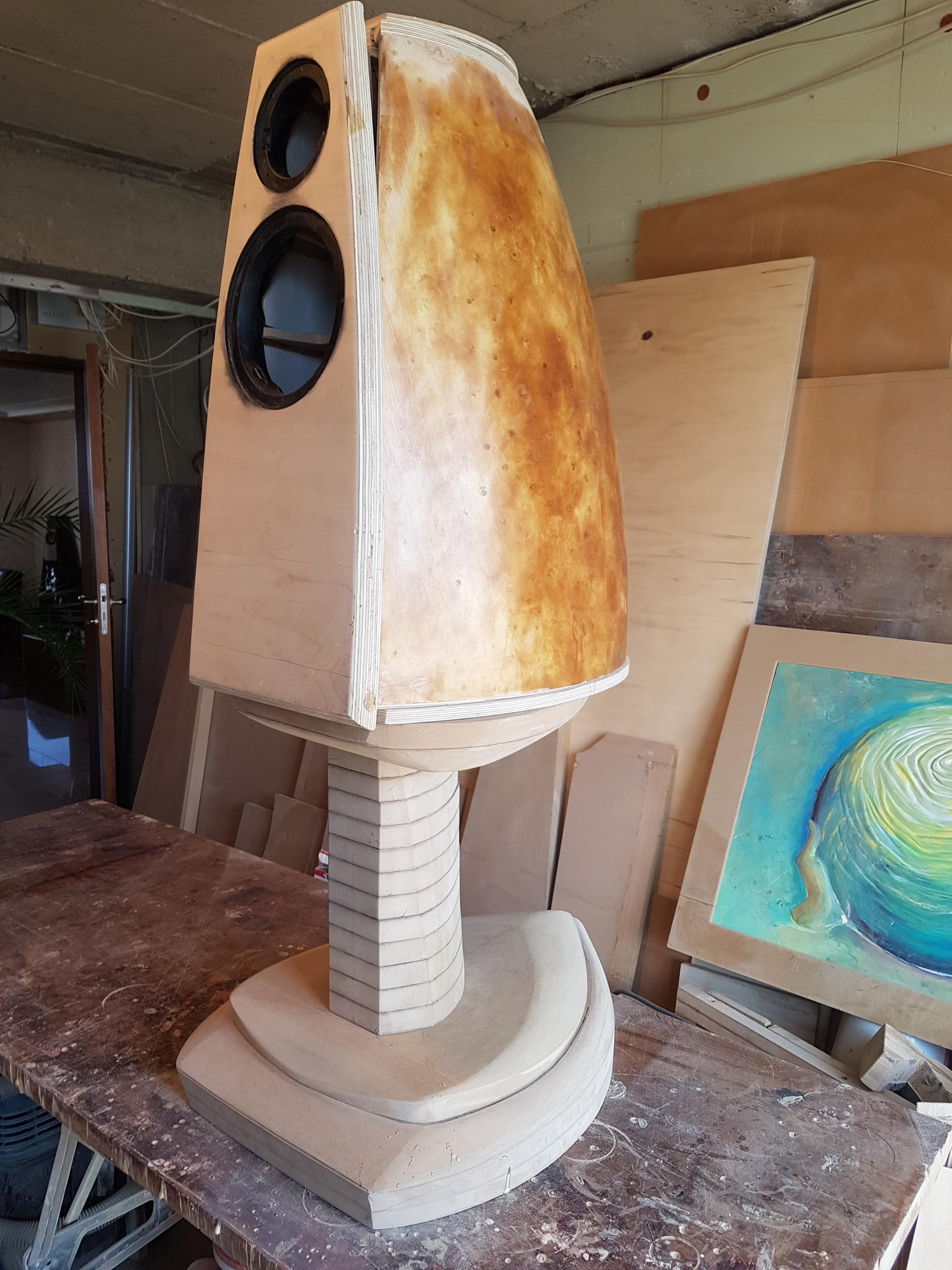

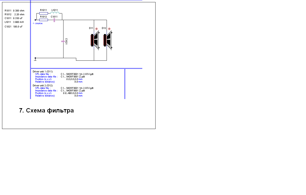

Why and how should a beautiful project be changed at the outset?

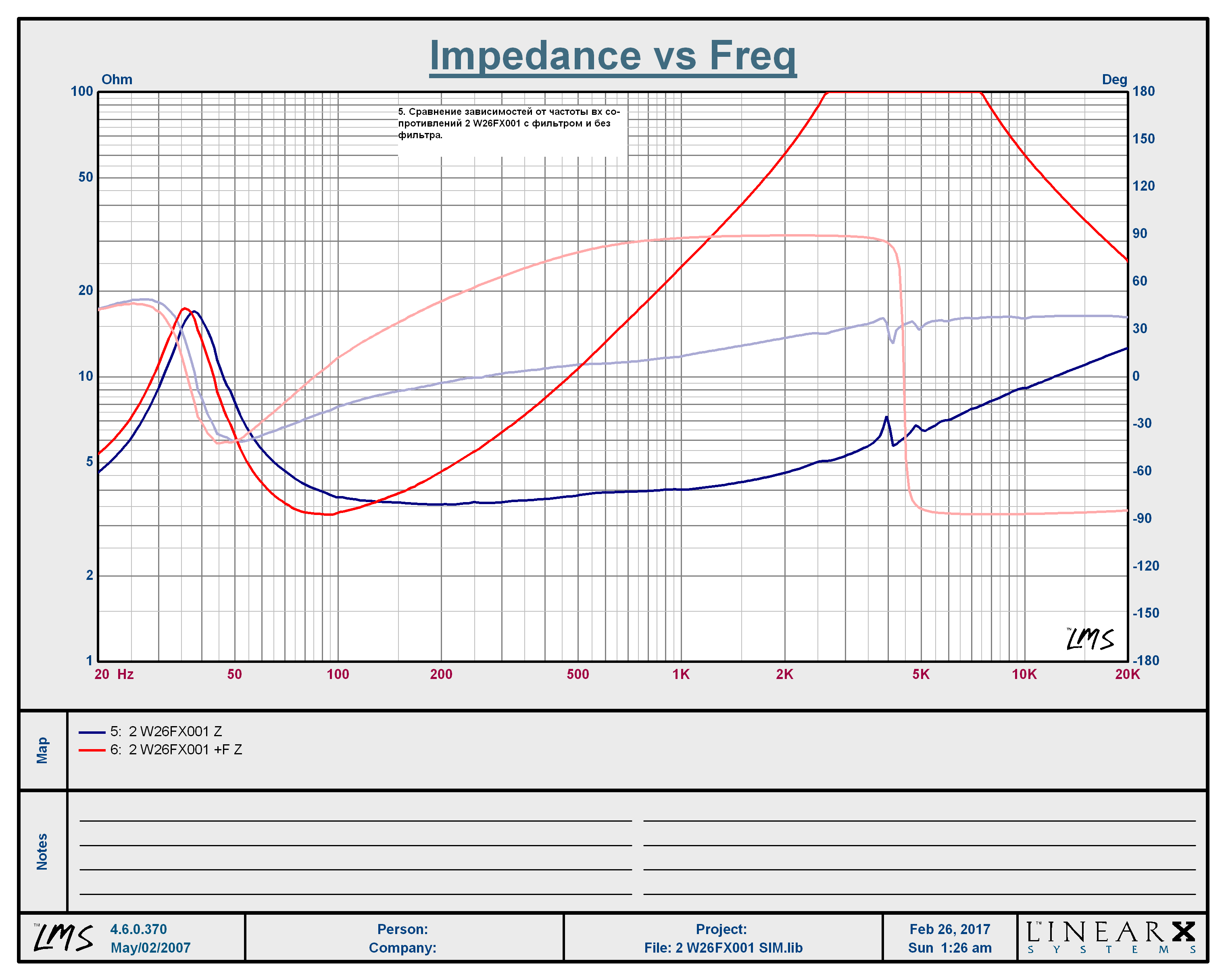

The problem is in the frequency of around 5000Hz; There is a peak ,which strongly influences the average frequencies.There are two ways to solve this problem:
- Adding one more MW,
-More complicated construction of the filter I don't know the exact name , maybe (reager).
This project may be look beautiful, but will be changed.
As I wrote at the beginning of my post, everything is done by me, I do not use ready filters / and I do not recommend it to anyone unless it is a ready-made kit with cabinets /.Will try to explain why this project is changed at the very beginning.

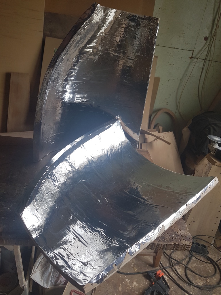

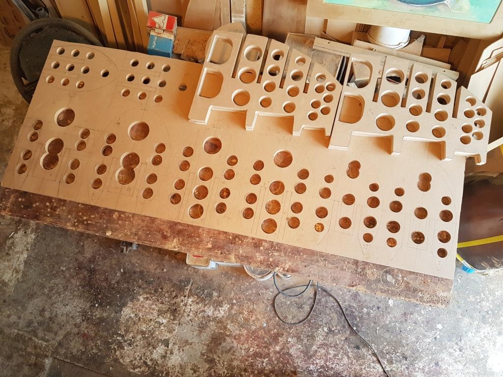

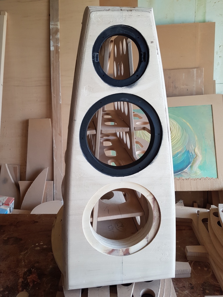

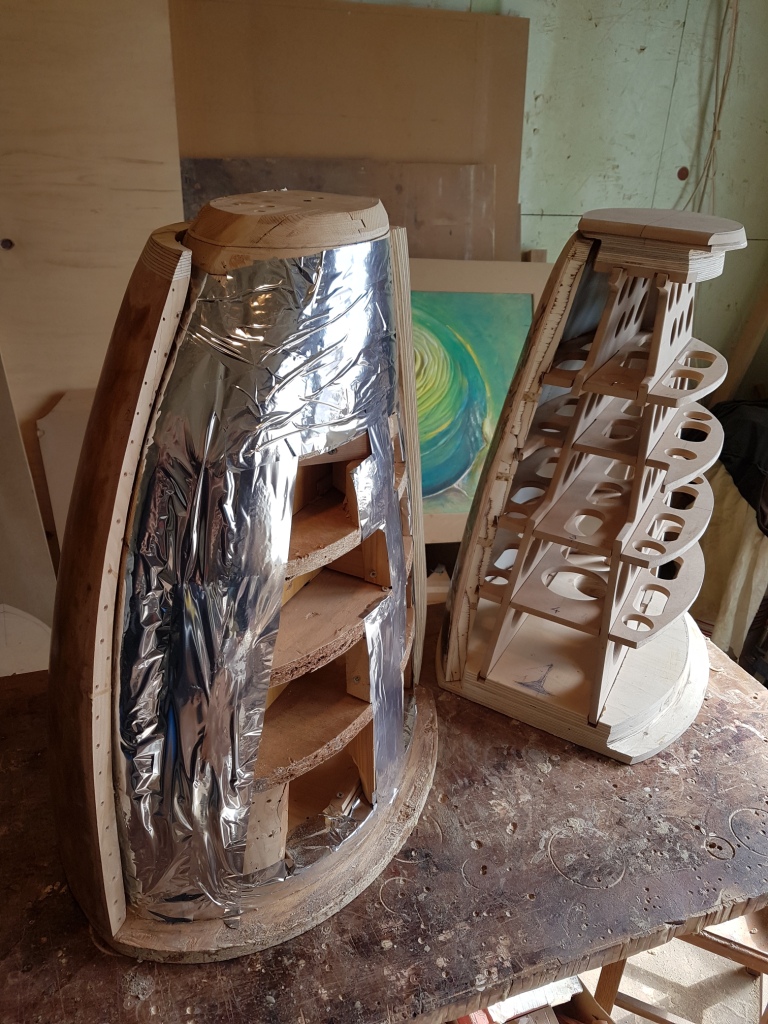

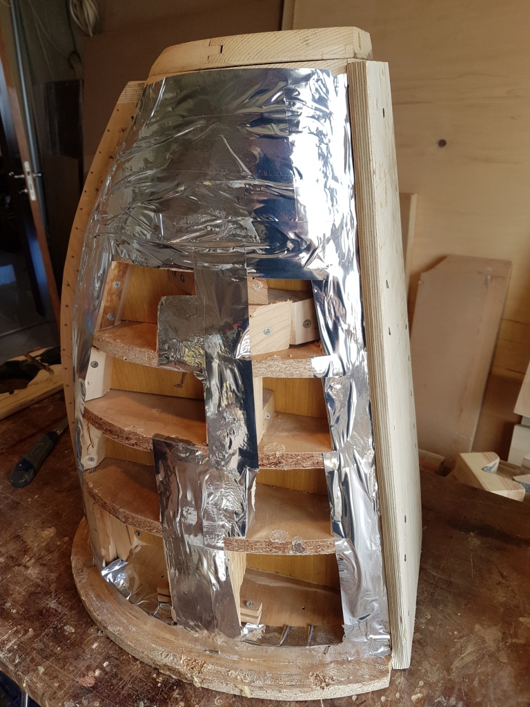

Beautiful cabinetry.

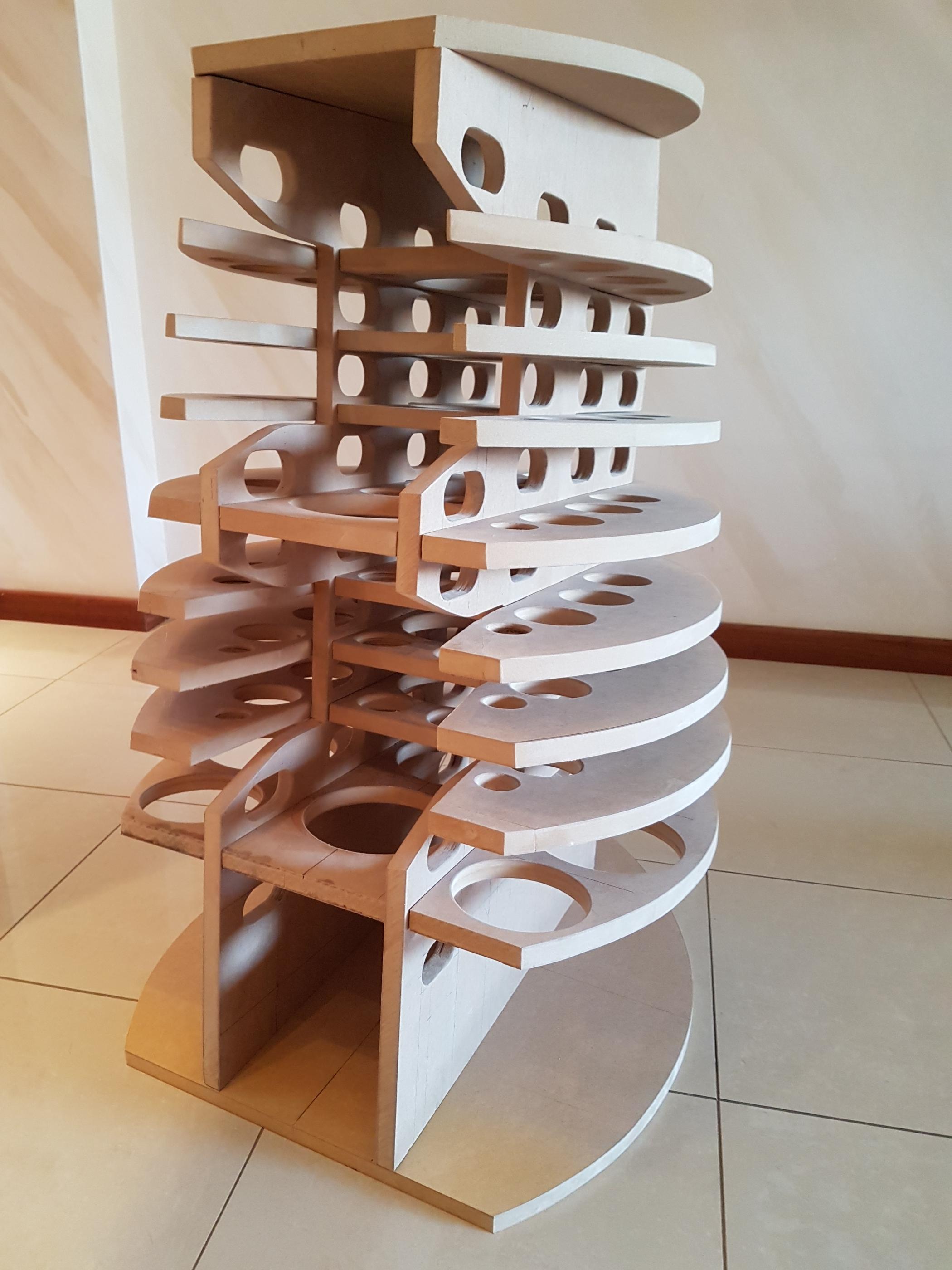

The name of this construction from "B & W" is:
"Matrix Internal bracing-system for cabinet stability" ,
I will use my term- "Ventilation".
Accept this term as a metaphor of a vented inner structure of cabinet , / I will say in a different way /, has the task of preventing the column's own sound and participating in the design proces.

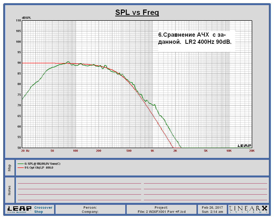

that peak at 5000 Hz looks like the breakup of the woofer. You don't need to start over, just crossover to the tweeter well below 5000 Hz
I think this peak will cause me problems at mid range frequencies. At the Tweeter , everything is clear.
I can make a reflector filter frequency filterrefiner filter, but what happens to the natural sound?

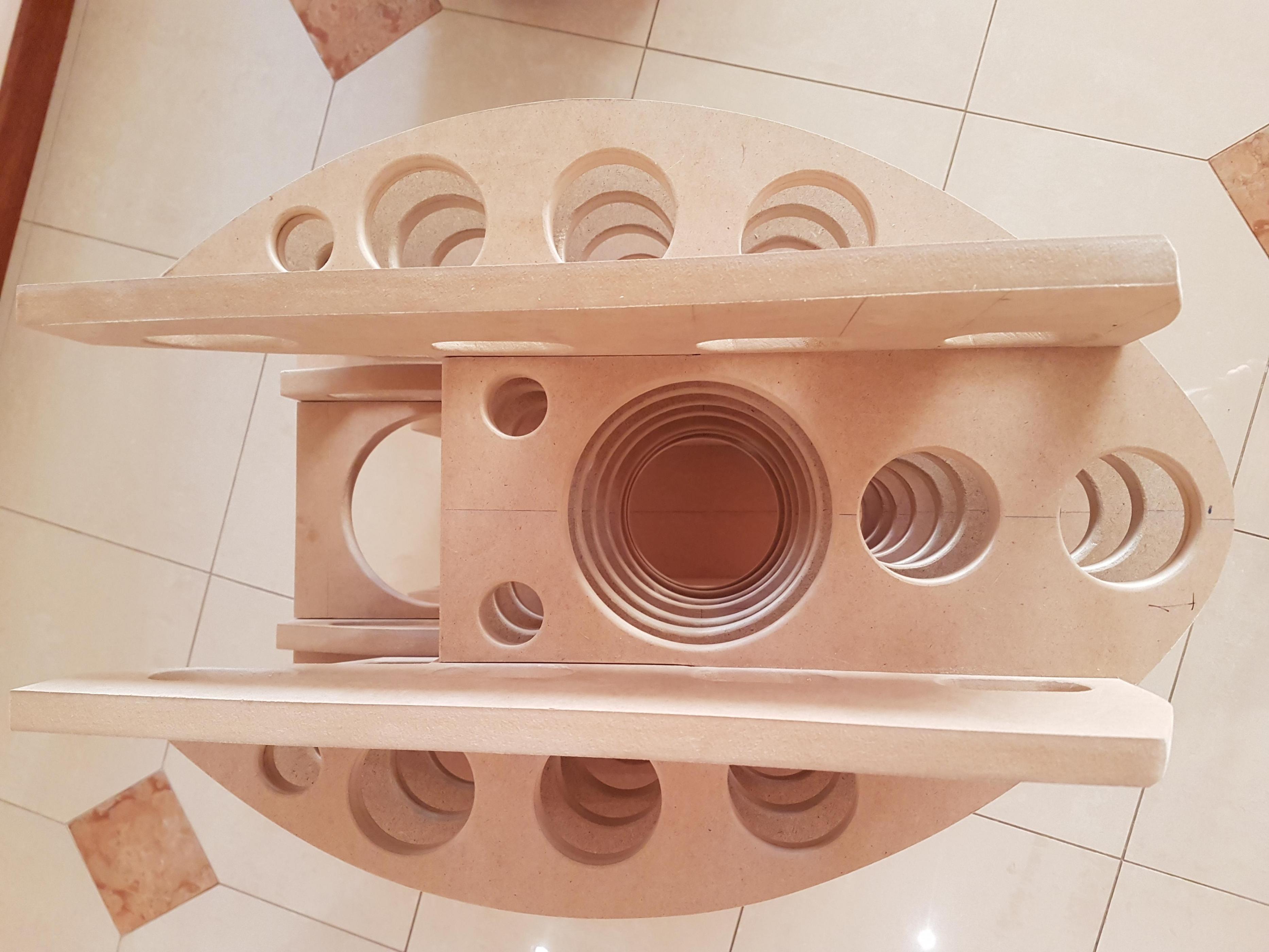

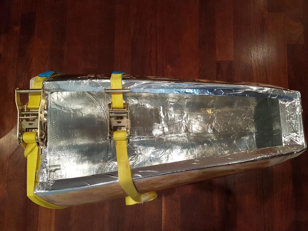

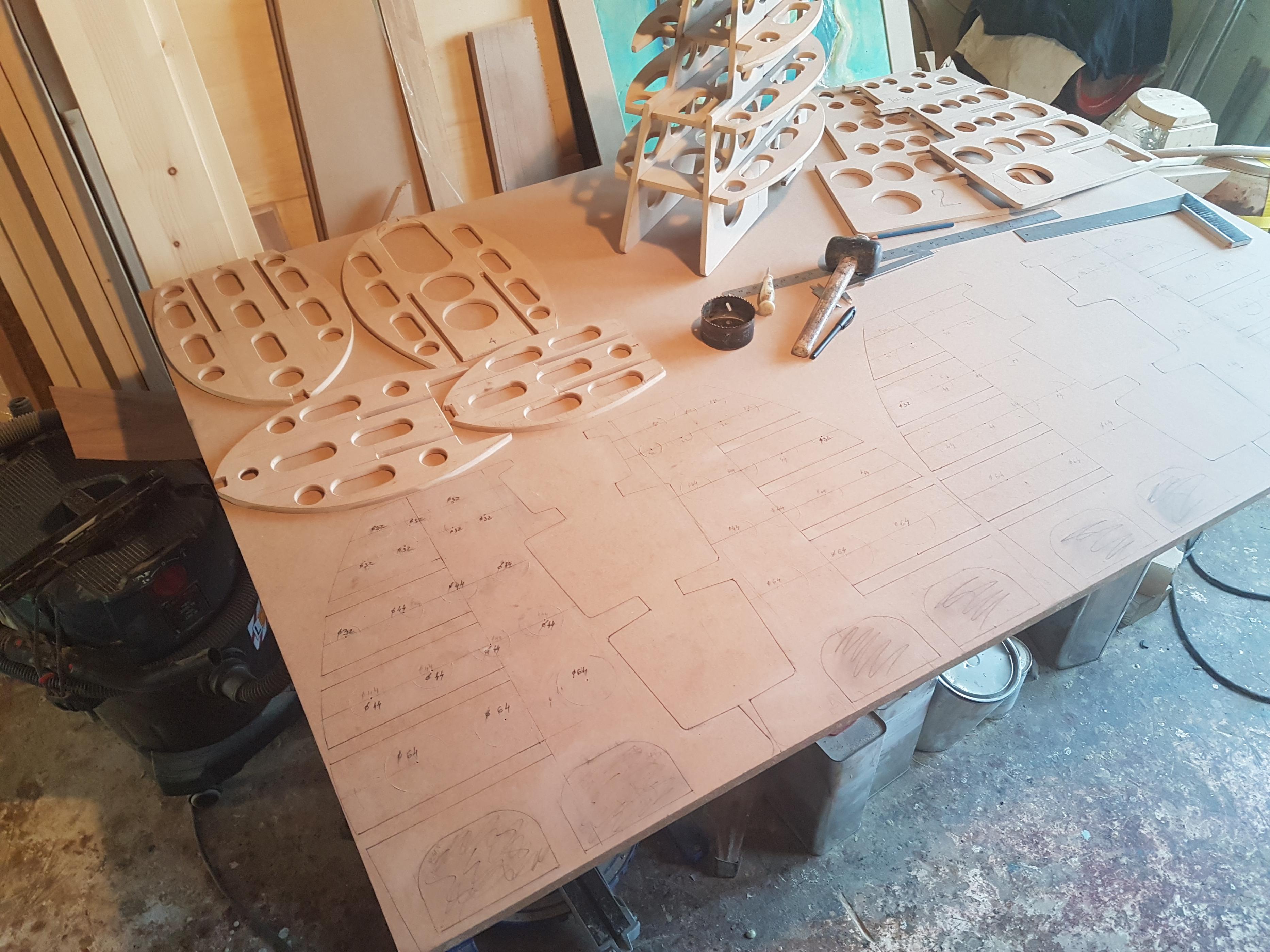

However, we reach the point where we have to measure the internal volume of the column. I am registered in more than 35 "DIY" sites and when I am asking the question , how i was made it - whether I have the right answer?

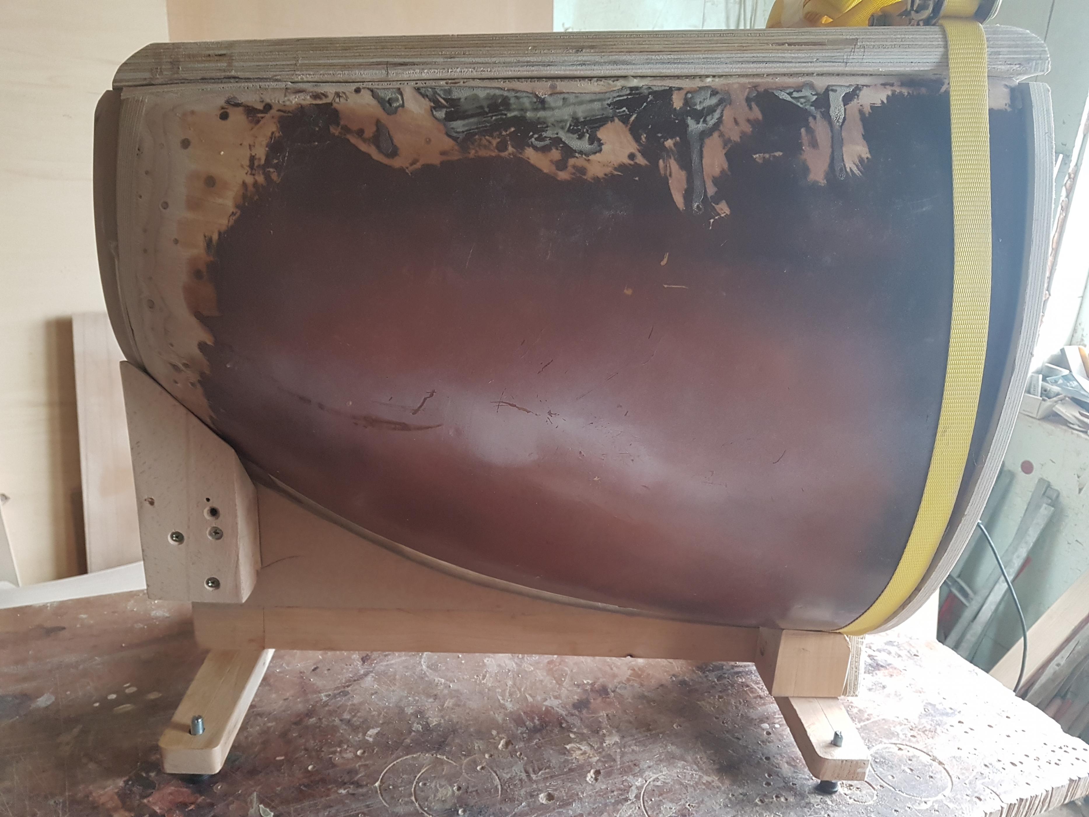

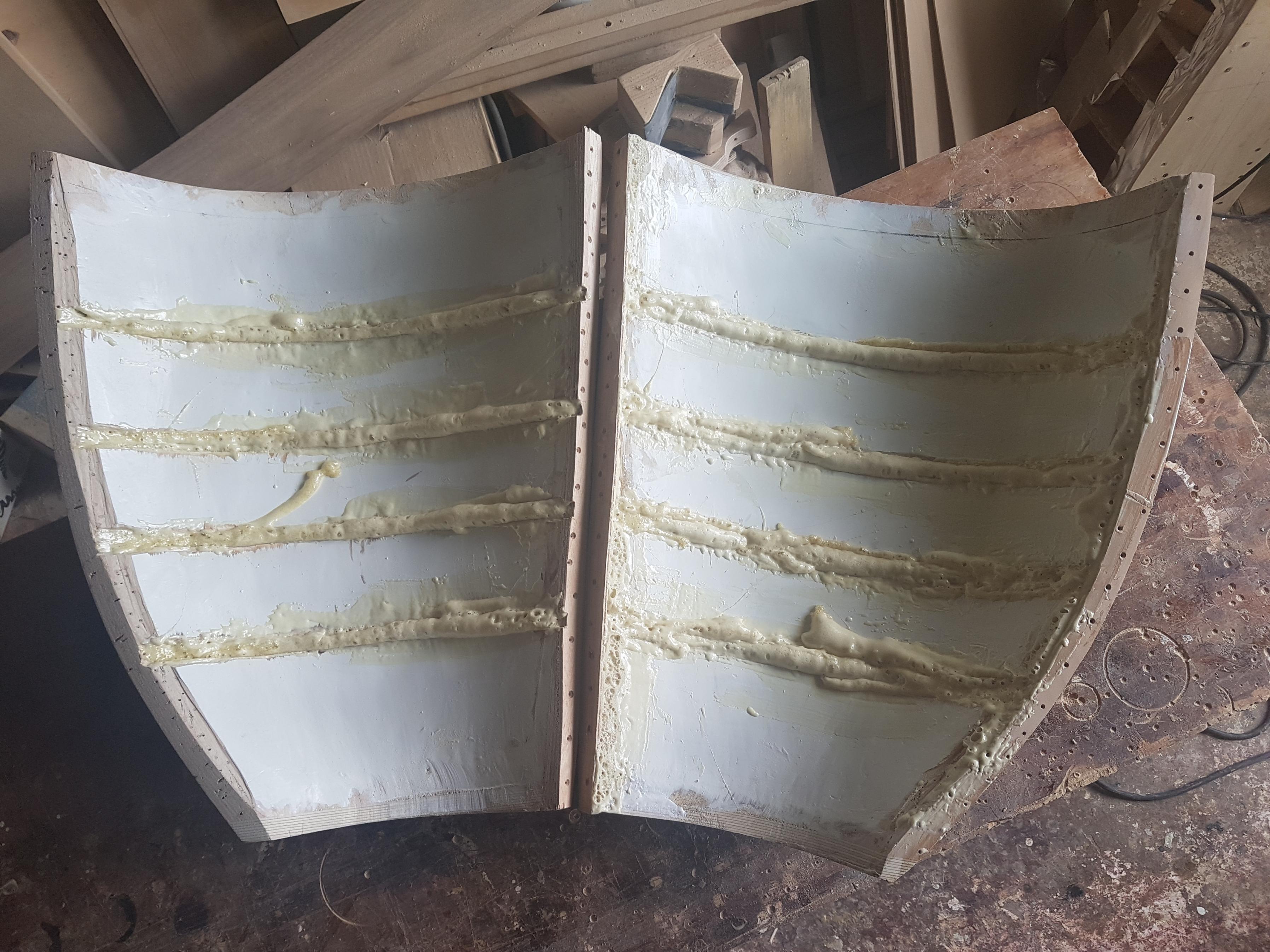

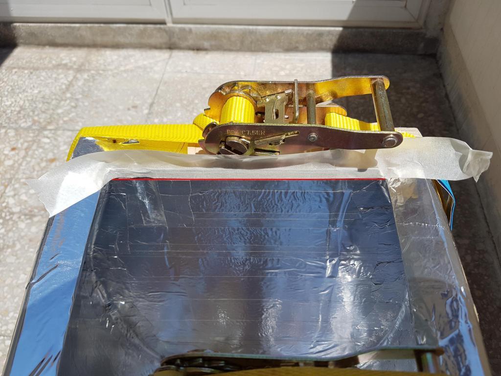

From waste material I made this gadget ,that takes part in the measurements and when assembling the cabinet:
Continue:

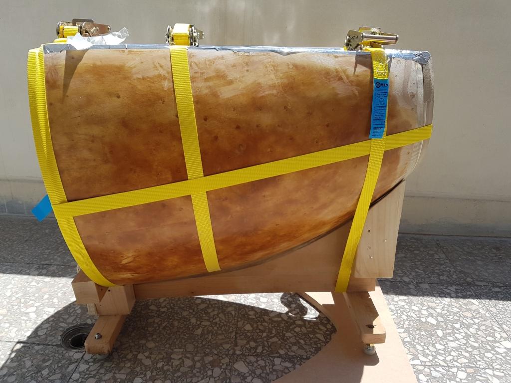

I fill the cabinet with water to the red line / there ends the front panel with the speakers /.
I find the volume - 43l, I deduct the weight of the internal ribbed - massa 3.4kg.
And the net volume of the cabinet is 39. 6l. More than I need, I need about 35l.
