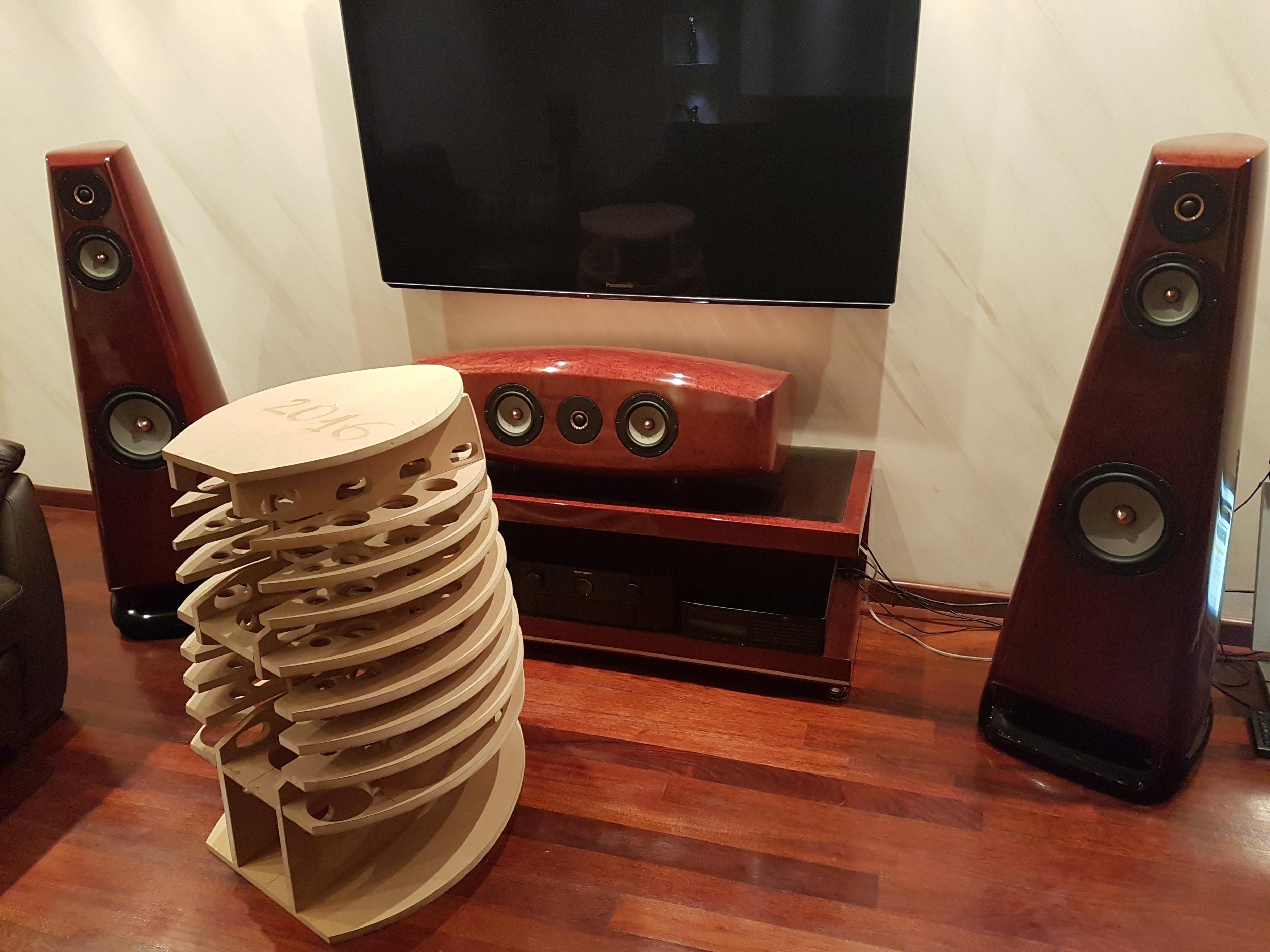

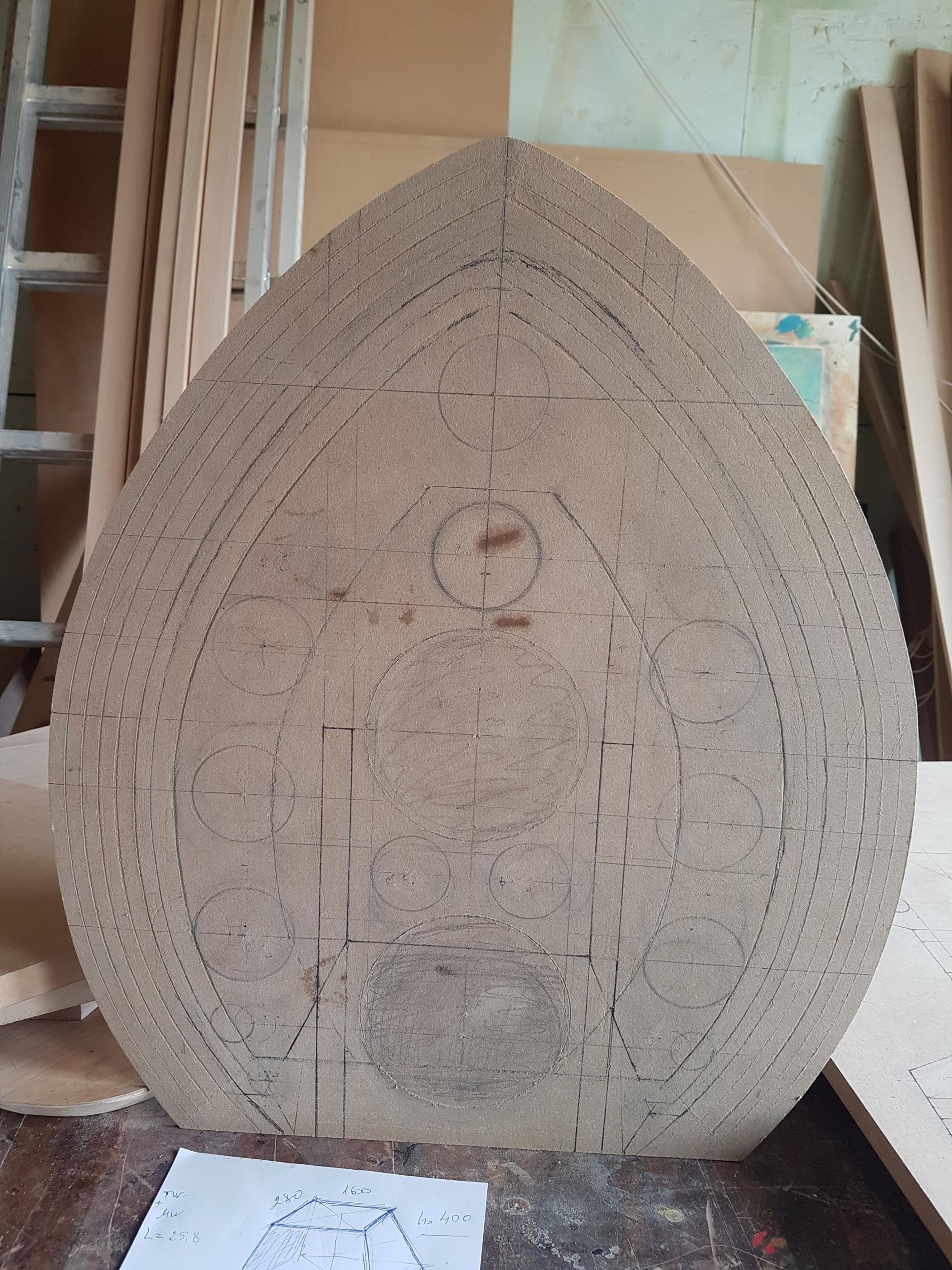

I started working with them in 2009 and finished in 2012.
My projects tend to be a bit quicker but not so pretty.
I start building at 9-00am and finish testing around 4pm !
Very nice work! You said spray on finish? What type are you using?
Thanks for the good evaluation!
Auto acrylic varnish, high scratch resistance and UV protection. The last thing is done is polishing with polishing paste 3M- numbers from 1 to 3.
I have used Italian, Spanish varnishes, but I'm most pleased with the Polish. American products can hardly speak / for obvious reasons /.
Regards!

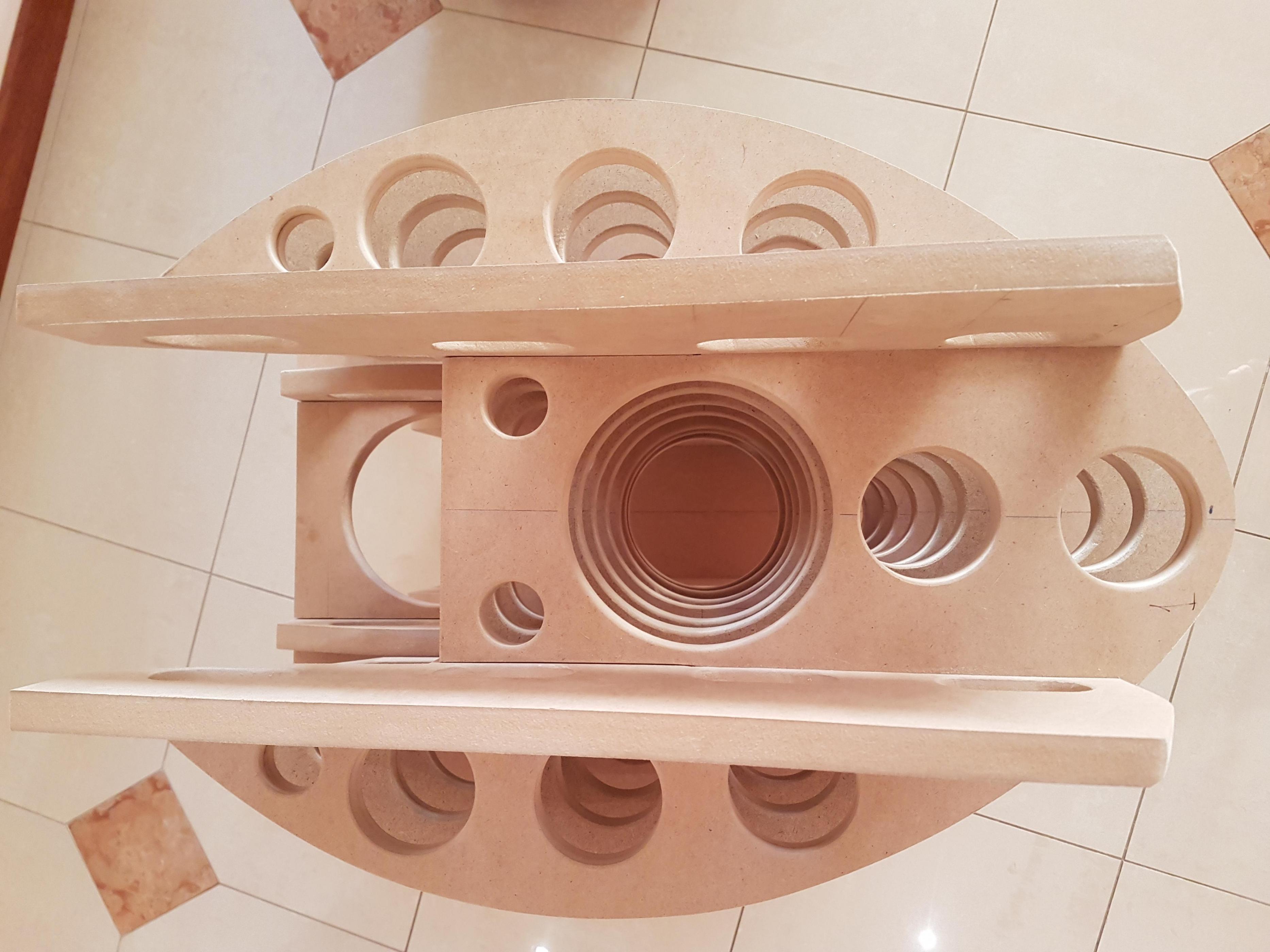

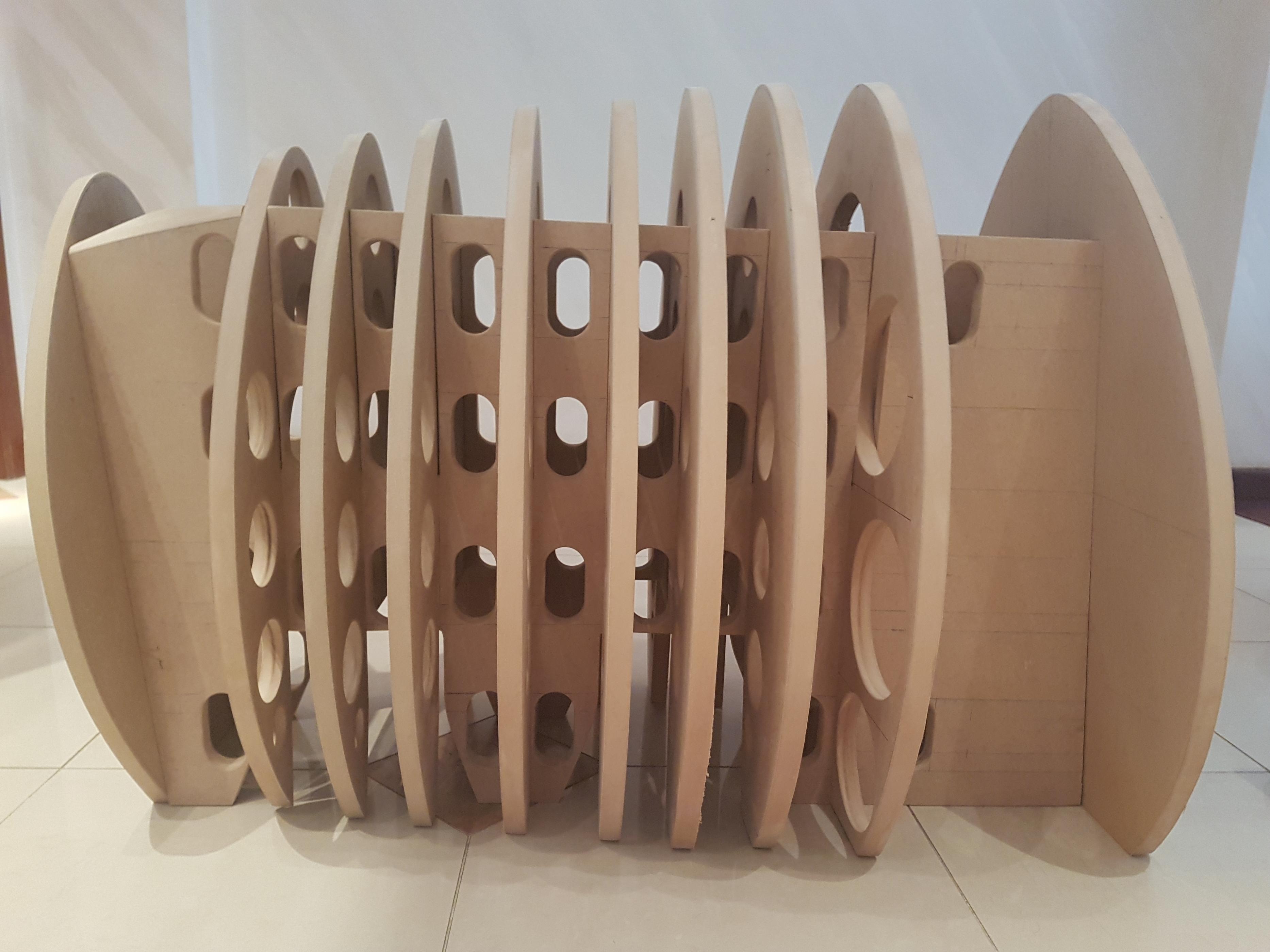

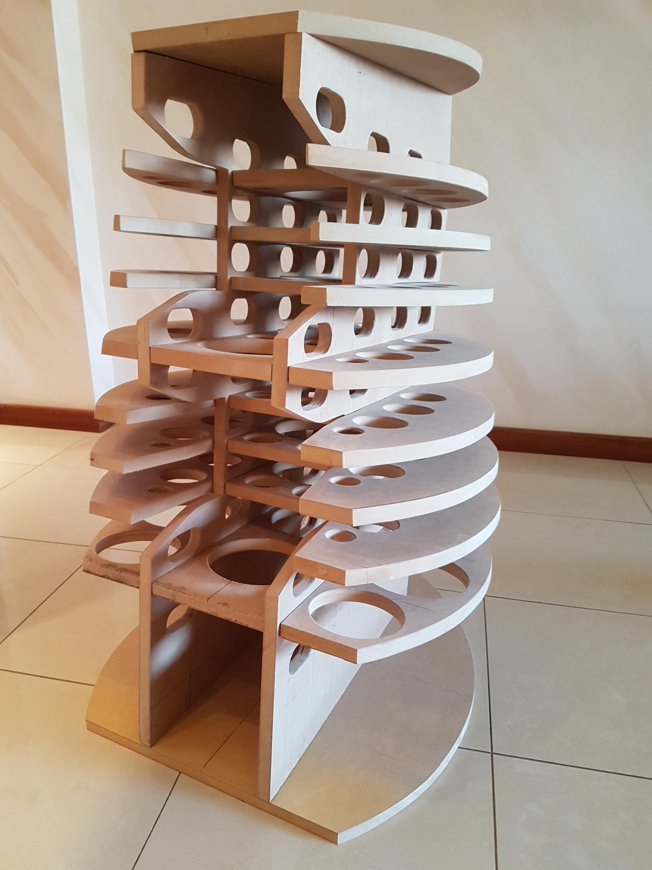

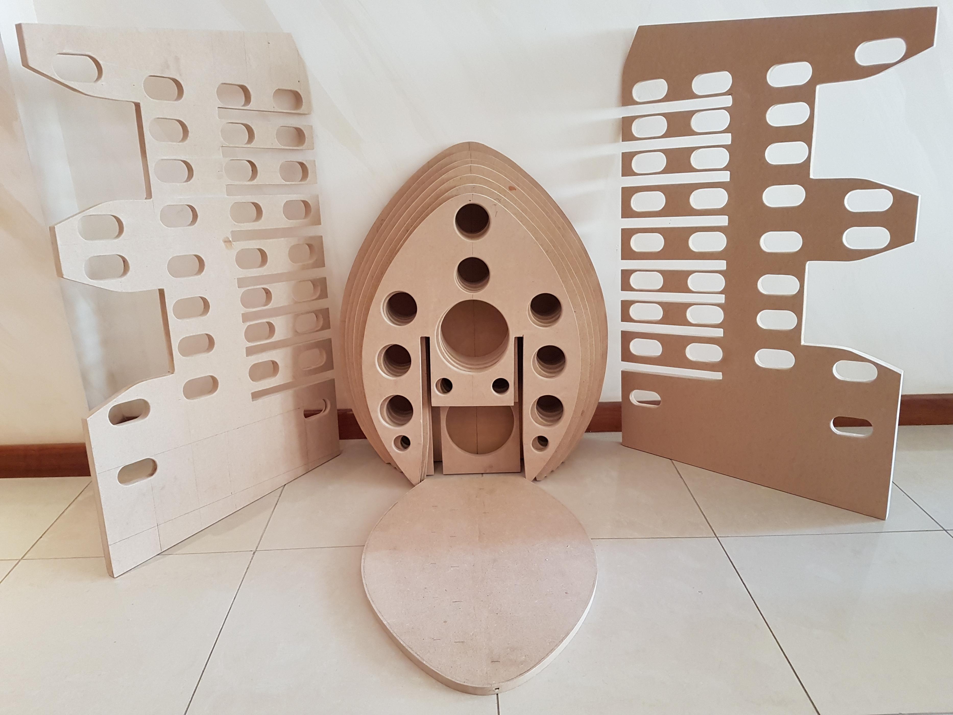

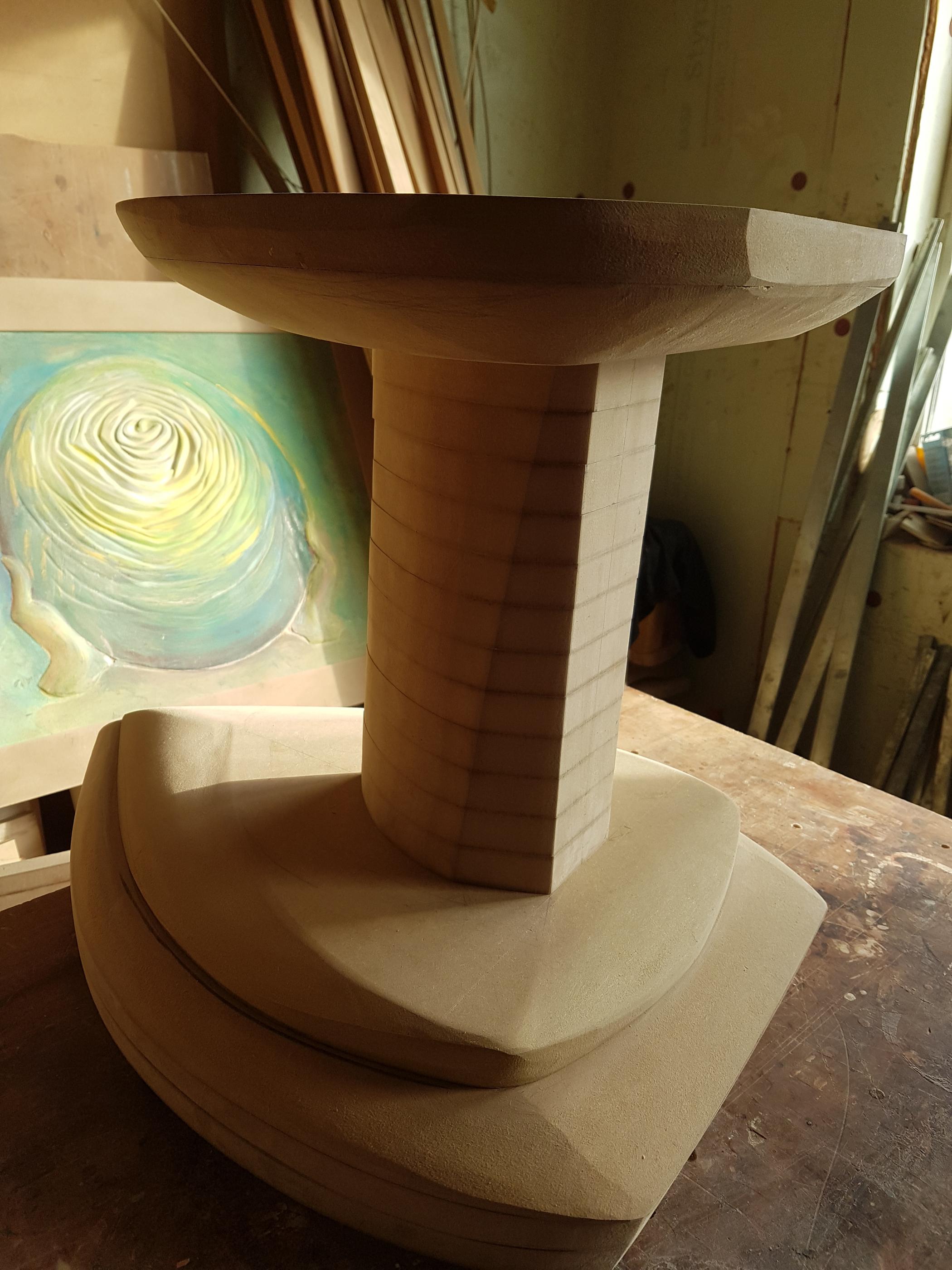

The internals are a work of art in themselves.... It could look rather cool with a transparent outer, though I imagine that would be a challenge! No idea whether acrylic or other similar transparent materials would be usable as cabinet walls.... 🙂
Tony.
Tony.
"J&N"
Speakers: "SEAS" Excel; TW-T25CF002;MW-18EX001;W 2x26 FX001
Nominal impedance- 8 Ohm
Free air resonance FS-21Hz
Sensitiviti /2,83V/m/-90db
Eguivalent volume/ VAS-170l/
Long Term Power Handling-150W.
Greetings!

wintermute
Quote:
"The internals are a work of art in themselves.... It could look rather cool with a transparent outer, though I imagine that would be a challenge! No idea whether acrylic or other similar transparent materials would be usable as cabinet walls...."
Thank you for your evaluation really assess it!
Unfortunately I can not use materials that offer me.
The sound has its own laws.The housing will be of plywood, birch or beech.
