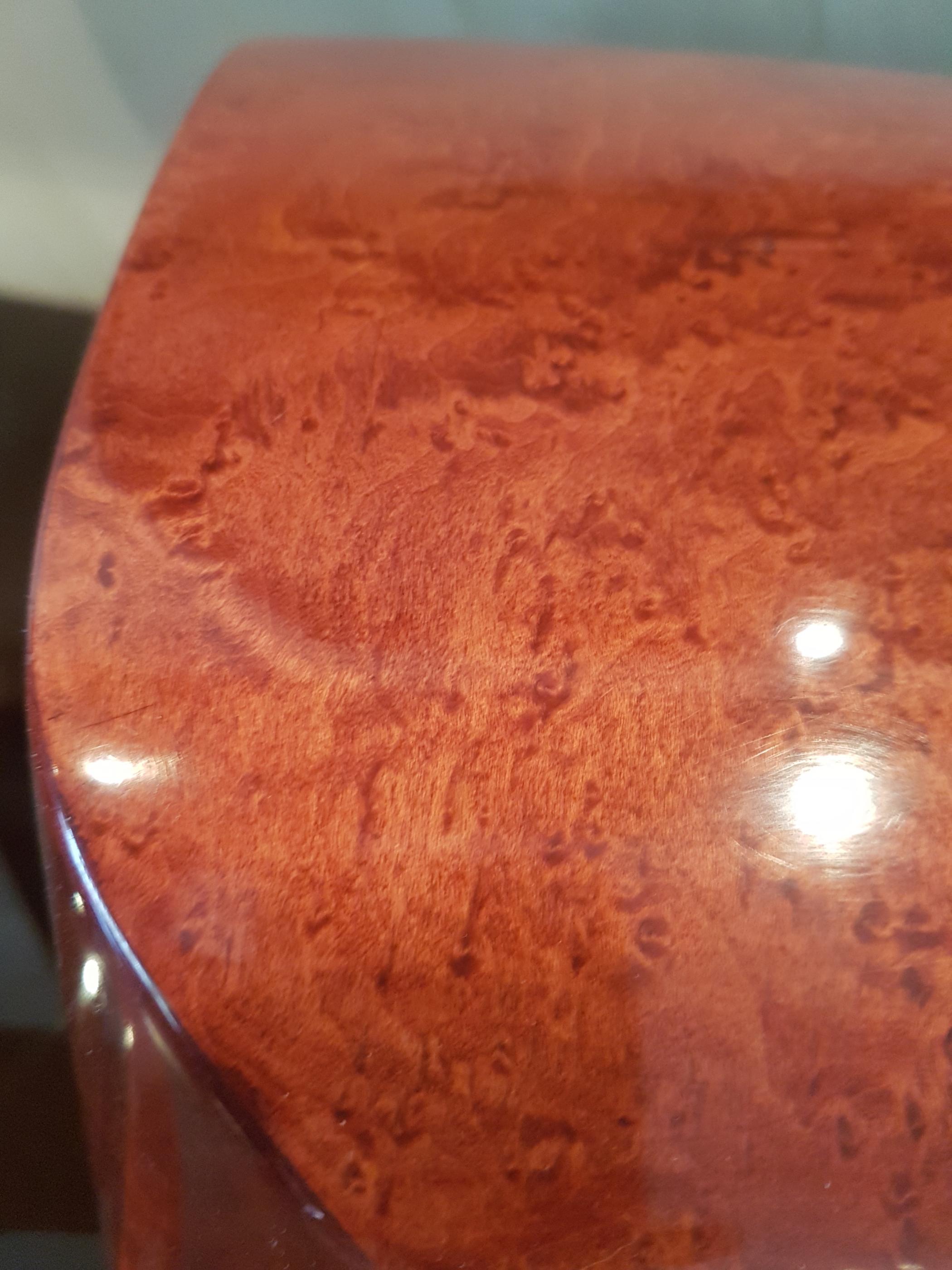

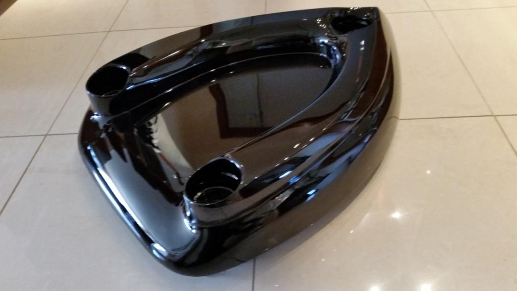

Clarification, this is a polyurethane primer, follows the cabinet's veneer with "Birds of Maple".
Noted. Look forward to pics of the "final product".

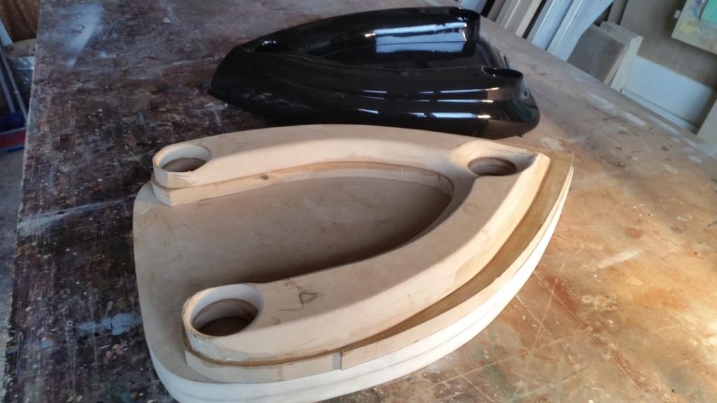

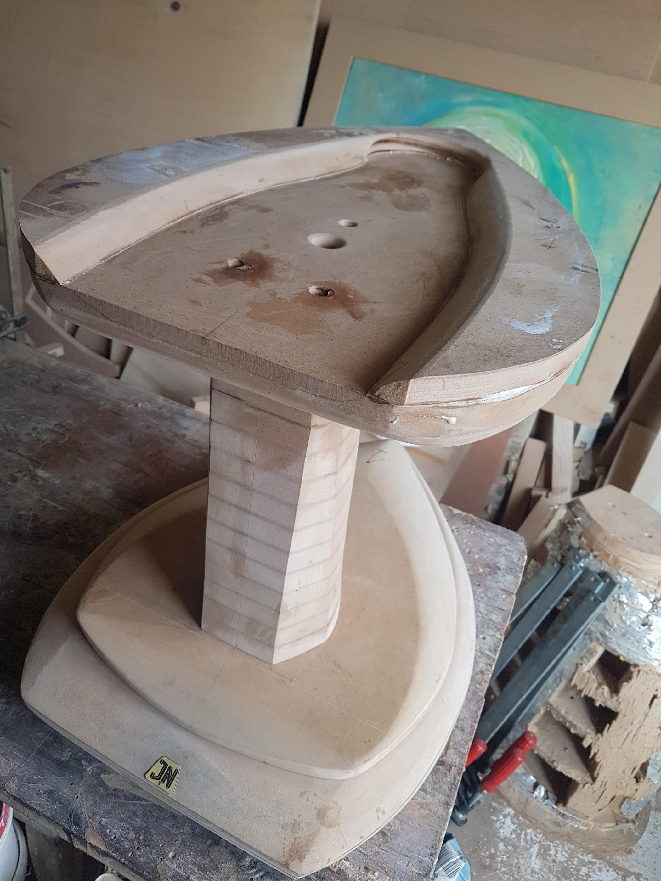

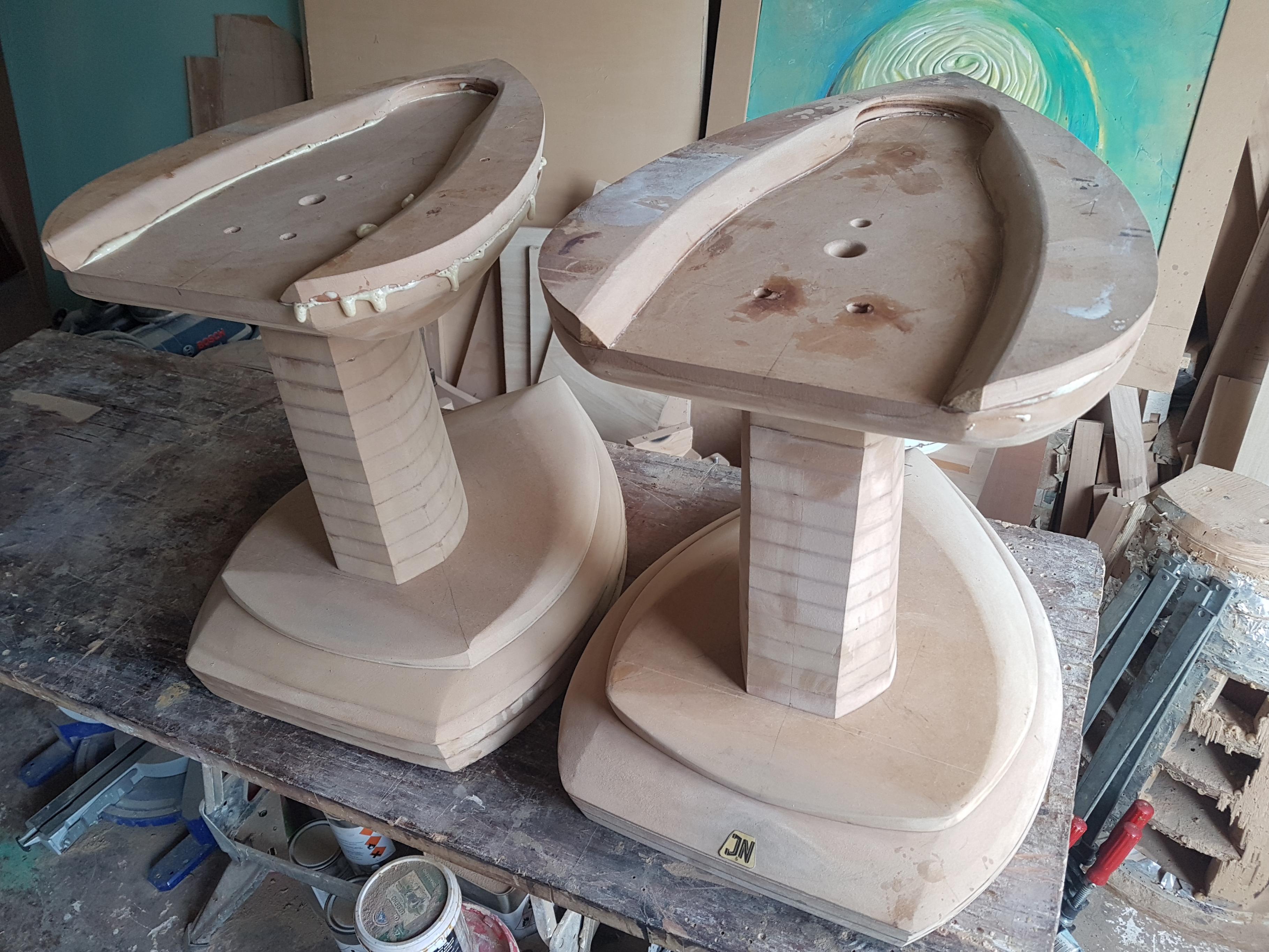

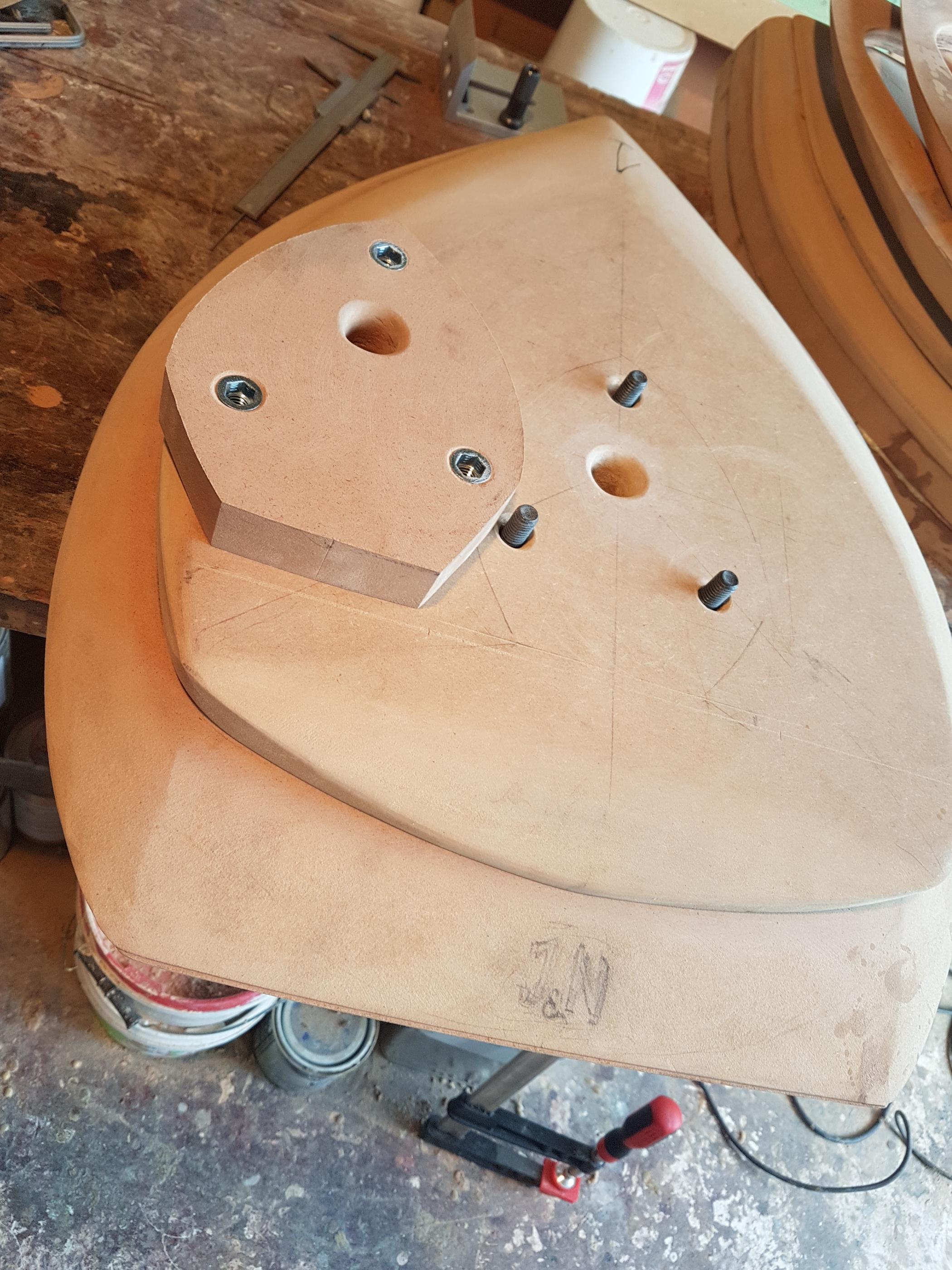

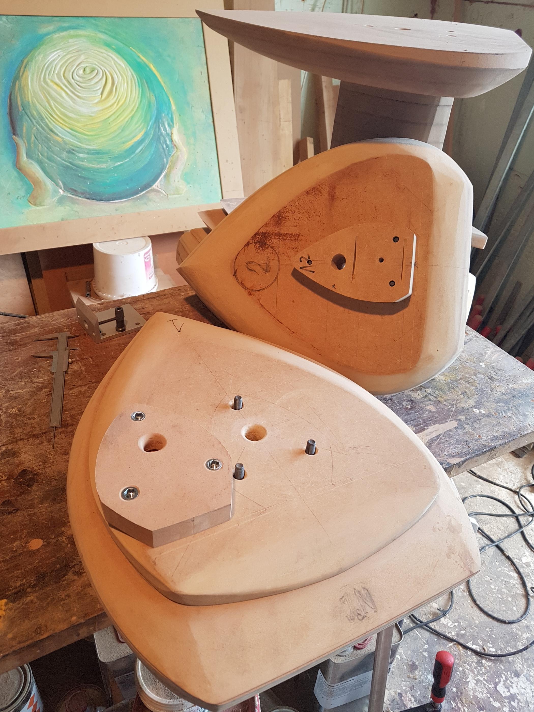

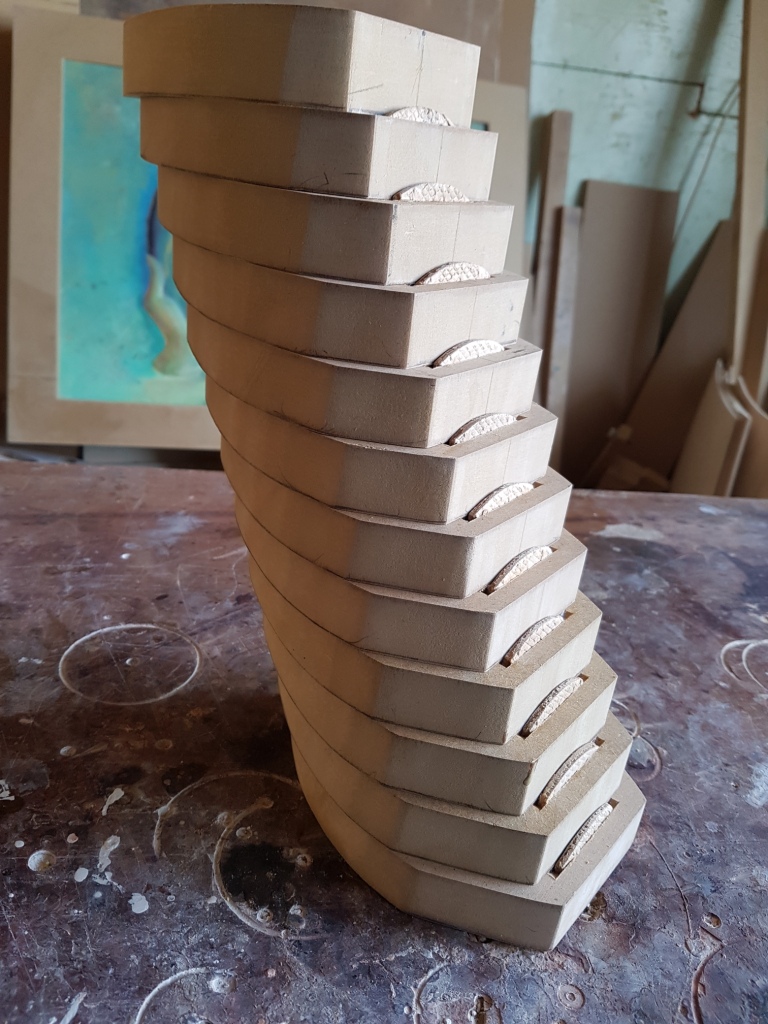

A very underestimated moment - work with multilayer MDF!
There's still a lot of work on the stands.
I show you a few pictures of the front speaker bases, the rear speaker stands will look like the same;Always been a problem with the MDF, especially when we have a multilayer construction. Over time, individual parts are beginning to show up - all of this is the result of improper processing. Soon I will show you how to deal with this problem.

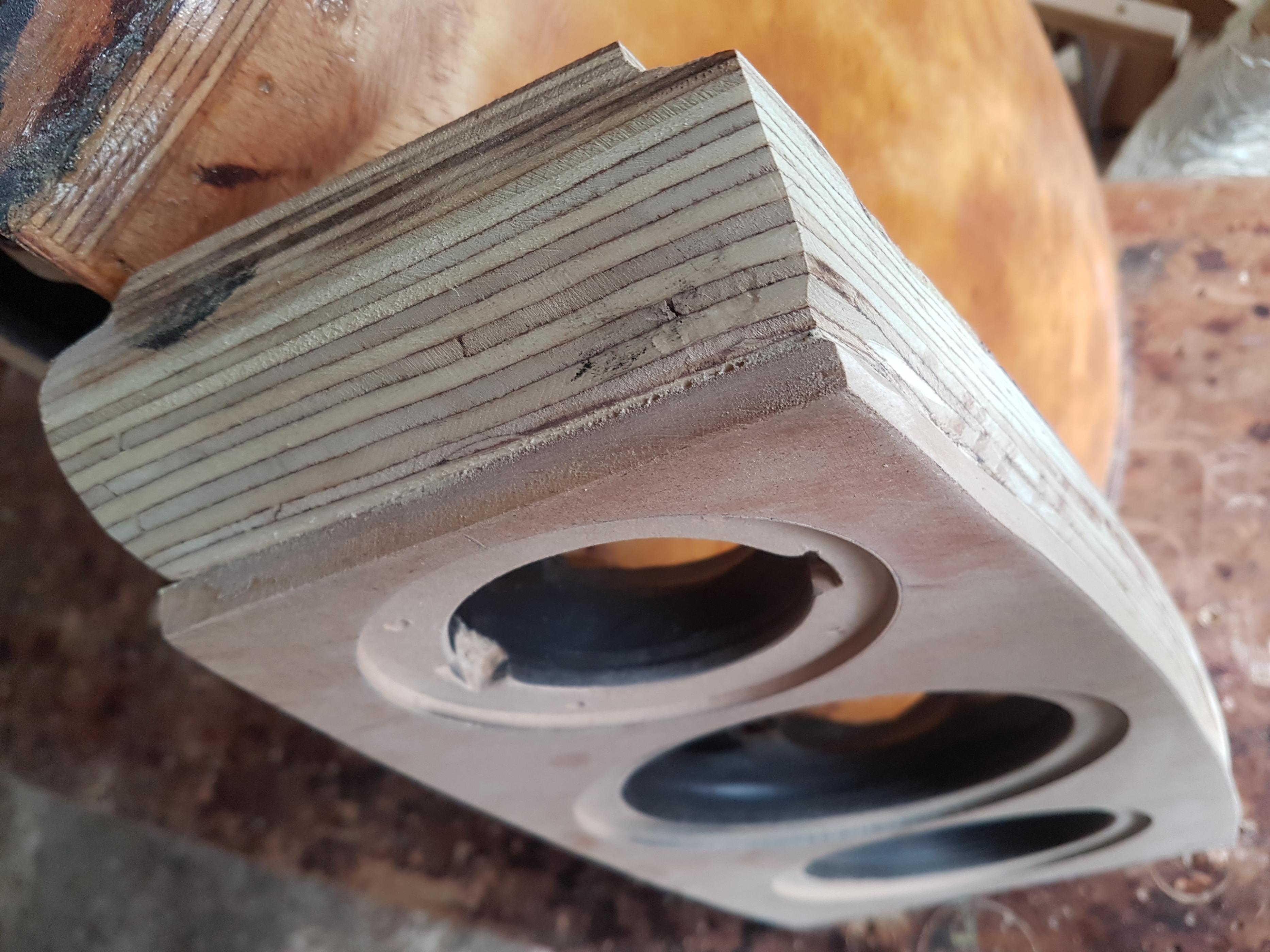

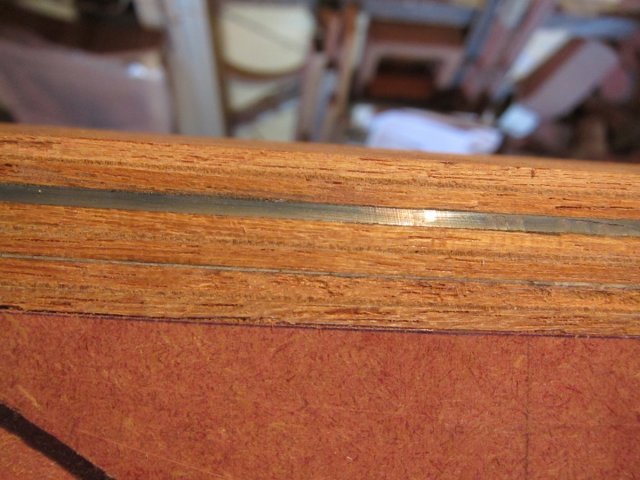

I noticed that I failed to share with you a very substantial detail in the construction of the front panel - type sandwich, finishing it with 6 mm MDF.
Sorry, this is a very important detail!
Some constructors use an array when building the front panel - a big mistake!
Тhe combination of plywood and MDF is a good solution.

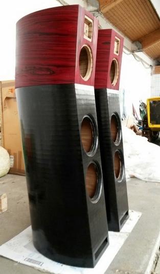

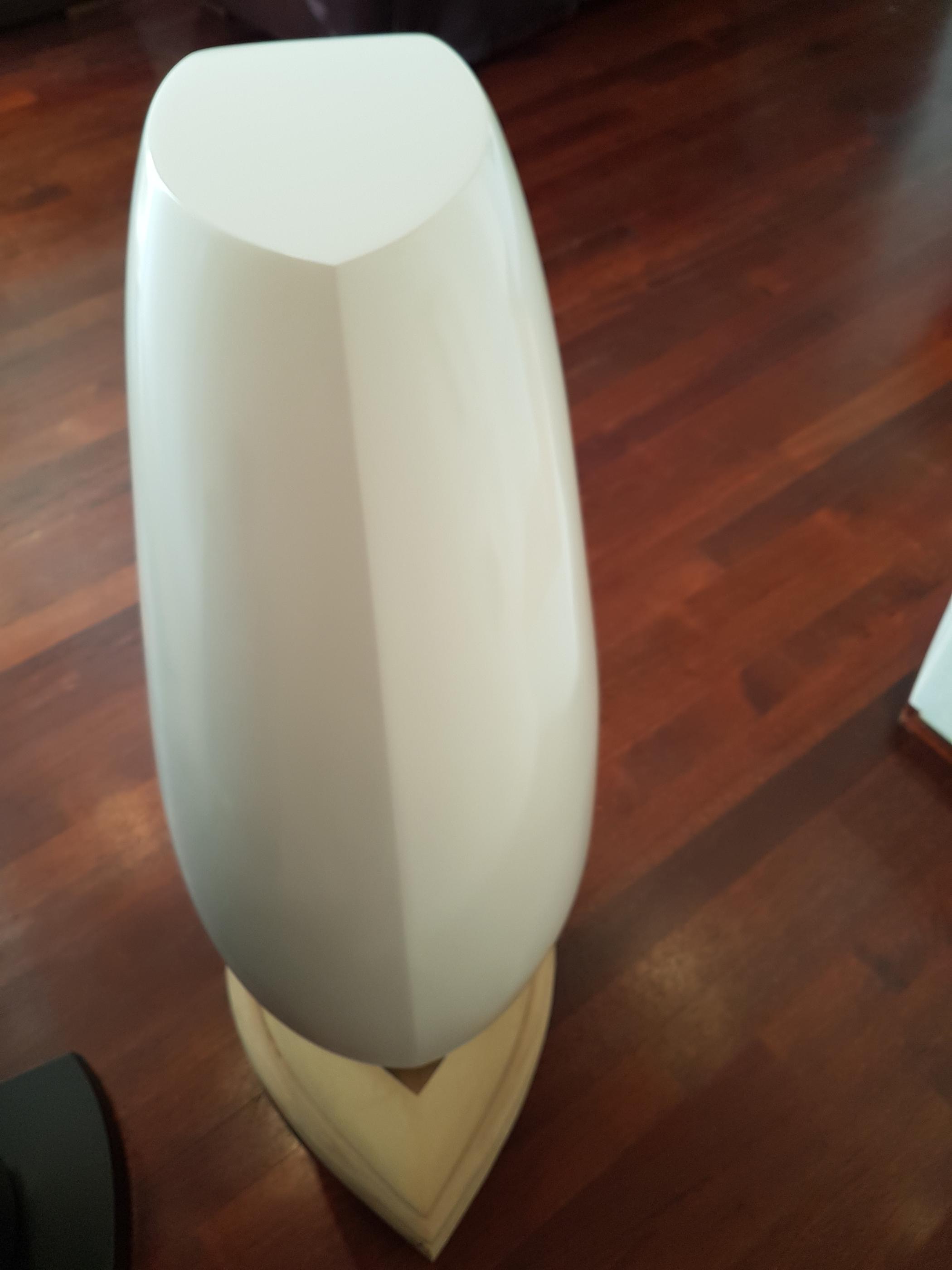

Looking at the final result of that stand it's hard to believe that it's made of MDF. Stunning finish!!

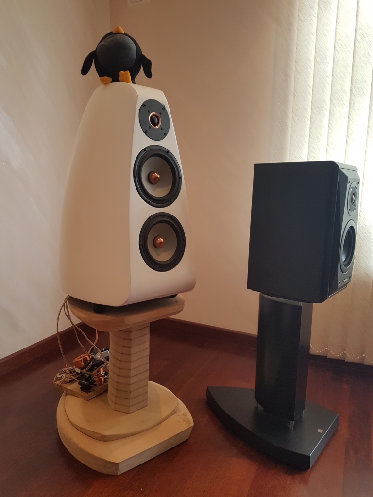

And a risky picture (everything is supported by gravity), how look for compared to the front speakers, are not on one line, but I rely on your imagination.
When will you talk about sound quality? Sound comparison between the two speakers?
I have always had difficulty choosing between those two constructions.
With floor stander type, I want the second woofer to be very close to the floor (closer than what you have chosen) to improve performance, but decrease the quality of the look.
A bookshelf to me look prettier (with good stand) and tend to give better midrange.

Wow! This is super work! Does the glossy finish make finger prints visible?

I too use a sandwich. 6mm marine grade ply + 4mm MDF + 2mm Fiberglass + 3mm Lead + 2m Fiberglass + 4mm MDF + 6mm ply - total 27mm plus 1.5 mm for the veneer. See pic below.
I find 4mm MDF bends about as easily as 6mm of marine grade plywood.
Your bracing work is insane! B&W used to advertise this bracing for their 800 Matrix series.
Correct "plywood boards",7 layers -4 mm thickness, curved on a matrix/ my work/
Thank you!
There are a few my special tehnologic moments I'll introduce to you, when I will began the finishing work on the rear speaker stands .
I never allow myself to explain the sound of my lowd speakers because this is a subjective assessment. This is a very expensive project, commissioned by an investor and is done in this way. Naturally, the bass could be 10 " and for the rear speakers 8.5 "on" Seas "/this is a project without a subwoofer/.
Thank you!
When the dust is wiped with a microfiber cloth, everything is fine.

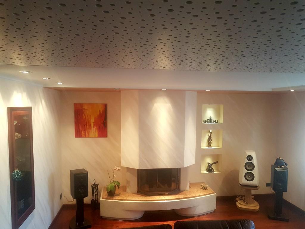

jororaitchev: Impressive. You are a man of many talents. I especially like your listening room. That acoustic ceiling panel is so architecturally clean my wife would not even notice its presence.
Did you calculate a certain hole diameter, spacing, and panel thickness to address a specific speaker/room interaction or is that a general pattern? Did you CAD/ CNC it or did you drill it out by hand? What material did you use for the panel? Any thing else that I should know before giving it a try?

Without presuming to answer for the OP, perhaps I can be of assistance.
The ceiling treatment looks to have utilized premade drywall panels, specifically the 8-15-20 formation preferred for dispersion (the numbers refer to the diameters of the holes in millimeters and the pattern is supposedly random).
Not sure about availability in the US, but in Europe, at least two companies produce such panels:
1. Rigips, the product series being called Rigiton; and,
2. Knauf, the product series being called Cleaneo.
It is relatively cheap (it is drywall essentially) but requires a bit more care/experience to put up as the joints should not be spackled/mudded.
P.S. My wife approves, which is why all of the acoustic treatment in our home is based on Knauf Cleaneo - we prefer less furniture, and even in rooms that do not typically include music systems, this type of treatment makes habitation a tad more pleasant - we do not have to fill up the rooms to squash echoes.

Few details about these gypsum panels, my model is Knauf, production - Bulgaria. Above these panels I have infrared heating and, as I say, "one bullet, two targets". Тhese panels do not solve the vibration problem in the whole range - only the with the high and to very small part of the average frequencies. For low-baffles, other solutions are needed, in time, I'll show you my way.
