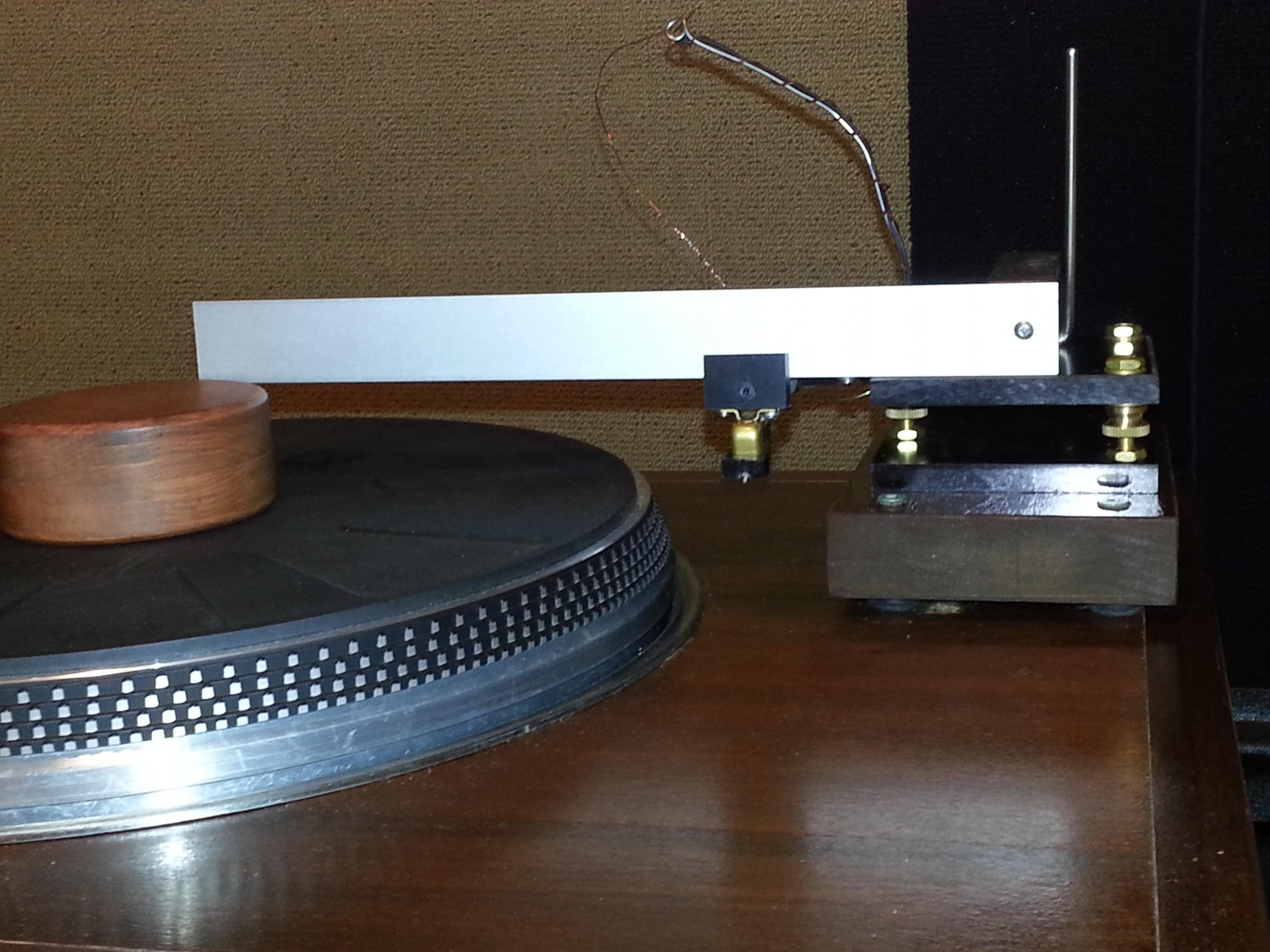

base upgrade
I lately have my arm base upgraded with piece of solid walnut n 4 rubber gourmets. It sounds more solid with better bass, dark background too.

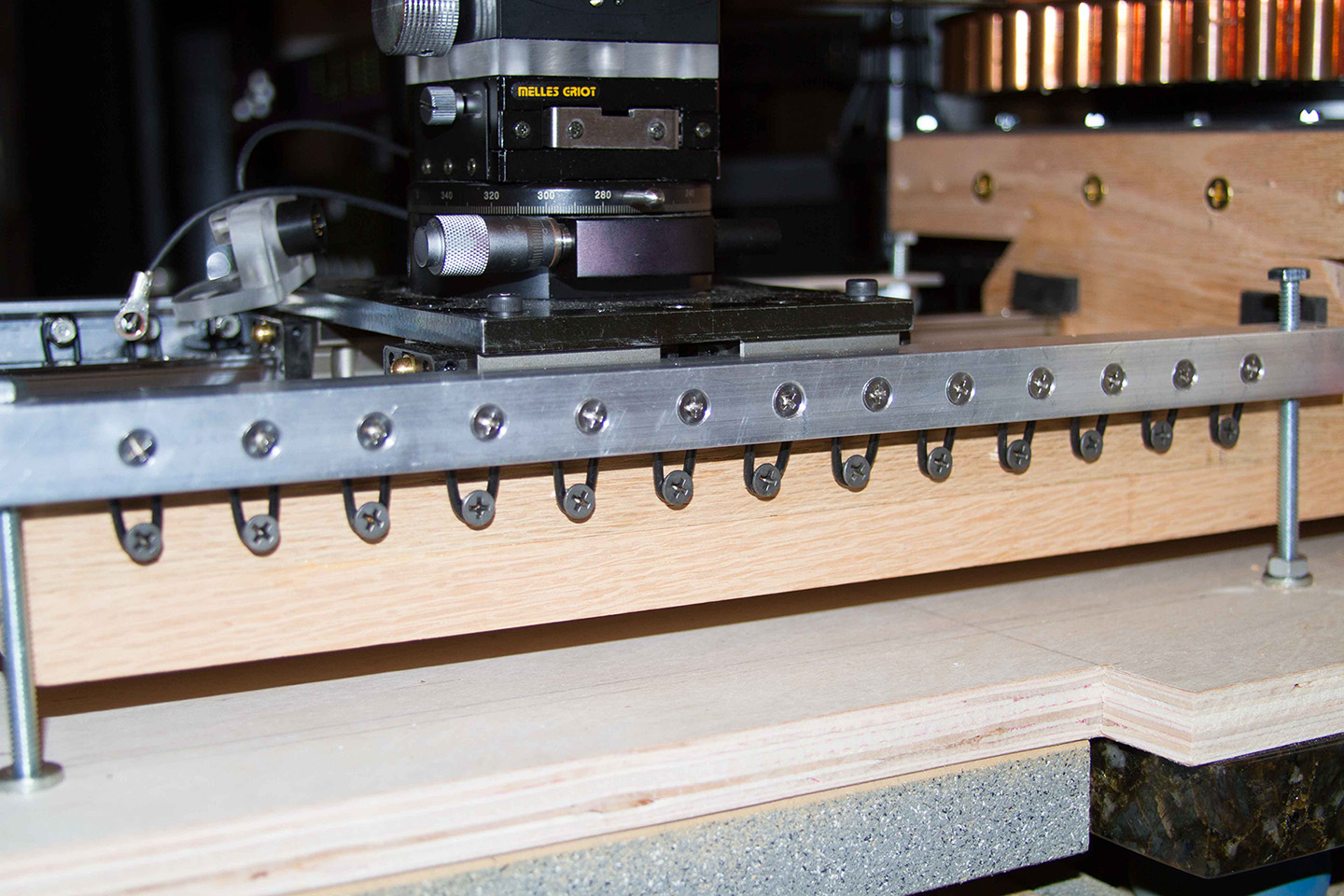

Wow, this thread has grown since the last time I was through it. Some new developments as well.
Please confirm that I have correctly summarized what has transpired since the single glass tube.
1) Two 6mm Borosilicate tubes are now used side be side (no spaces)
2) Aluminum Angle used for stiffness with a dust Shield.
3) Two 4x10x4mm Bearings instead of 4 on the carraige.
4) Cartridge Shell Is a wider and taller rather than longer piece of material.
5) Other dimensions unchanged.
If so this looks like a good late summer project. With the potential of lower horizontal drag, my Lyra cartridge may be useful here. Other wise it certainly will be an improvement with the Denon 103r.

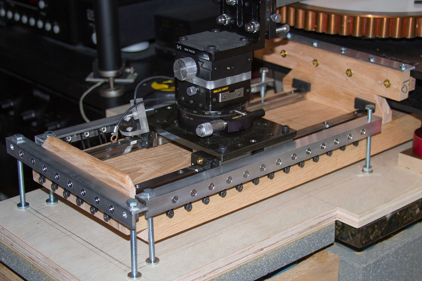

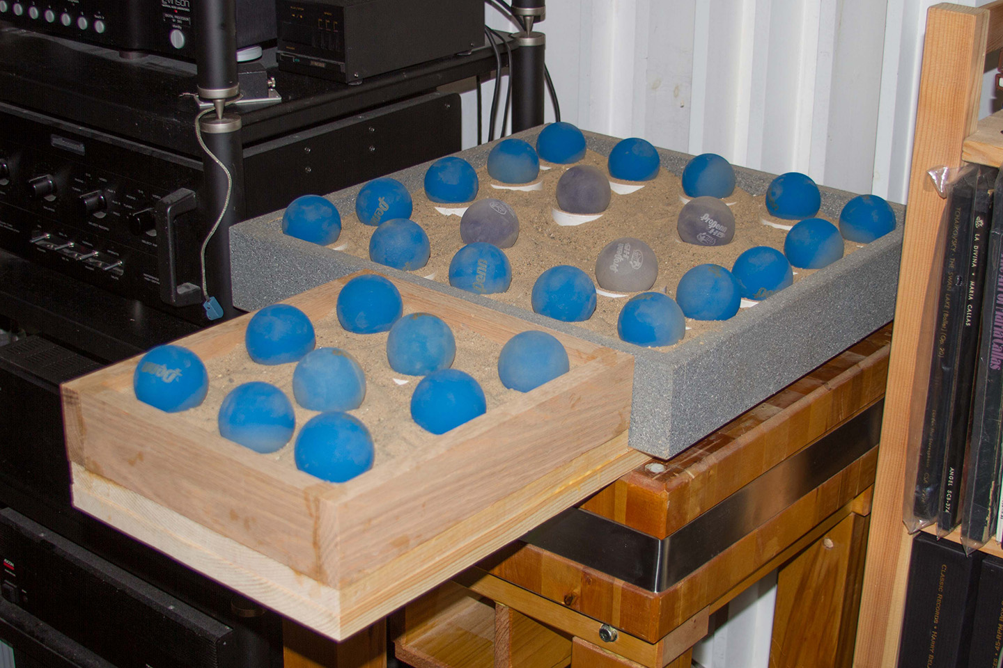

I am going to work on my 2nd version of arm this weekend and didn't do too much because I was busy. But I finished modification of SME suspension. I built " a small Brooklyn bridge". There are two layers of suspensions now. The first layer is on racquetballs. The 2nd layer is hanging on rubber O-rings just as SME's. The arm is now on the same platform as the platter.

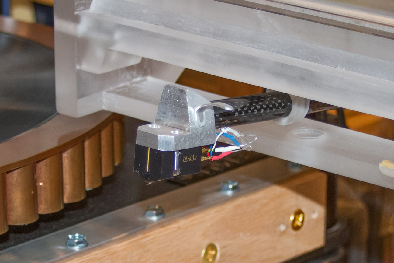

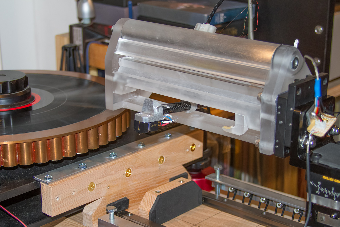

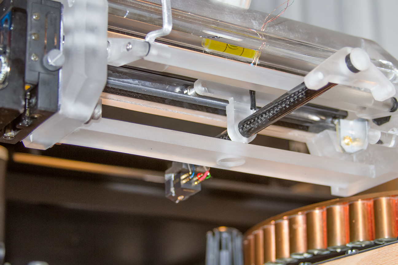

I finally finished 2nd version of diy linear tone arm. This time, I paid a lot of attention to damping. These following things are different from 1st version.
1. Arm base is on the same suspension platform as platter.
2. I tried to do uni-body. It mean to avoid loose parts and glue all supporting braces as one unified structure.
3. I used lead sheets and rubber to effectively damp unwanted resonance. Glass rail is covered by .5 mm soft lead strip and supported by 2 mm carbon fiber plates. It is very effective. The arm is deadly quiet.
4. Using a new Denon DL-103R cartridge. DL-103R works very well with this kind of diy arm. It doesn't pick any noise from the tone arm. I tapped very where on the tone arm and didn't hear any feedback from the speakers. The DL-103R has very good tracking ability as well.
5. Of course, all the dimensions of the tone arm are different from 1st version. The distance between two bearings is 60 mm now. It is 25 mm from arm pivot to center of wand. I designed 20 mm, but I have to use 25 mm due to miscalculation.
