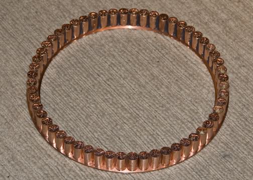

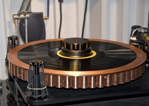

Hi Niffy,

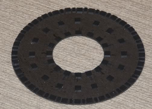

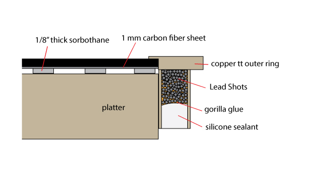

Here is the detail information about my outer ring. I also found some of old pictures of the ring.
I bought the ring from TTWeight audio when they just started business years ago. They only made outer rings and all the outer ring they made had no weights at that time. But their ring is not easy to use and is too light. So, I decided to modify the ring.
TTW Outer Record Rings
I think they call the ring I bought classical now.
My ring consists of two parts.
One part is the record mat. I bought the mat from TT Weights as well. The mat is made of 1 mm carbon fiber sheet. I think 2 mm is better. On the back of the carbon fiber mat, I stick small pieces of sorbothane. I cut them from a 1/8” sheet.

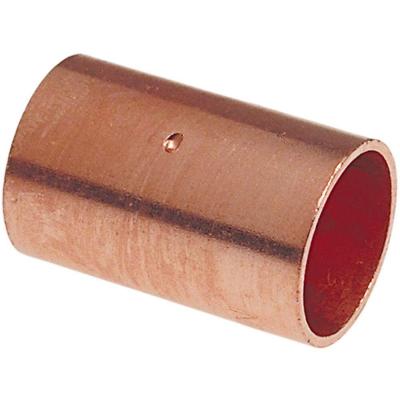

The other part of the outer ring is the ring itself. I glued 56 pieces of copper cups( for plumbing) around the ring on the bottom. They made almost perfect fit. There are about 2 mm space left between last two cups. So, once I put the ring on platter, the ring is centered. I filled these cups with same amount of lead shots by weight. The lead shots filled about half of the cups. Then, I poured Gorilla glue into these cups. Gorilla glue expends once it is dry. It fills all small space between lead shots. Finally, I sealed these cups with silicone sealant. In one of the pictures, you can see the lead shots with Gorilla glue, I didn’t seal the cups with silicone yet when the picture was taken.
The outer ring helps needle to track the information in groove accurately.

Forgot to mention that the total weight of the outer ring is 6 lbs and 8 ozs. 6 lbs is on the heavy side. I think 4 lbs should be enough in most of cases. SME's motor does have enough power to drive the platter with the outer ring. I measured wow and flutter with the outer ring and without the outer ring. I couldn't see significant difference so I think the weight of the outer ring is ok.
Hi Super.
Nice work. 6lb will definitely flatten even the most severe warps especially when combined with the grip and pull SME central clamp. With the way SME build things I doubt the main bearing even notices the extra mass.

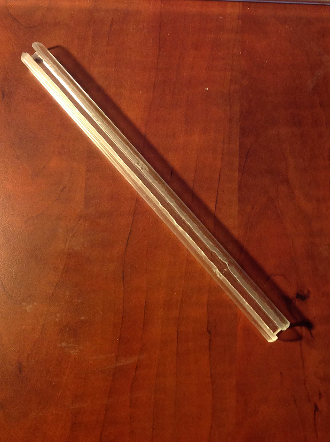

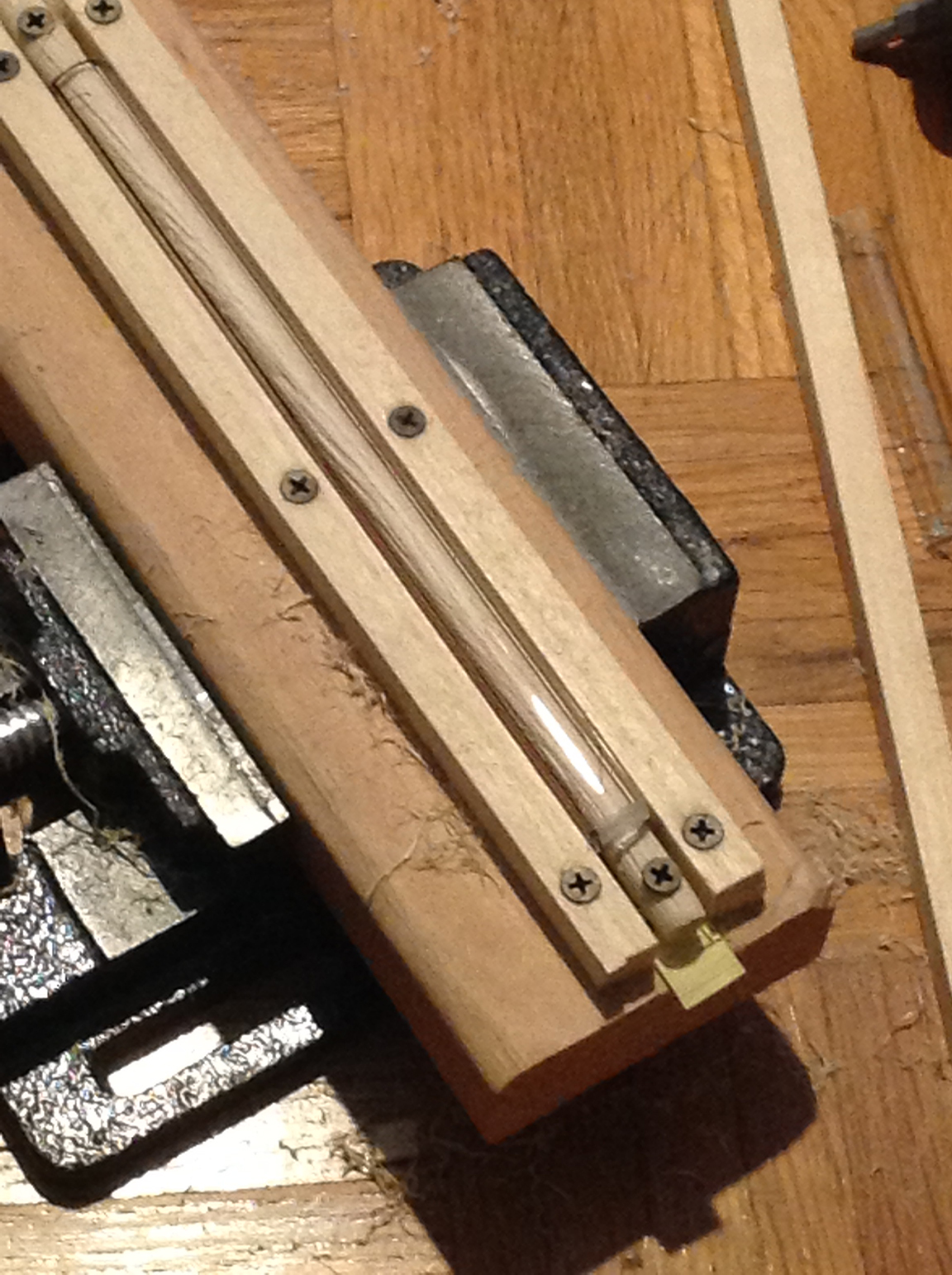

Ok, I did C shape glass tubing.
I made a attachment to hold the tubing and used a grinder first. Then, I used a cordless drill and small grinding wheels to do the detail, and finished it with knife sharpening stone with water. It took a lot of patient and time to get it done. The first one was cracked because I put too much pressure on it. It is not the most beautiful thing in the world, but it works. 😀

Hi Super.
Much earlier in this thread someone posted a video link showing a homemade glass tube cutter. It was fast and gave a good clean cut. It was for cutting the tube to length but the idea could be adapted to cut along the length to make a slot. The key to the success of this cutting rig was using a high speed dremil type drill with a diamond cutting disk with a constant stream of water to cool and lubricate.
Niffy

from what I understand these kind of tubes can be easily cut with a standard hardware store glass cutter the type used for window glass. seems a simple step to make the above style jig which would provide two spaced guide edges for a glass cutter to run along spaced to provide the desired gap. Worth a try. Best regards Moray James.

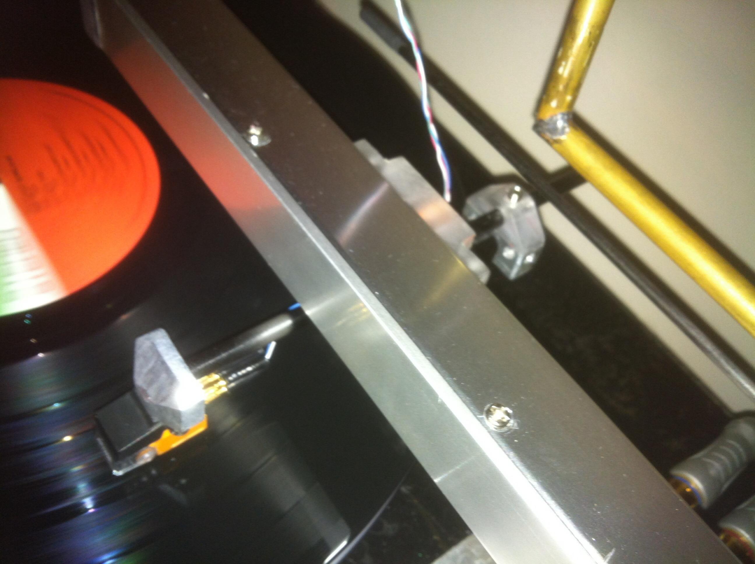

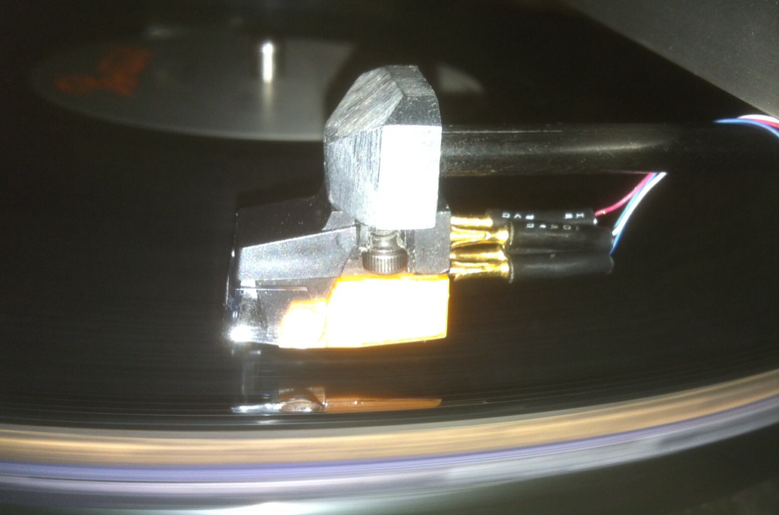

Shot from side of headshell
Hi Colin.
How is the headshell attached to the arm tube?
Niffy.
Hi Niffy,
Press fit and bonded with a little krazy glue. The last couple I've done this with are so strong I had to use a hacksaw to free up the carbon fiber tube 🙂.
Colin

I am going to try small diamond coated cutting wheels. However, 2.5mm glass wall may be still too much for these cutting wheels. So, I ordered both 12x1mm and 15x2.5mm tubings and will try to cut 1mm wall tubing first.

Hm. I'm tempted to try my diamond-bladed tile saw. Just need to take it easy, water already pumped. I've cut glass tiles and other glass without any problems.
Are those machine screws steel? If so you should try swapping them out for Titanium or top quality Stainless which will both be more or less non magnetic. Makes a difference. Best regards Moray James.
