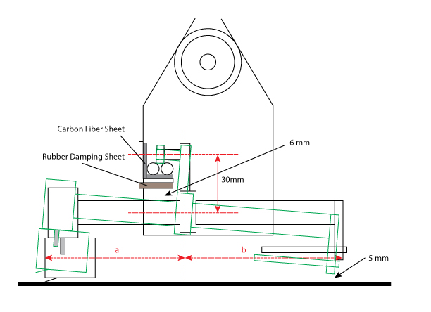

The glass tubing I ordered is 16mm OD, 11mm ID and 2.5mm wall. My bearing is 4x9x4mm. It should fit inside of tubing perfectly. I don’t have the glass tubings yet. I tried to fit the bearing in a 10mm ID tubing, it works fine as well.
In fact, I think it is more stable to run inside of tubing than to run on two tubings. One thing I don’t understand is why Clear Audio uses convex bearings because convex bearings allow more lateral movements. They must know something that We don’t know. Anyway, in my 2nd arm, the glass rails can be easily change to twin tubings or one C shape tubing without modifying anything else. I will try both.
With regard to 30mm on the “T”, it is almost the smallest size I can do. Please see the drawing.
From my experience, a shorter distance A (see drawing) may be better. But it can’t be too short. If it is too short, the arm won’t be stable. The distance A should be almost same as distance B in order to maintain stability of arm.
Jim

Hi Super.
Keeping distances a and b similar definitely can help. Making b the wrong length can do nasty things to the effective mass. Have you done any calculations to determine what it will be? I've been designing a lighter carriage for my arm just to see how it compares to my current model. A simple spread sheet allows me to evaluate how the design effects carriage mass, tracking force, effective mass and vertical location of COM. Balancing all these factors is crucial.
Looking back at the photos you posted I can see that reducing the hight of the T section might prove difficult without bringing the bottom of the support structure too close to the record surface.
I notice that you have gone with a Colin style head shell in your drawing. I'll be interested to hear how it works for you. I've opted for a half hight version as I couldn't get a good balance of factors with the square version (as I'm designing the carriage to fit my base my design criteria are different than yours).
I love your ring clamp. It definitely follows my design philosophy, give the job of dealing with warps to the deck not the arm. In fact as it removes a major burden from the arm it could be seen to be as much a part of the arm as it is of the deck so it's discussion here is definitely not off topic. Would you mind sharing a bit about it. How did you make it and did you balance it.
Niffy

Hi super10018
Bearings with a convex outer race find center at the inside bottom of the tube by virtue of gravity. When the tone arm encounters a warp, the bearings roll back and forth on the bottom of the tube, hence rolling friction, the most desirable kind. Make a simple sketch of the Clear Audio design, looking at it from the end of the tube, and you will know what Clear Audio knows. 🙂

I understand what you are saying. Personally, I am not fond of so called knife edge effect theory.
One of benefits to use convex bearing is VTF is a constant force.
In order to avoid lateral movements, the down force generated by arm moving mass must be stronger than the pulling force caused by friction between stylus and record groove. In reality, the irregularity of record surface may knock convex bearing off center. Therefore, the weight of moving mass is very critical. I guess Clear Audio might find the right balance between pulling force and down force. Optimal down force will keep convex bearing centered inside of glass tubing. 43 grams may be a good reference point for arm moving mass in stead of 20 something grams.

Niffy,
No. I have not done any calculations so far. If you have a simple spread sheet and it doesn’t cause you too much trouble, I would love to see it.
Yes. I am going to do same kind of head shell as Colin’s. I also took your advice to drill two larger holes for adjusting zenith. The head shell will be a solid block of aluminum.
