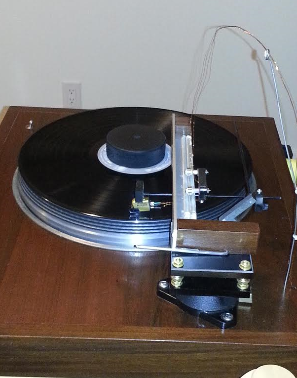

Guy,
I finally finish my linear arm after reading this tread multiple times. I don't know if it would work the first time, since I still have to finish my Lenco TT before trying. I still have to make a phono amp to try on this arm.
I'm new on analog play back. I have been playing around with CD for the last 30 years and all in a sudden a friend of mind gave me a MM cartridge, Pickering V15-625e, and I start everything from this. I have some small choke with me. I wonder if the wire inside is small enough to do the job ??
Please do advice.
Albert

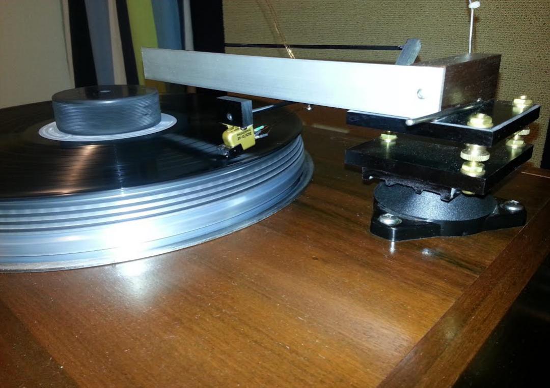

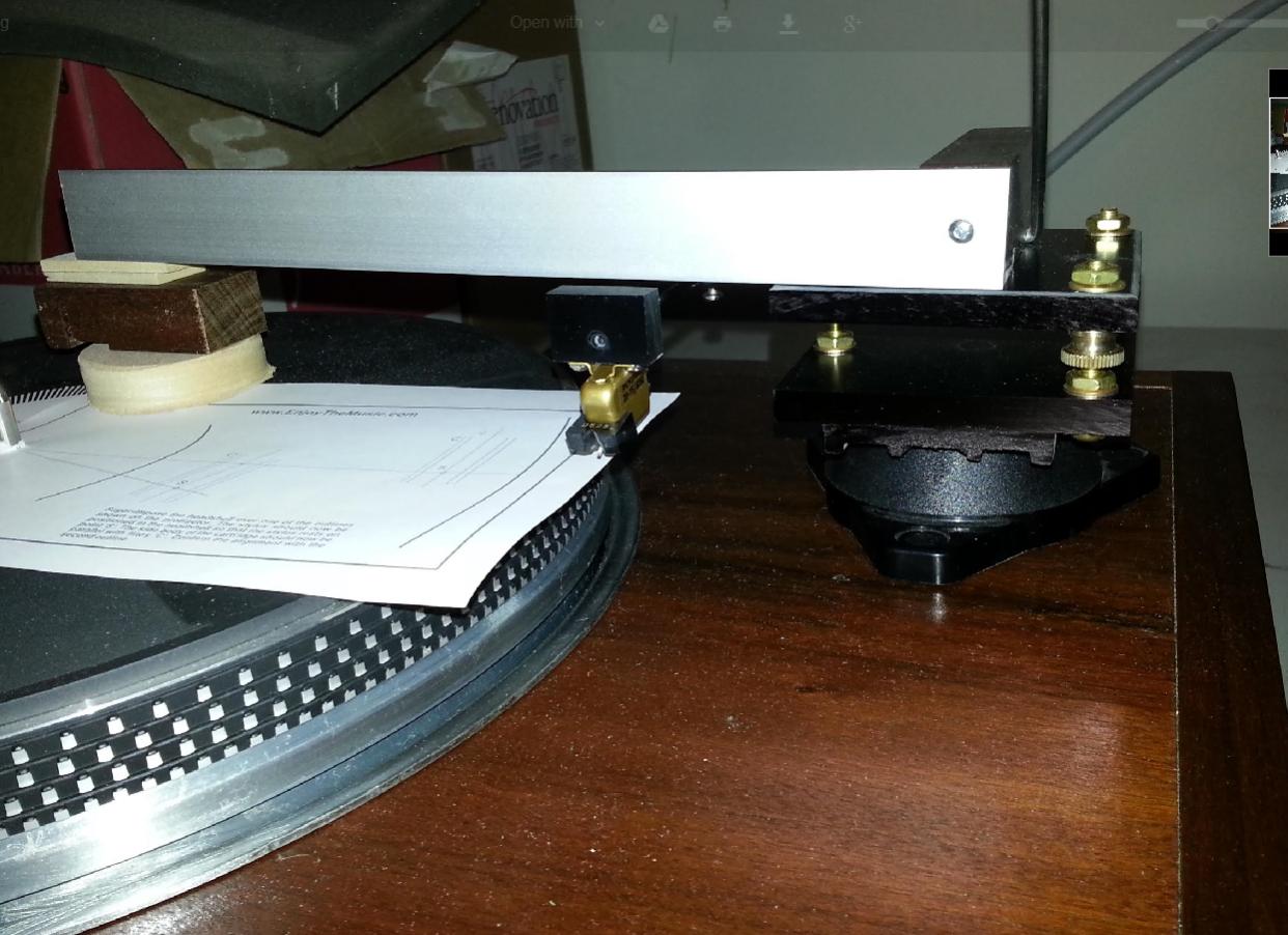

It's perfectly working
Colin, and all,
I have to thanks those guys especially Colin for his hard job. This arm works perfectly from the very start and I can't tell what the different between this and the other, for this is the first tonearm I make to coupe with my Lenco TT. I don't have any experience in analog playback, so don't know how to compare. I know my work is not 100% perfect, but I'll keep learning n hope I could tweak it to another level someday.
Thanks again
Albert

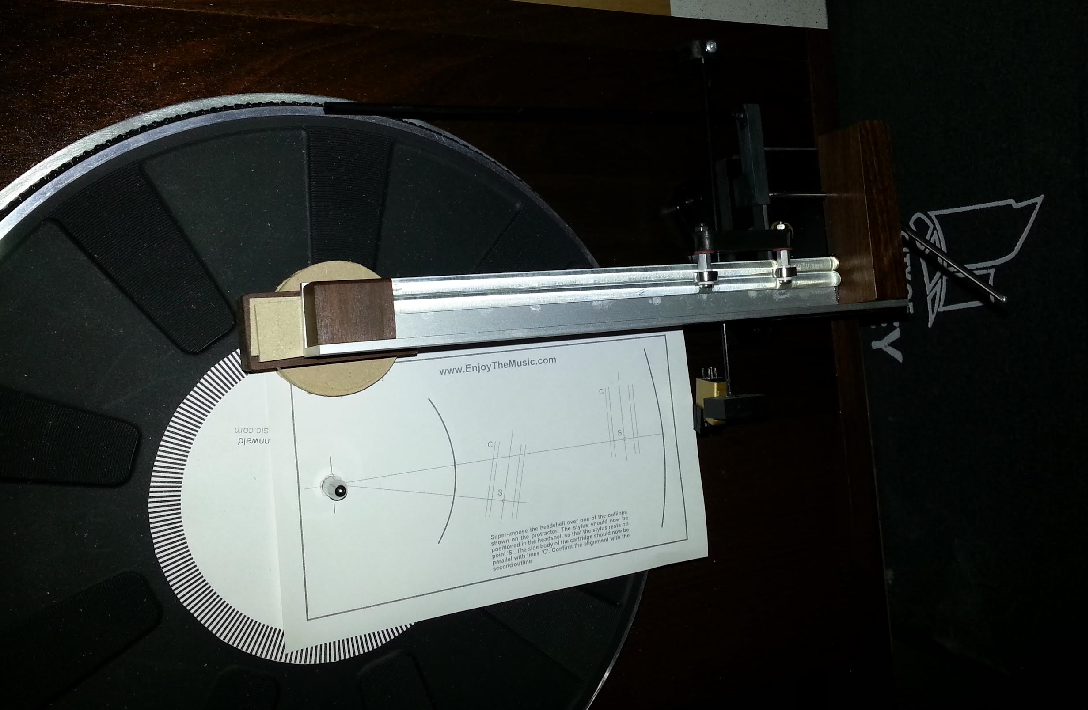

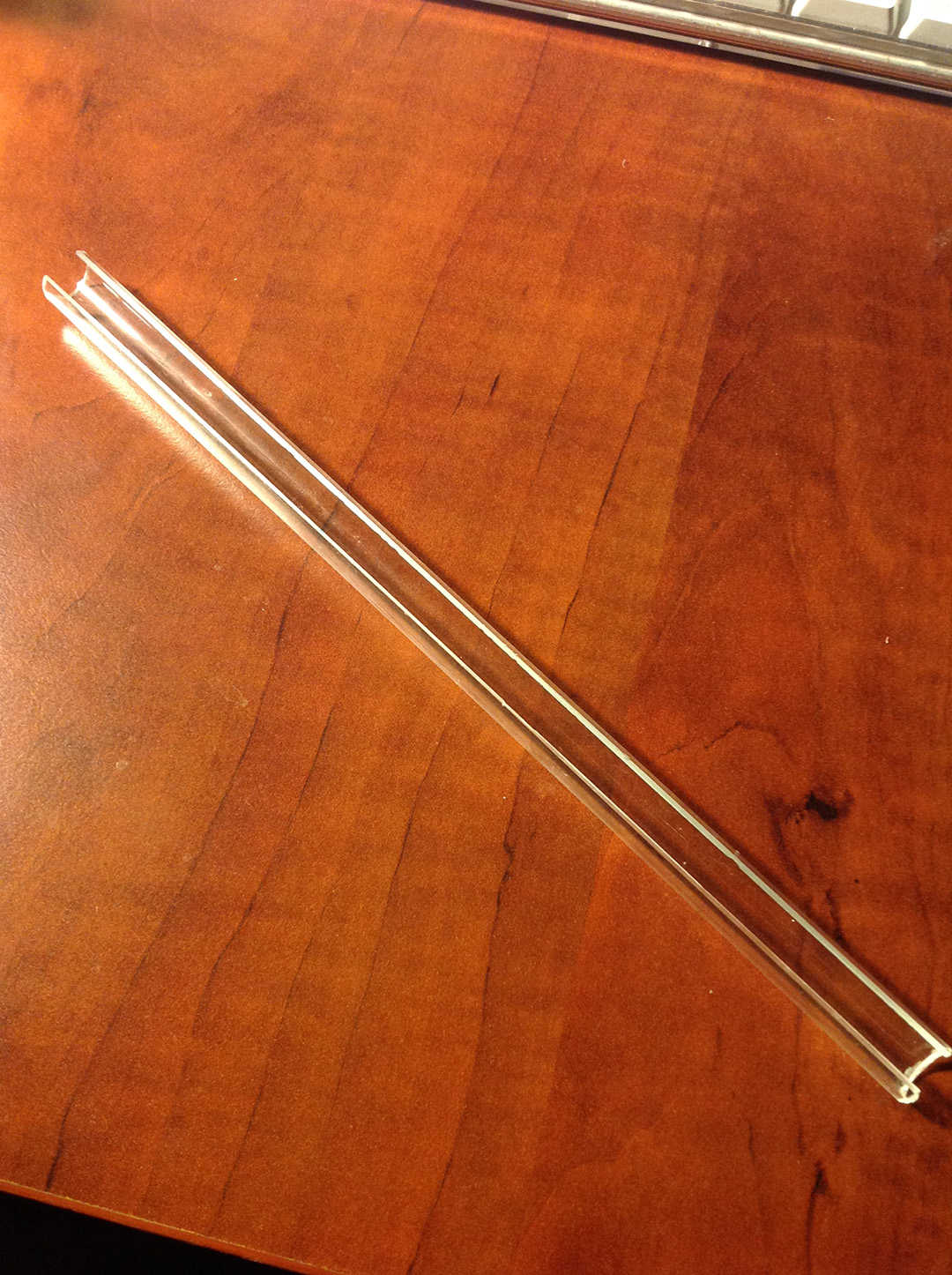

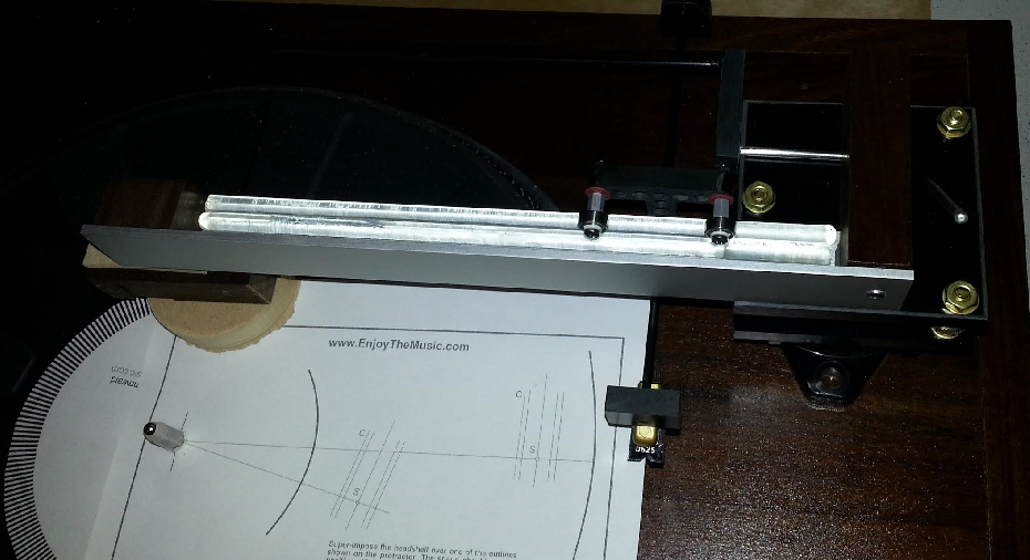

I did 2nd try. It is almost perfect cut this time. I use a 12 OD 10 ID glass tubing instead of 16 OD 11 ID glass tubing .
Hi Albert.
Welcome to the wonderful world of LT.
Nicely done. It looks like you have followed Colins design pretty closely. A smart move considering the amount of experimentation, fine tuning and hard work our mentor has put into this design.
Colin.
I've just tried your frequency sweep test tone test. You're right it is dead simple. All I heard was a perfectly smooth progression through the entire range. No peaks or resonant modes in the audible range at all. Just as I had hoped considering the amount of work I did to push the arms resonant frequency out of the audio bandwidth its a nice conformation. Thanks for the tip. I've nearly finished my light weight carriage and will hopefully be able to report on what differences it makes soon.
Super.
Nice clean cuts. I bet you were sweating buy the end. I look forward to hearing how it compares to the two tube design.
