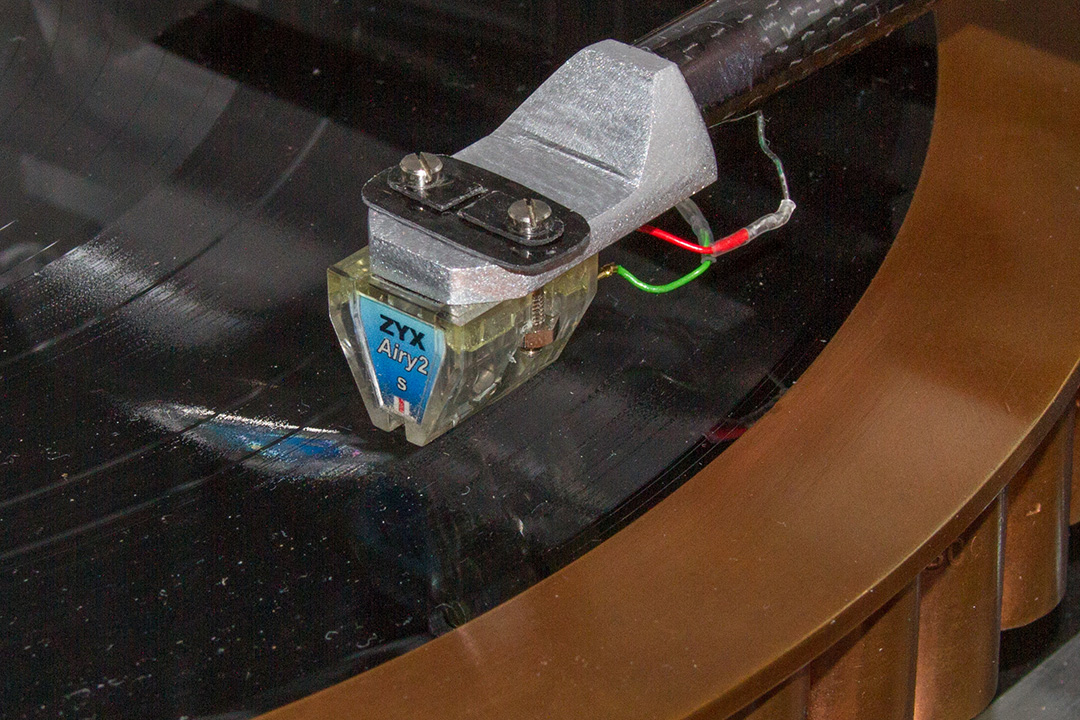

I finished 3rd revision of my diy arm.
The headshell is now 7.5 g and bearing carriage is 12 g. I made a small bucket for counter weight. It is filled with lead shots. The lead pellets are weighted .05 g each. I can also move the counter weight back and forth to adjust tracking force. Please see attached photo. I did four different kinds of counter weights. The bottom of 1st version is about 3/4 inch lower than record surface. I believed that counter weight should be lower than record surface and the lower, the better. However, I found that it is not necessary and not desirable. The bottom of final version of counter weight is on the same level as record surface. A counter weight should be on the same level as the needle of cartridge in order to track nicely.
I tried Denon DL-S1 and zyx Airy on the new version of the arm.
The recommended tracking force is 1.1-1.3 g for Denon DL-S1. I could not track at 1.3 g with old arm, but no problem with the new arm. I set the VTF at 1.3 g. The cartridge tracks perfectly. My only complain is the sound of Denon DL-S1 is on thin side. It sounds wonderful when it plays jazz, but not classical. In my opinion, classical music is the most difficult music to play back on a vinyl system.
For Zyx Airy, it tracks very nice as well. I spent a lot of time to try to get ride of buzz when it plays classical music with high dynamics. I tried different combos of VTF, VTA and did 4 different versions of counter weights. Finally, I get the sound which I like the most. It is my favorite cartridge and diy arm combo now.
At this point, I think I am done with this Cantus style rail diy arm. Personally, I am not fond of so called "knife edge" theory. I really suspect the validity of such theory and plan to build my own version diy arm. Here is the plan. Please see attached drawing.

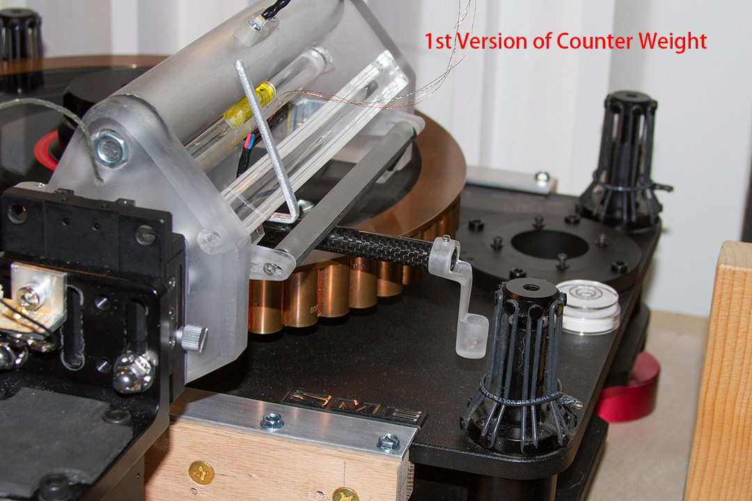

Hi super.
Good to see you still experimenting and coming up with new angles. Your lead pellet counterweight is neat as you can adjust both tracking force and effective mass.
You said " A counter weight should be on the same level as the needle of cartridge in order to track nicely". I've heard this stated many times but think it is true only under a very specific set of circumstances. Circumstances that are not met in this design of arm.
Ideally the vertical pivot should be level with the record surface in order to minimize warp wow. Also the centre of mass of the whole arm (not just the counterweight) should be level with pivot in order to minimize tracking force variations when traversing warps. Therefore the centre of mass of the arm should only be level with the surface of the record if the pivot is also level with the surface of the record.
As our arms have their pivots above the record surface the centre of mass of the arm should also be raised.
Also worth mentioning is a very good observation made by Colin quite some time ago. Having the centre of mass below the pivot causes a slight increase in tracking force on warps and this can be advantageous as it seems to make the cartridge a little more sure footed. The slightly higher than centre of mass pivot will also make the arm dynamically stable.
As you have excellent record clamping warps will be much less of an issue for you.
Keep up the good nay excellent work.

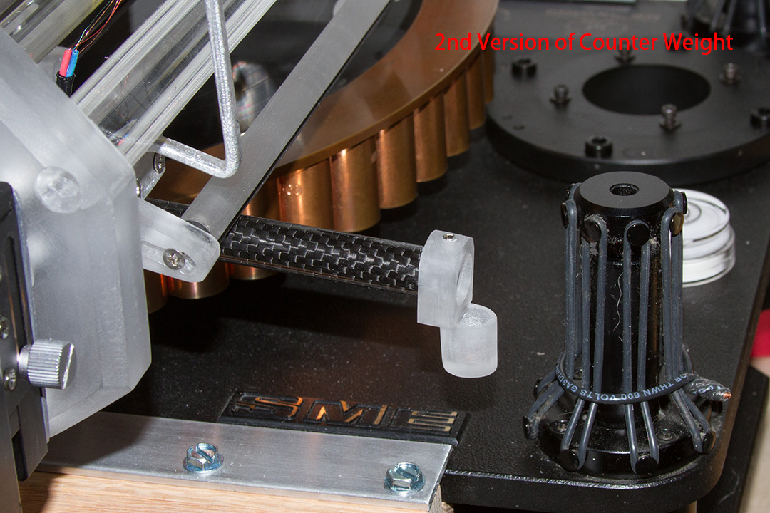

Hi Niff!
Please see the photo. The weight of bearing carriage is mostly concentrated on the bottom. So, all the weights of three sections, head shell, bearing carriage and counter weight should be in line with arm wand. I learn this by studying Clear Audio arm.
I made another small improvement by adding .5 mm carbon fiber washers on the cartridge screws. These washers are about .15 g. Accordingly, I added two lead pellets (.05 g each) into the counter weight bucket. It seems to me that background noise is reduced.
