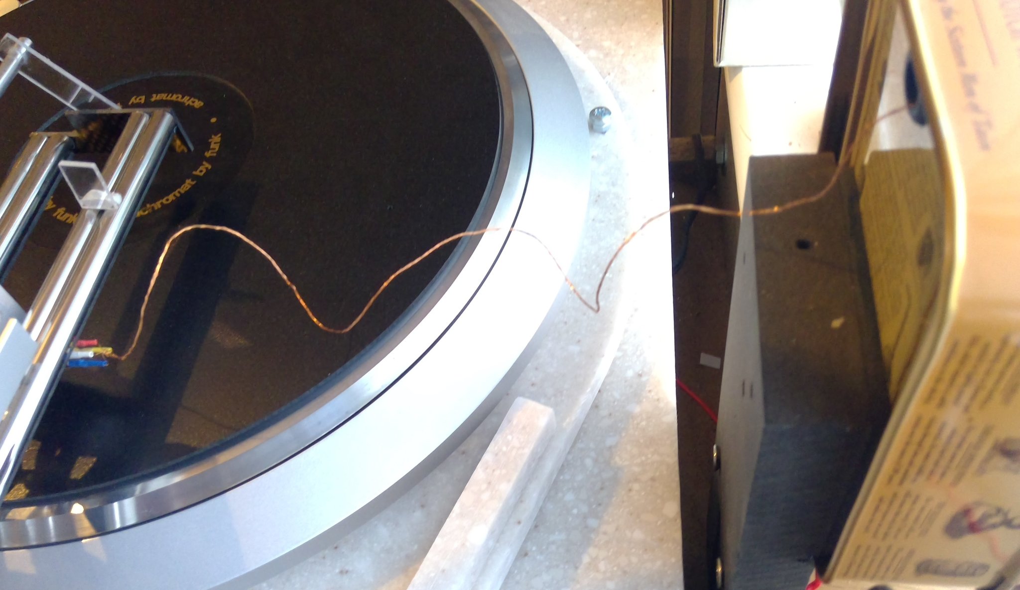

My cartridge connection wires were built to your spec when you were using two strands of magnet wire per connection, so the lead set is 4 connectors (plus and minus for each channel, each twisted pairs) each connector being two strands of magnet wire, the whole lot inside a shield wire of the same composition, not connected to anything at the cartridge end but to ground at the connector box end.
At the moment, the connector box, (a good looking GlenMorangie tin!!) simply connects those cartridge leads to phono sockets, and phono leads connect that to the phono pre. The phono pre is about the same size as the existing box and my thoughts are to reposition the phono pre where the connector box currently sits and to wire the cartridge leads straight into the molex plug that brings the input to the phono pre.
That way there will be no interconnects at all, and the cartridge leads to molex plug will be the only solder joints prior to the phono pre.
But, if it is a but, i believe there will be little capacitive load for the cartridge that way?
I would value advice on that!
By the way, the leads are very un intrusive in the carriage motion.

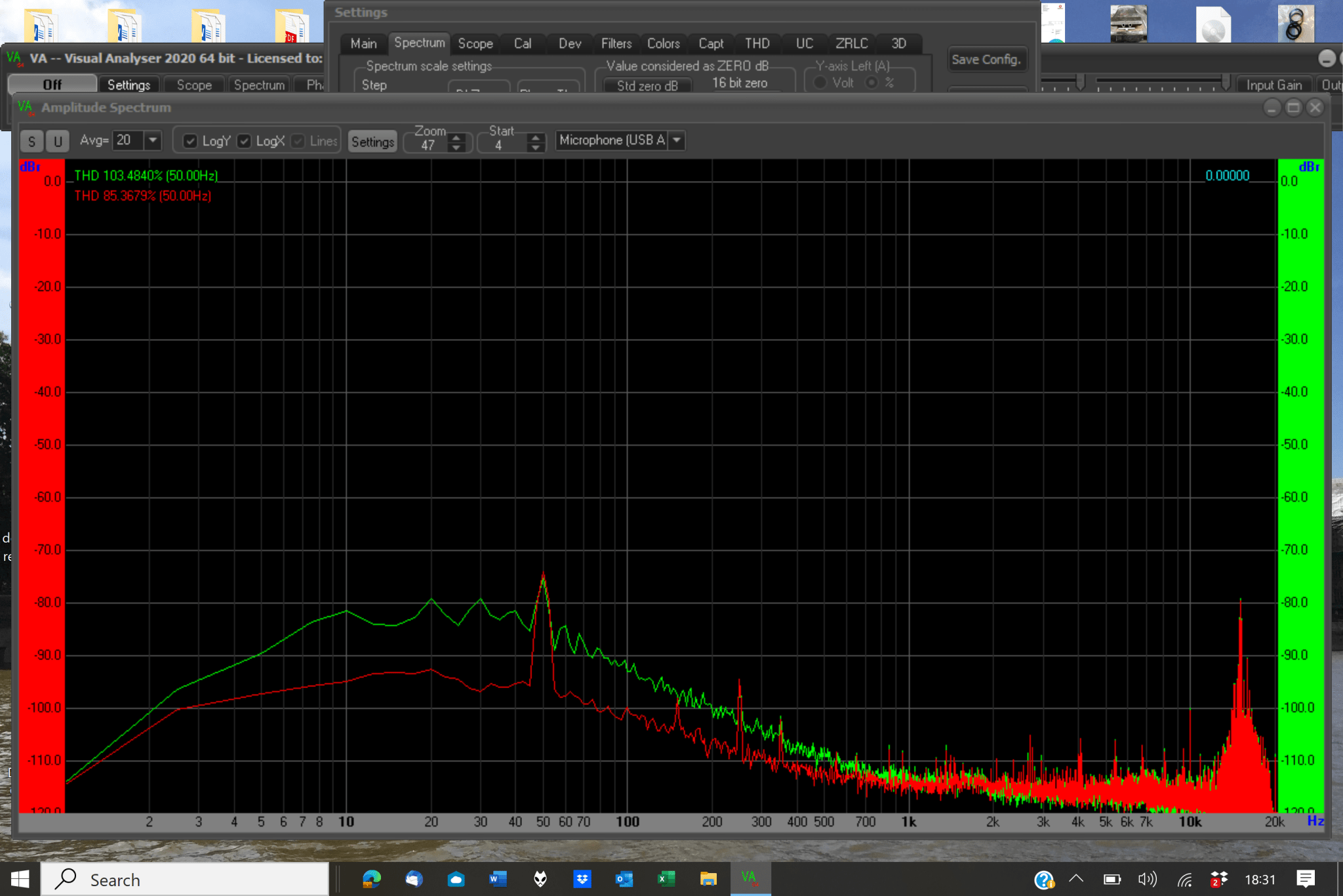

I thought i would report in on the mornings work.........
First i built up courage to chop into my phono pre case and wiring.
2098 attached was before i started this wiring experiment.
The cartridge output wires now go direct into the phono pre which is mounted where the connector box used to be........
I had forgotten how fiddly those tiny wires are.
Its not my best work but it connects correctly, all wiring tested end to end showing continuity and insignificant resistance was a good start.
It plays music, always a good start!

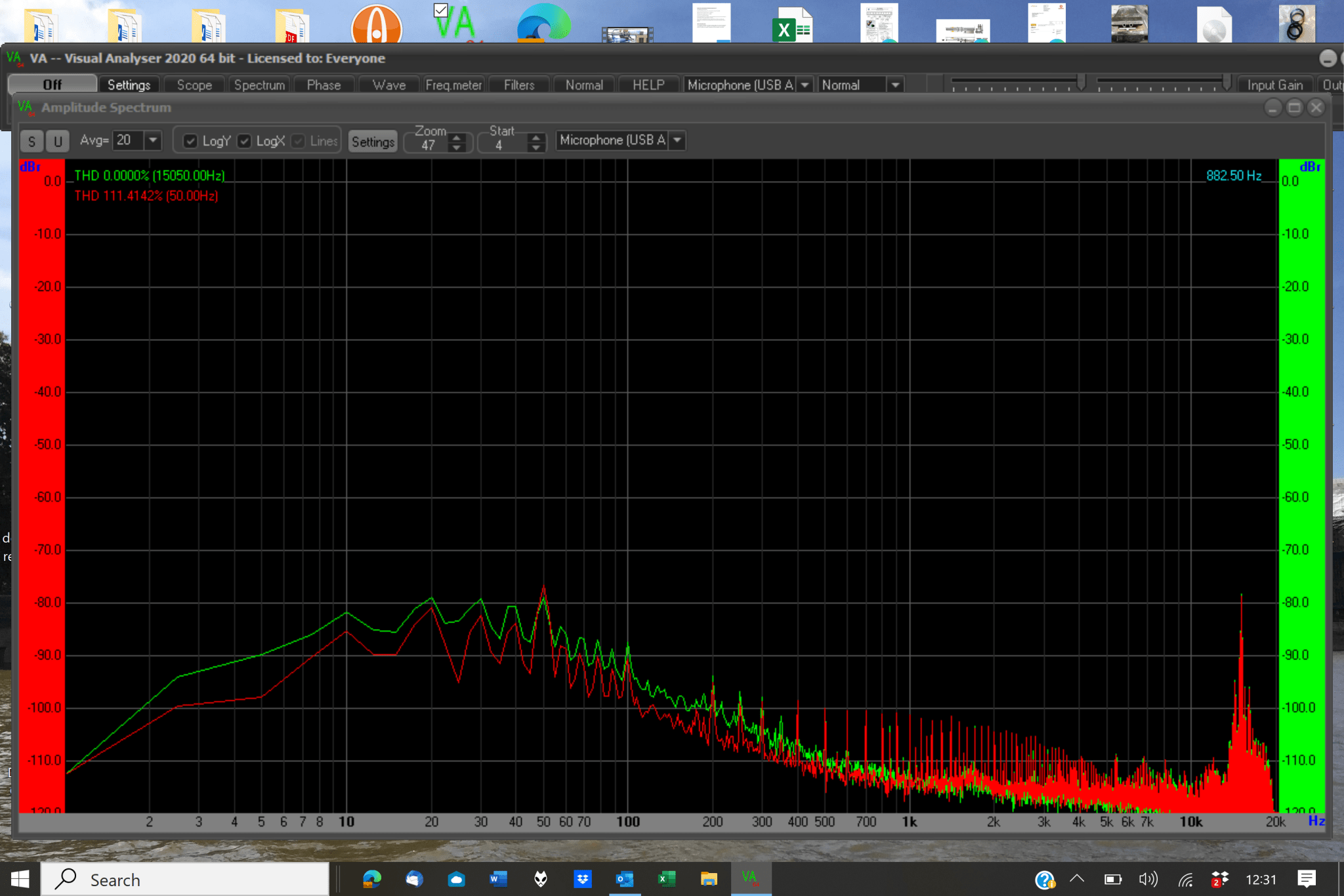

the previous wiring test measurement that caused the suggestion to improve the wiring was 2098.
An equivalent now is 2121.
I haven't done any swapping round etc, i tend to feel that's job done on this aspect? - or would that still be considered poor?
The 50Hz hum is a bit reduced and the signals similar.
By the way that 50 Hz would be instantly recognisable but when connected to the power amp and speakers and at FULL volume, there is no detectable hum, only a tiny amount when i approach the TT.
More later when i have done some tests.
M
