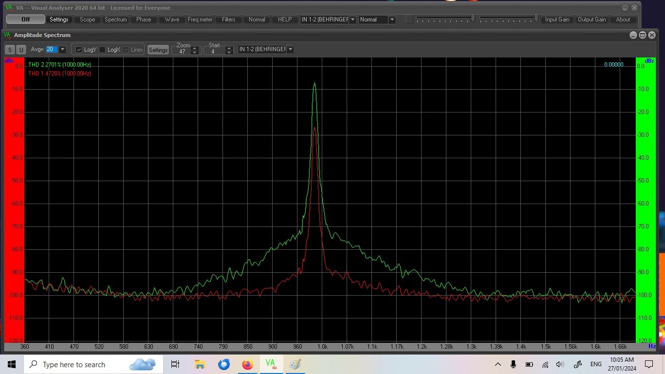

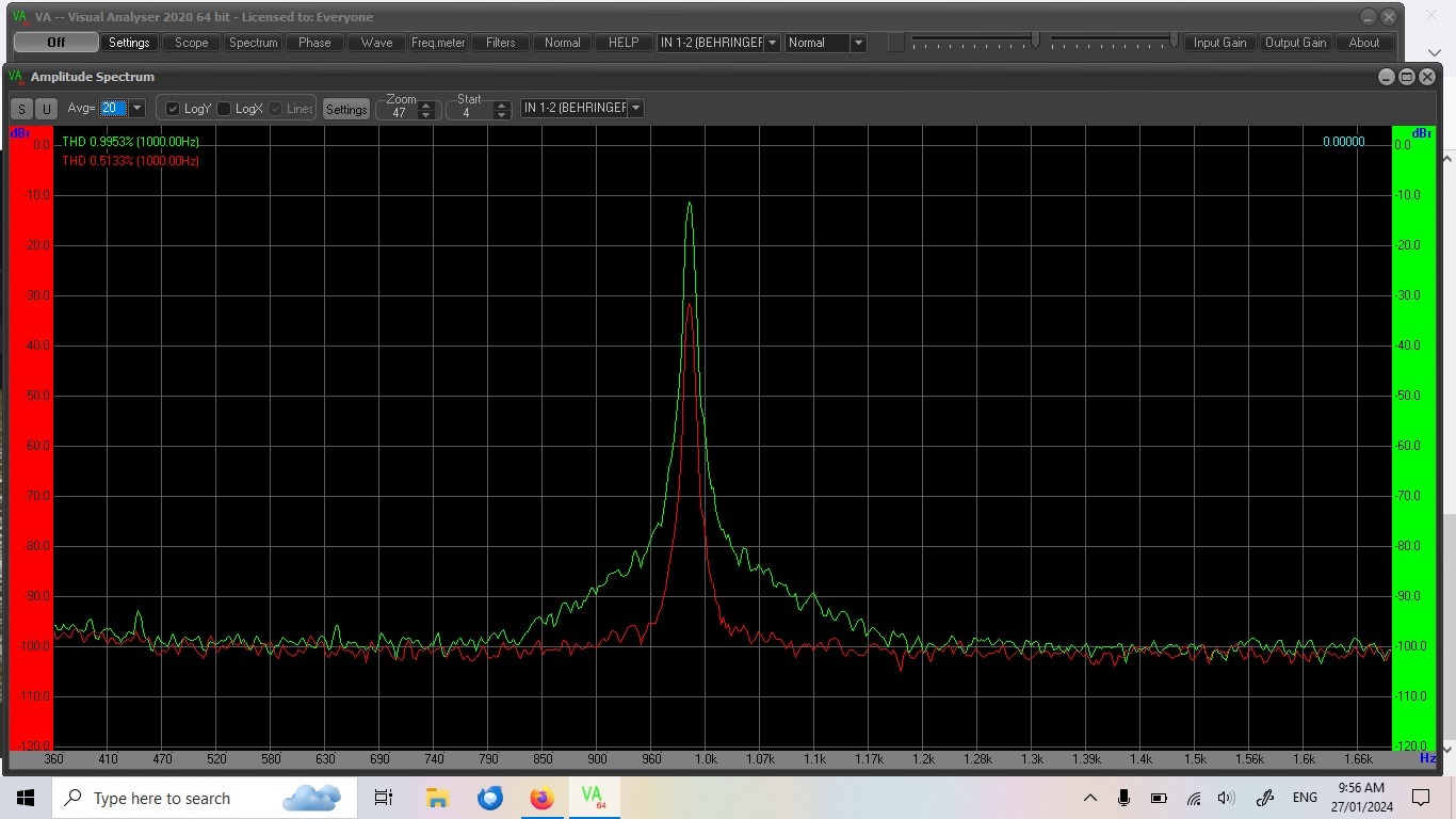

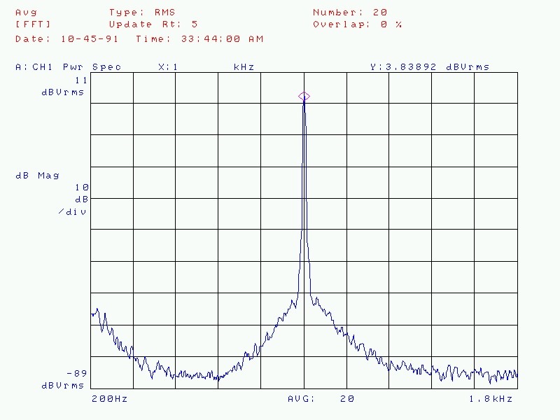

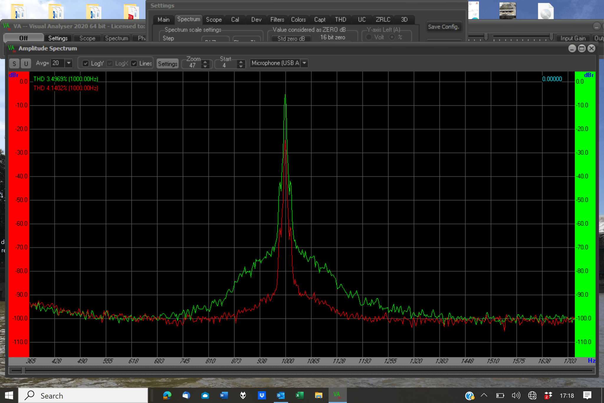

By the way, I used a new test record and saw the attached 1Khz tone measurements. i think a lot of the noise floor was on my old test record.
Reactions: carolus
Very impressive Mike! I guess improvements are now in material choices, bearing contact finishes, rail stiffness, parallelogram miniaturisation perhaps. But really you are there!! I’m new to this test measurement thing, what software/hardware do you recommend?

Hi Sether, when I first was advised to measure things by a couple of friends I was doubtful.
First, I wasn't sure i could do it, and then, why did I need to do that when i had ears!
Anyway, i soon taught myself a lesson there. Ears can easily deceive you! - and i don't have golden ears anyway.....
Every time i modified something it sounded better, well of course it did, why would i have modified it to sound worse?
Auto suggestion tells you that and you really believe it sounds better until you measure it and its clear the performance is worse, and it goes in the bin, and hopefully you learn something!
Then there are the small things you do that maybe you don't hear alone but could add up, so i am now a convicted measurer!
I would like to work out the small sideband at about -45DB if i could but have struggled to find the cause.

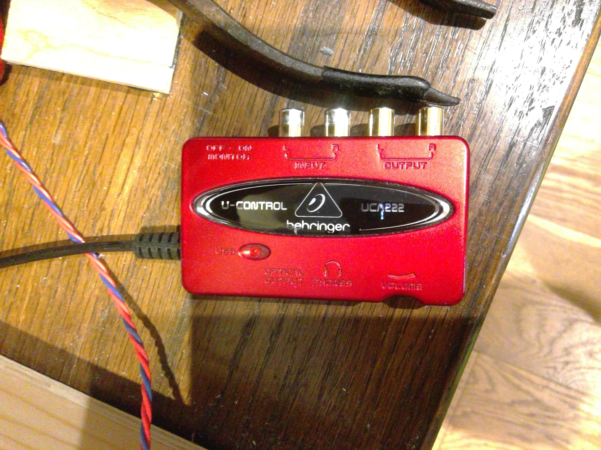

Unplug the phono pre leads from the input to the amp and plug them into an ADC, i was advised and use a Behringer, pic attached, USB connection and power.
Load Visual Analyser on your PC and play a 1000Hz test tone into it, from your test record.
Someone kindly wrote a tutorial for me which i will dig out if folk are interested.

@Mike56 I have been thinking about your 20Hz issue and here's my recommendation to diagnose it.
First I would isolate what is NOT causing it there is no guarantee that this is caused by the arm. It could be environmental or even the TT.
Looking at 2087 there doesn't seem to be a pounced signal at around 20Hz so the approx 20Hz could be the 3rd harmonic of 6 to 8Hz which could make it an artifact of arm/cart resonance.
To start with drop the needle on a stationary LP (use an old unwanted LP) and look for the 20Hz or a derivative of being present with the same analyser settings zoom in. If there is no 6 to 8Hz or 20Hz then you are a step closer to confirming this is being induced by the arm/cart.
Next I would use an impulse response test. Drop a marble on the LP and record it in Audacity. I used a surface plate indicator base with an alligator clip to ensure I dropped the marble in the same place on the LP from the same height. NOTE: Audacity's built in spectrum analyser does not have the resolution so use a different analyser to inspect the results. You want to inspect the results in both the time and frequency domain.
Also be aware that you are working at the lower limit of the test setup anything under 20Hz could be unreliable,. Perform each test multiple times and look for both consistencies and inconsistencies between each test, any test that falls too far from the expected result disregard. If you run each test 10 times you should have a Gaussian distribution of the results.
Here is my TT for reference.
One interesting thing to note is that VA shows the TT running slow but my HP 5316B frequency counter says the TT is running 0.6% fast.
Also note the difference in the base of the plots, this will be artifacts on the LP.
1st plot is The Ultimate Analog Test LP Track 2 and the 2nd is Vinyl Check Part 4, both show the same channel.

Whilst my image 2084 appears to show the TT is spot on for speed, 1Khz =1Khz, i guess you are saying this may in fact not be the case due to software and measuring errors? - i am not looking for problems that don't exist so i shall concentrate on those little sidebands half way down. they have been present with previous versions of the arm as well........
A wonderful hobby this, i read Warrens useful input and, Warren i took some measurements feeling sure i could interpret something.
Unfortunately all it taught me is how little i understand.............

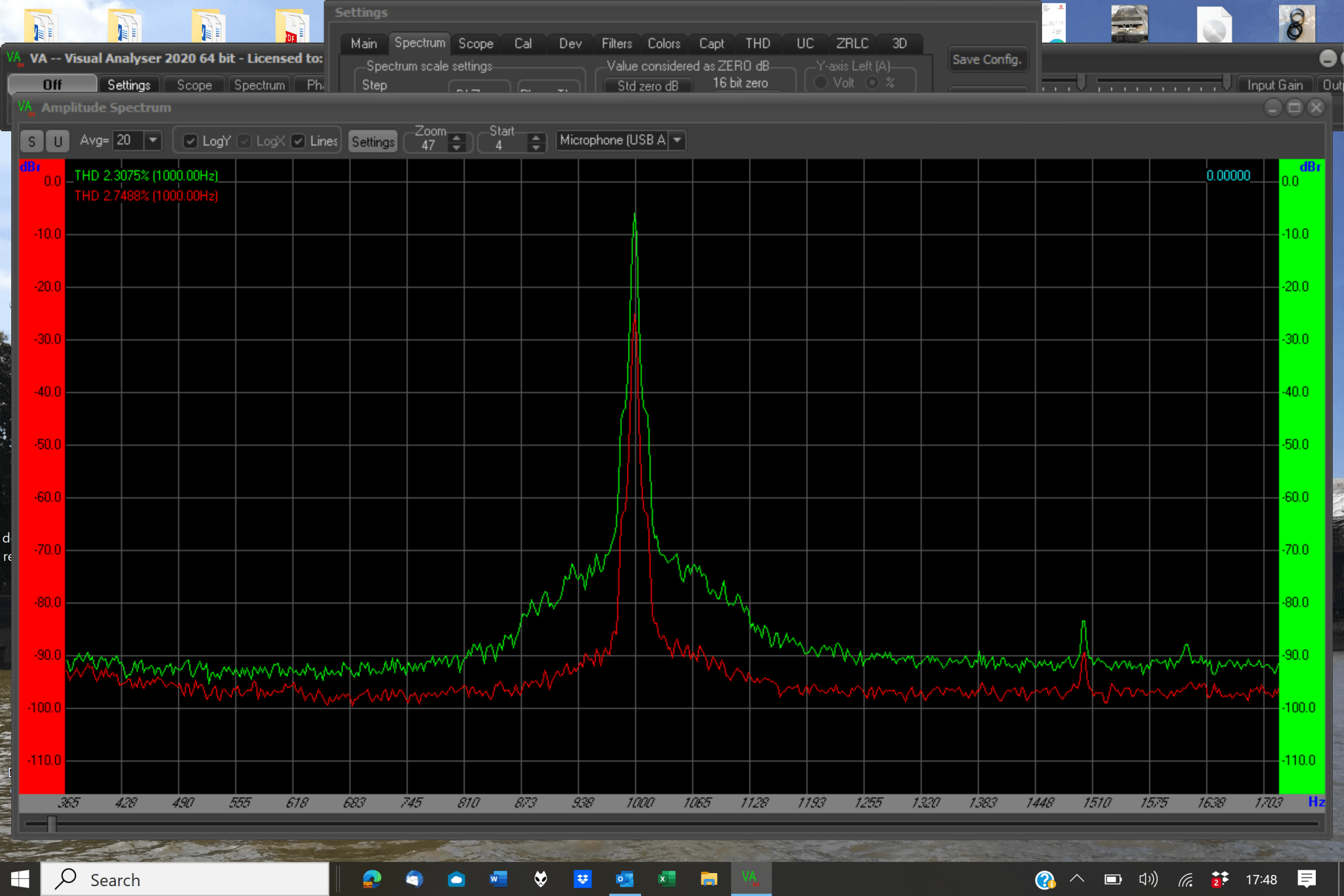

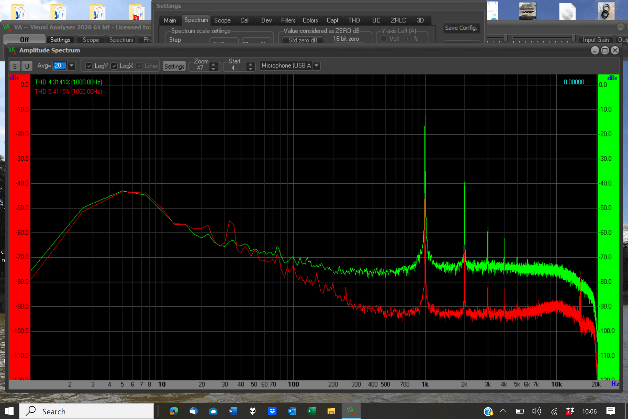

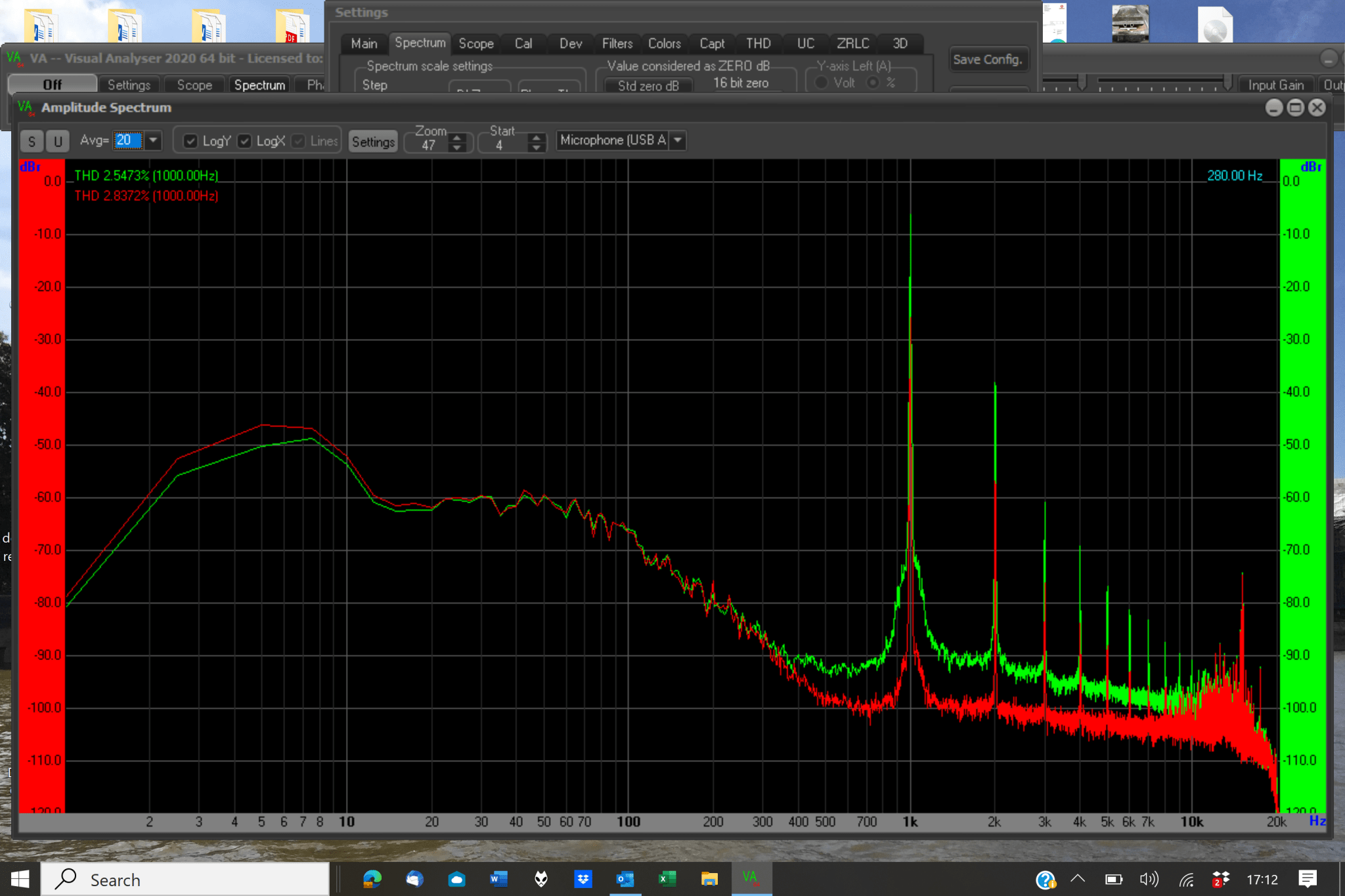

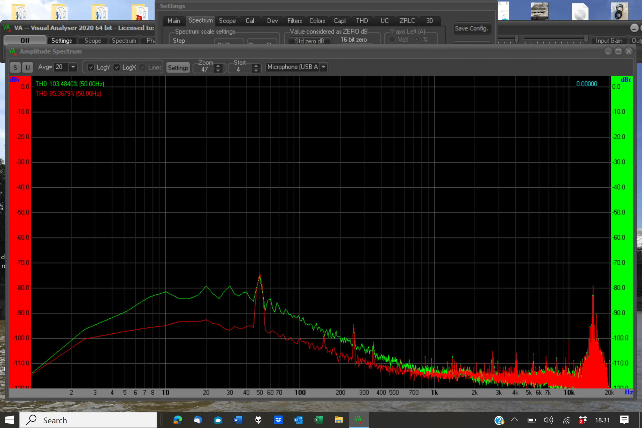

First, disc stationary, stylus off disc
Second, disc stationary, stylus on lead in track

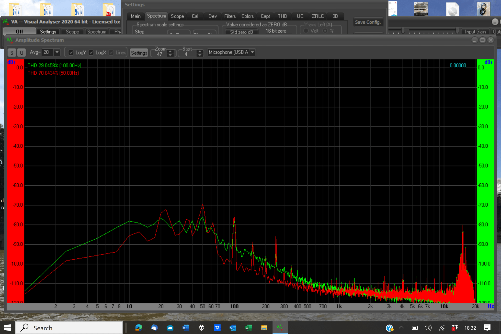

Third, the previous full range measurement
Fourth the previous 1000Hz zoomed in
So, as Warren suggested, i should be able to work out something from this.
Does it tell me the sought after sideband, apparent in the fourth shot is created when the TT is switched on or from the arm when its tracking the 1000Hz, also with the TT switched on.............is it the arm, is it the TT

@Mike56, my first question is why do you have a difference in level between channels under 1kHz with nothing playing. Swap the inputs to the Behringer if it stays the same the issue is in the Behringer or VA. I don't use VA much but I do know it has customisable filters, make sure these are all bypassed.
There are small 10, 20 30Hz peaks on 2098 are these the cause of your 20Hz sideband? it's not possible to say for sure. Switch the TT off and see what happens to these peaks.
Then I would excite the arm/cart with an impulse so see what happens. You will need to record these impulses with Audacity, just viewing in VA is insufficient.
With the stylus off the LP tap various parts of the arm structure,
With the Stylus on a stationary LP drop a marble on the LP.
I would take a minimum of 5 samples of each test then average them. If you export the Audacity files as audio you can import them into REW which has the capability to average the individual traces. The reason we take multiple samples and average them is that many samples of a test averaged will come close to the actual result. The more samples the closer to the actual result we will get. This averages out any erroneous errors.
Unfortunately you are past simple testing to make improvements. There are more things happening in the playback chain than a simple 1kHz test tone is going to tell you. From here on you will be on another learning curve. If we do it in the forum then others can learn along the way.
