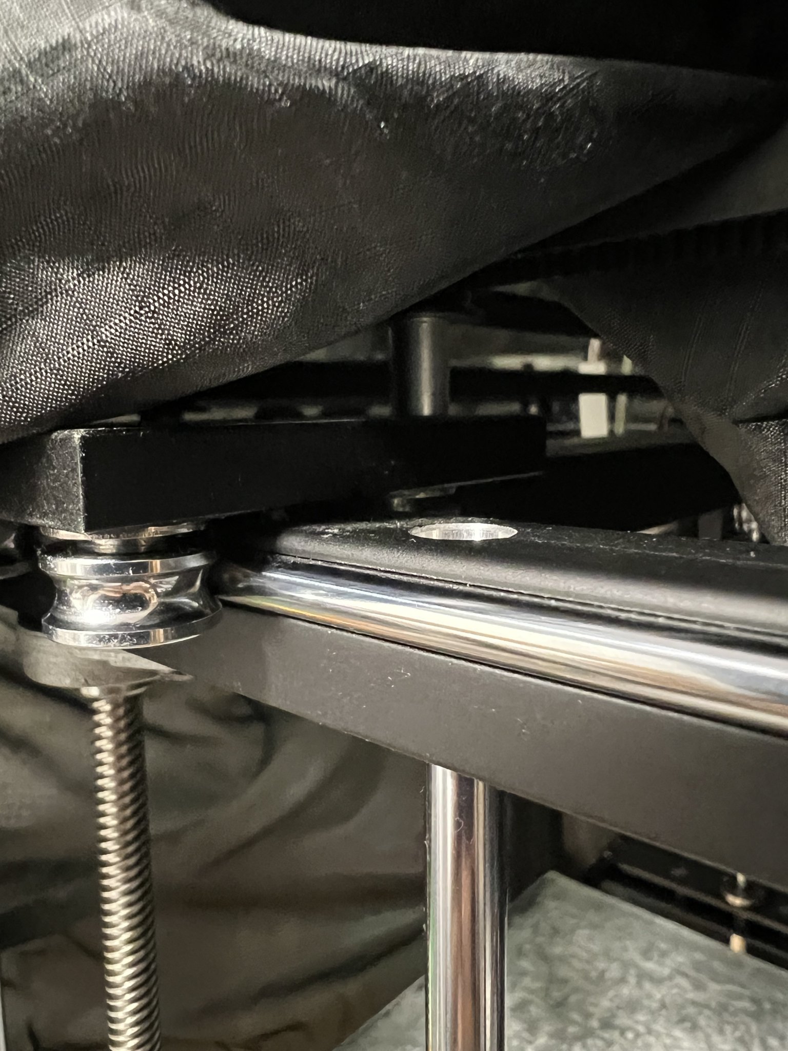

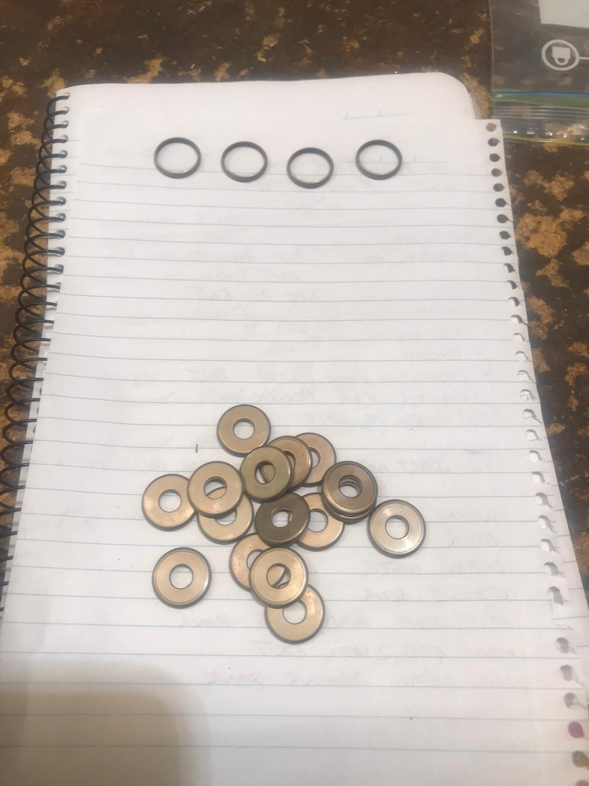

@warrjon I did encounter a few design issues with the clamp approach. Mainly that by setting the rails into the GFS this by default brought the pivot axis down. With my design the smallest wheel diameter possible is 17mm with an axle diameter of 2mm. I’m planning on using 1.2mm TC for the pivot points and sapphire watch glass wheels. Your rail carrier/clamp would have to be reduced in height to accommodate the axle shown in the render. This may impact on rail stiffness, IMO stiffness of the rail is a crucial part of this system. The wheels however, do look the business, beautiful!
S.
S.

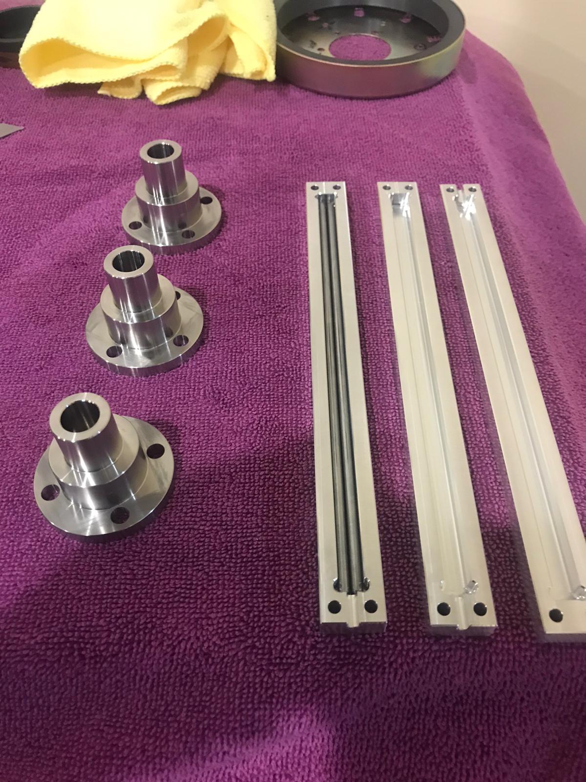

@Sether my rail design is slightly different to yours. I've gone with 6061 T6 aluminium CNC machined so the 4mm rods drop in a pocket, I have already used this rail assembly and know 16mm OD wheels will fit and operate correctly. With all the work so far to ensure everything runs as true as possible I was scratching my head with a way to hold the carbide rods straight while the epoxy sets.
Rails are on the right. There is a 3mm channel machined in one end of the rail so the carriage can be easily installed.

This time all the machining has been done by a friend who is a Toolmaker on 4 and 5 axis CNC machining centers. He's done a great job. The rail was machined from much larger stock and constantly rotated to stress relieve the Al.

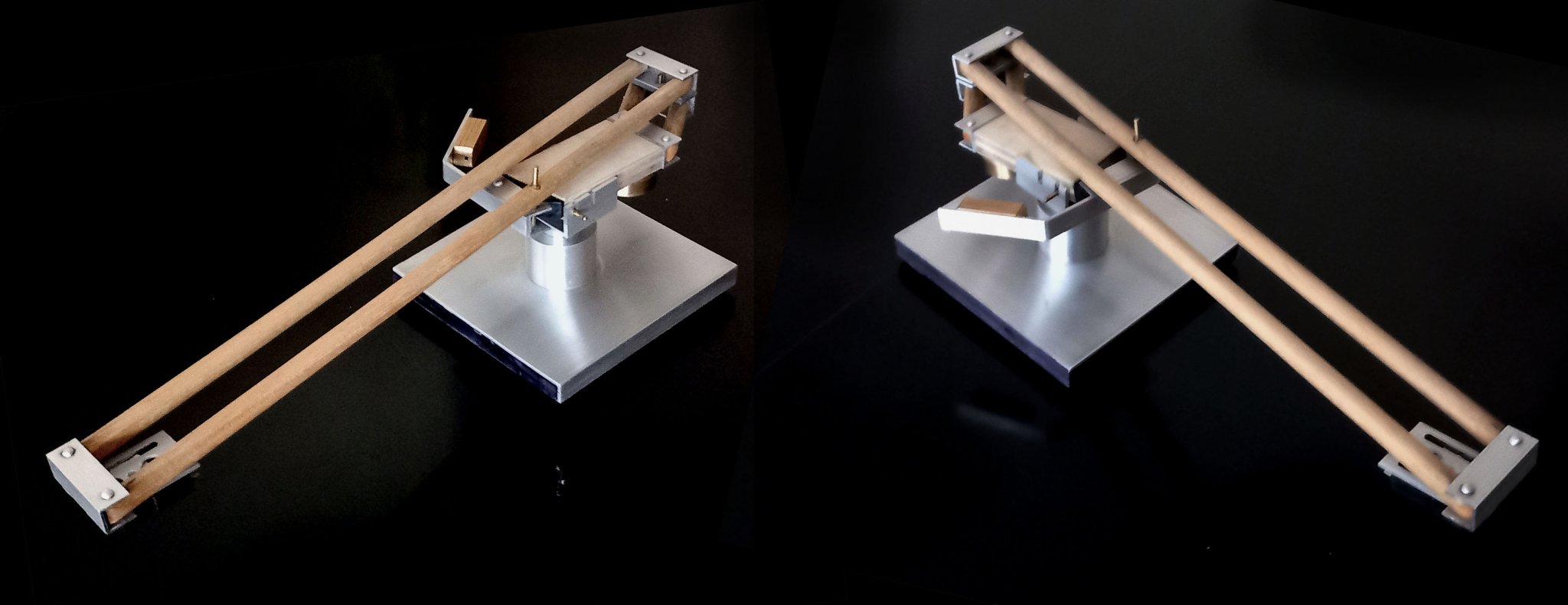

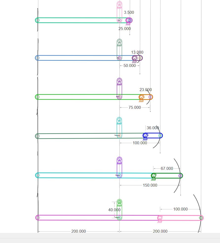

Easy Π, a true linear pivoted (ie linear on a radius, not tangential on the Thales circle), p.256 #5112

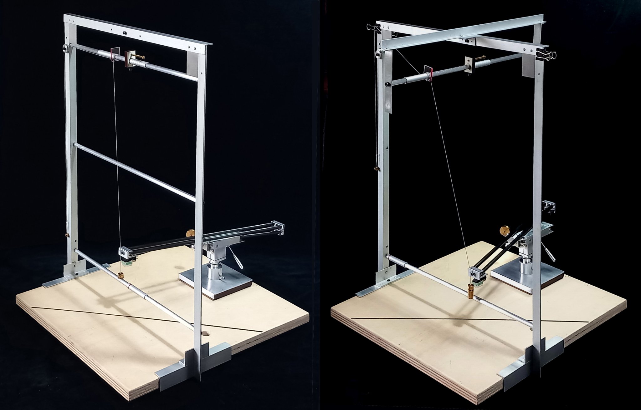

To each one (or two?) interested, sorry for the delay, I listened to music more enjoyable than test discs.

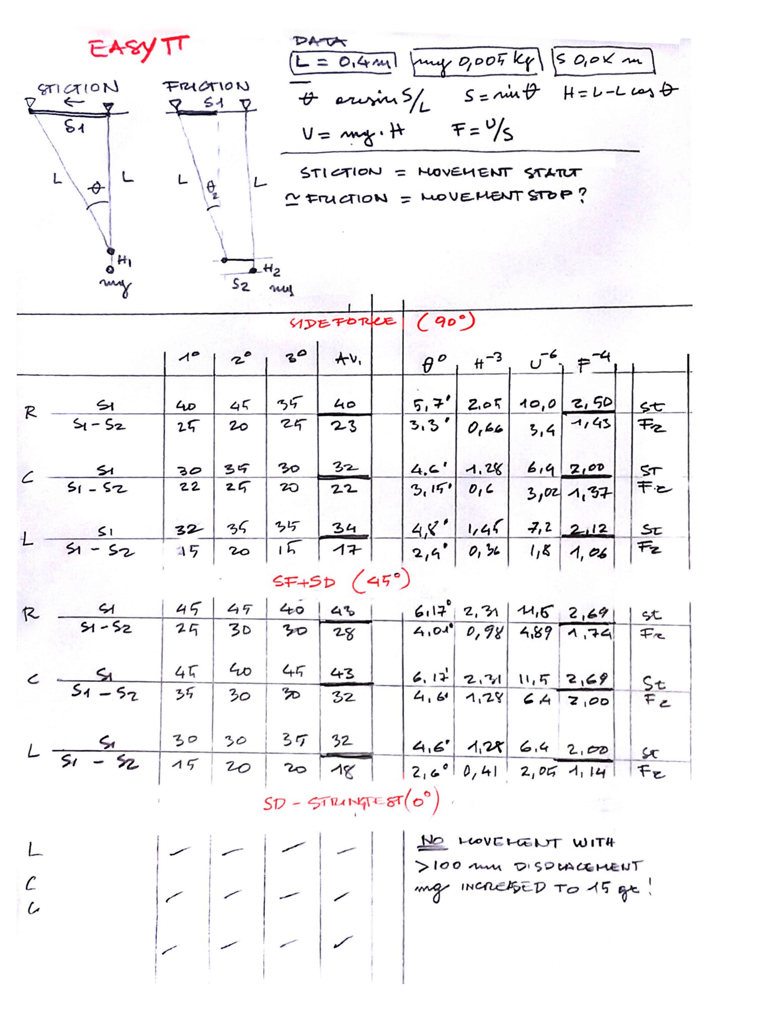

After the warp+eccentric tracing test, already posted, here are my usual tests with the reverse pendulum for the friction due to SF, SD and also the SF+SD at 45° (verifying a promising simulation in Algodoo) and a new one with my "Torquemada" gadget, to check the coherence between the two articulations (elliptic vs circle headshell motion).
Useless wasting time with subiective comments on tests, everyone may compare them easily with his linear realizations

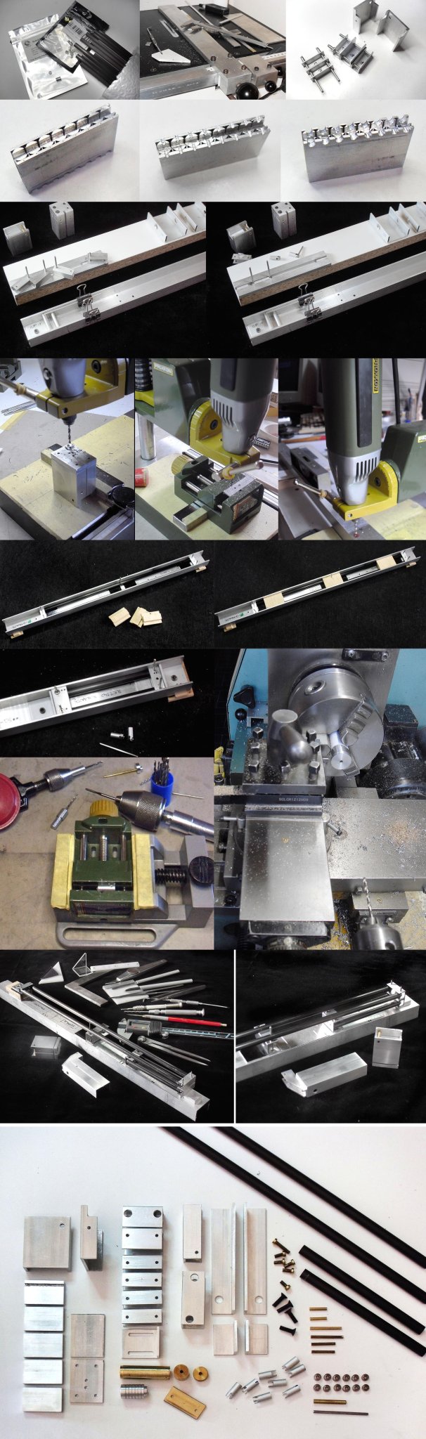

Added also some photos of the build process, which requires (without a mill, or someome else) some more patience than usual, and a very accurate assembly jig.

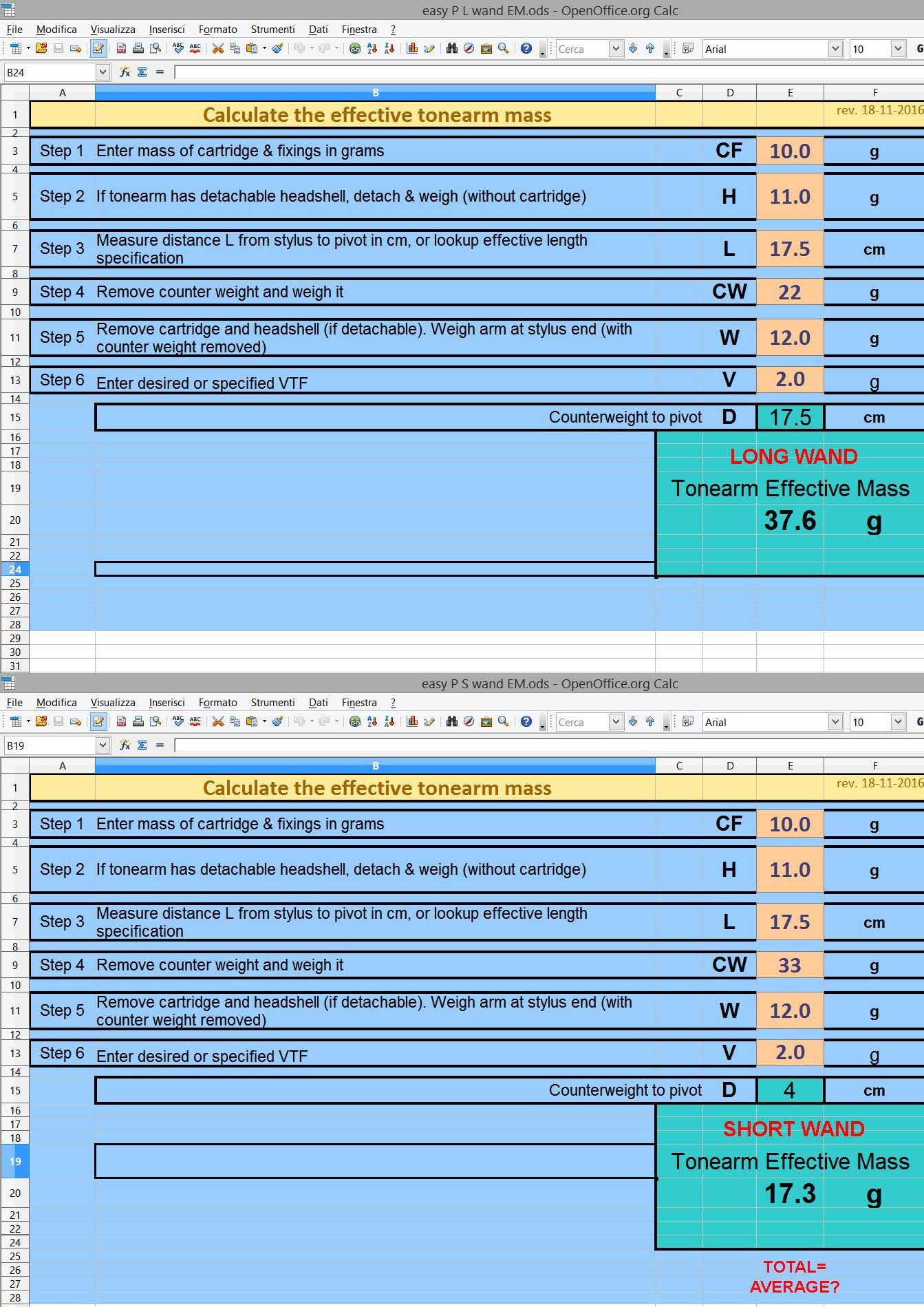

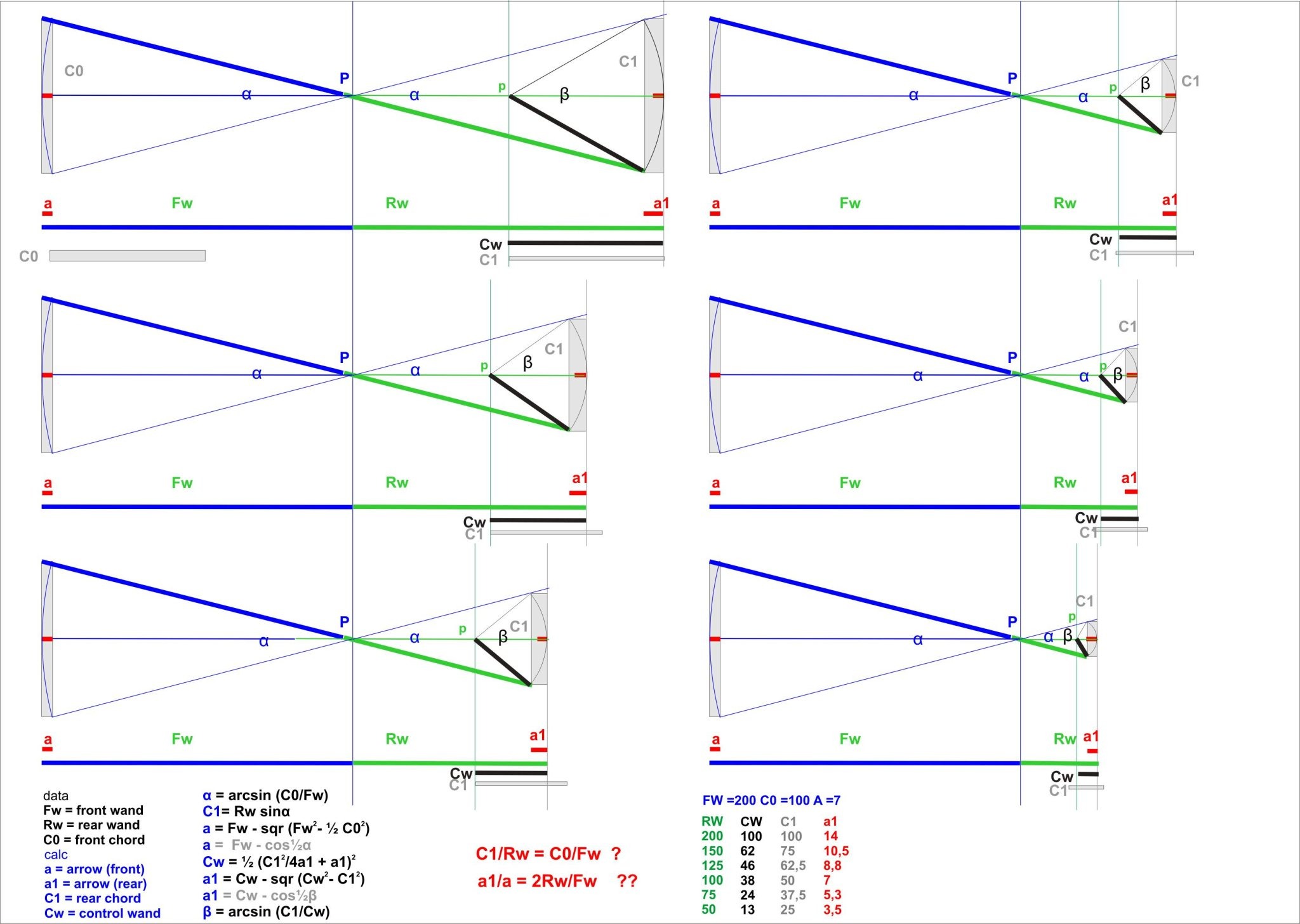

Then some thoughts on this "strange" geometry and possible developments (some sketches and calculation hypotheses, as well as simulations and a verification mockup) in order to get smarter levers, better bearings, and less effective mass = a long way to.

Hi Carlo,
Very impressive work indeed. Your test jigs are finished to a higher standard than I often end up with for my final product.
Does photo 3 prove me wrong? Is it showing a pivoting arm with zero skating force?
Niffy
Niffy
Yes, and No, Niffy
Yes - the pendulum confirms my simulations, the arm does not move with mere SD even by increasing mg to 15 gr with 100 mm displacement - in all positions - Right - Center - Left.*
No - I don't know if there is 0 skating, because as soon as the traction is a bit off-axis, SD seems collaborating with SF - the 45° test was aimed at precisely this, since the sim was the most favorable. (see data on my pencil notes - quite coincident 90° vs 45° measurements)
My guess is that the composition of forces perhaps explains the tracking shown in those videos #5112, up with my best radials despite quite a double stiction (10+10 BBs around!**). And maybe there is also a never full stiction, because the bearings rotate at different angles.
My idea that this strange contraption is damn complicated to understand, for me.
Thanks R, N, S, M carlo
* simply because the headshell can't advance, geometrically ?
**but with various favorable levers

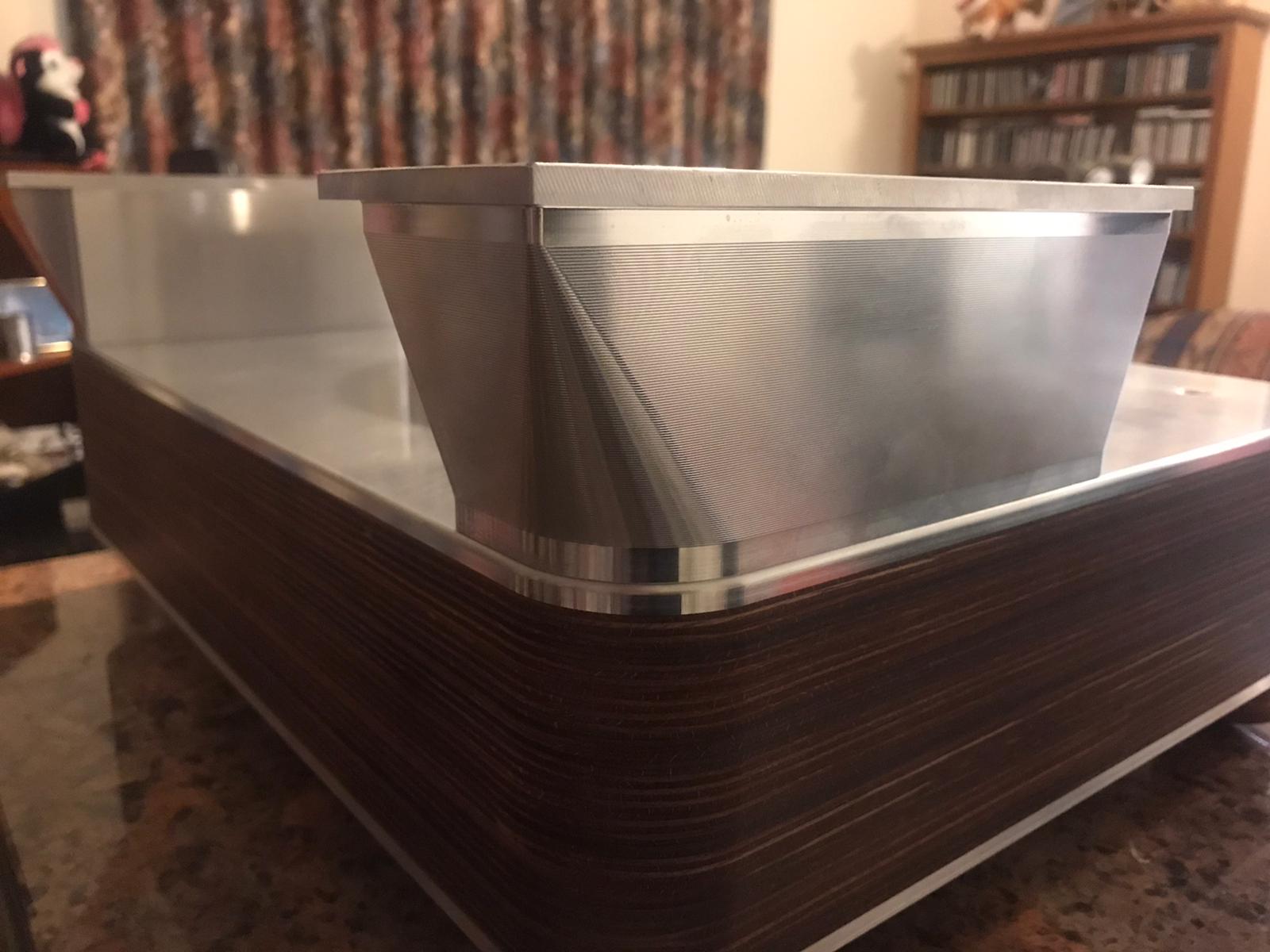

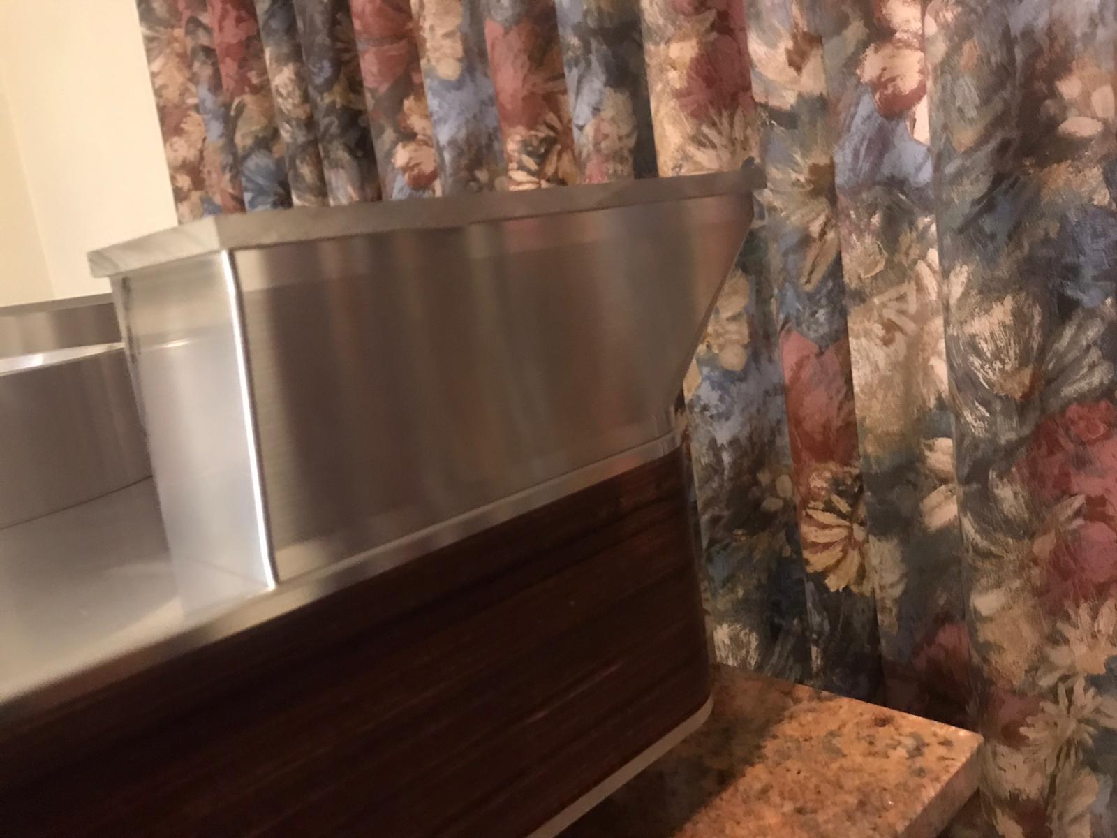

Wow, some seriously nice CNC finishes! Are you doing the CAD work? I like the honesty in the design of leaving the stepped CNC slicing against the glossy 90deg surfaces…nice touch! Happy new year everyone.
S.
S.
Impressive, Warren - it comes out from solid SS? a kind of material - 304 -316 - i've never succeeded to work decently (fault of the crap BV20, not mine ;-) And all those beautiful lines are single milling steps, I presume: it takes a very patient computer...
c
c
It's solid 6061 T6 aluminium. Machined in an Okuma CNC vertical mill so it doesn't take too long setup takes longer.
