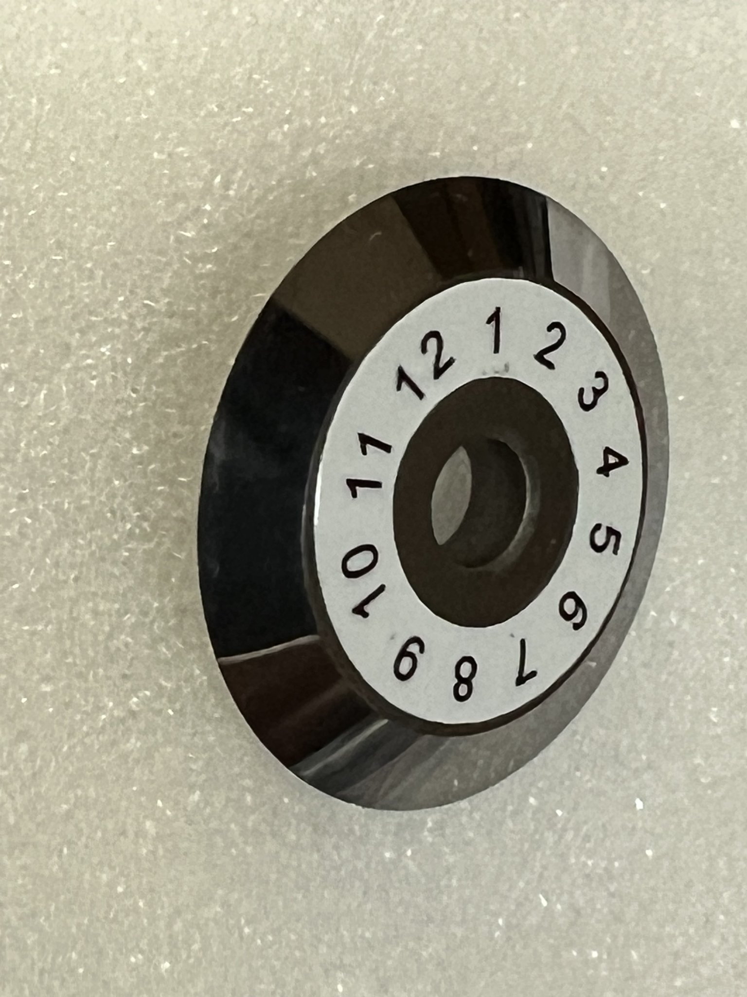

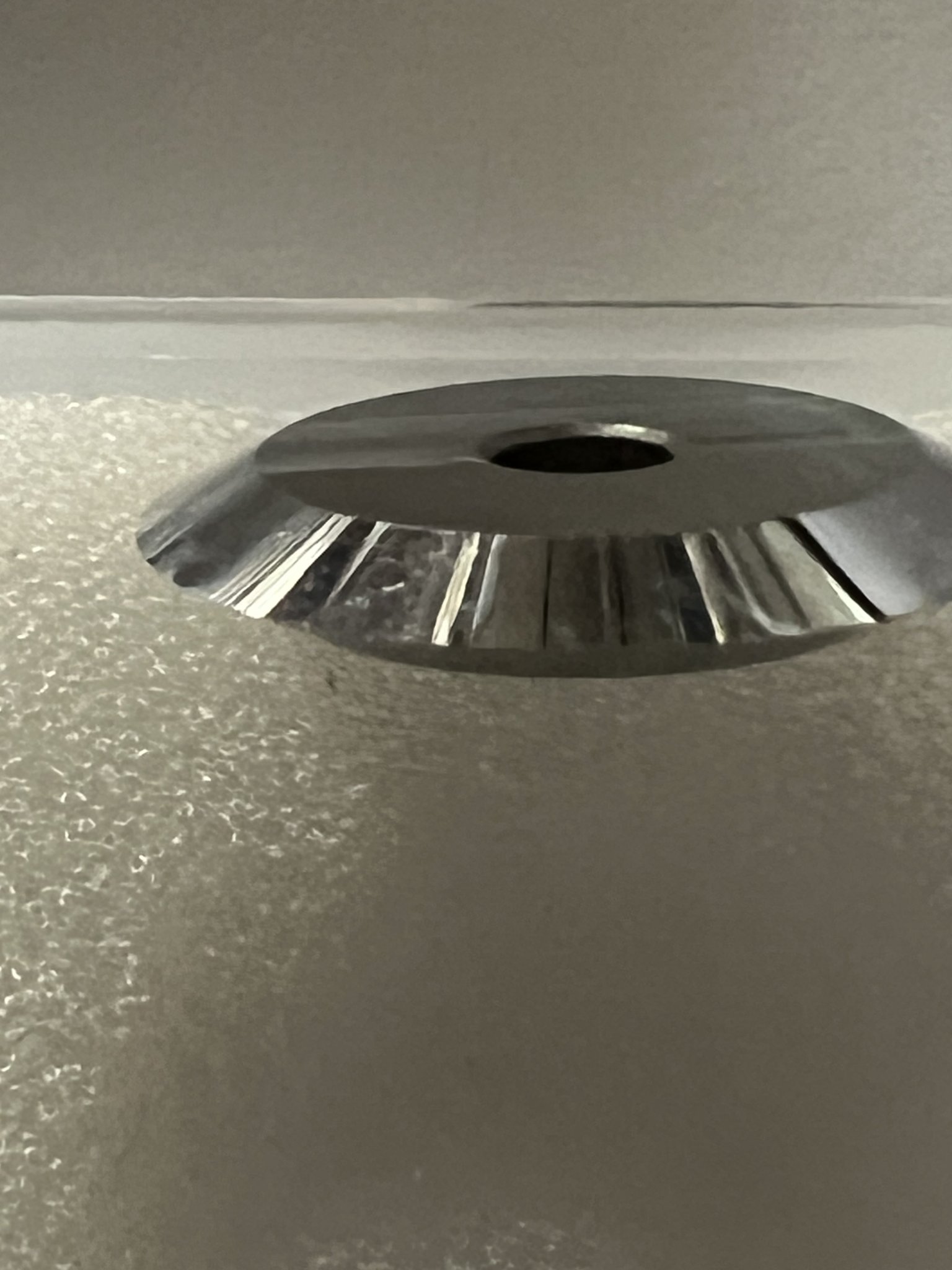

Sorry obviously I meant rail and not carriage. Arrived this morning, exceptional finishing on these wheels! Seriously sharp edge and no evidence of tool marks on the walls, very impressive for under £3.00.

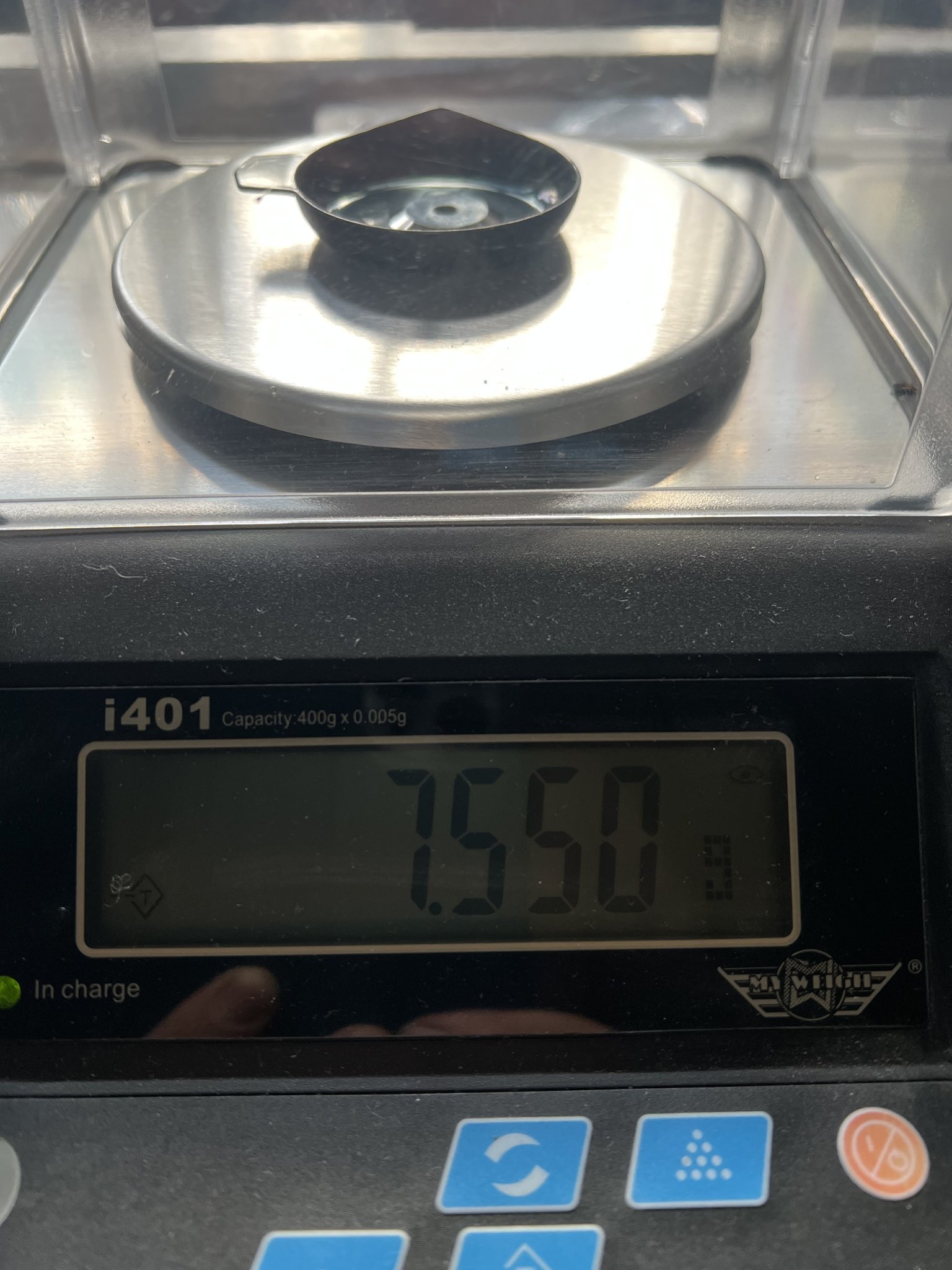

I’ll weigh them tonight, yes solid carbide 4.00mm ID so might be able to machine an axle to take the 1/8” diamond engraving tips. Quite a thin wall but possible. I’m working on a skeletal carriage with two keel ballast chambers to counteract the wheel weight and to accurately set the COG.
S.

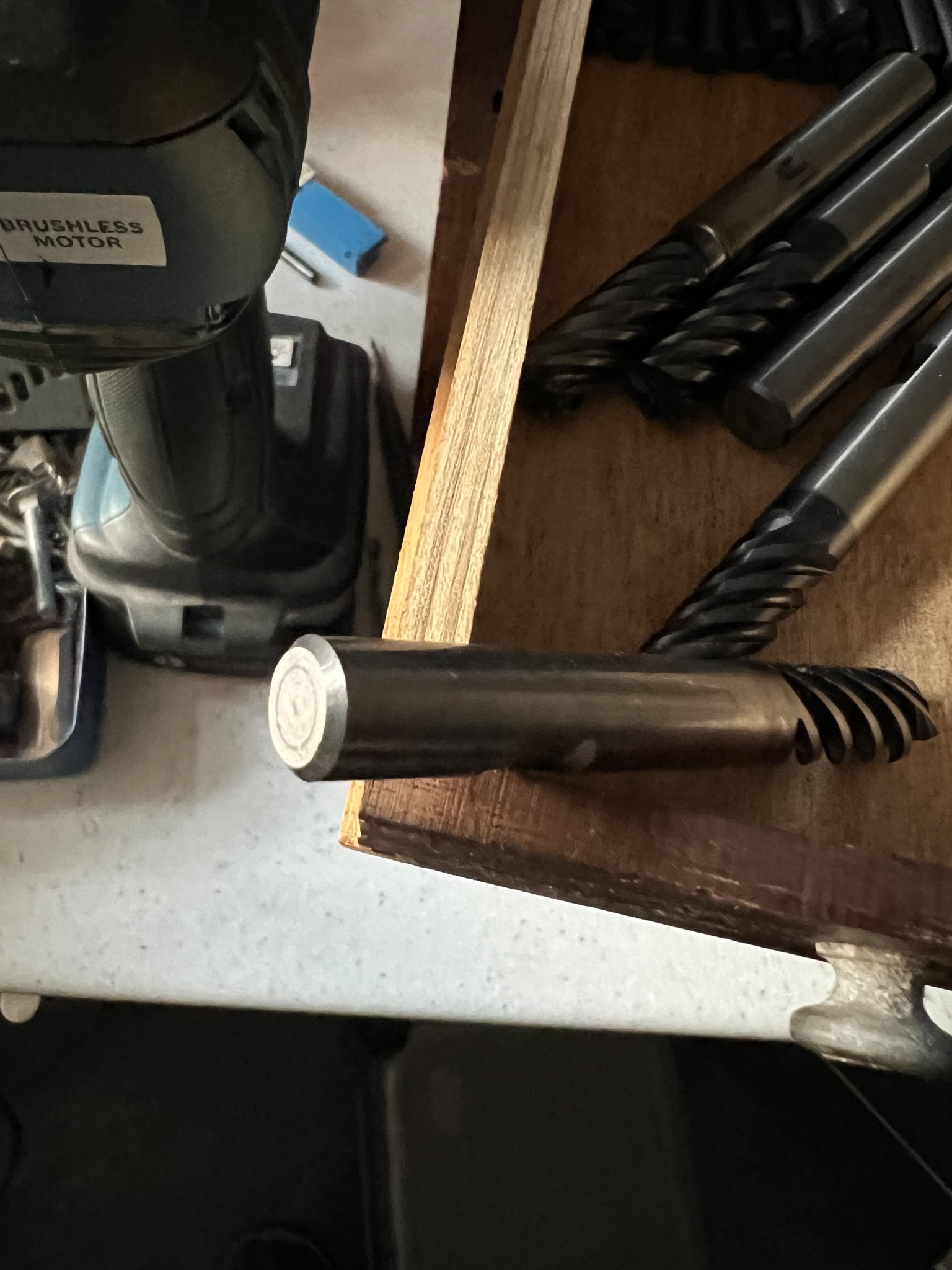

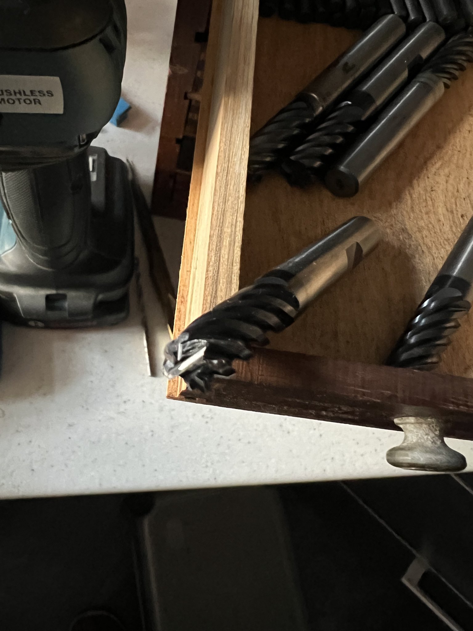

@warrjon if you’re having wheels made why not cut the end off a broken 16mm TC end mill with a CBN diamond lathe tool. I work with stainless a lot and these are notoriously brittle. Tend to break one of two ways, wrong feed rate or when changing the tool they fall out of the collet onto the mill table! Any machine shop will have a bucket of these with the good intention of having them reground but it never happens!!
S.

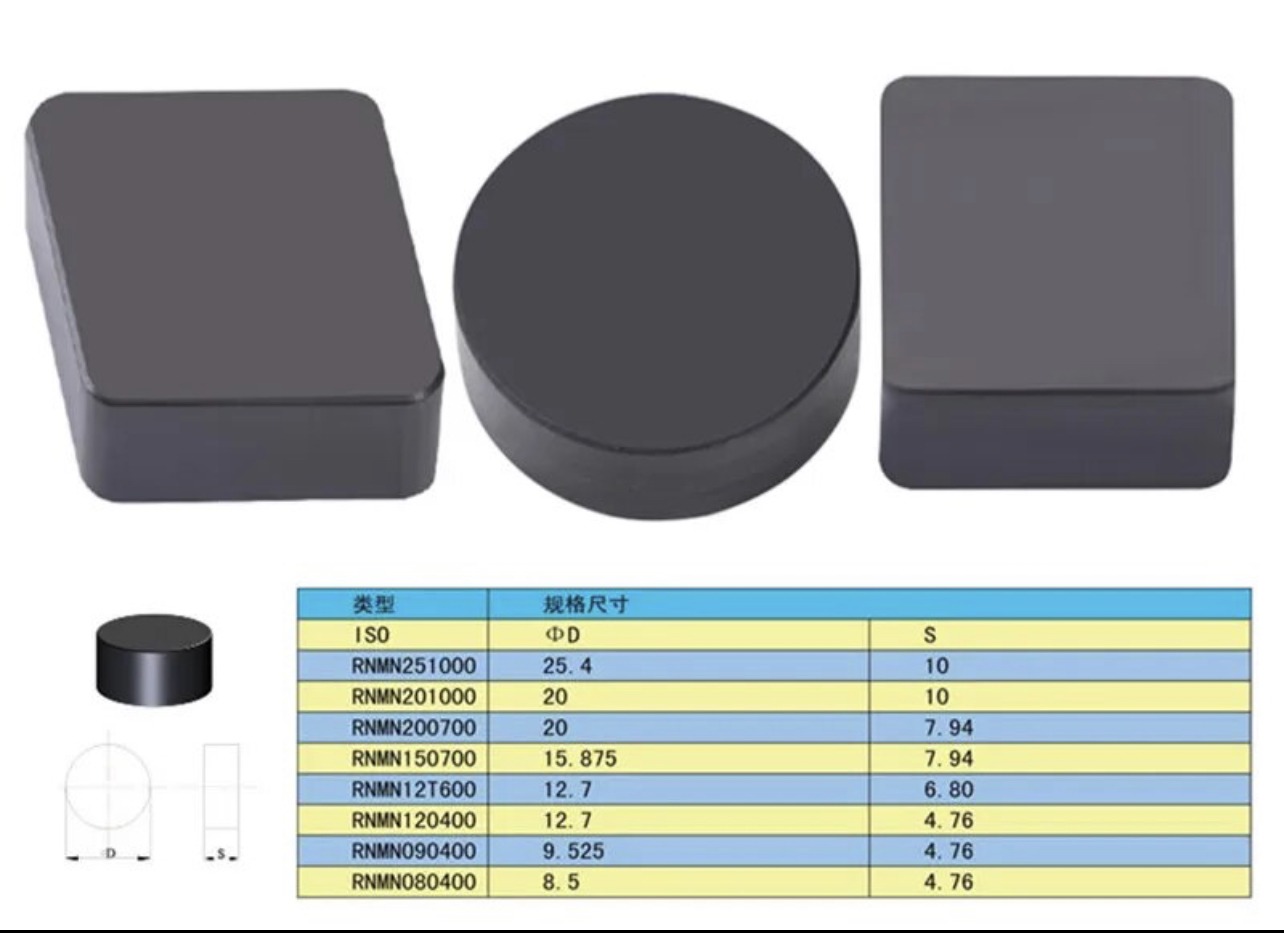

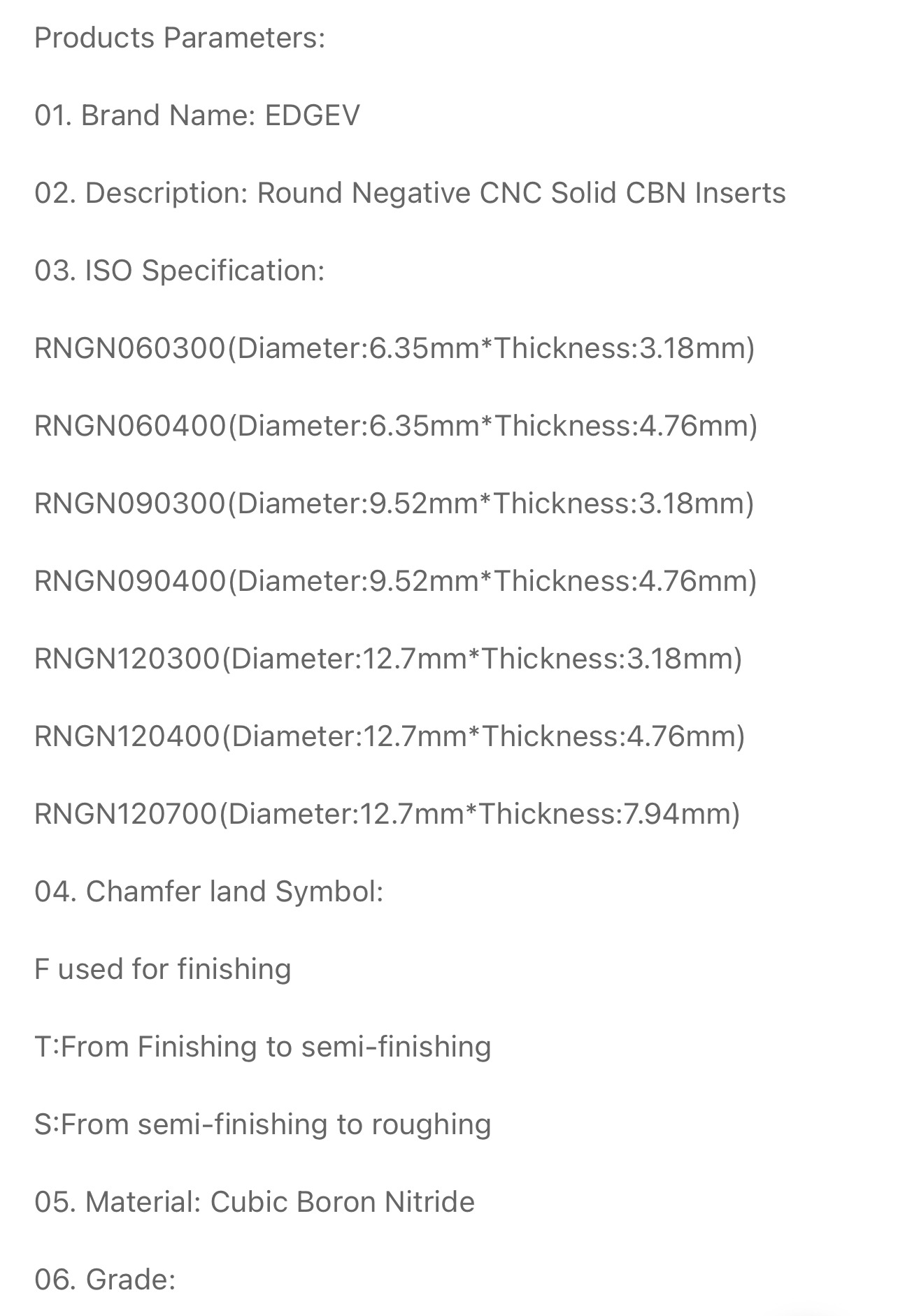

I mentioned CBN for machining TC. There are a range of inserts for indexable lathe tools. One particular sort are circular which could perhaps make good wheels. These would be very accurate, maybe more so than the sapphire windows. See pic

The advantage of tungsten carbide is its extreme hardness. Generally the harder the materials the wheels and rail are made from the lower the rolling resistance will be.
The disadvantage of tungsten carbide is its very high density, over 15g/cc. The entire wheel will be above the pivot point. Ideally we want the COG of the entire carriage (Inc cartridge, counterweight and wheels) to be level with the pivot point. We also want the pivot point to be as close to the record surface as possible in order to minimise warp induced wow.
If the wheels are very heavy the pivot point will need to be raised so that COGs of the cartridge and counterweight can be further below the pivot, balancing the carriage. This will worsen warp wow.
Making the wheels from solid tungsten carbide will result in the wheels being very heavy, raising the COG of the carriage.
Making only the rims from tungsten carbide and the wheels from a lighter material will result in the same low rolling resistance as solid tungsten carbide but with much lower overall mass.
(Although processes like anodising and nitriding will harden the surface of a wheel or rail the hardened layer is very thin, in the order of microns, and will not improve rolling resistance significantly. A rim made from a ring of material can be over a millimetre thick and will be much more effective.)
Sapphire does have the advantages of being even harder than tungsten carbide and having density almost a quarter of it. It has the major disadvantage of being almost impossible to work on in the average diy workshop.
Overall any design is going to be a compromise between weight, hardness, ease of machinability and processing, material availability and cost.
