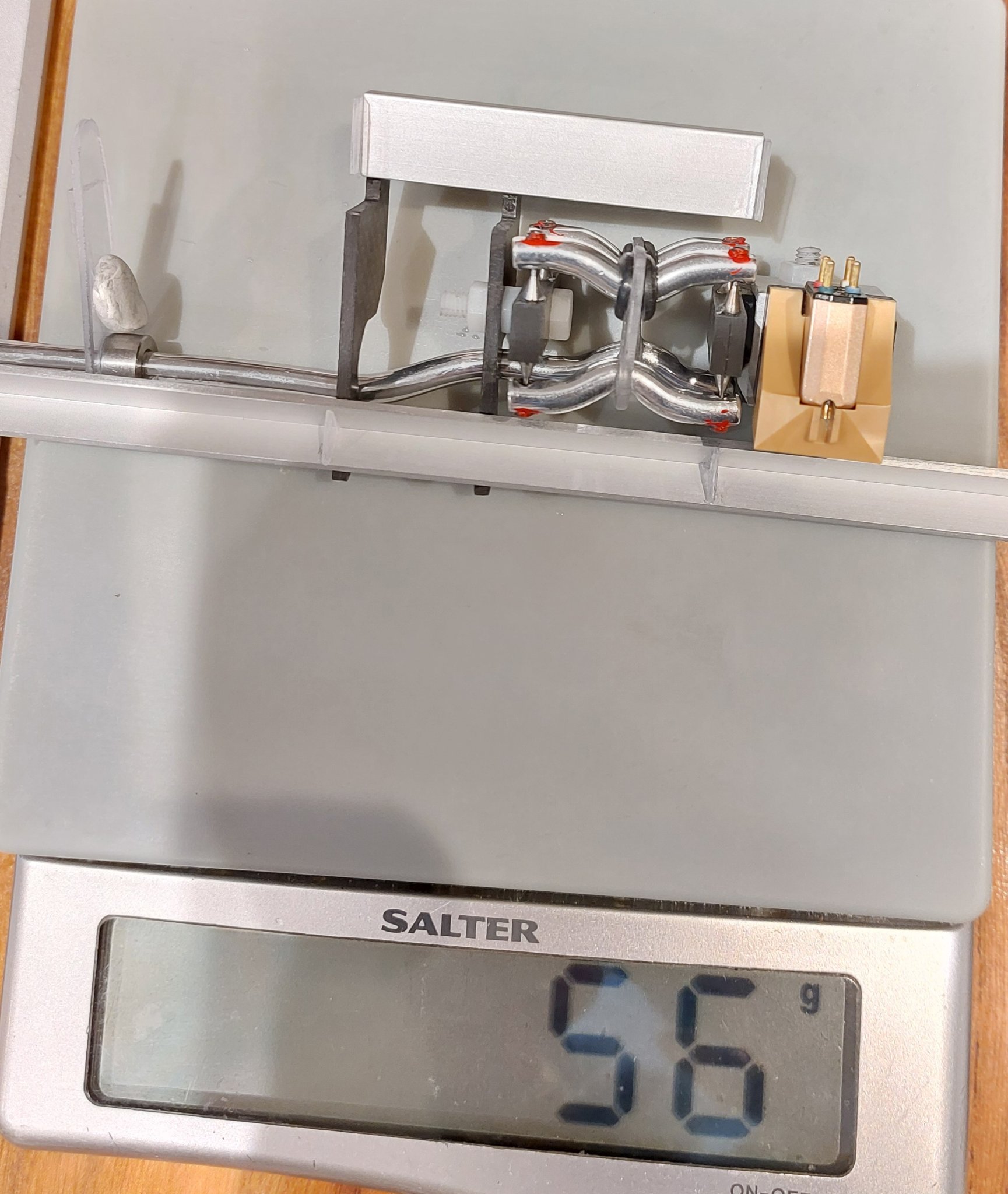

For some of you who may not have enough to do, please have a look below at my latest iteration.
It has a new lighter carriage, carbon crossmembers and lighter rear carriage rail, shortened also to remove unnecessary rail length.
It is now playing with the cartridge wires directly into my phono pre, neatly taped to its stand!
I always admire other posters construction standards!
It played its first side while i typed this up, all went well.
Auto suggestion kicks in here and tells me it sounds better.
Anything that takes a few days to make must sound better, mustn't it?
Sether may notice this has allowed removal of the front ballast weight, because of the lighter back end.
Horizontal and total mass are over 5gms lighter.
I cannot pretend i expected an audible difference, but very clean bass lines and tunefulness, clear top end are noticeable to me.
I will do some measurements at some point.
This will also allow me (eventually!) to lower the CW arm which will remove a small rising VTF in warp, a couple of 10ths in 5mm of warp, totally irrelevant (imho) in real life but i will do it anyway!

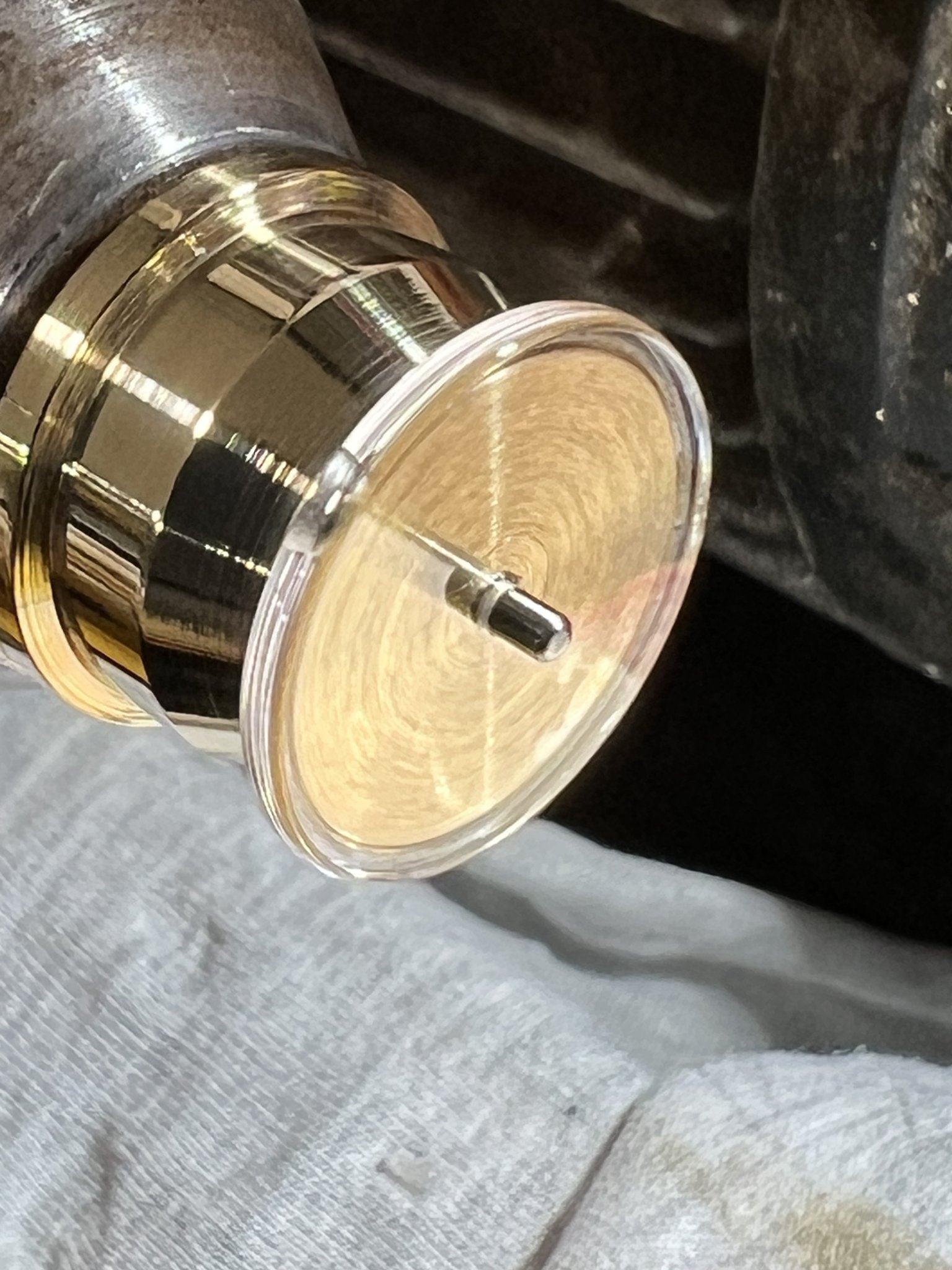

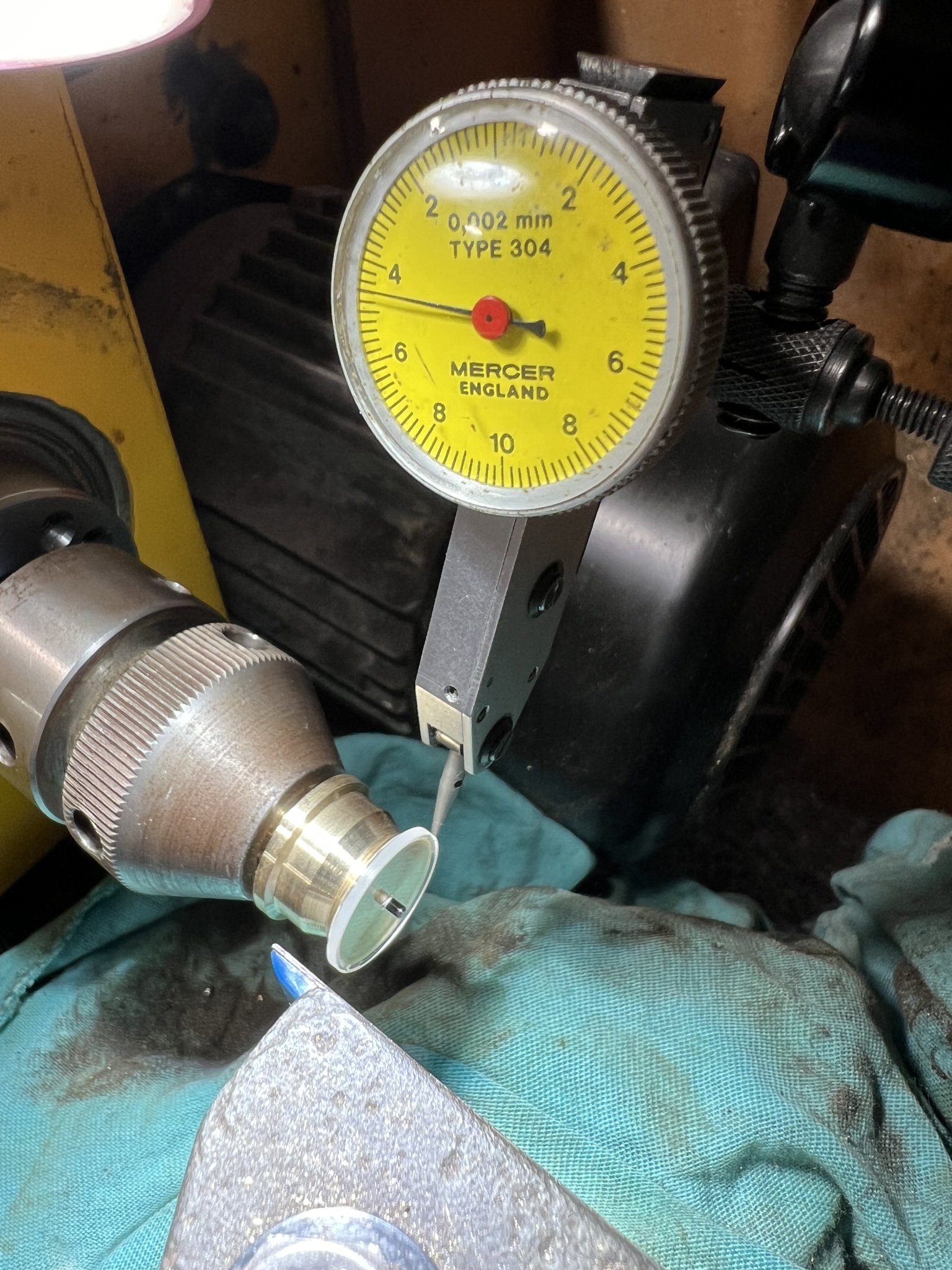

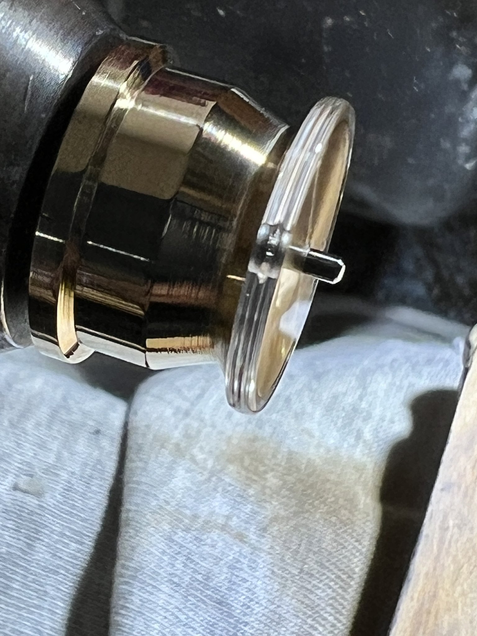

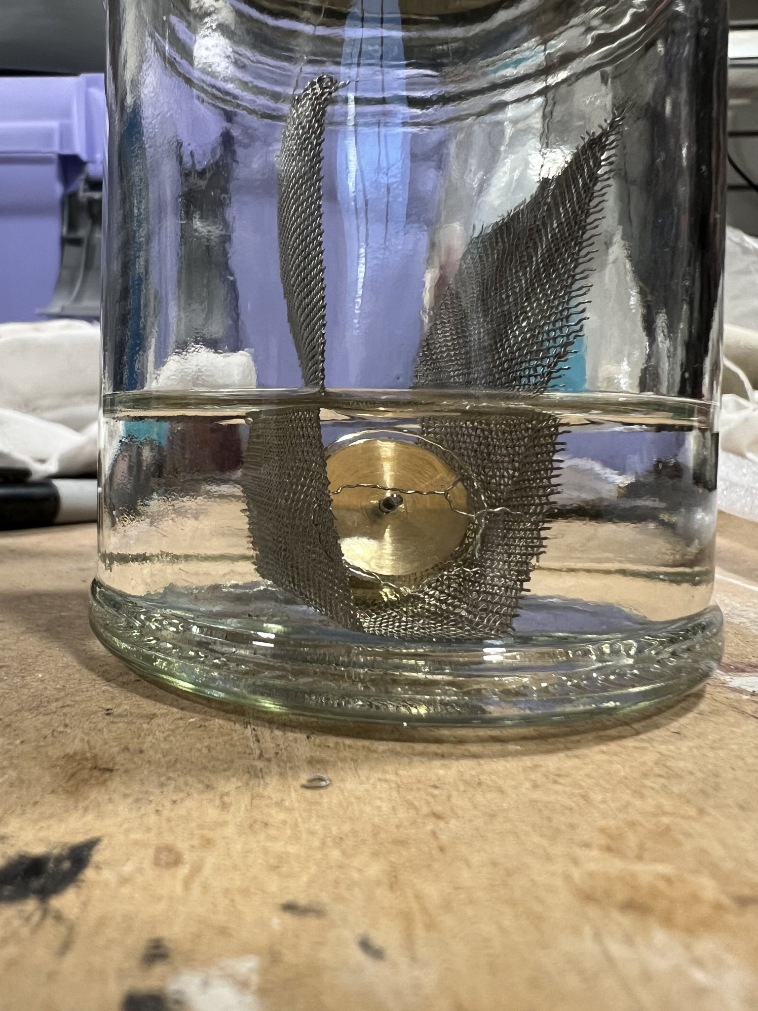

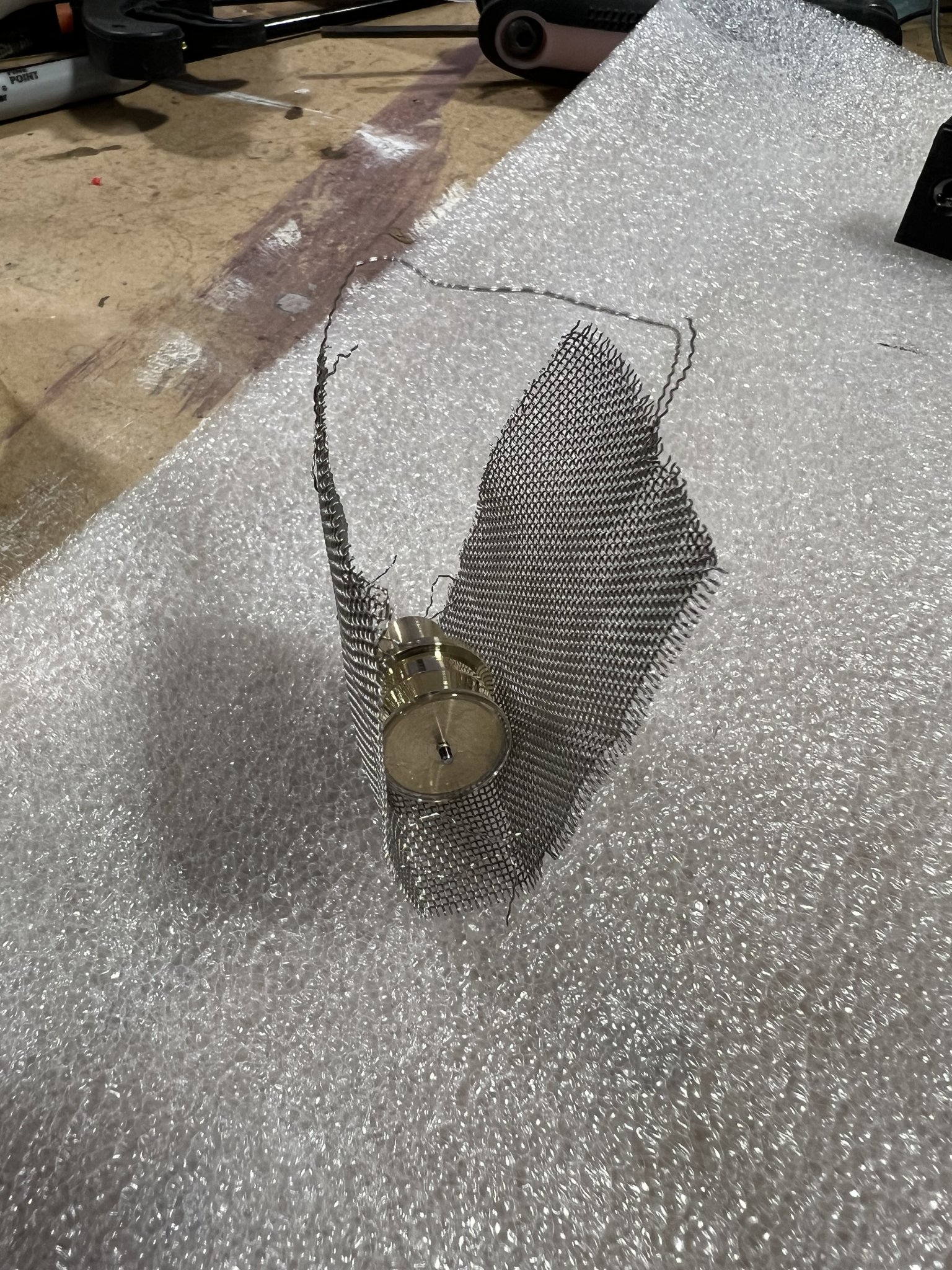

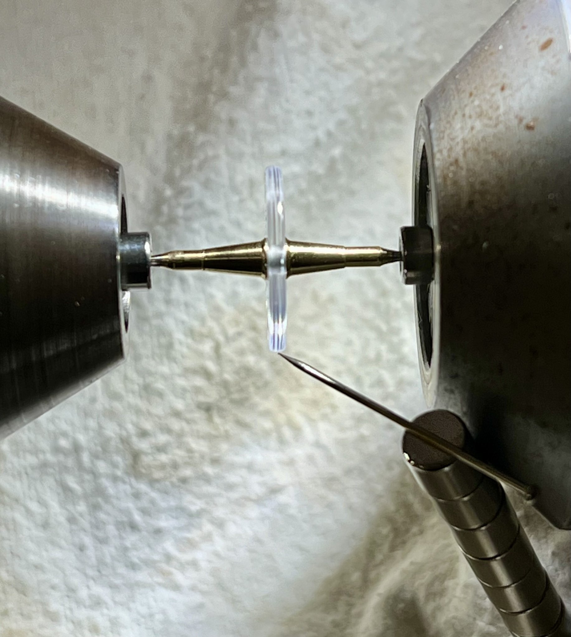

I also attach progress to the sapphire wheels
S.

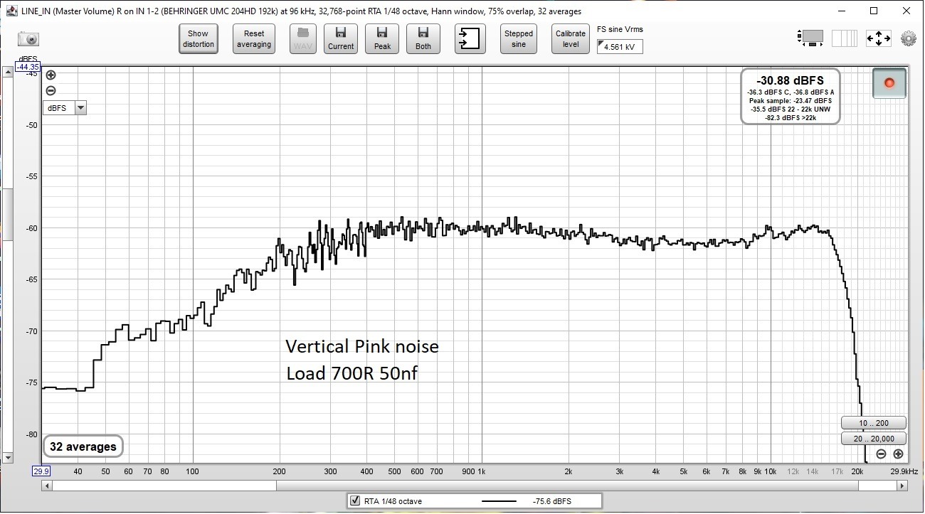

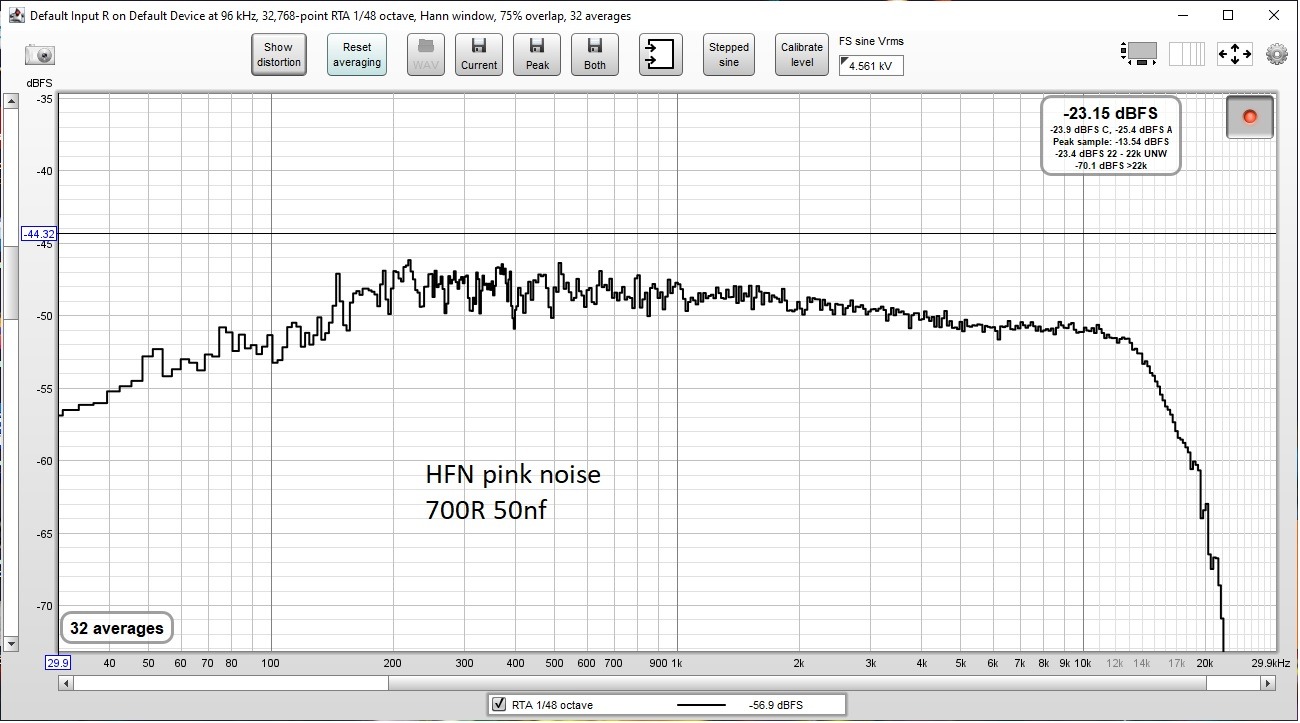

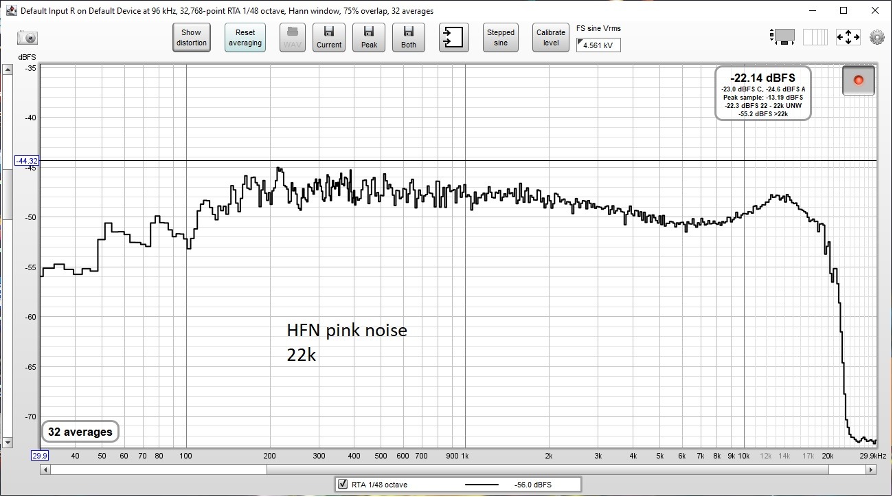

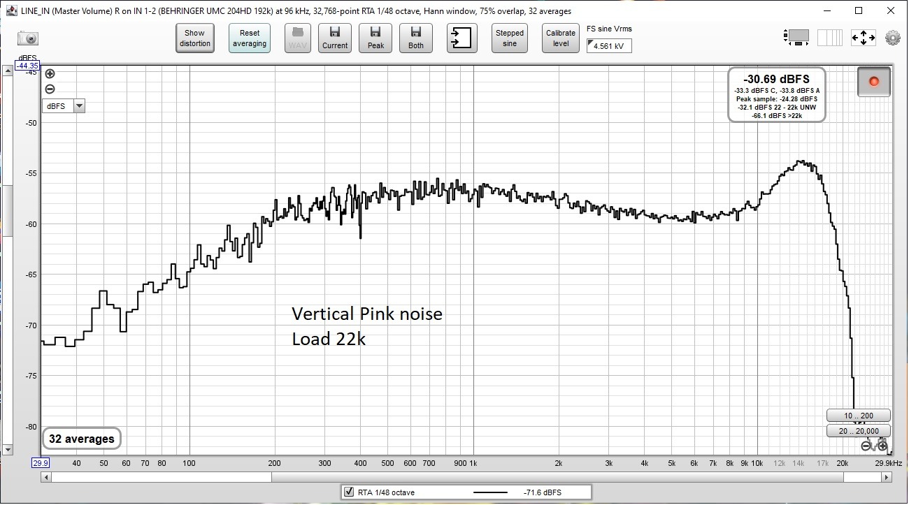

I spent some time over the past few days experimenting with loading. Here are the results. I guess the point of this post is to demonstrate you need to verify results as most of these test LP's have some error and quantifying this error as best we can is key to verifiable results. The uncertainty is still quite large because we have no verifiable reference.
Test LP's used
HFN Pink Noise L then R channels modulated
AP Vertical Pink Noise
Vinyl Check Frequency Response sweep 20Hz to 20kHz used to verify cartridge FR, results not shown as I only wrote them on a bit of paper.
None of the Pink Noise tracks were perfectly flat when compared to the VC Frequency sweep. The VC showed FR between 600Hz and 4kHz varied less than 2dB. Which correlates well with the HFN Pink Noise above 1kHz but the AP is off. Note that there was a difference in FR between channels above 4kHz using the HFN which is the tracks on the LP as there was less than 0.5dB difference in levels using the sweep, and there was no difference using the AP vertical Pink Noise.
These are identical loading showing the Left Channel, the only difference is the LP. The tracks are vertically modulated so I would expect the plots to roll off at about 300Hz. But here we're looking at cartridge loading so we're only interested in the plot above 1kHz.
AP test LP
HFN Test LP

"The tracks are vertically modulated so I would expect the plots to roll off at about 300Hz. But here we're looking at cartridge loading so we're only interested in the plot above 1kHz."
I assume this is below 300Hz Warren, as one can see in the plots, for interest why does vertical modulation do that please?
M
Plots are intriguing, do you also hear the differences in those results clearly?
The reason for the rolloff in the vertical modulation is because under 300Hz in an LP the modulation is mono (horizontal) too much energy for vertical.
I didn't listen to the pink noise only recorded the plots. But I would suggest it would be audible due to the level variation.
Hi Warren, no that first picture is just me roughing out the wheel and checking for flat spots. Total mass 1.395g before shaping and polishing. I’ve got the wheels as circular as possible with my equipment and surface polished to 0.1 microns, the same process as with the TC rails. They’re not on the axle/hubs yet as need to make a centring jig as per niffy’s instructions.
S.
