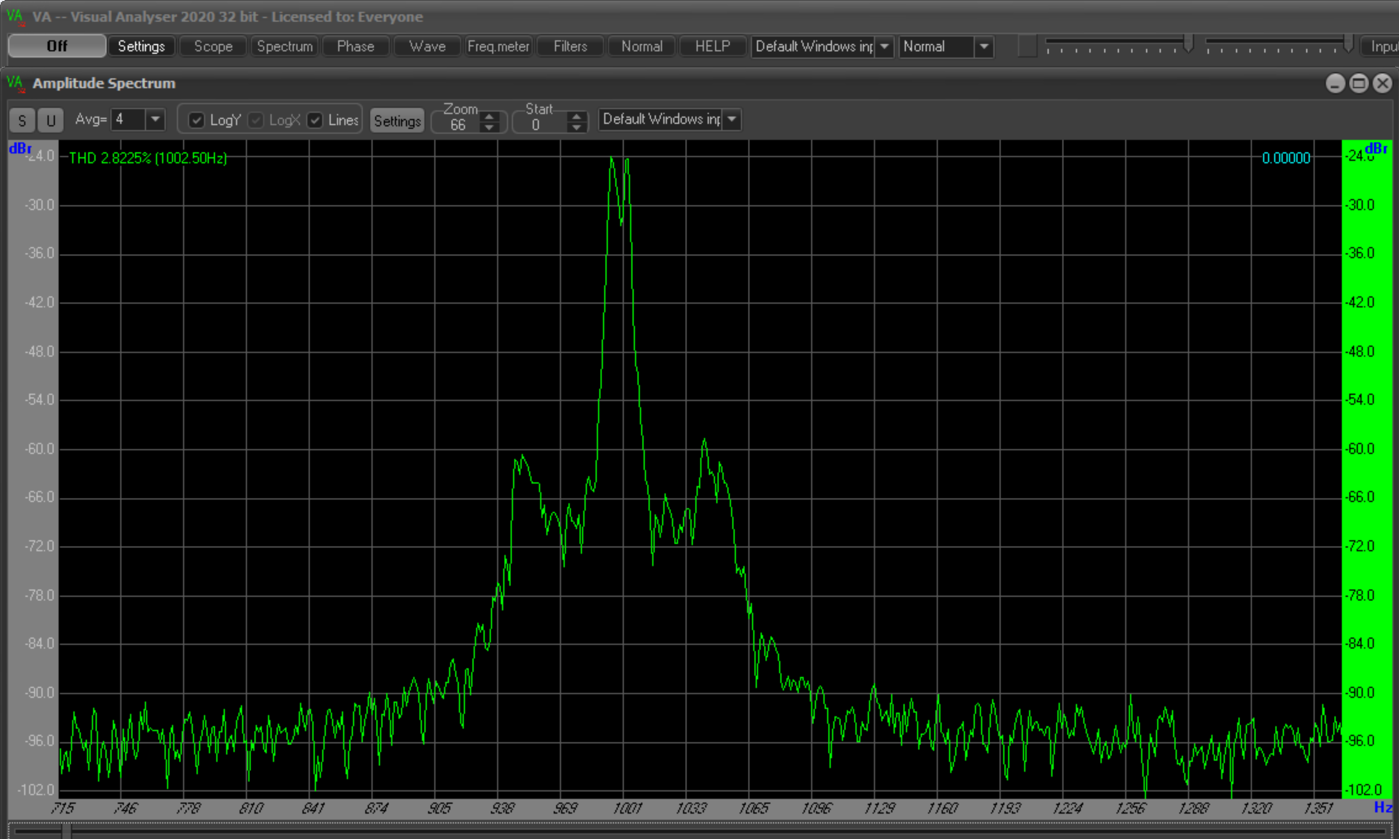

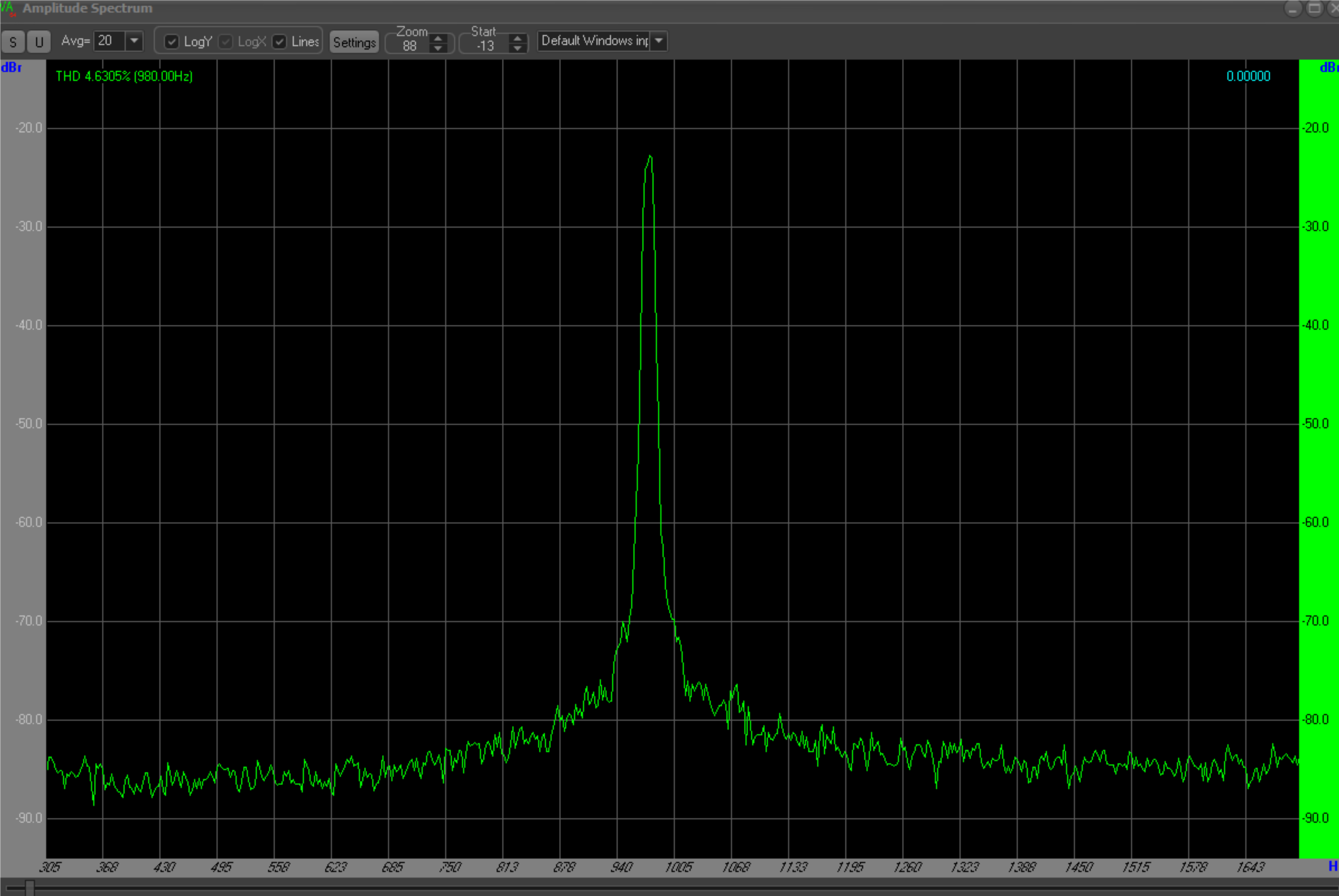

To understand the output (again following much encouragement from posters) i feed my pre amp output to an ADC into the computer and view the spectrum on my PC in VA. many posters have contributed to my amateur attempts but i have learnt lots and much improved the arm as a result.
With this tool you can easily see the results of your work and small effects from individual changes. It took me a while to adopt this but the persuasion of posters here is now greatly appreciated.

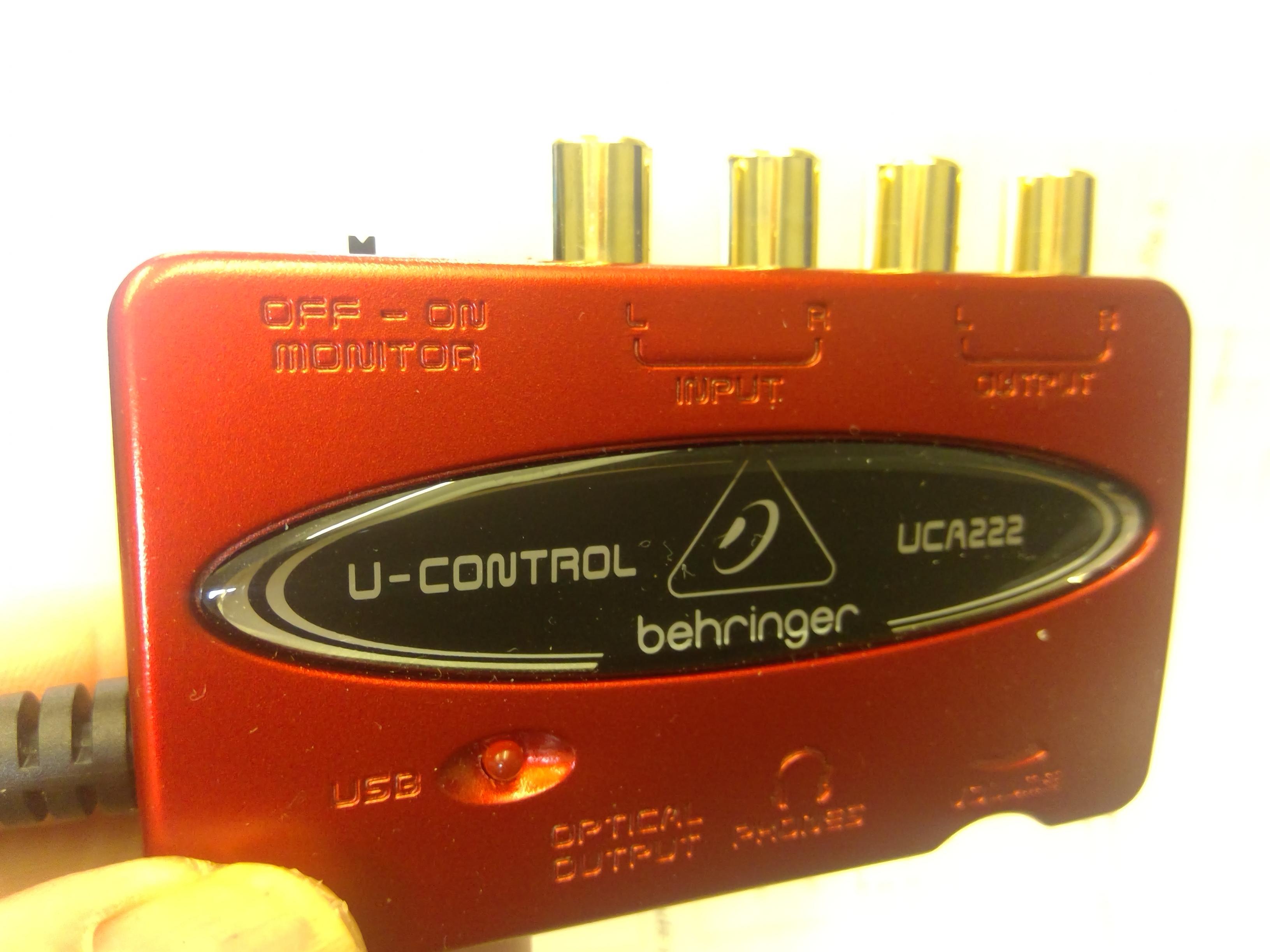

ADC, analogue to digital converter, i chose a behringer, pic attached at ~£20 over the focusrite that is probably better at £100. all the plots i post come through this, my only problem with it is that its grounding is not the same as my playback amp and you can see hum on the plots that i cannot hear in real life, but its so low level i have not worried to date.
VA is visual analyser and is a free download, just google it and you will find it

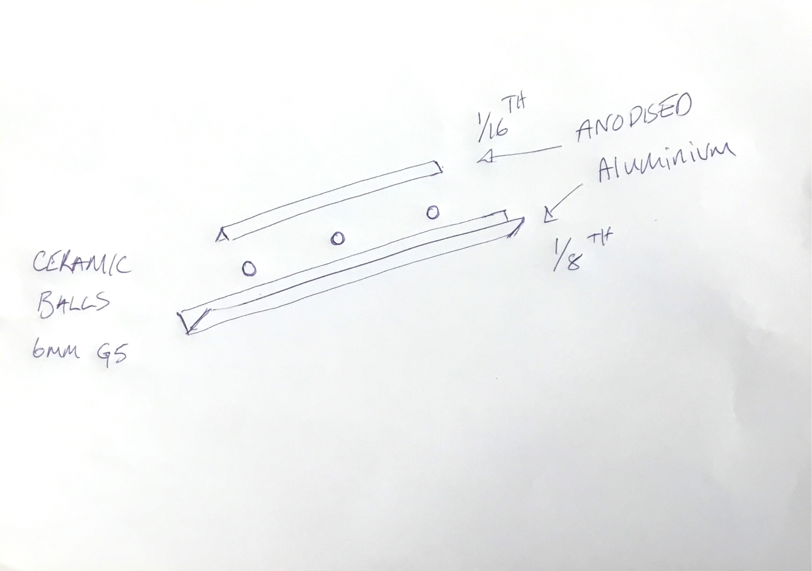

Lastly and most importantly. I have searched just now and I remember doing this in January. I cannot find non recirculating 6mm ceramic balls on an aluminium v rail. Have you a supplier? And pictures of yours. I’m struggling with this bit quite a lot. Thanks
Post 4287 shows the set up with a pair of horizontal rails. i am now using one above the other but the concept is the same for the balls etc.
With your set up you only need one rail because the stylus is the stabiliser to tipping as you know.

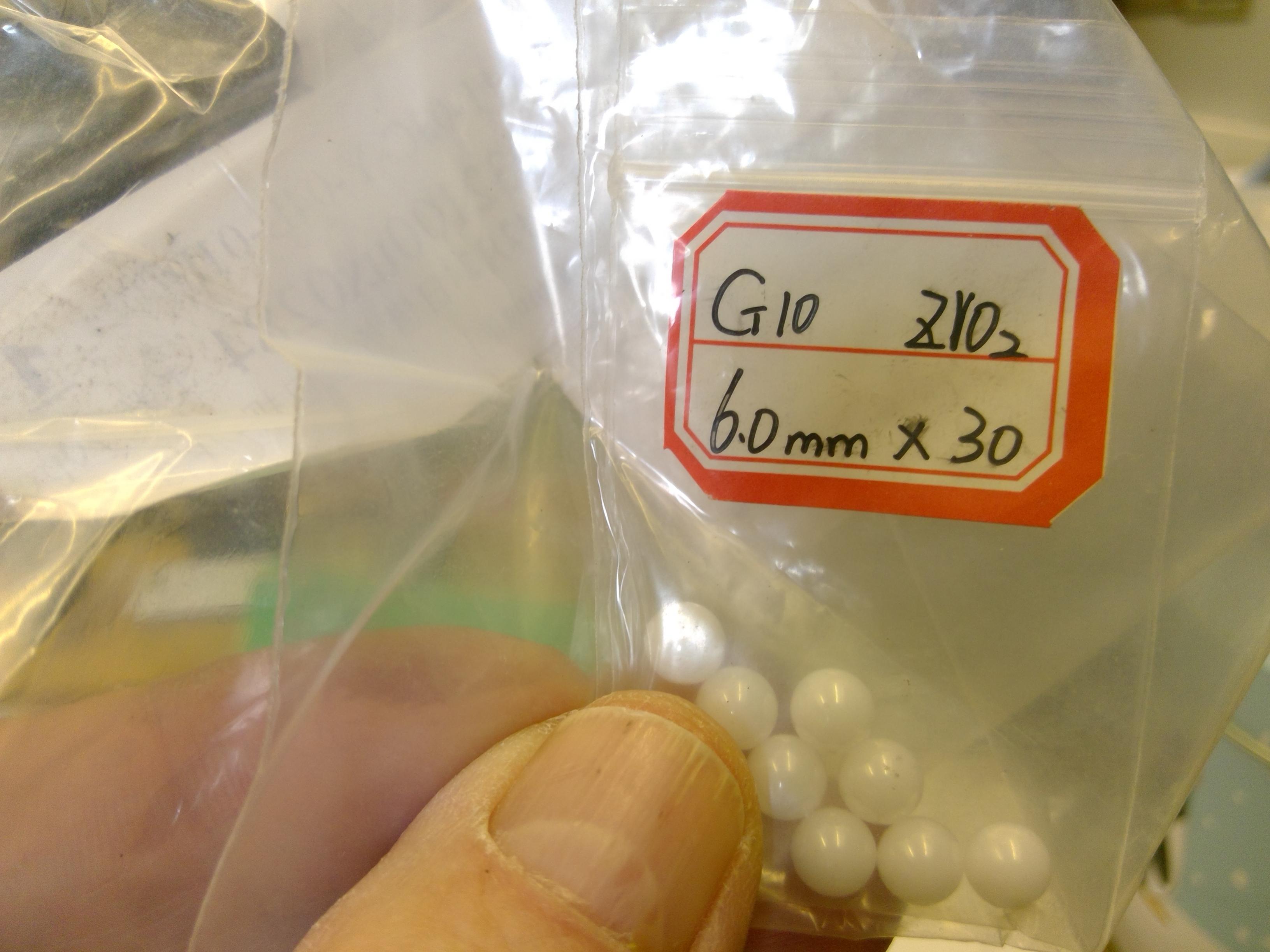

I got balls from amazon or ebay, it would be nice to find G5 closer tolerance balls, but G10 is what they normally send despite the advert .......you might experiment with diameter as you will have a different result in your configuration.
Aluminium anodise 1/2" angle at 1/8" for the rail and 1/16" for the cart is my recommendation, then you've only got to grind or cut the cart rail to fit.........!

I think you only need two balls, in fact three in line guarantee a variation in contact as there will be tolerances. The ball movement needs to be restricted, here is a pic of an old rail to show what i do.
Concerning the vertical pivot, i feel you will either get a small slide to achieve that, same as the current bearing, or perhaps a combination movement, either way no worse than current i feel.
I will get out some old bits and glue up a mock up later if you tell me the length of your arm wand.

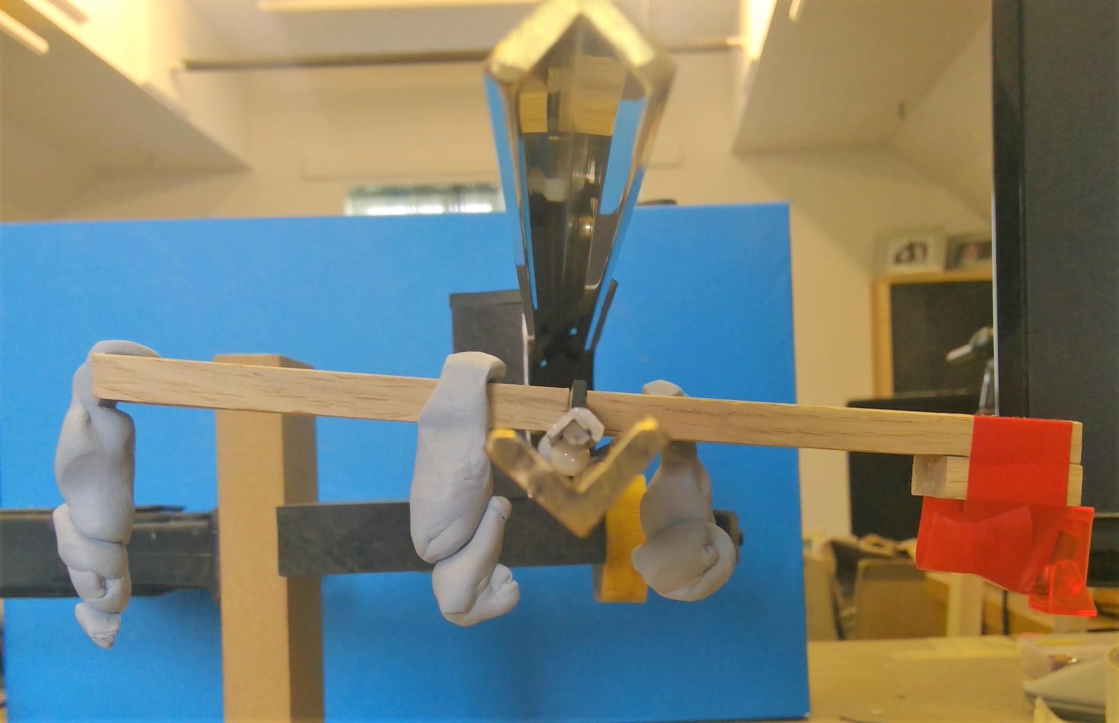

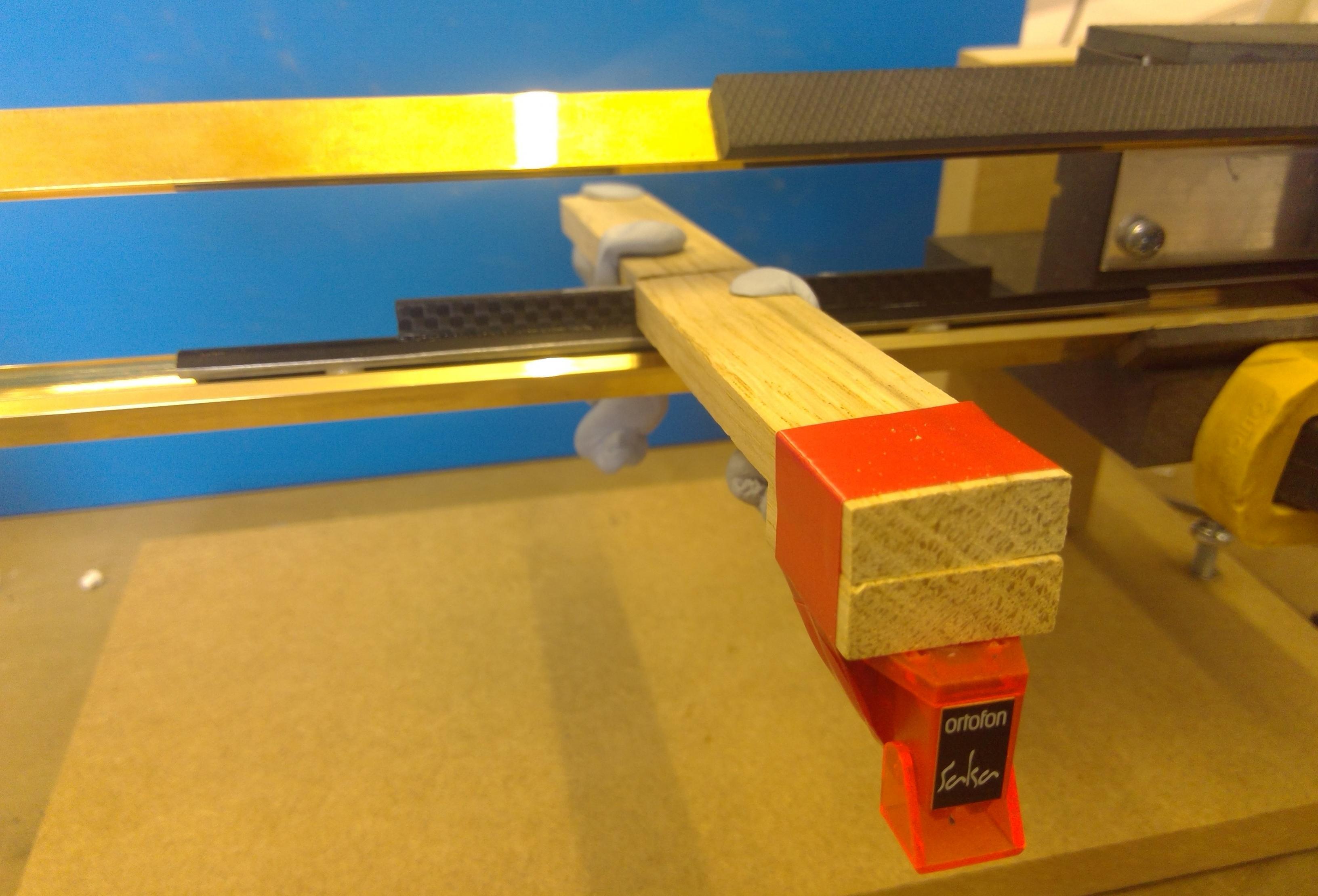

Here is my latest tonearm, called "the oak" for obvious reasons.
Offcuts from a cupboard project!

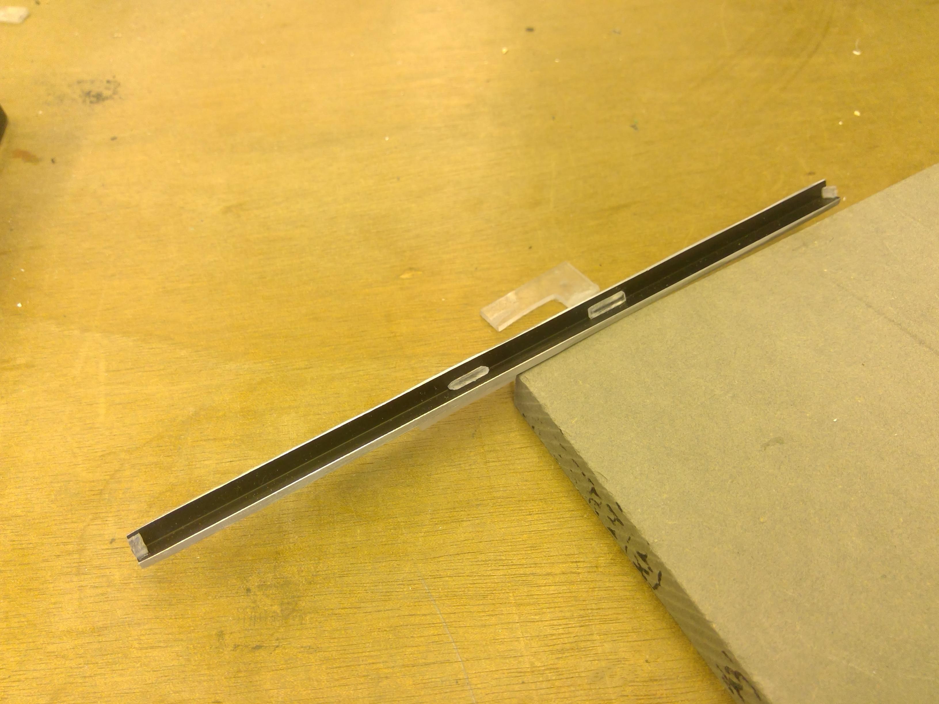

I just took my recently redundant brass rails, they are not as good as anodised, you won't want the top one in your configuration if you go this route.
Then i took an old carriage rail which is certainly not pristine.
As this is classic V on V the carriage travel is twice the ball travel.

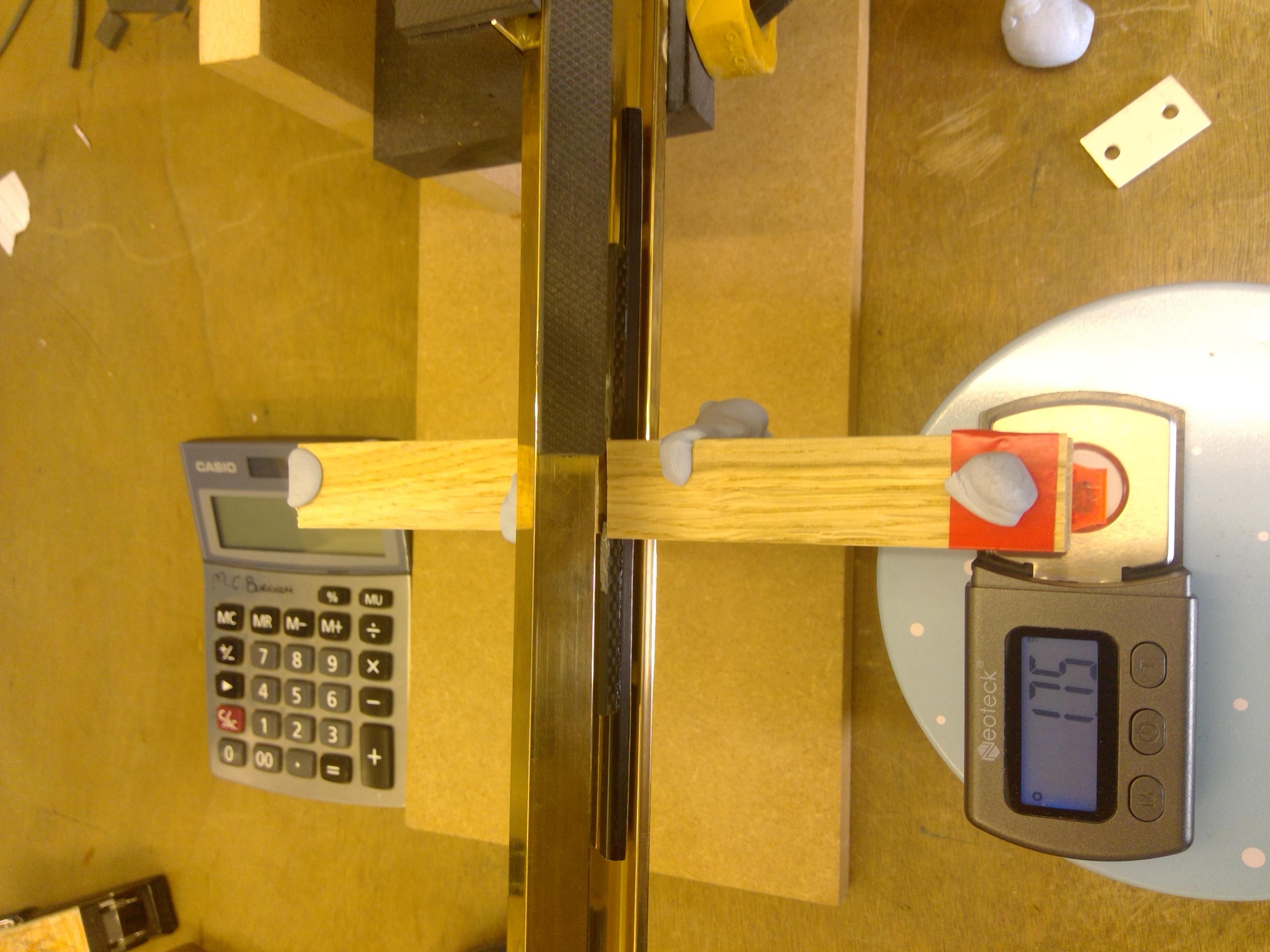

I set it up on the sine bar, neutral VTF, i.e. zero and the blu tack gets the centre of gravity below the pivot balls so that it returns to centre when it pivots in the vertical plane. This is only necessary for the experiment to work not on an arm in use.
Apologies to Ortofon for taping their cartridge to it but one channel went down....
I felt this pivoted better with 5mm balls than 6mm, which is logical as the scrub radius would be less. possibly even smaller would be better but getting the right clearances becomes tricky.
So each ball has 4 points of contact, two top and two bottom and in the radial motion it runs similar to my tonearm, it needs around 1mm in 300 to continue to run when started and slightly more to start from rest.
I have never gone down the jewel route, so i don't know how much better that might be but i am fairly sure this will better the BB's in motion and likely be similar to them in vertical pivot.........
I then set vtf at 1.75 with another lump of blutack and this is consistent to '00ths, i.e. stays in the 1.7's over a 3mm height difference which is the accepted maximum warp and returns to stable immediately, so i reckon this could work for you, no guarantees but a good value experiment and no chattering BB's around!

Thanks Mike. That helps a lot to see what’s going on there.
I need to go back and see how your arm has developed. I’m unsure of the use of the top v amongst other things. How have you connected the arm to the top of the v? It’s unclear from the pictures. Is it carbon fibre bonded onto the top of the v?
Mike. Maximum mass makes sense. When the disc was cut, the lateral motion was tied to a slowly advancing lead screw that had NO compliance.. Ideally, we would all have tonearms that had a leadscrew that advanced the stylus across the record at the exact same rate the groove was put down. For any given moment, you want zero lateral and vertical movement of the cartridge. Including those freedoms of movement are a compromise to the real world issues of vinyl. Warps and eccentricity. If there were no warps, the tonearm need not move vertically other than to place it on the record. Horizontal movement is necessary to move the stylus across the record. High mass in the horizontal plane moves the resonant frequency created by the lateral flexibility of the cantilever way below reproduction range.. Eccentricity of a 33.33 rpm record should be ~0.55Hz. Resonant action will tend to create harmonics above this frequency.. moving the resonance as low as possible also keeps the harmonics very low.. I would like to add that if you're trying to track a record that has more eccentricity than the cartridge/cantilever can handle, you should probably get another copy of said record.
Mike. Maximum mass makes sense........ .
