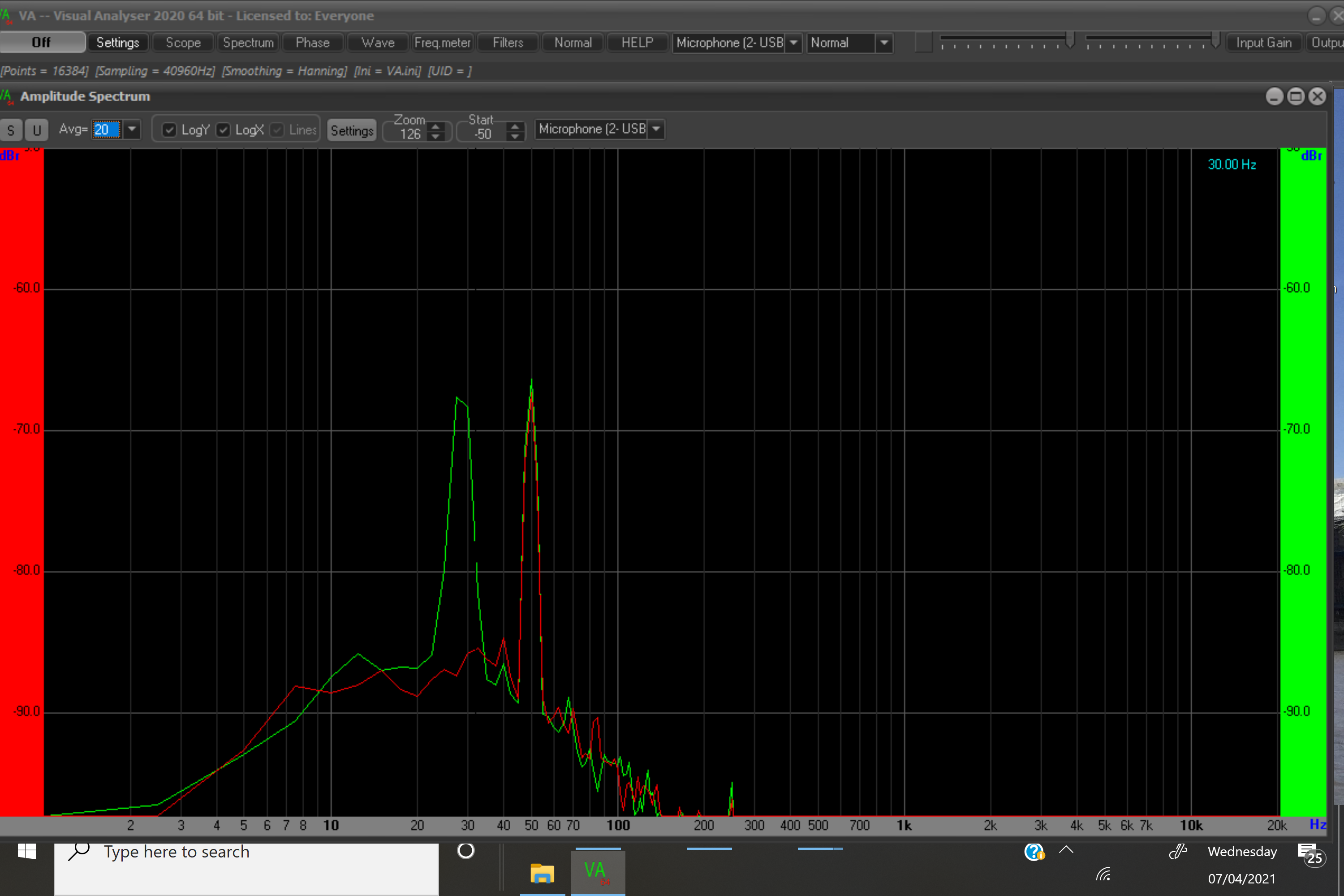

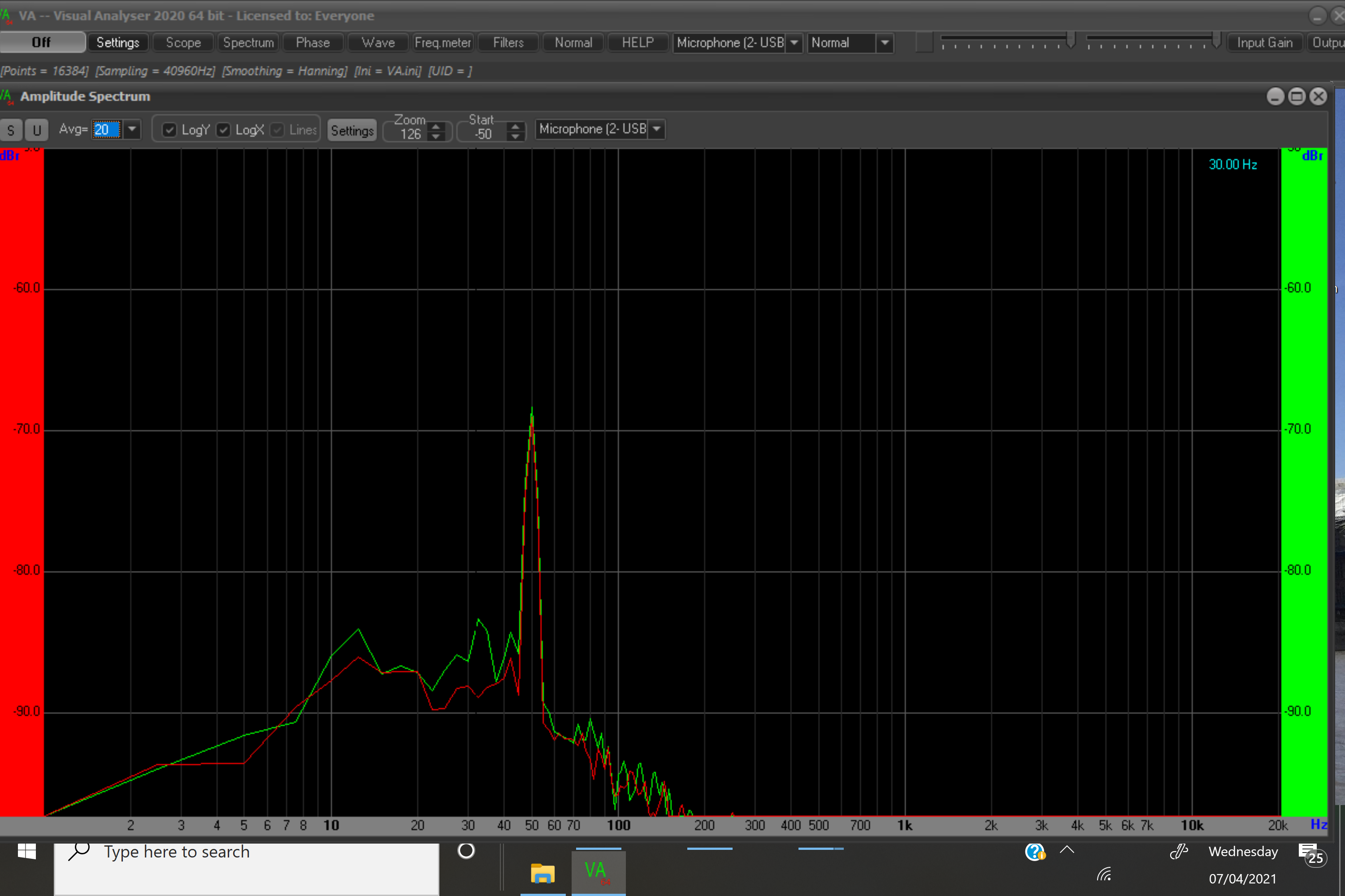

I tried a lightweight platform of 3" expanded polystyrene sheets thinking LF would not go through it.
At the same time i tried two set ups, all belt off motor only
1. on polystyrene
Motor off = 582
Motor on on 33 = 583
Motor on on 45 = 584

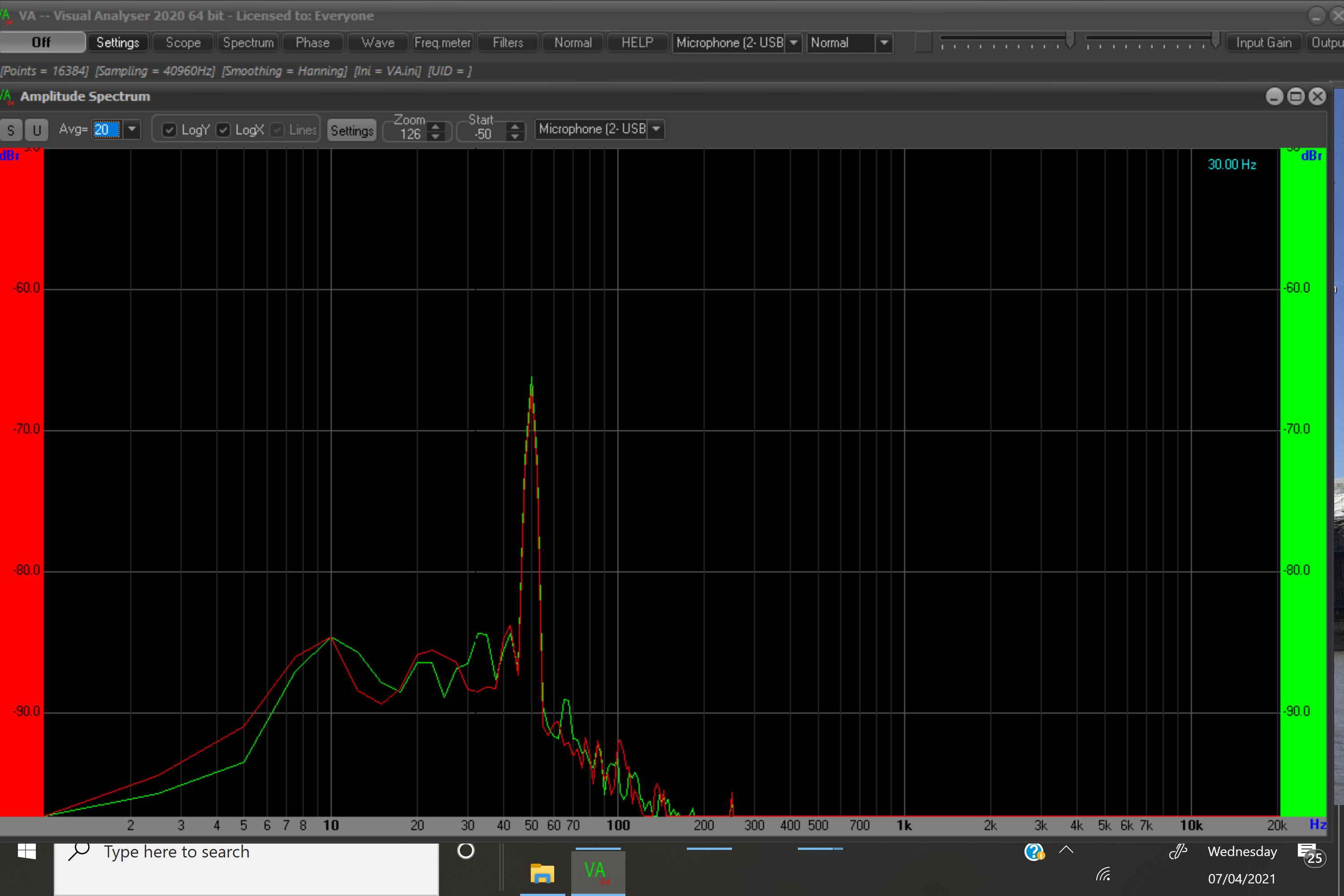

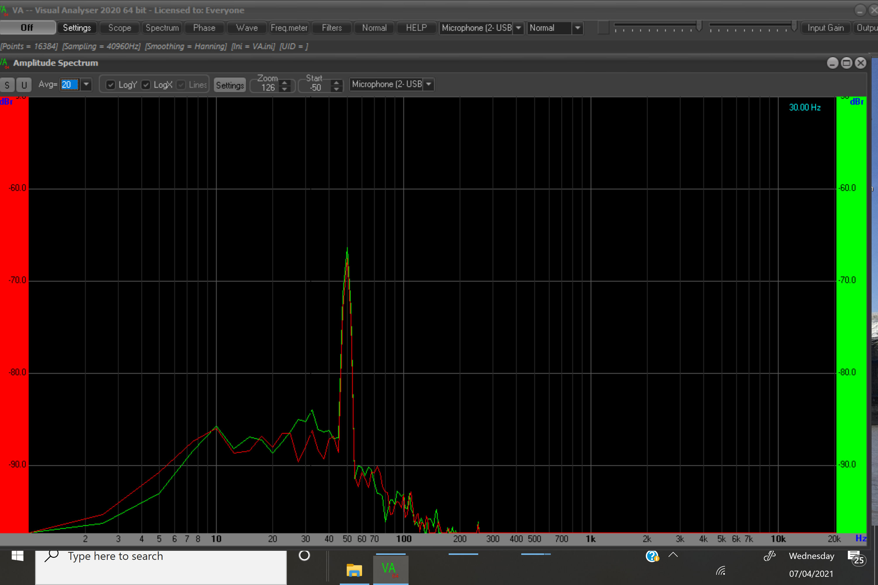

2. on inner tube platform
Motor off = 585
Motor on on 33 = 586
Motor on on 45 = 587
So the inner tube platform stays under the motor and as i dont use 45 its ok, but what is happening at 45 there?

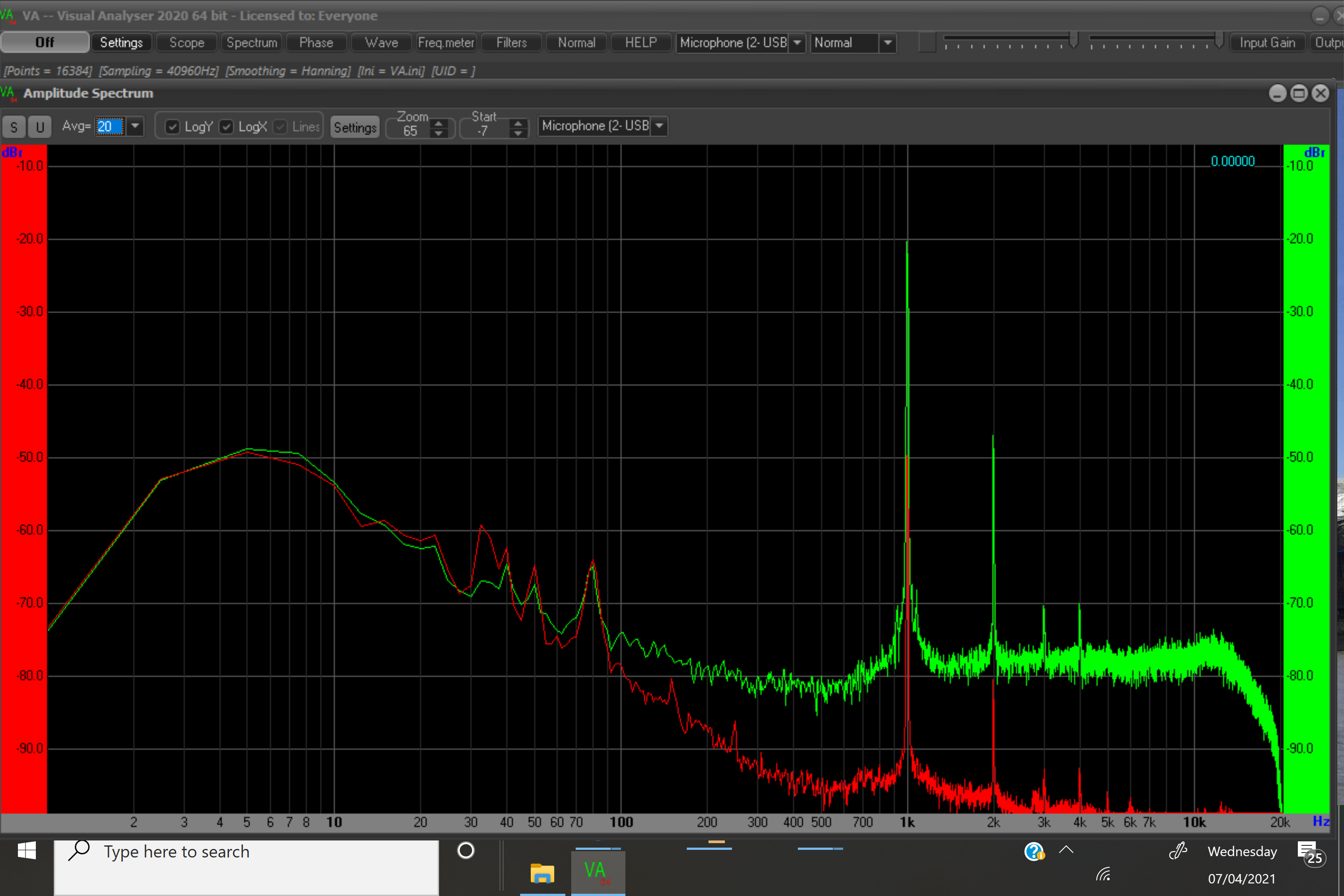

I have run a measure playing the 1khz tone and the 23hz is negligible after playing belt tensions, but the LF noise is up to within 30db of the signal peak and was lower, 35-40 down?

Didn't we cover the speed as the issue back in February? This conclusion had already been reached. no?
That's absolutely correct thanks Soundblaster, last time it was evident that changing the speed changed the frequency in proportion, what i didn't find was a solution to it.
So i tried hard at isolating the motor pod, but with moderate success, now i have found the motor mount adjustments make a much greater effect and en route learnt something about isolation and puzzled myself about a few other things like why the peak when using 45rpm remains high.

Hi Mike,
I believe that the Origin Live decks are designed specifically to have both the motor pod and the deck mounted on the same solid surface. Putting an extra compliance under either one or separate compliances under both could result in a rotational oscillation due to a torque reaction. (Standing both motor pod and deck on an isolation platform together is a good idea).
It is possible that adding separate isolations might exacerbate the motor breakthrough problem rather than reducing it especially if the natural frequency of the isolation + motor/deck is close to the rotational speed of the motor.
If the AVMs are quite stiff it is also possible that the natural frequency will be higher in frequency and could explain the +/- 70hz side-bands you are seeing .
Rotational oscillation due to this type of torque reaction is a problem that has plagued suspended turntable designers for years. There have been many attempts to counter this problem. Many manufacturers give up and just over damp the suspension which gets rid of the torque reaction oscillation but also gets rid of most of the benefits of the suspension. I believe that Origin Live has a suspension system based on a leaf spring that only operates vertically and so cannot be induced into rotational oscillation. Definitely one of the better solutions to the problem.
