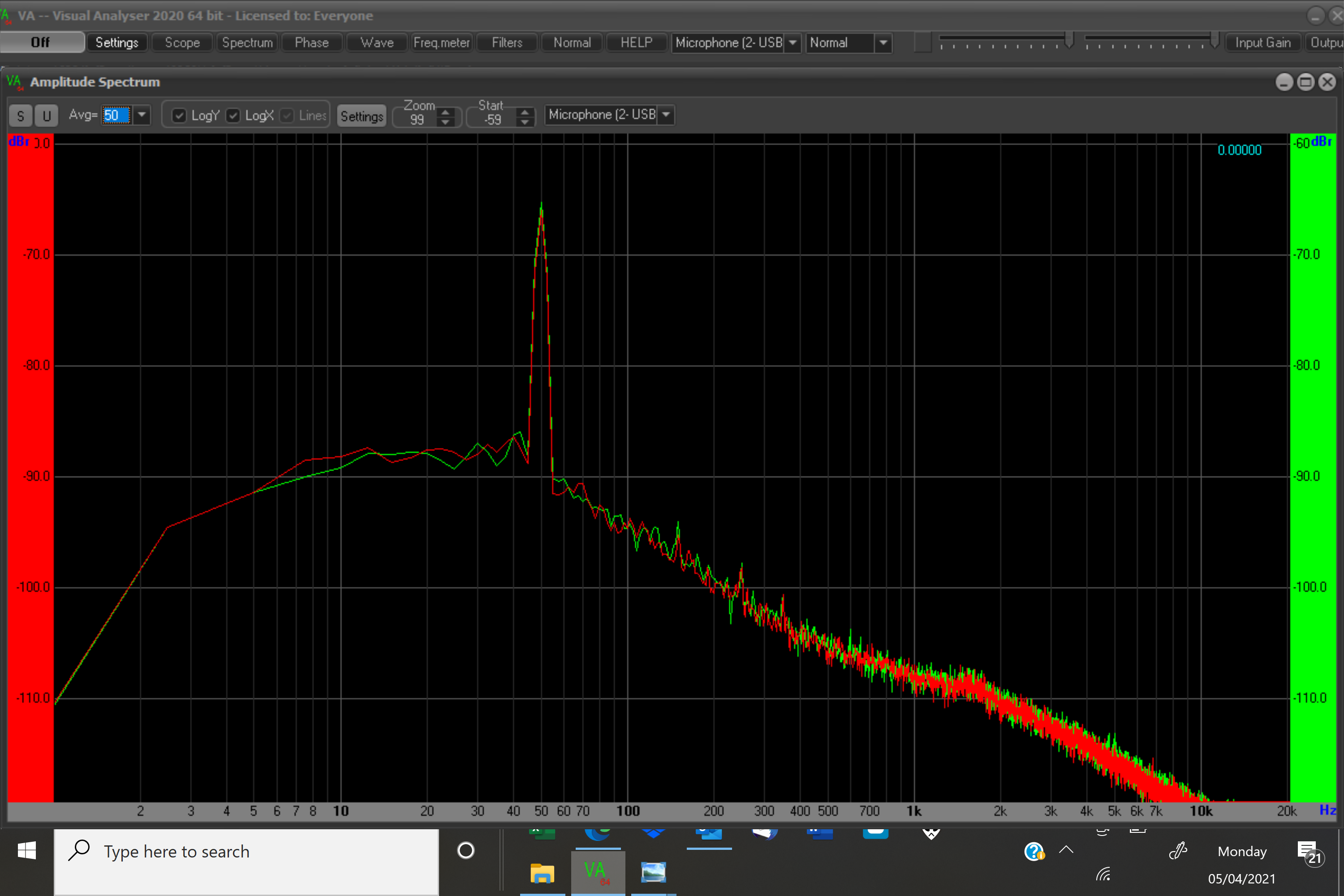

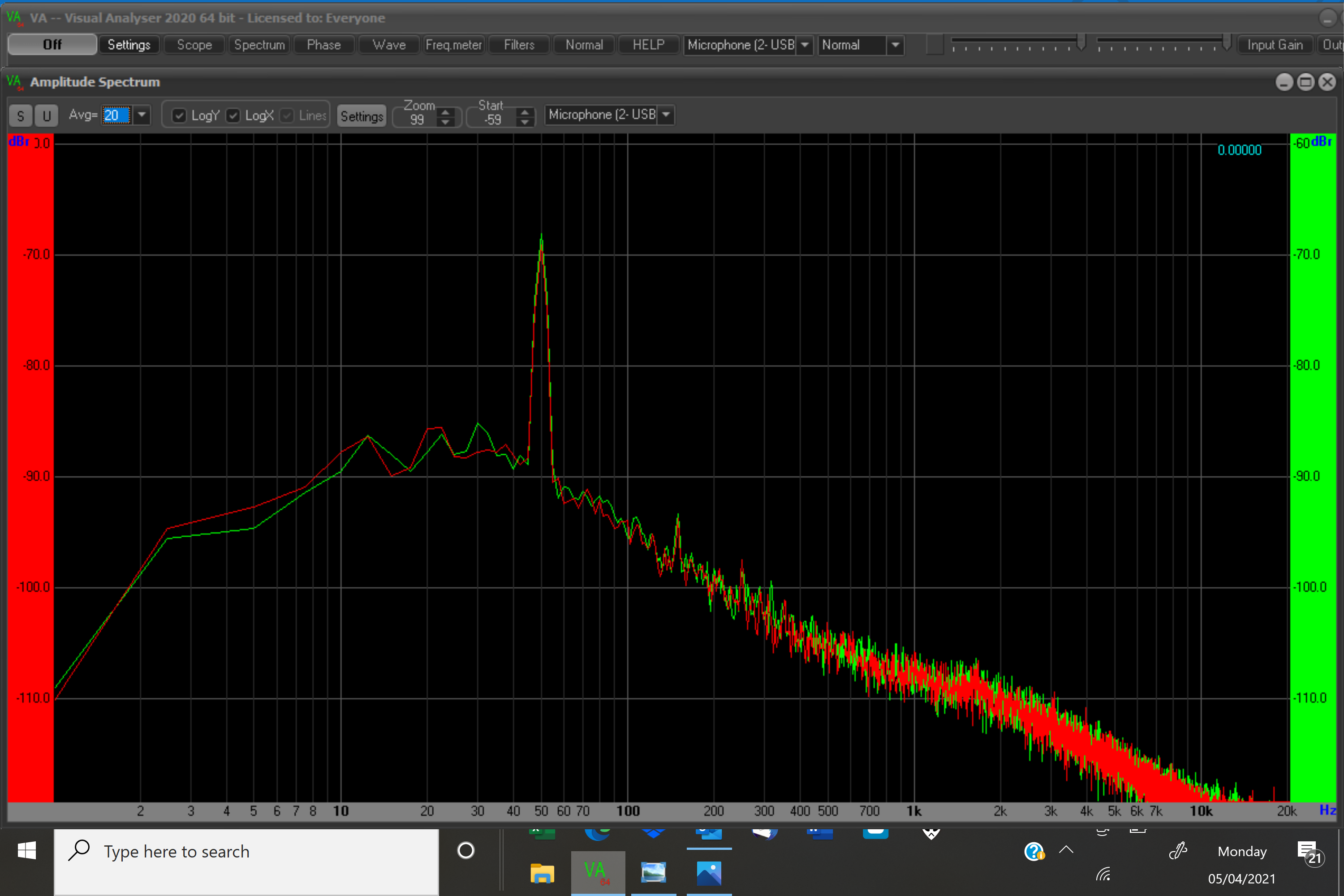

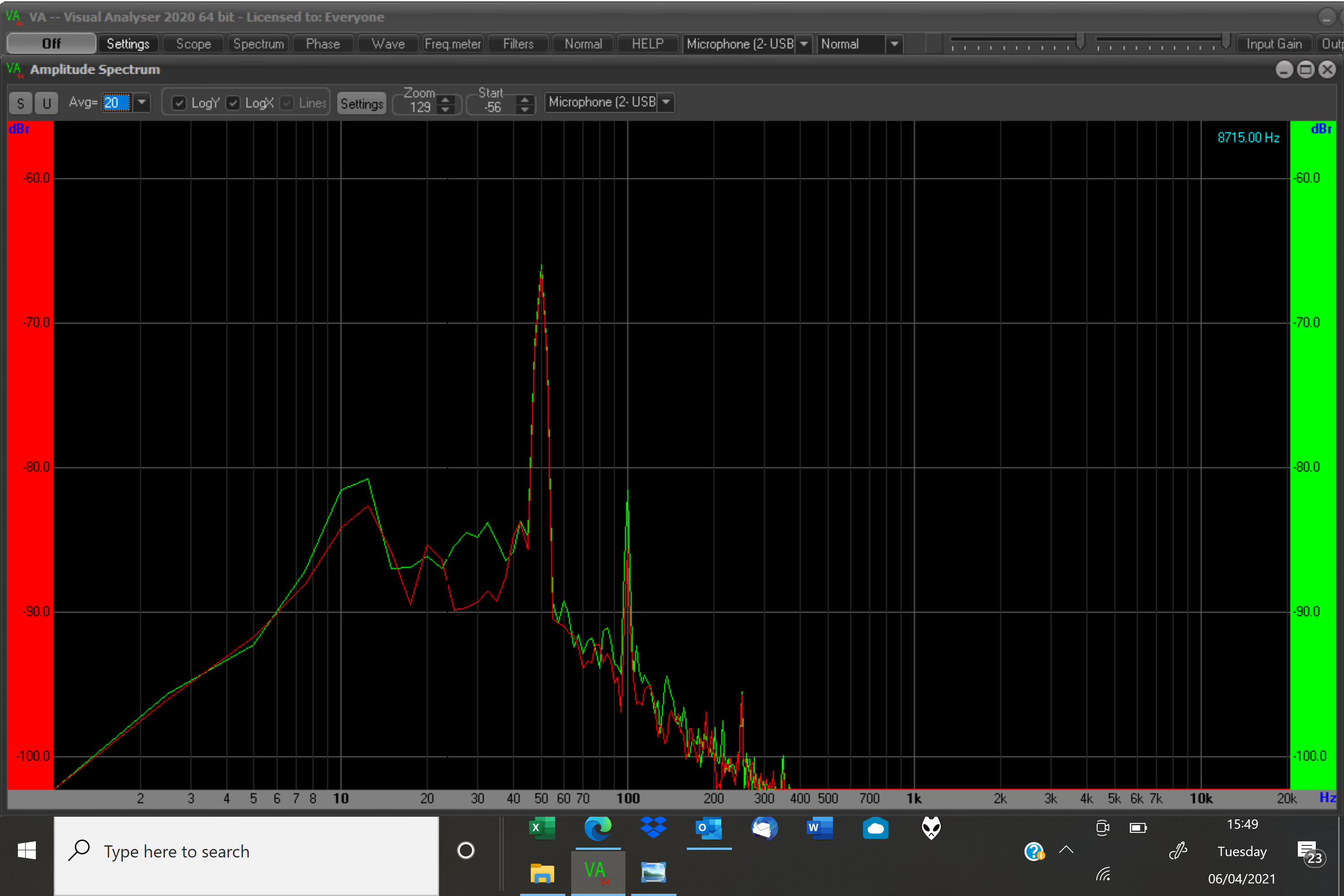

First in answer to your last question, i had previously found the motor seemed to have an input at 20-23Hz, and so now the motor pod is on a separate plinth from the deck and arm and i took these measurements again.
First 555 (stylus on record, motor switched off) shows the 50hz hum peak which seems to be how the ADC is wired because if i turn the volume up full when everything is set to play through the amp there is zero detectable hum at the speakers, and the bass has 250W a side to try and amplify that if it were there. it is picked up by the wiring which i have proven by shrouding it for a test but that isn't practical playing a record.
Then 544 is the motor switched on, one can see a peak still, maybe this is electro magnetic rather than mechanical as well?

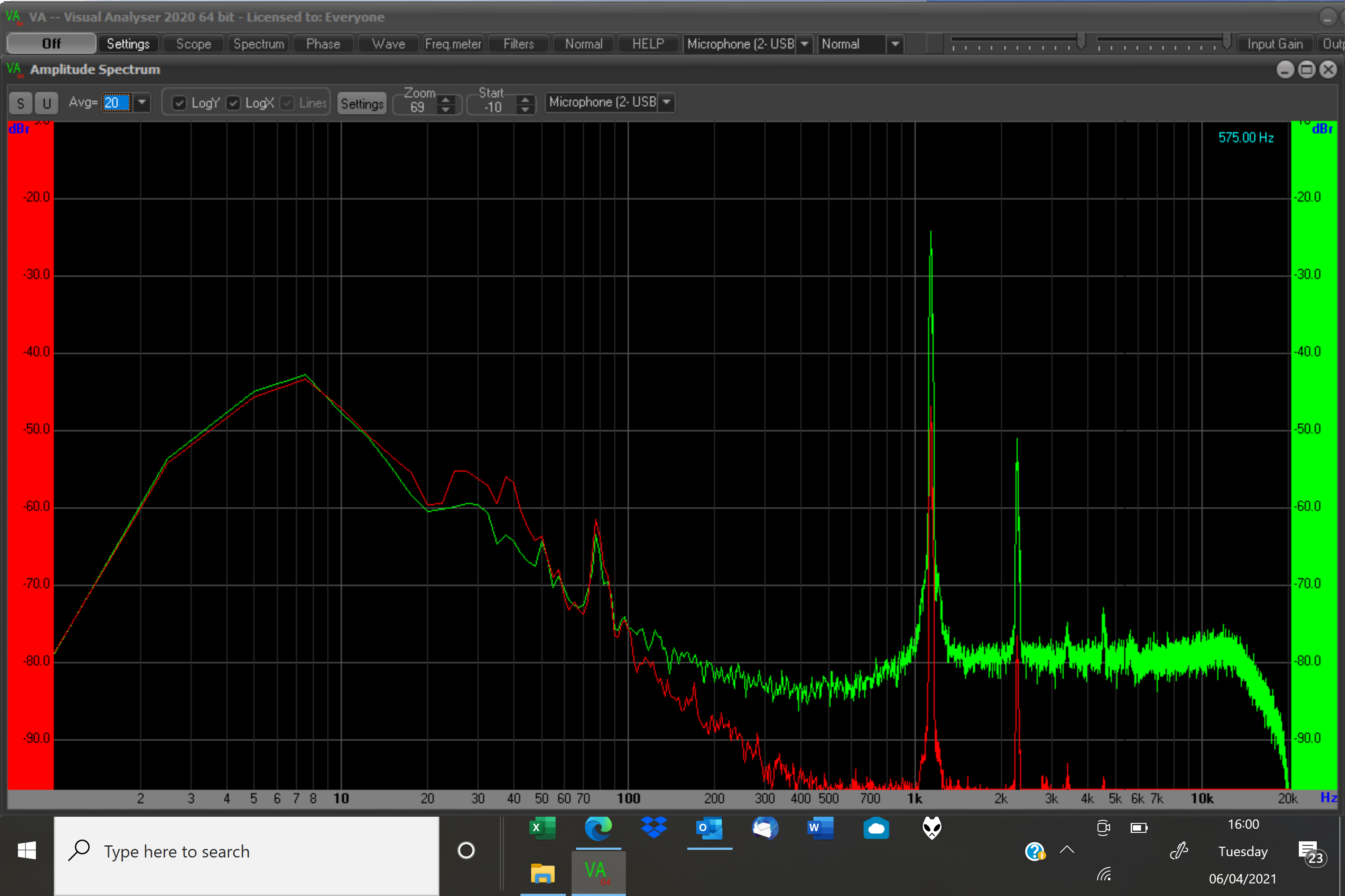

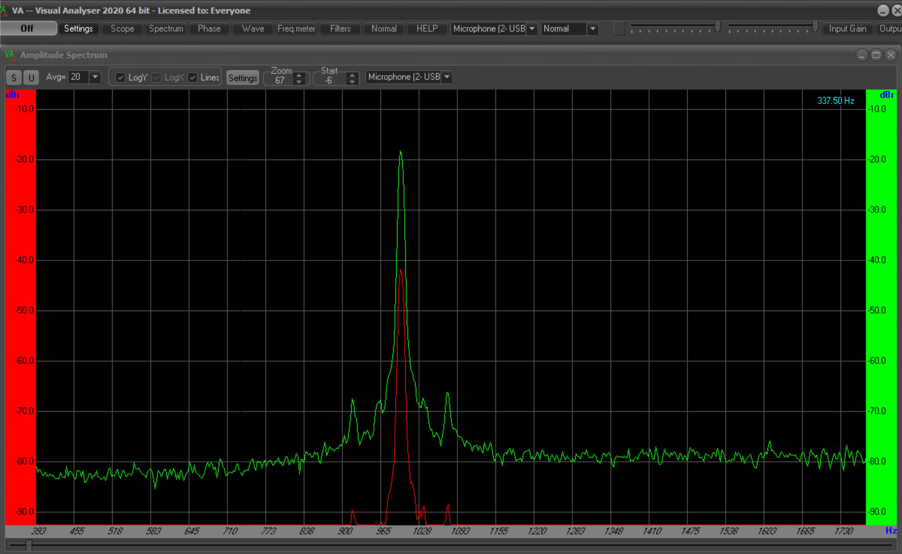

Hi Mike,

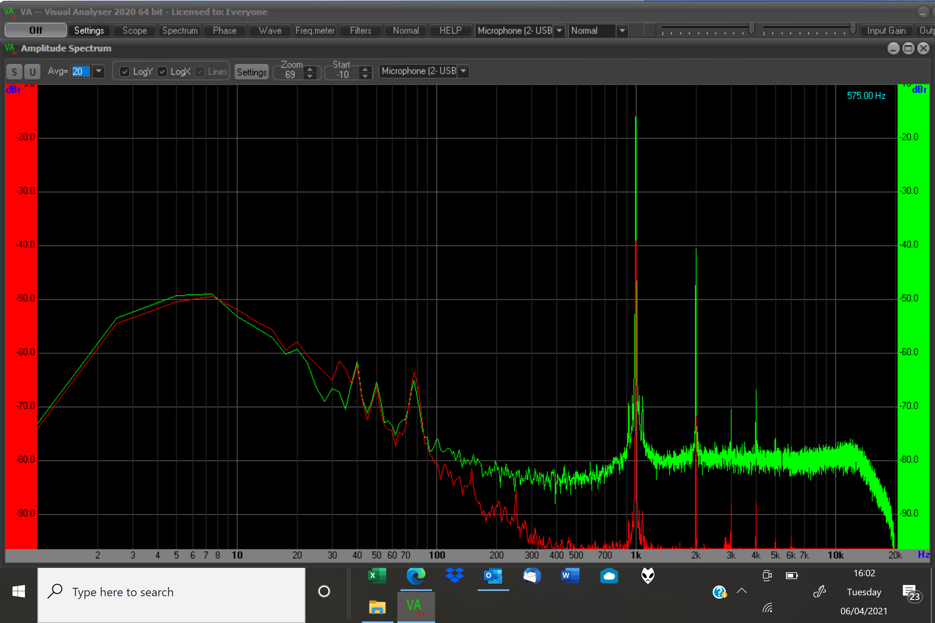

I notice in the 1kHz spectral post you have asymmetric sidebands. This is not good as it points to multiple sources of non-linearity. Pure amplitude modulation always results in symmetric sidebands. My first guess would be FM as well as AM.
I mentioned this for you keep an eye on as I don;t remember seeing this in your other plots.

Hi Warren, thanks, i am probably trying to do too many things at the same time, i find this sport engaging and get carried away!
The latest looks as attached.
Now looking symmetrical to me but would be interested to know a little about FM and AM, how caused etc.............

Welcome to the world of R&D, just make sure to change 1 thing at a time.
Frequency Modulation is like WOW where the F is varied, FM has deviation which is the amount in Hz that the F is varied.
AM is far more common in TT audio reproduction. The 2 frequencies you have 1KHz and 70Hz will naturally Amplitude modulate causing F1+F2 and F1-F2. So you have 1kHz-70Hz and 1kHz+70Hz thus upper and lower sidebands.

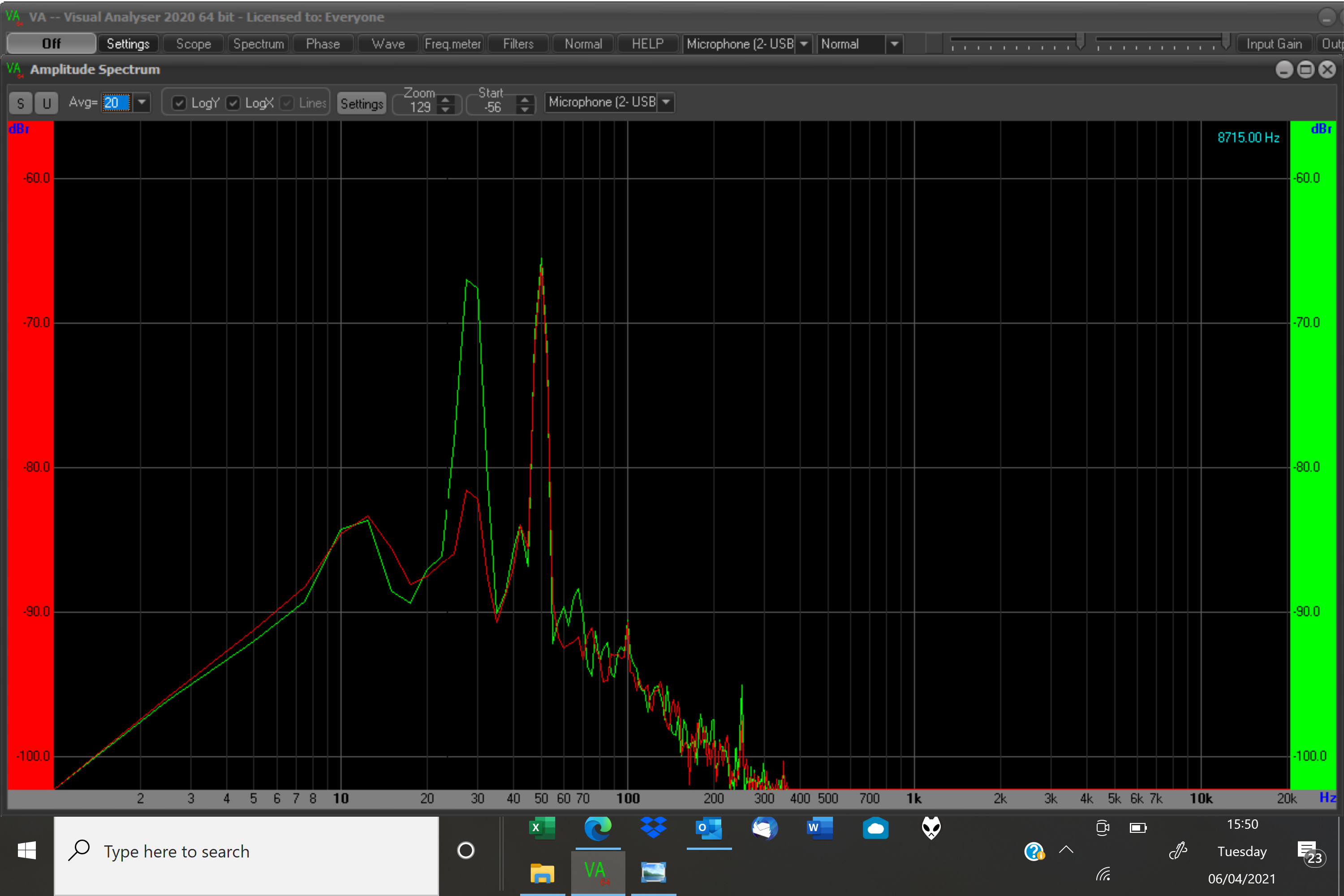

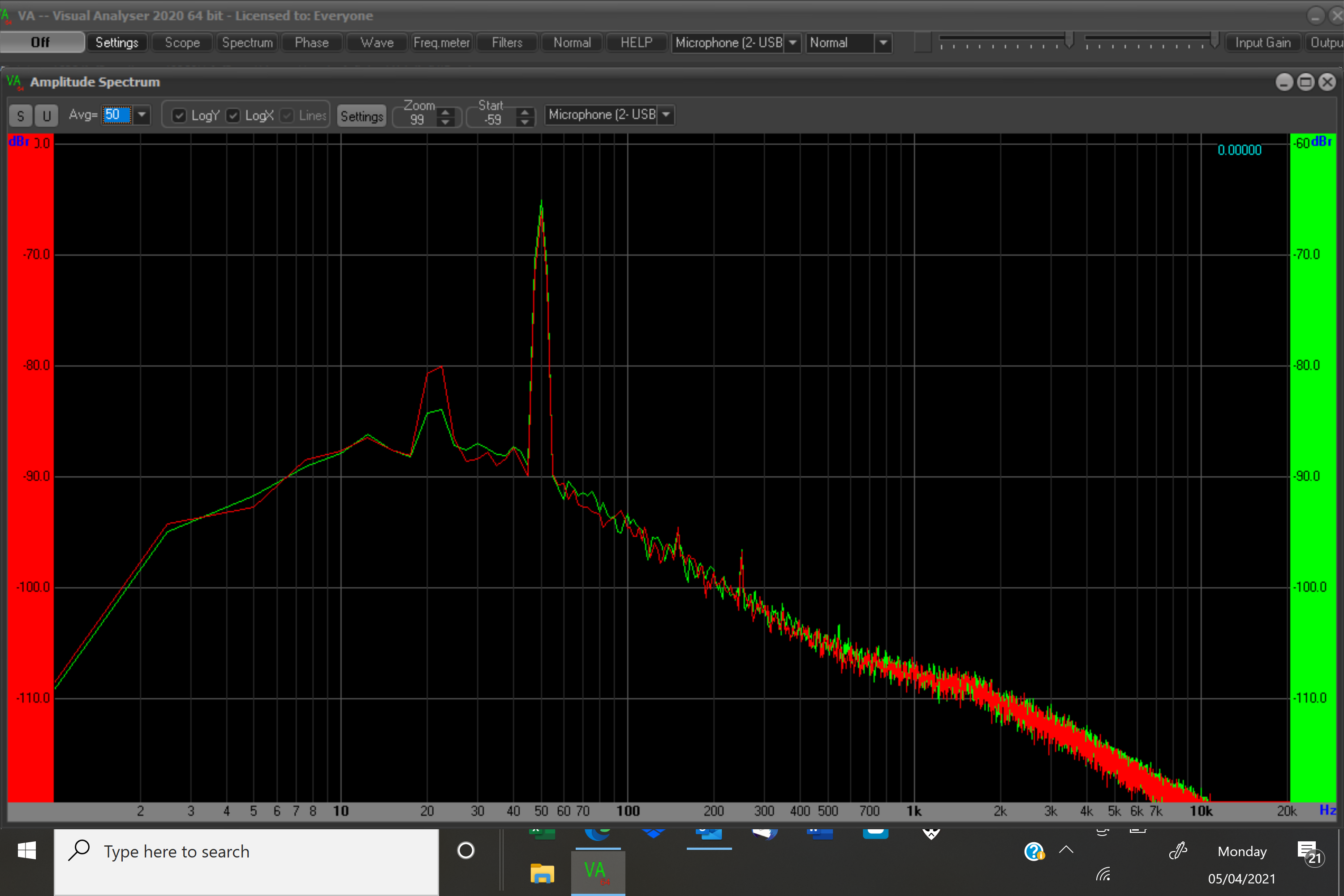

I re-ran the test Niffy, here you can see the peak at around 30Hz, so i bent down to the motor and can hear it buzz a little...........Hi Mike,

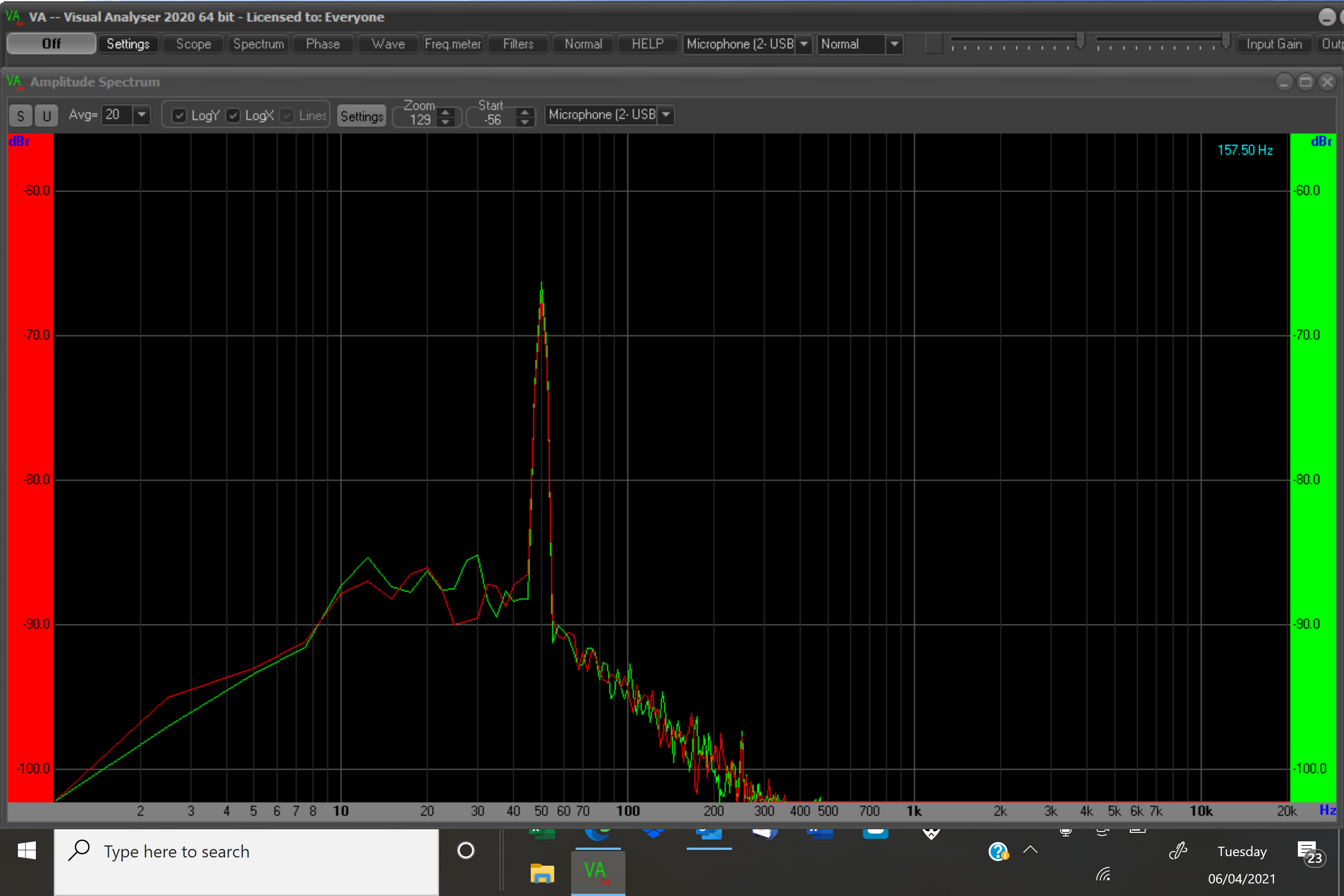

I read the instructions and adjusted the motor mount screws, 554 before, 557 after, i will check with a running set up but hope that's resolved
thanks again, mike

Hi Mike,
I glad that you've found the source of that pesky 23hz bump. That this isn't an arm resonance issue would lend credence to my supposition that the little bump around the 10hz range is in fact the vertical resonance mode of the arm. 10hz is pretty much exactly where you want this to be so that is an excellent result.
The next peek at 50hz is likely to be mains noise being picked up by the tonearm wires. It does appear to be at a low level so hopefully isn't audible but any lowering of the noise floor is welcome.
