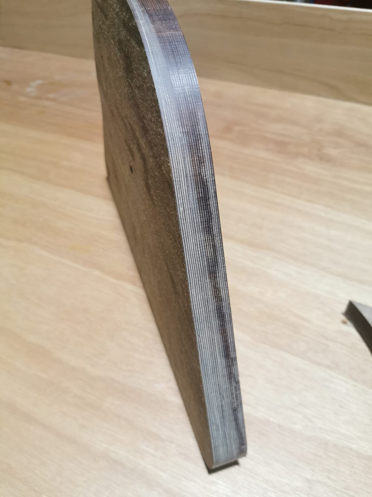

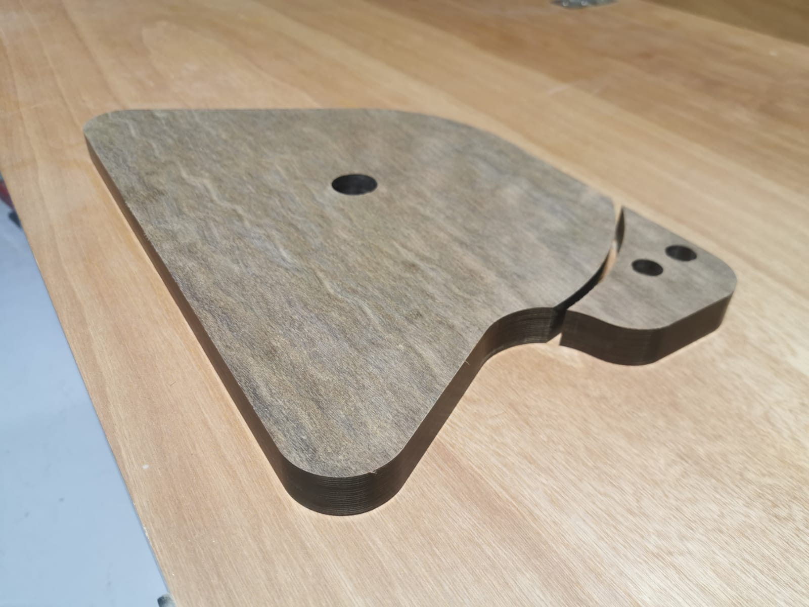

These are some of the permali pieces cut. You can see the edge seems to have light bits in it. I’m not sure what sort of finish it will bring up once sanded etc, looks darker than the panzerholz though.

In terms of cost I think it was less than £400 for 1m square which is the minimum size. It’s enough for 4 plinths though. I think it was £340...I can’t remember. The panzerholz was £150 for 500x500mm so it’s a lot cheaper in the long run. You can’t get the panzerholz now as I’ve previously mentioned...of course Brexit may have had a bearing on the prices. He’s around Gloucestershire I think so if you’re near that may save postage which was £40.
Thanks JW, i shall investigate, i am also going to experiment with what you see on the Lenco thread of modified/damped surfaces using a spiral routed groove filled with bitumen/sand........may be a dead end, but low cost diy!
Mike, yes they do. I can’t remember which one I got. What I suggest is give simon a call, he talked me through the options. In practice there were only two to choose from in 25mm I think. He may have a cheaper off cut if it’s a particular size. They make a lot of skid boards for Le Mans cars and I think they occasionally have off cuts from them. I needed a certain size so that didn’t work for me.

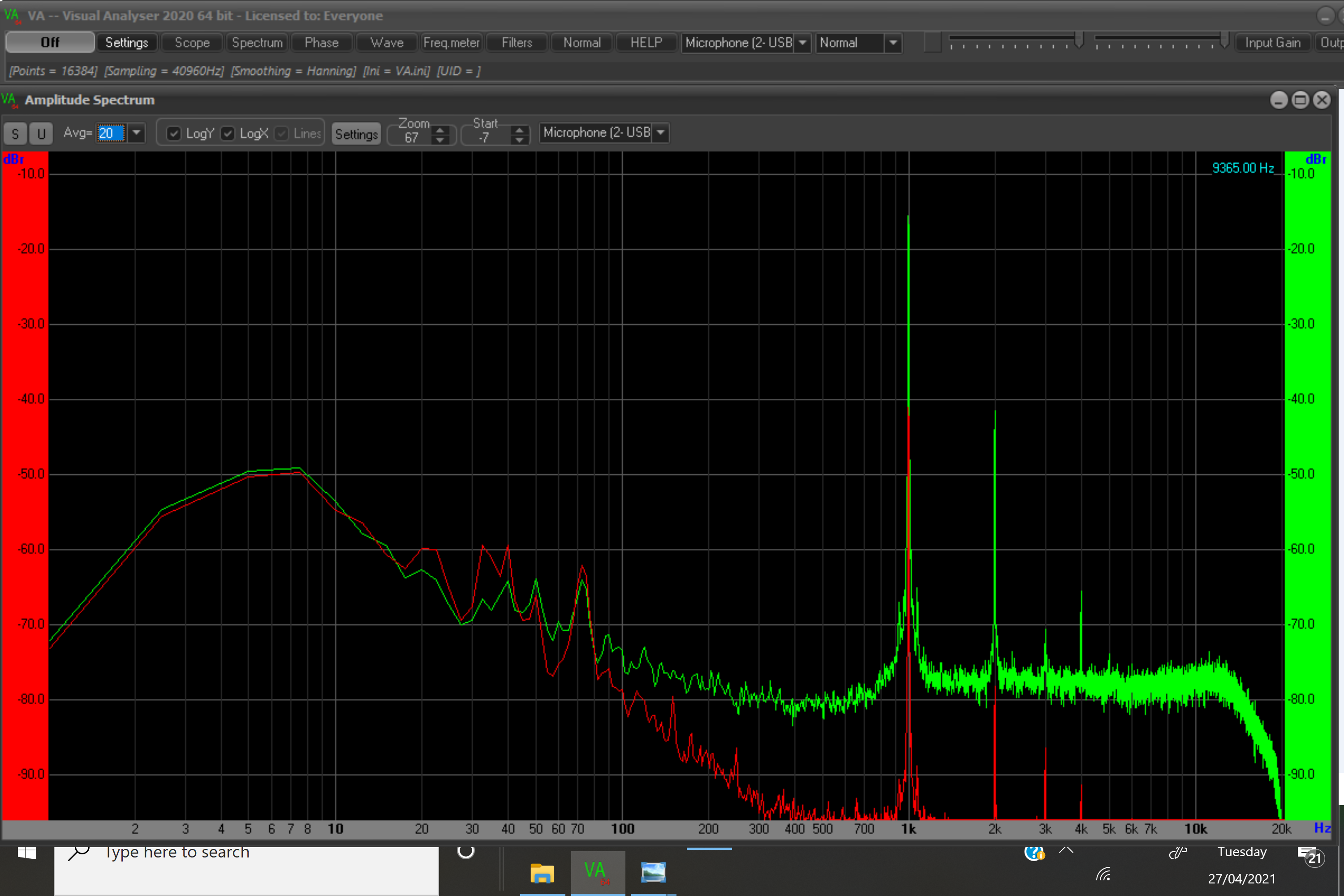

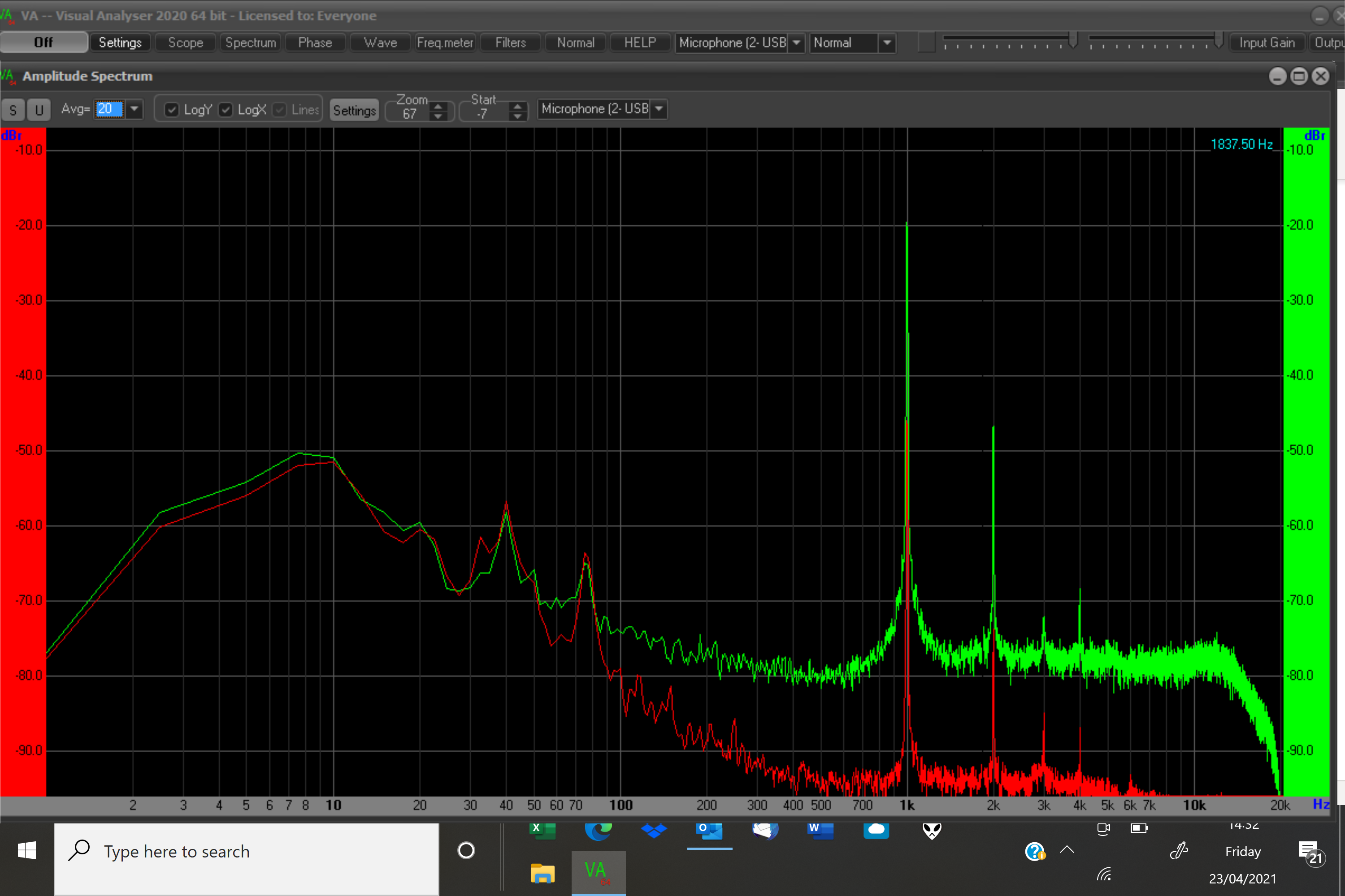

Hi Niffy and all, so with these constituents in place for tests i have a before and after, SS597 before, SS607 after.
Normally there are some fine tuning experiments to have small further improvements as well.
It seems to me the signal is the best part of 5db higher, i never understand that, but the noise floor etc is in parts several db lower as well and generally smoother.
A sand damper pot on the top plinth demonstrated a bit of smoothing of peaks and troughs as well, so i might try sand filled channels in the avonite sandwich............
In the pic you can see starting at the bottom the wall shelf which has MLV strips between it and the black MDF, this is the "earth" then on the MDF there are four 8" inner tubes, which behave acceptably in terms of handling, cueing etc, i havent tried pressure experiments yet. there is just a few mm of movement available.
The sand box sits on these tubes as the sink for the reference layer of two avonite sheets with MLV between on which all of the TA, TT and motor pod are sat.
When i have refined this i will put a skirt on the top layer which will cover all the lower layers and look smart?
