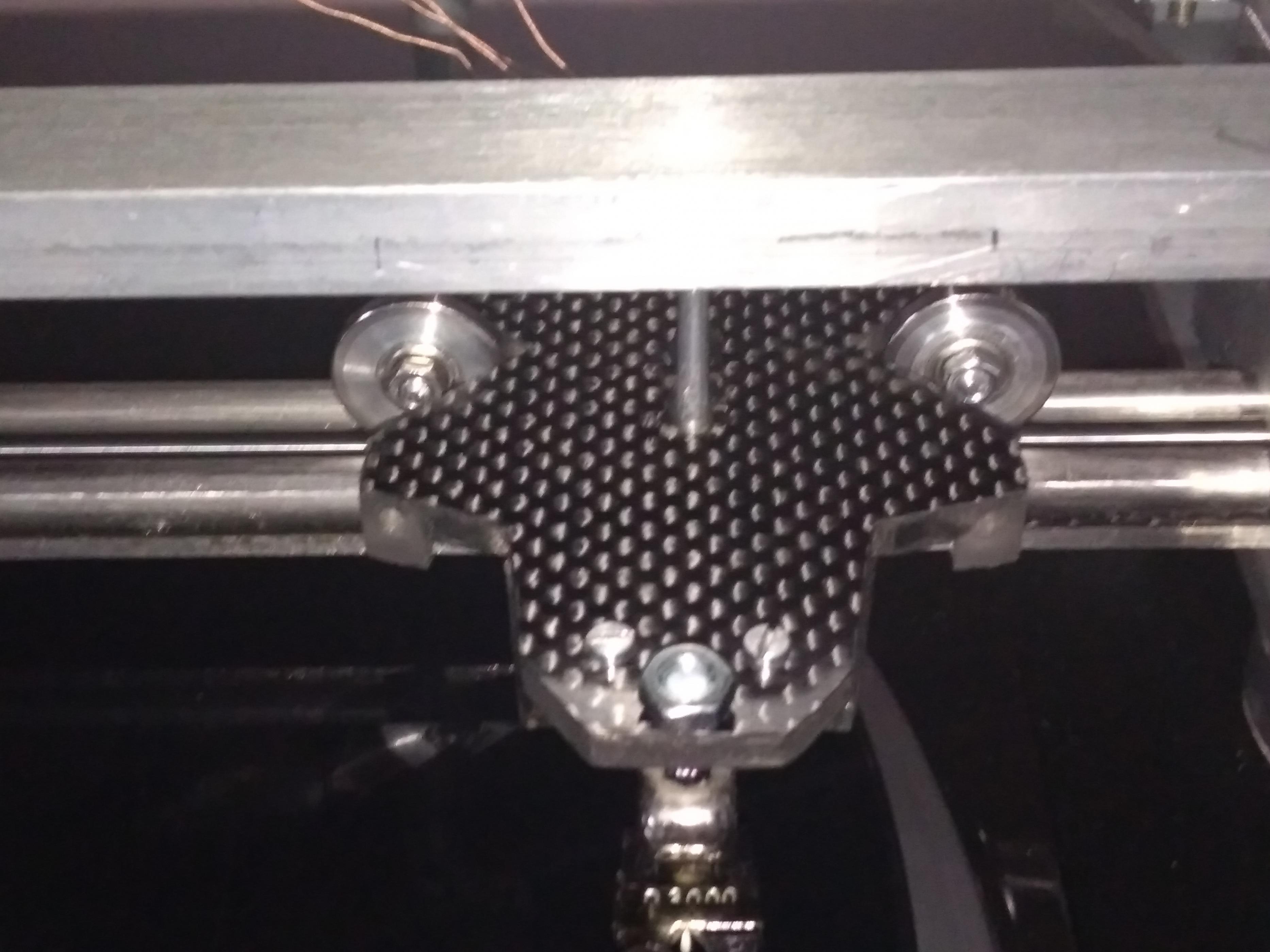

Found a couple of issues with the wheels.
1 - One pin was off centre. I think this happened when I machined them and turned it around in the collet.
2 The same wheel I found the carbide ring is oval by +-0.1mm
Add these 2 things together and it made miss tracking inevitable. I plan to remake the wheels this time I will make the rings from some 4140 high tensile steel I have at least this way I know they will be concentric.
Tracking is pretty good now and only the cable dressing causes it to miss track.

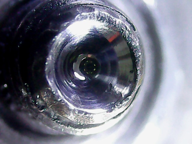

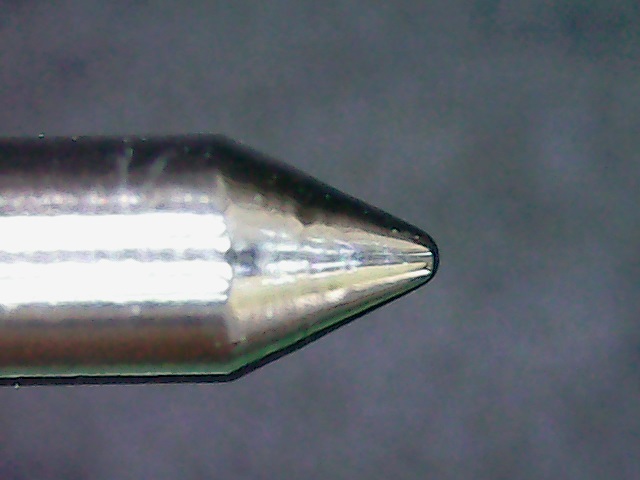

I am only making an assumption the oval ring is the issue as the miss tracking happens at the same point on the wheel. The stylus has to pull the carriage over the hump???
My Vee's and pins are polished with diamond paste to 1micron. I took a picture of the Vee and all I could see was the reflection of the camera. The problem is not the Vee. I have swapped the wheels from left to right and the problem follows the wheel. Vee's are high tensile M3 set screws that were forged with a HSS/cobalt pin at 90deg and pins are 1.5mm HSS drills cut off and 60deg vees ground on the tip.
Plan tomorrow is make a set of wheels for the Boca bearings and install them on the current carriage. If I make the rings 2.5mm wide with 4mm diameter rail rods should work.
My hypothesis is that if there is a simple runout, the carriage has to lift and lower just by the same measure, i.e. very little and very slowly (1/2 turn = 4 times during the whole LP). If instead you think there is a "bump" on the ring, this is really a stumbling block.
yes, but each one alone, or pivots against the mating Vee?
Because if by itself, a minimal lack of roundness may increase the load during rotation and blocks everything - and always in the same point of the wheel, as you noticed

The steel wheels that I made were oval by about 1/20mm and still worked very well. Which makes me think that there might also be a problem with the pivots and/or the vees. What radius are the pivots and vees and what materials are they made of? Maybe try slightly increasing the end shake. Don't worry too much, it took me ages to get mine working as well as they do now. I'm sure you will get there.

Pin radius is 0.125mm and pins are HSS 1.5mm drills
Vee radius is 0.25mm radius Only the bottom of the Vee is highly polished

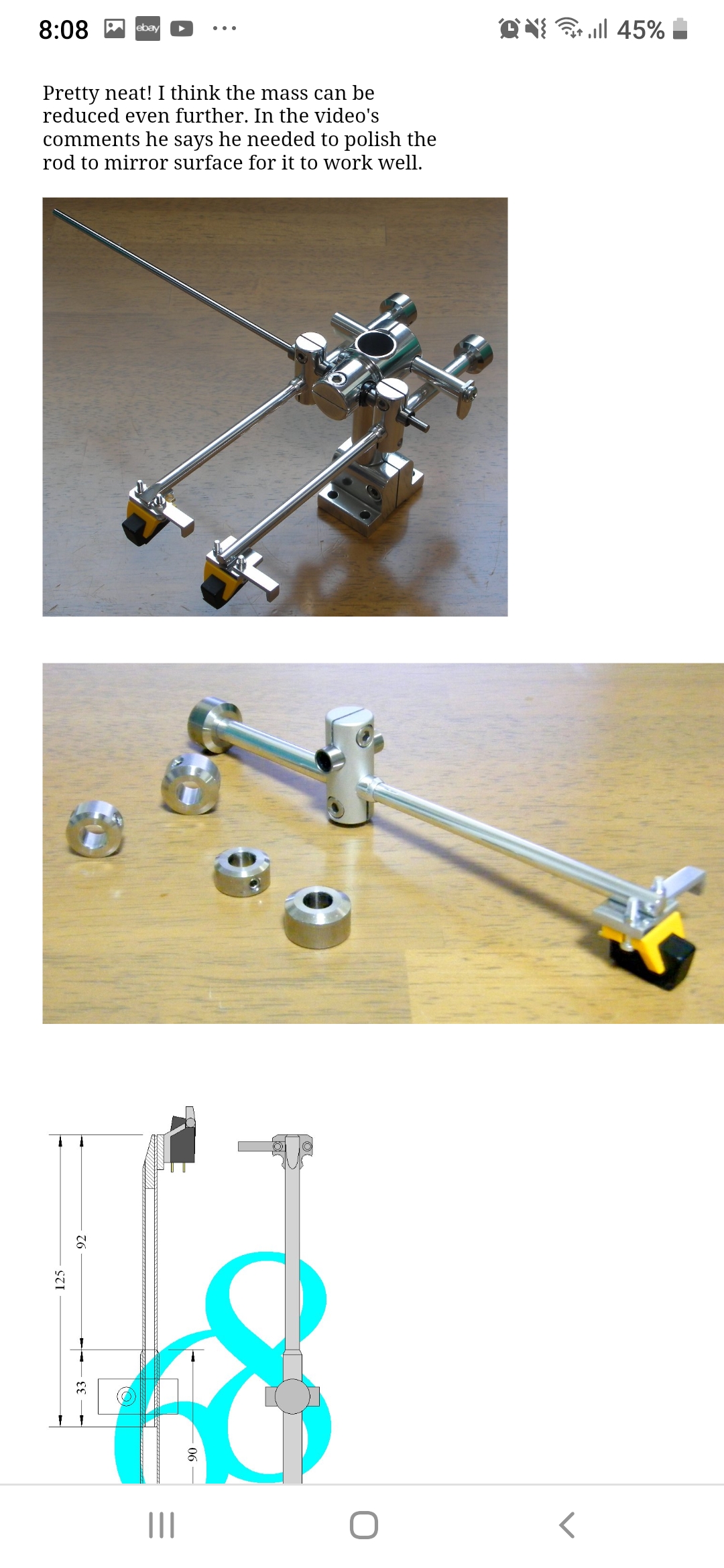

Screenshot_20200406-200828_Chrome.jpgFirst. Thanks Warren, for explaining more about linear tone arm
I am considering this.
Using a bearing Thk lm stroke.model ST 10. 0.0008 friction coifficiant possible. I think with tweaks I can cut the friction by half.
Polished tungsten carbide rod
Similar to old Japanese diy linear tone arm.
Any foreseable problem?
Thank you in advance
Hi Anthony,
From the 2 LTA I have built I would endeavor to make the arm wand as short and stiff as possible, it really does make a HUGE difference.
My first LTA used a 6mm OD carbon fibre tube I stuffed with balsa core. My 2nd is a copy of Niffys carriage which is extremely stiff. The difference is significant, although there are a lot of other changes.
I made a new set of wheels today using Boca ABEC9 hybrid bearings.
I have played LP's all afternoon 8 so far. The miss tracking has gone. I can still see the CL moving back and forth as the carriage tracks a significant off centre record but the Left and Right channel distortion is gone.
I can live with this now until I male a new carriage and re-fit the pin bearings
