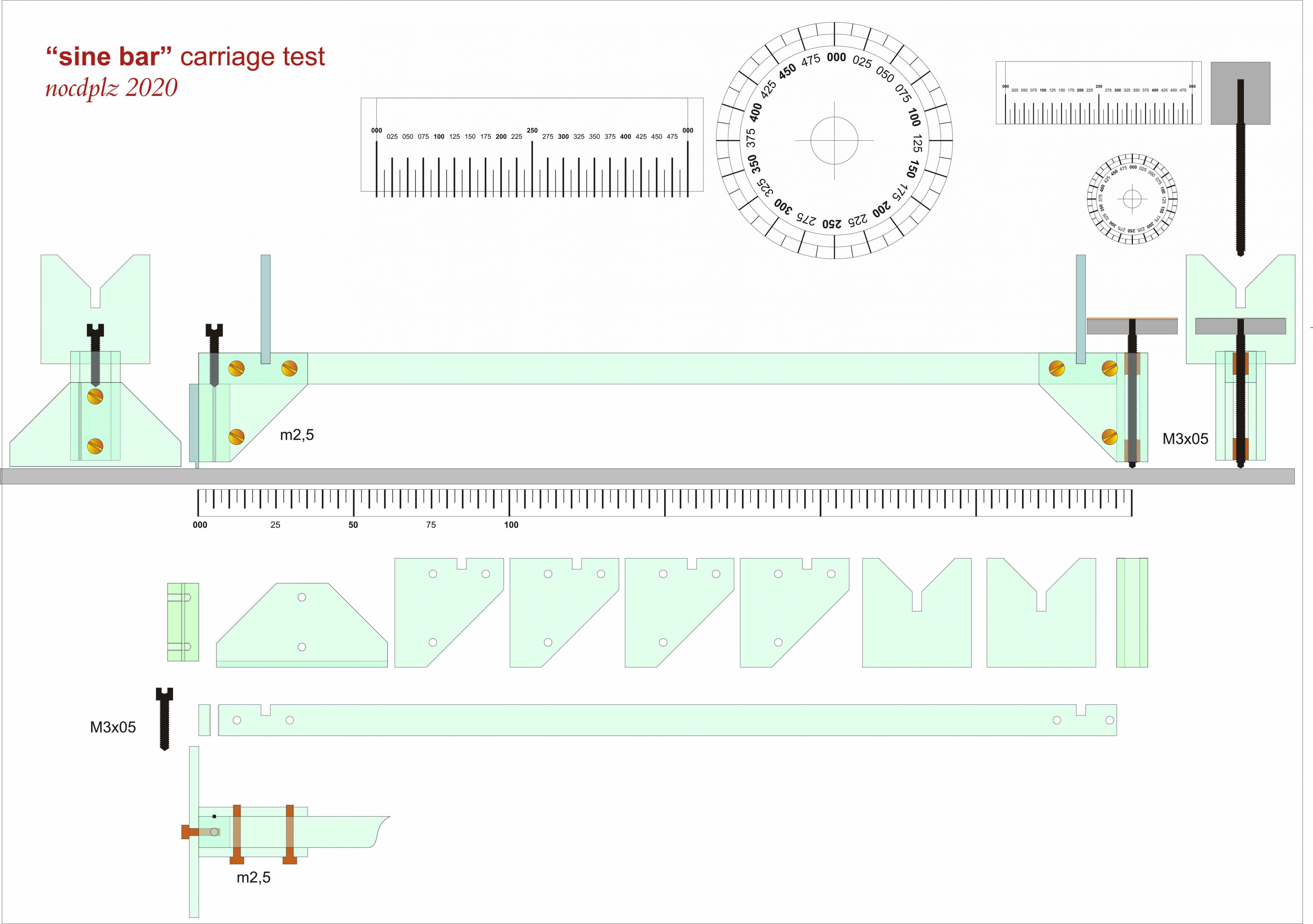

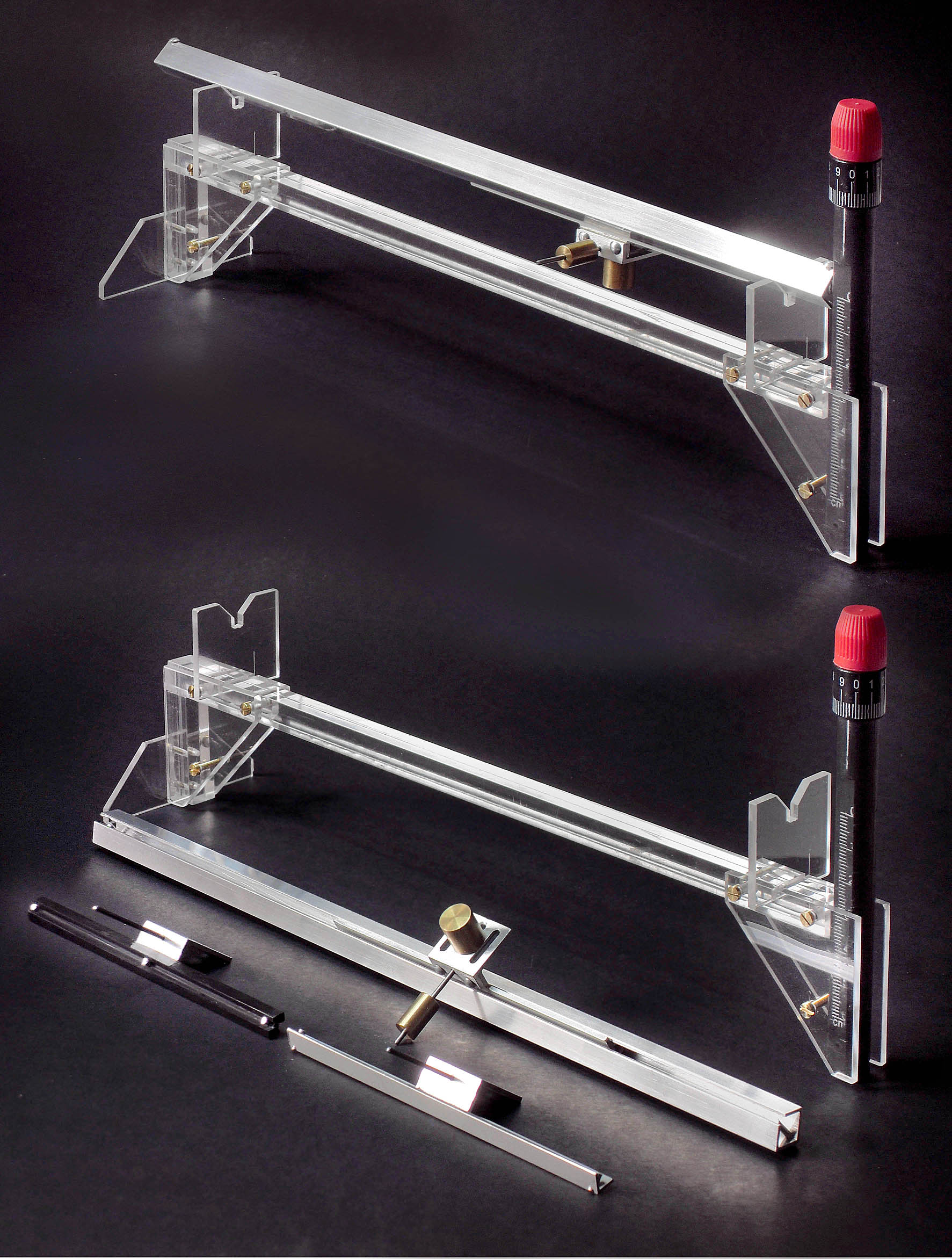

Here is my version of a "sine bar": an afternoon to build it at a 0 cost. (thanks Warrjon, I know - thanks to chinese items I became friendly with the Amazon courier - but I enjoy recycling: the depth gauge of my router gives 2/100 mm, more than enough for this task.
Hoping that this gadget could interest to anyone with curiosity to measure his realizations, or some manufacturer's claims. Both the sides height ("hinge" + depth gauge) can be changed to make positive and negative tilting.

Thanks Niffy, let's see if this "masterpiece" deserves your compliments. A little mod, with an adjusting screw for the left support tuning, made first leveling much faster. (attachment)
I found more or less the data previously posted - max differences + 10-15 cents, which fall within the subjectivity of the observations, or some differences of leveling, that is very critical.
At the beginning, the carriage A showed almost doubled measurements, and I could not understand why: then the irregular motion remembered me that the rail had remained all the time in the midst of the work dust. after a thoroughly cleaning everything went back to the normal.
So beware of dust: can double the friction, and frustrate the construction sophistications.

disclaimer - When posting the photos I forgot to warn that the "sine bar" tilting gives the carriage a perfectly axial thrust. So it is excellent for testing those using a radial rail (as Lil Casey), but less for conventional LT, where the force is applied by the negative shaft lever (= torque). For these, the Niffy's inverse pendulum, which allows you to apply force directly on the head shell, seems still preferable.

Hi Carlo,
Looks good to me.
Regarding your disclaimer. The sine bar doesn't apply force at the same location that the stylus would and therefore doesn't apply the torque that would be seen in actual usage. As the frictions that we are achieving are very low the amount of torque and the modification to the loading of the bearings that result will be extremely low. The sine bar has the big advantage over the pendulum in that it also measures dynamic friction. If my hypothesis that my bearings operate purely in dynamic friction is true then this would make the sine bar method better suited to our application.

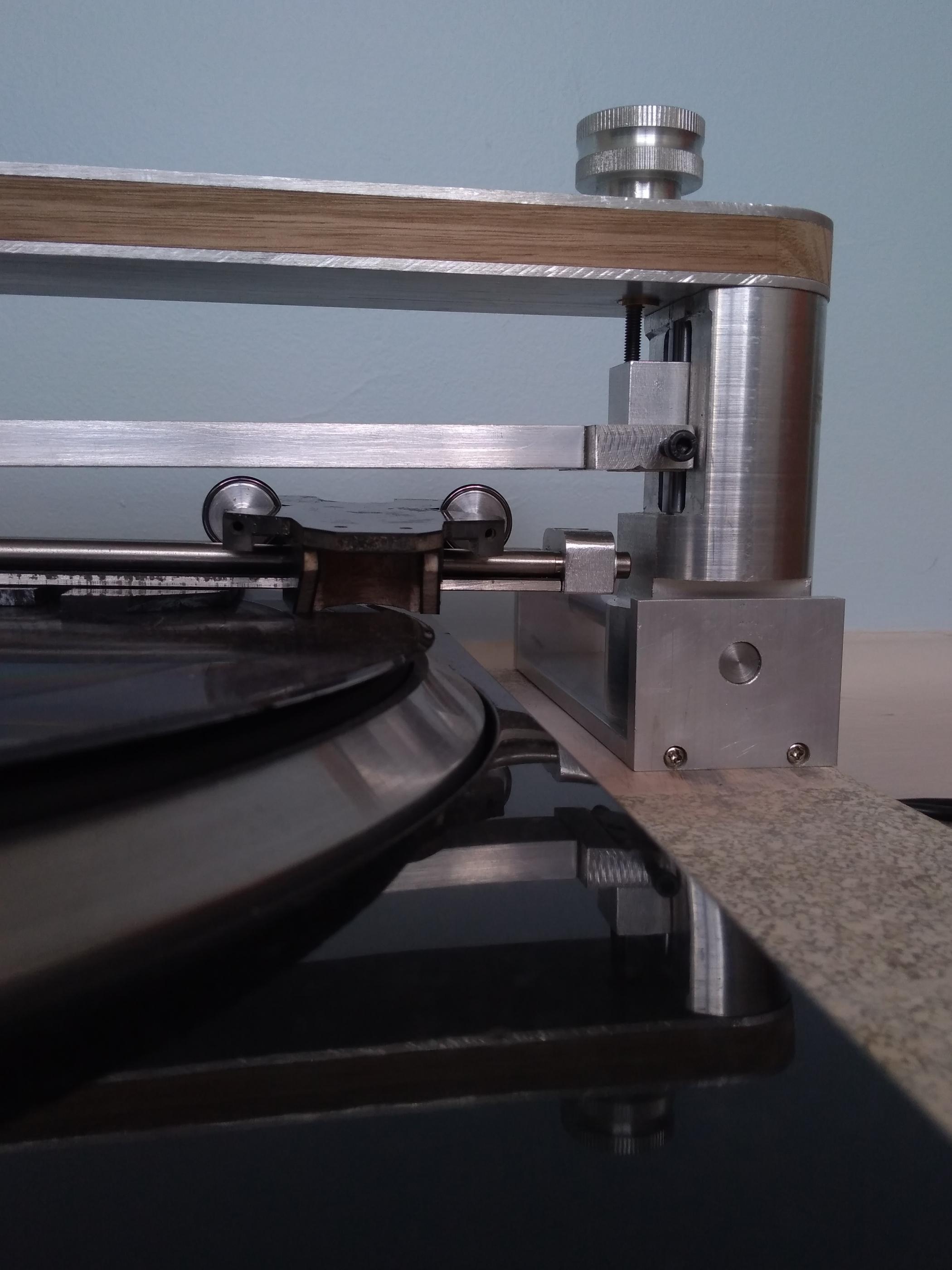

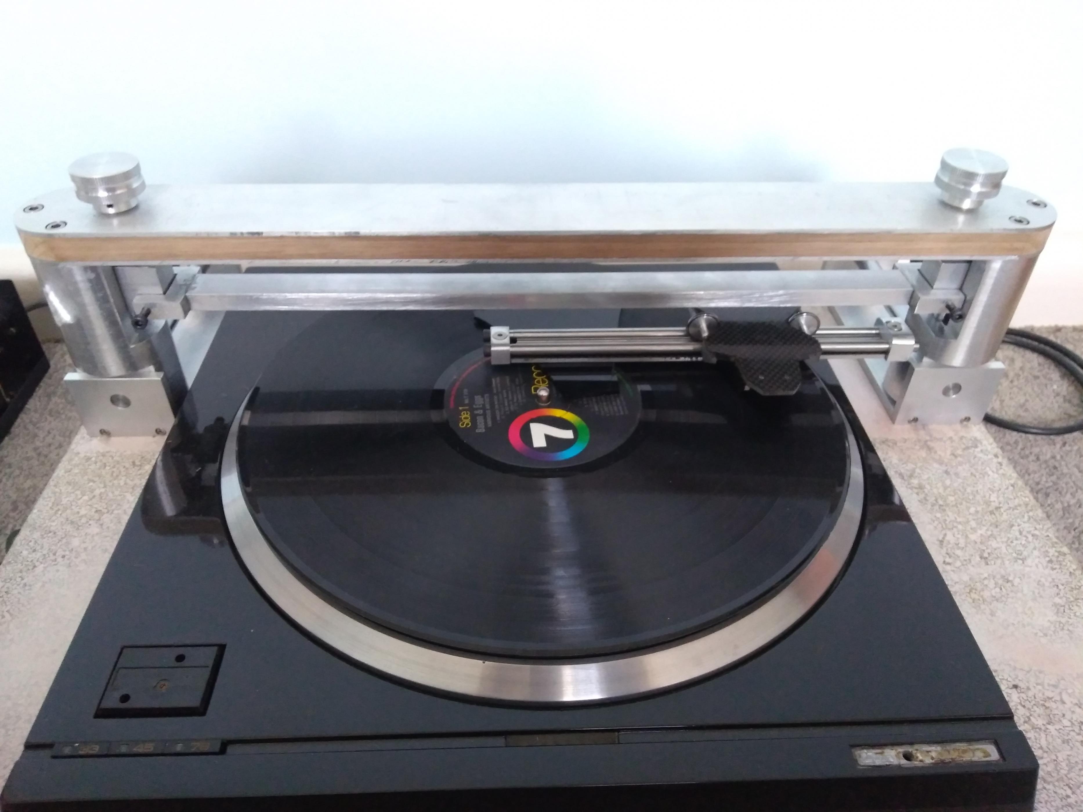

Cheers Carlo, I was referring the Mk3. But at my pace I might not get it built before I die.
Making slow progress. Mocked up to check height. I added screws (the black cap head screws) on each end of the horizontal bar (rail support) that the rail will suspend from to allow a small amount of LTA adjustment for fine tuning. These screws have a 60deg point into a Vee brass insert. I'll cut the head off and slot the screw and add a nut to lock it down later.
I made the rail support slightly tight so it applies enough pressure so as not to need springs to load the VTA. Each end is adjustable for tilt or more precisely to level the rail with nearly 7mm adjustment. The rail support also has a hardwood core glued in to stiffen it.
I ran out of carbon fibre, so the bottom of the carriage is not yet finished. The VEE bearing wheels are far better than the bearings in my current setup, they spin for ages, very low friction.
The runout in the previous wheels was unacceptable, so these wheels are machined from a single piece of aluminium with the carbide rings an interference fit.

Awesome, remarkable, Warren. "The Definitive Tonearm" could be defined by any famous manufacturer.

It would be useful if many measured their carriage, to know which are the best solutions, not only in theory or by sensations.
carlo
what a dumb 1: there is no need to raise the sine-bar rig on right and then the left side to check if the base is horizontal, just rotate it 180°, as you do to check any bubble level.
what a dumb 2 - to level the base I've used a good laser level, measuring the alignment on the wall: a very precise method, a sin that I later discovered that the floor is not at all horizontal
Straight rods
