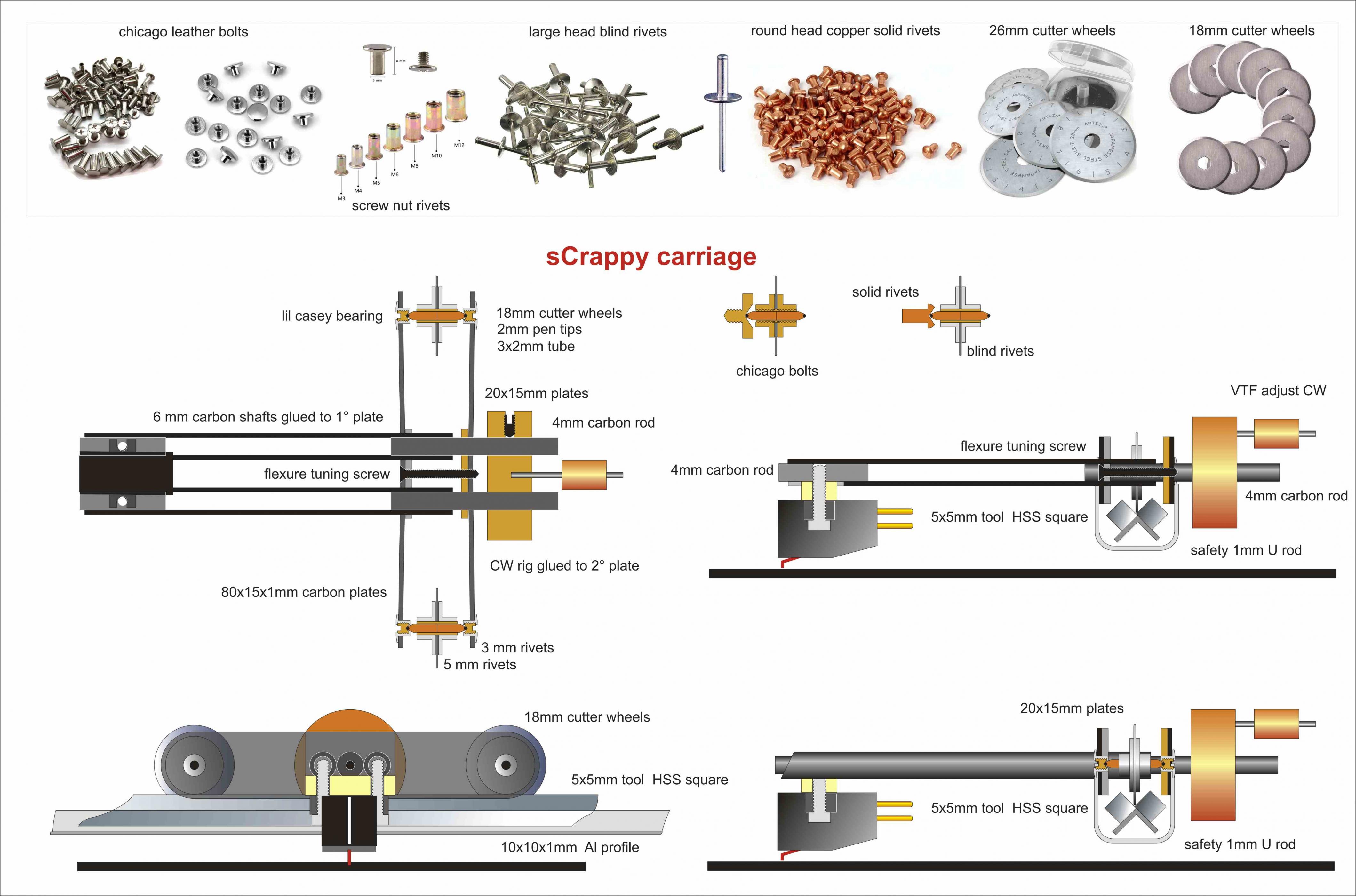

Hi all, since in winter it is too damp-cold to play with my hated 9"x20" in the garage, I tried to think how I would make a carriage without a lathe.
It's amazing how many things (except our V jewels) can be got from baymazon, of course spending much more on shipping than for buying a lathe.
The idea is to assemble, with just hand tools on the famous kitchen table, a very light, chattering free carriage (all weight is in the CW).
Will it work? just hoping there is some useful idea for someone (flexure? head shell?) .
carlo
sorry - the CW can be put asimmetrically, lowered with respect to the drawing

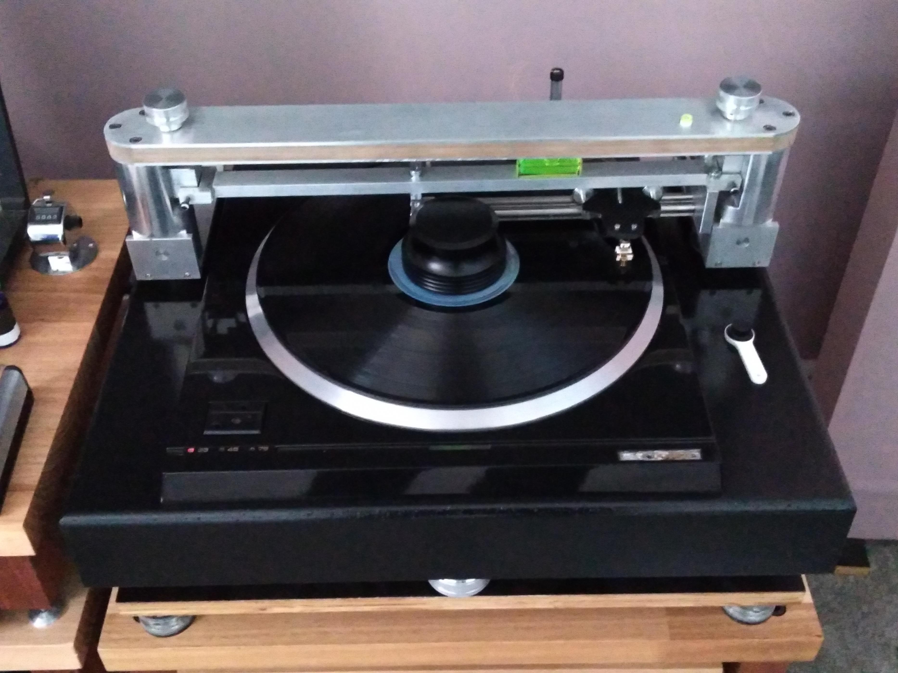

I finally have it finished.......... Good new and Bad news
Good news it sounds great, micro detail has improved significantly.
Bad news is it miss tracks dreadfully I suspect the carriage is too heavy (50g including cartridge) for the ultra high compliance Stanton to pull.
The video is with the rail level. You can see the stylus is significantly pulled to the left. I tried tilting the rail slightly but then the carriage will not traverse backwards. Nothing I did would result in playing a full record side with at least 2-3 miss tracks.
YouTube
Next job to make a lighter carriage and re-test.

Hi Warrjon,
My cartridge is also high compliance at 22um/mN though not as high as yours at 30um/mN. My carriage, including cartridge, wheels and counterweight, weights 55g. Even on my torture test record with the huge eccentricity the cantilever defection is barely noticeable. When I was using ballrace bearings with this carriage and cartridge I never suffered skipping (except for when there was an obstruction in the groove). The ball race bearings had about 4 times the friction of the current bearings.
I think the problem is more likely to be something with the setup of the bearings. I did build a lightweight carriage as an experiment but it didn't sound anywhere near as good as the heavier version.
Good luck finding the problem.

Hi Niffy,
I thought about the bearings, the pin bearings spin far longer and smoother than the ABEC9's on the old arm. I was going to pull ABEC9's off my other carriage and install them on this just to test. I have to work for the next 3 days which will give some thinking time before I get back to it on Saturday.
Very strange, Warren - but are the cables ok? they act in the shadows, like butlers in detective stories
Mistracking - Seems a matter more complicated than what the common sense suggests. On the Lil Casey of his friends Walter had noticed that low compliance cartridges were more prone to skipping, and I had verified it even on mine; so we had ventured some hypotheses - see #3026 - 27 - 28.
Quote what Niffy says, at most it should happen on excessive eccentricities. Have you measured the friction-stiction? even the cat whisker method gives some useful indications
