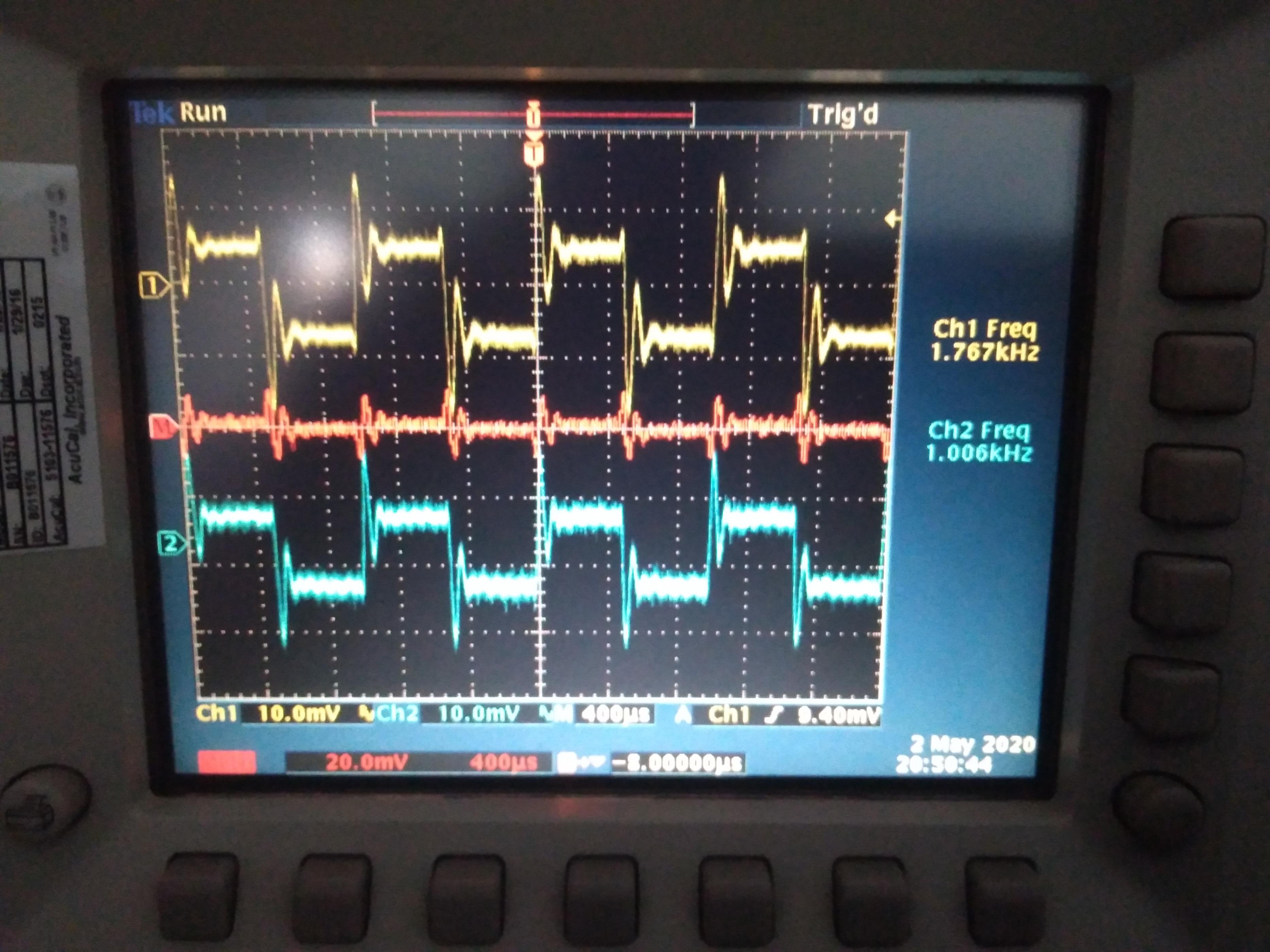

I thought I would post this here as well as in the Air bearing arm for reference for others.
Here is a shot of my LTA, inspired by Niffy's design, tracking the CBS STR112 1kHz square wave.
NOTE: I have used no loading except the scope input 1MR and 33pf so the ringing is a bit high as my Stanton 881s needs 47kR and 275pf.
CH1 Left and CH2 Right red trace is math function CH1 - CH2, NO averaging
?'s
Hi Warrjon,
Could you do another screen shot with the cartridge properly loaded ?
Does your fixed bearing still have a lot of horizontal movement as shown on the youtube video?
tia,
dennis h

Hi Dennis,
I can do another square wave measurement but I'll need to get a longer set of RCA leads. The RCA's from the TT to the preamp are very short to keep lead capacitance low.
The horizontal tracking is much better and the arm does not miss track unless I fiddle with the height. The carriage is running a bit tail up ATM to allow enough room for 180g LP's and clearance when cued up on warps. I need to add a thicker spacer under the cartridge.
I found getting the arm level can't be done with a level, I need to lower the stylus on the platter without an LP and watch for cantilever deflection, doing it this way improves tracking significantly.

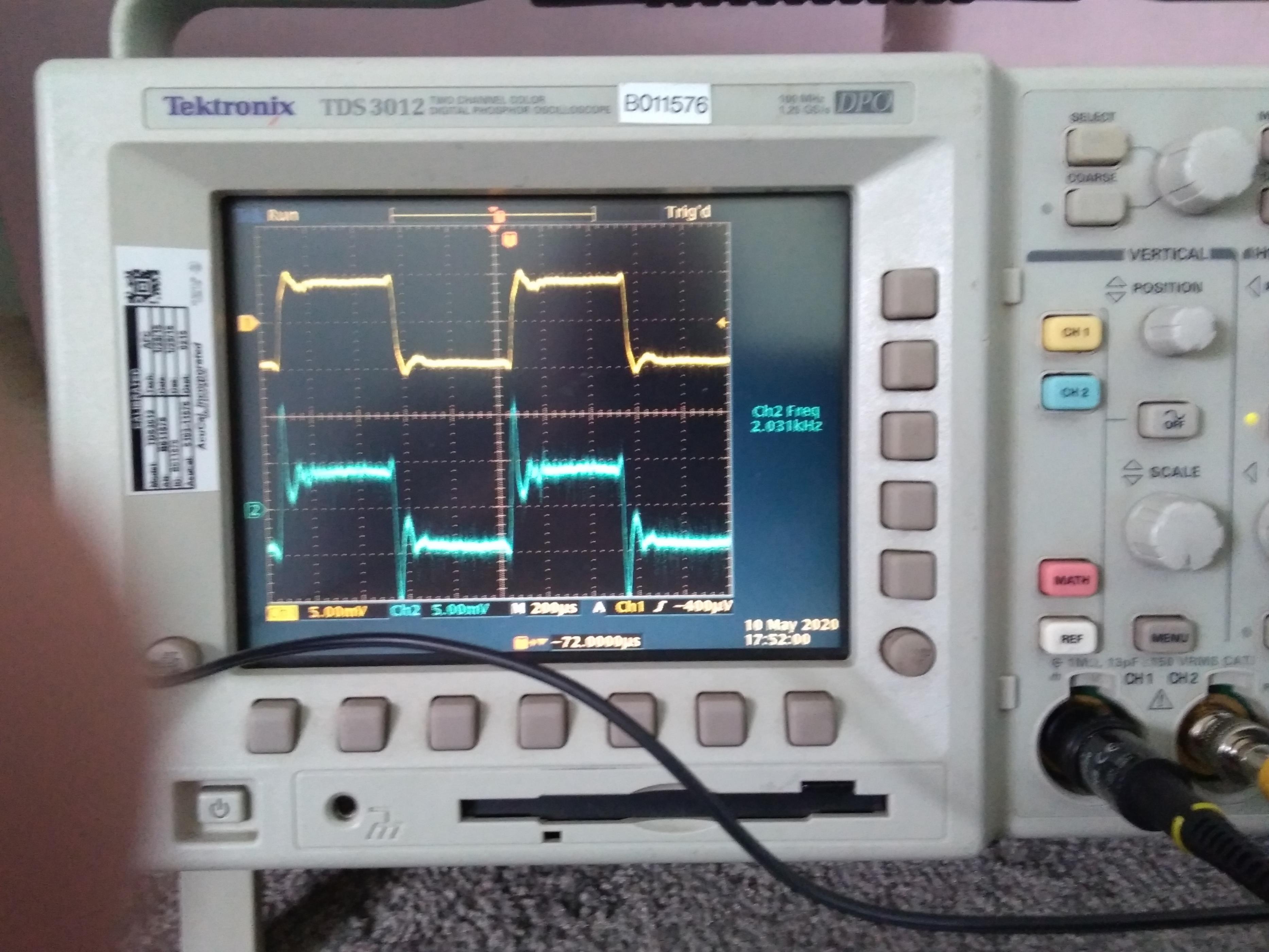

Hi Dennis,
Here is a screen shot with one channel plugged into the phono-pre and the other directly into the scope. Yellow trace is phono-pre blue trace is the TT plugged directly into the scope. So capacitive loading is 330fp yellow and 33pf blue.

This comparison is very interesting and really new for me, Warren; often we try to split the hair in 4 while forgetting all the rest, starting from the cartridge loading. For example very few of those I know measure the cable capacity, and take it into account, even if a wrong load changes the sound more than the worst tonearm.
Perhaps it would be interesting to do the same measurement on every step of the whole audio chain: 0 - at the cartridge output; 1 - at the pre phono input; 2 - at the pre phono output; 3 - at the amplifier input; 4 - at the amplifier output ; 5 - after the cross over; 6 - on the mid speaker terminals.
The ideal would be to generate the signal not from a track on the test disk (therefore from the sum of the imperfections of the recording and the support with the resonances of the turntable and the tonearm ) but by directly soliciting the stylus (with a piezo buzzer?) with the cartridge tied to an almost non resonant support.
This in order to be finally able to separate the crimes of our tonearm from those of all the rest of the gang

I did that using an LCR bridge.
Tonearm wiring 10pf
Cable from TT to phono pre 32pf
Phono pre 210pf
Total loading is a little low for my Stanton at 250pf total.
My interconnect is very short 300mm and DIY made from 2 core shielded microphone cable.One core is + the other is - and the shield is only connected to - at the phono-pre end.
The scope photo above I was playing with capacitive loading on the phono-pre to get the best balance.
If you look at the difference between the 2 channels you can see 2 things.
1 The leading/training edges on CH2 (blue trace) are more vertical than CH1 (yellow trace) this indicates higher frequency response of CH2. CH1 has too much capacitative loading at 360pf including 33pf of scope.
2 The ringing on the leading/trailing edge of CH2. This oscillation will have the affect of making the sound very bright.

Hi Jim,
Sorry I wasn't clear. The scope shot in #3652 was the input to the phono-pre not the output. If I was to scope the output it would be a sawtooth (triangle) wave.
Scoping the input with this LP gives an indication of how well loaded the cartridge is and in both the cartridge is not correctly loaded CH1 is too much C and CH2 is too little C.

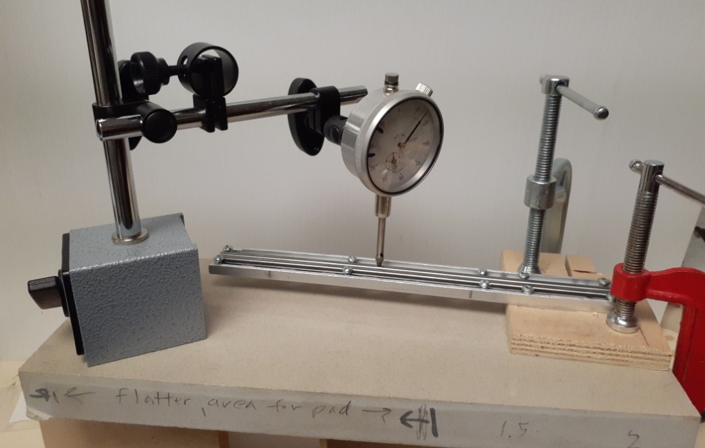

Straight rails
Warrjon,
Thanks again for that tip about the granite plate and the Vee Blocks. I was not so lucky with HSS rods, but the Carbide rods from Castlebar (on ebay) were pretty good.
I had to cut mine down from 13" with a Dremel like diamond wheel. That turns out to be a poor idea because there's a WARNING sticker - CANCER. There's Cobalt in the mix and it's a suspected Carcinogen. Better to buy the right length. I wonder how many ebay sellers don't bother with that warning.
The Dial Indicator worked out very well for tweaking the rods to straighten them. I measured each rail at 1" increments and plotted the results...
I have a 24'" granite surface plate. Place rods on Vee blocks and run a test indicator over them. Rotate the rod and check again, I used the Vee block clamps on top of the rod to hold it.
Also just rolling the rods on the surface plate you can hear the uneven roll if they are bent, even a small amount. The worst ones rocked back and forth.
Do it multiple times to ensure repeatability.

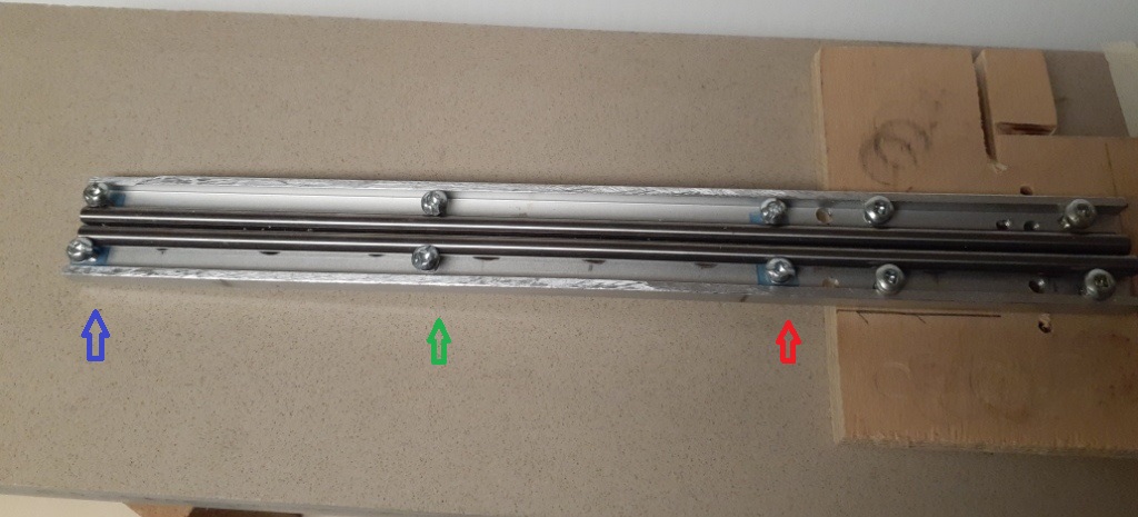

Warrjon,
There's a 0.025" spacer under the bolts highlighted with the red and blue arrows. Those bolts are snugged up to trap the rods. Then the bolts by the green arrow are tighten in stages to flatten out the rod. The dial Indicator measures the results.
Applied hot glue from under neath to fill in the gaps and keep everything in place.
I used something similar to Carlo's friction test to see the results. Flattening the rods gave me much more uniform results. Very happy with how it turned out.
Hugh
