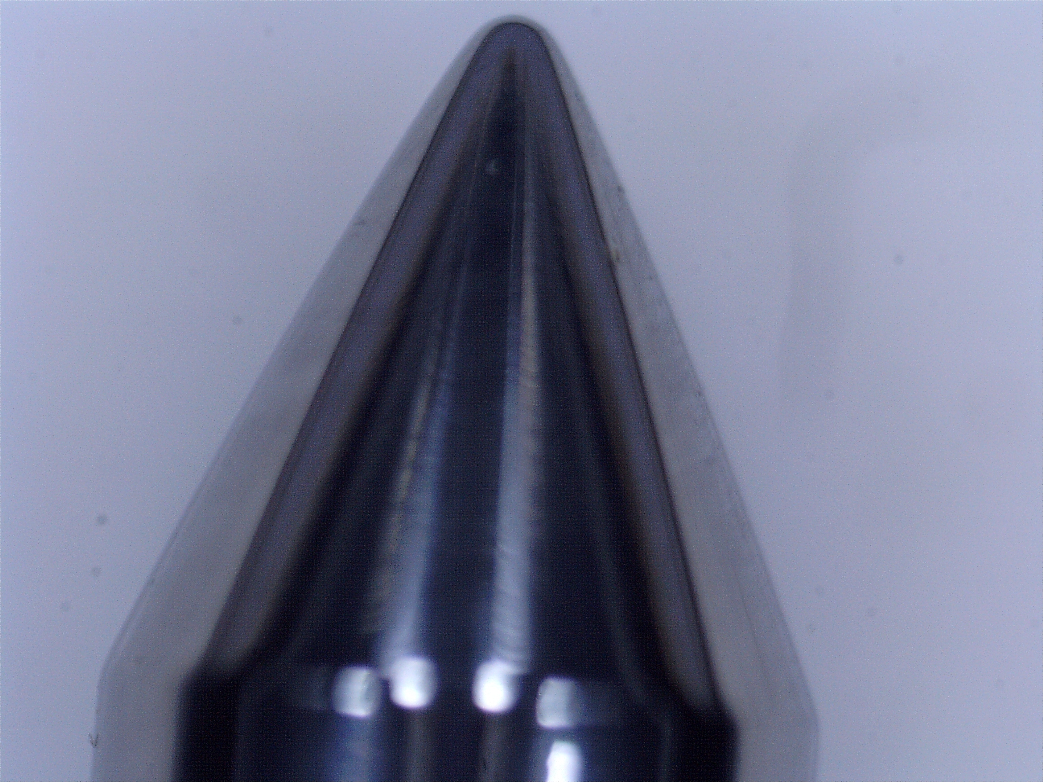

I just received some 5mm Carbide rods from a US ebay seller called Castlebar. They seem pretty good when I roll them on a table. But now I'm wondering how you were able to check yours to be straight within 0.02mm. Did you use your Lathe for this? (I'm envious again).
Hugh
I have a 24'" granite surface plate. Place rods on Vee blocks and run a test indicator over them. Rotate the rod and check again, I used the Vee block clamps on top of the rod to hold it.
Also just rolling the rods on the surface plate you can hear the uneven roll if they are bent, even a small amount. The worst ones rocked back and forth.
Do it multiple times to ensure repeatability.

I finally have it finished.......... Good new and Bad news
Good news it sounds great, micro detail has improved significantly.
Bad news is it miss tracks dreadfully I suspect the carriage is too heavy (50g including cartridge) for the ultra high compliance Stanton to pull.
The video is with the rail level. You can see the stylus is significantly pulled to the left. I tried tilting the rail slightly but then the carriage will not traverse backwards. Nothing I did would result in playing a full record side with at least 2-3 miss tracks.

Hi Warrjon,
My cartridge is also high compliance at 22um/mN though not as high as yours at 30um/mN. My carriage, including cartridge, wheels and counterweight, weights 55g. Even on my torture test record with the huge eccentricity the cantilever defection is barely noticeable. When I was using ballrace bearings with this carriage and cartridge I never suffered skipping (except for when there was an obstruction in the groove). The ball race bearings had about 4 times the friction of the current bearings.
I think the problem is more likely to be something with the setup of the bearings. I did build a lightweight carriage as an experiment but it didn't sound anywhere near as good as the heavier version.
Good luck finding the problem.
Niffy
