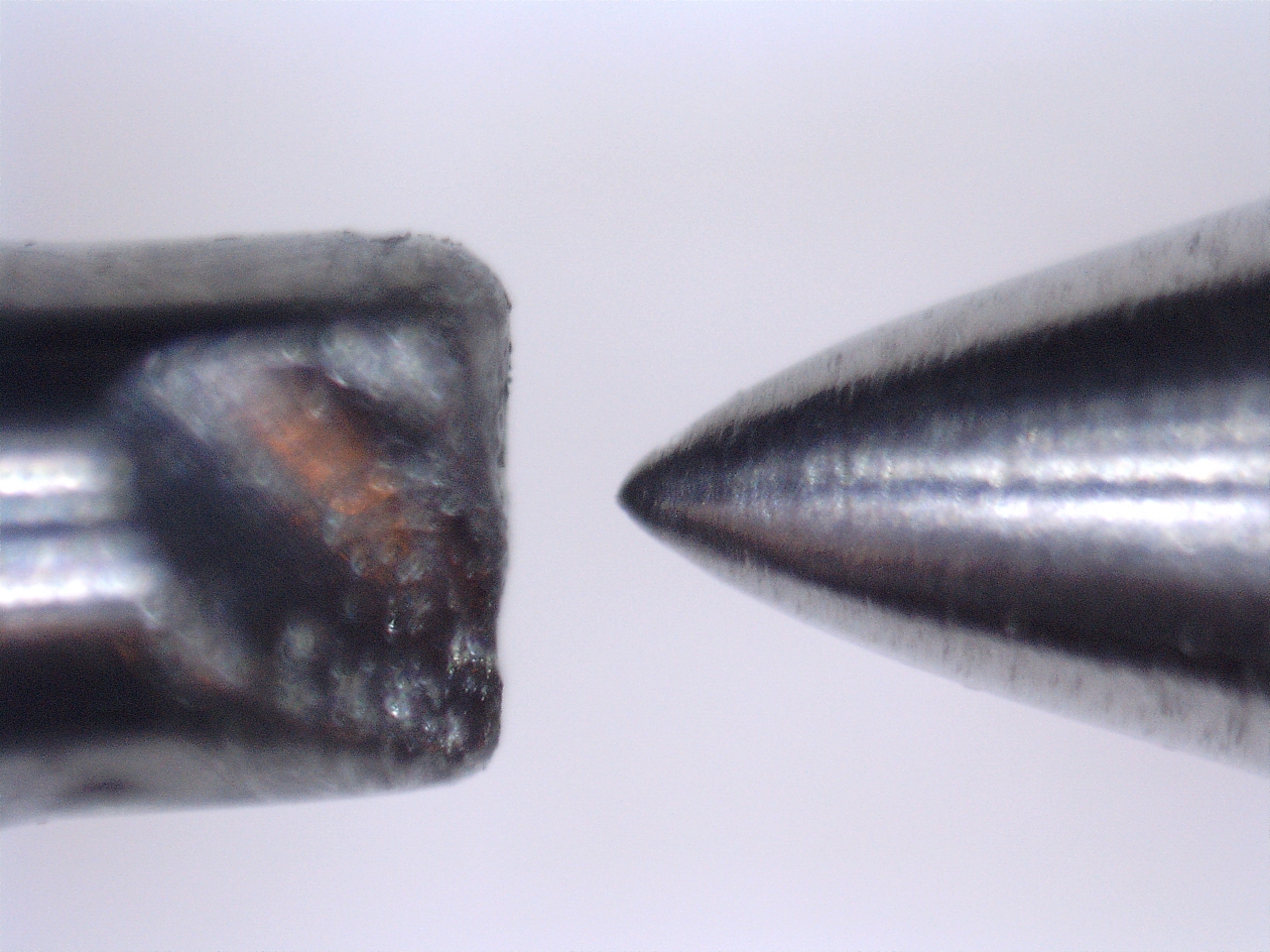

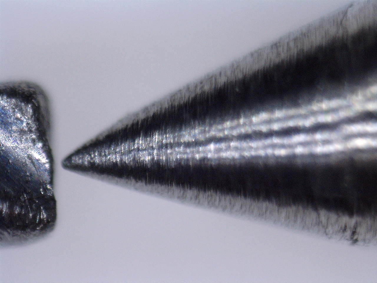

Had a crack at making a VEE. The pivot pin was easy I used a 2.5mm cobalt drill and ground it at 60deg on the lathe. with a 0.5mm radius. The VEE was not so easy. I will have to grind a special cutter to cut the VEE.
The pic is 1/4 stainless I cut the VEE in the pin is the 2.5mm drill with a 1mm drill to check radius.

When I made my steel pivots I gave them a radius of 0.125mm. I used a 0.25mm drill as a visual reference in exactly the same way you have. I used harden steel 0.8mm sewing pins. Prym brand are high quality with a nice symmetrical point that makes accurately rounding them relatively easy. A 0.5mm radius is rather on the large size for this application.
To make the vees I cut the shank of a 6mm cobalt drill at 45°. I rounded the tip to a radius of 0.25mm using a 0.5mm drill as a reference. I used this as a punch to cold forge the vee in the end of a stainless steel M3 grub screws. I polished the vee using polishing paste on a sharpened matchstick in a dremel. The act of cold forging will work harden the surface of the stainless steel.
The steel vees and pivots resulted in a massive reduction in friction compared to the very high quality boca hybrid ballrace bearings I had been using previously, reducing it to about half. The effect on sound quality was not subtle either. This was in part due to the lower friction resulting in lower tracking errors. I believe that the elimination of bearing chatter played a bigger role with the improvement in mechanical grounding being the main reason for the improvement.
The move to the more exotic materials definitely wrought even greater improvements. The steel pivots and vees probably cost less to make than the bocas did to buy. The jeweled and carbide bearings cost considerably more.
If you want to make your own vees I would recommend cold forging. You only have to shape the punch once rather than having to shape each vee individually. Convex shapes are much easier to make than concave.

Hi Niffy,
I didn't explain that very well. The pivot pin with 0.5mm radius (actually about 0.35-0.40 measured with a micrometer) was used to make the VEE. I used valve grinding paste to grind the VEE in a 6.35mm stainless shaft, unsuccessfully I might add.
I hadn't thought about cold forging. I'll regrind the drill and give it a go, I have some M3 grub screws. If I could buy the correct VEE's that would be easy, but getting them especially here in Aus is not easy.

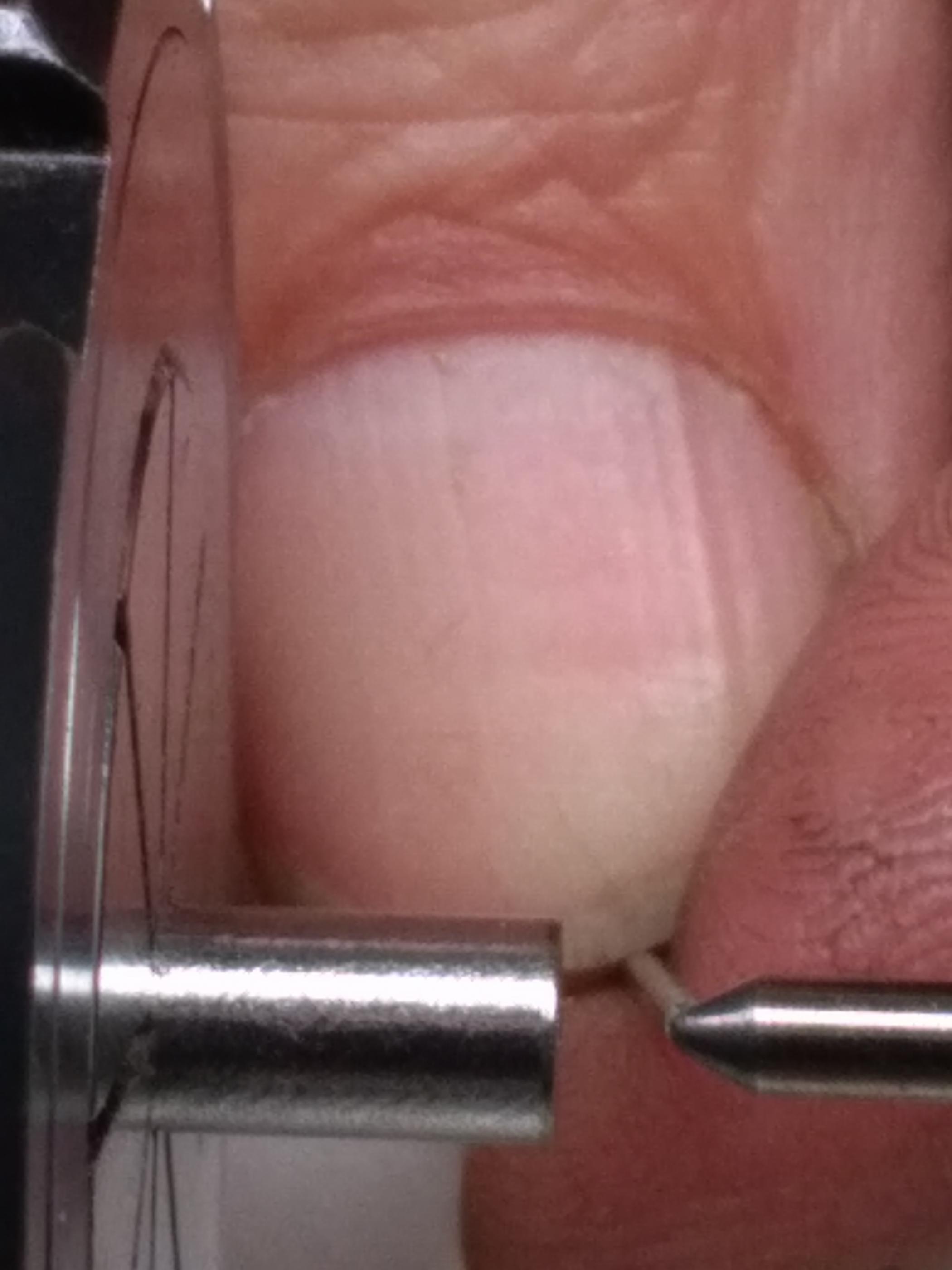

Did a quick trial on the lathe with a dremel for grinding and came up with this:
It's a 1mm broken tungsten drill with a second one on the left for reference.
I went over it fairly quickly with some 2500 wet paper as well, so I haven't polished it that much. I will try to figure out a more robust solution than the dremel.
I tried a different approach and I belive it worked out well. The pivot went into the dremel
and I used a diamond cup grinding disc placed in the lathe chuck.
I have done no finnishing work on it but I have a few other grinding cups to try first.
Cylindrical grinding you want to turn the bar being ground slowly (say 80rpm) and the wheel speed will depend on grinding disc diameter, but 3000rpm with a 150mm diameter wheel would be the minimum even faster if the wheel is smaller.
Might be an opportunity to make a tool post grinder. If using the Dremel do the bearing modification to better seat the bearings.
