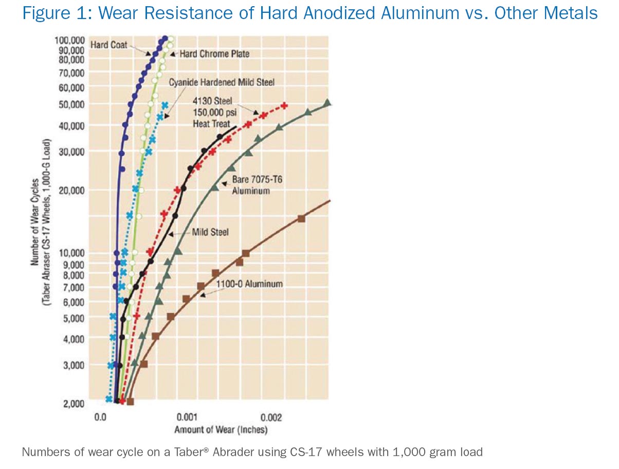

The anodization, especially the hard+teflon one is not a simple embellishment, but a surface treatment, a kind of hardening widely used in industry. On sailboats e.g. there are winches, pulleys, sliders working for decades under heavy loads + sand&salt wear. (from direct experience). Using a spring for contact, our loads would be much more contained.
The problem is anodizing; having my gadgets anodized by a workshop nearby, I can say almost nothing, but a friend used an ebay kit with excellent results. The crucial stage is the final sealing: normally into boiling water, but the heated pivots themselves could be rotated against the vees to obtain a perfect and smooth seat. A few turns with diamond powder for the break-in, could help too.
maybe - carlo

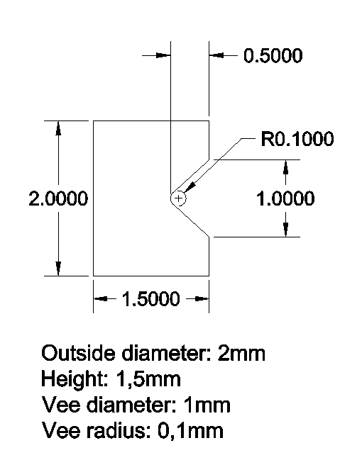

0.1mm radius is a little small. Maybe see if they can do 0.2mm - 0.25mm.
You can probably get away with 0.1mm if you have a pivot radius of 0.075mm which is a bit larger than the normally recommended 1:2 - 1:3 ratio. A 0.05mm pivot would result in excessively high contact pressure and may limit bearing life expectancy.
Niffy

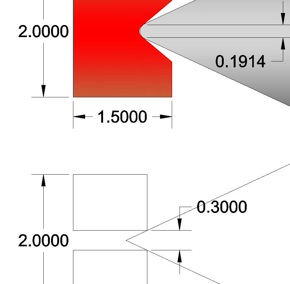

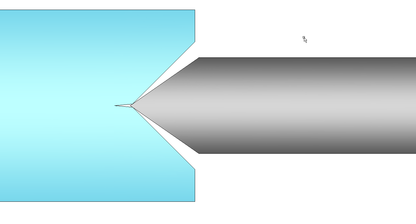

I'm quoting myself here but...
From true point:
Notes: When used horizontally, the pivots should not bottom against the radius of the jewel. A degree of looseness is required which is called 'end shake'.
The top part of the drawing shows such a solution. Why this is I don't know but I suspect that true point knows what they are saying. For a bigger pic see:
http://www.dahlbergaudiodesign.se/images/linear_8.png
Edit: When applying this way of thinking a holed jewel with a hole the same radius as the contact radius of the vee schould function similarly. The smallest holed one from true point was 0,3mm, therefore in the drawing.
With a conical ring jewel + end cap the contact point will be smaller than your 2nd picture. A straight ring jewel will be similar but it has much higher contact surface and therefore friction.
A 0.3mm hole is very difficult to drill in a hard bearing.....
I've been punching some numbers.
If you use sapphire vees with a cup radius of 0.1mm you will not be able to use tungsten carbide pivots with a tip radius of 0.05mm as the contact stress will be too high (a 2:1 ratio with the cup, as generally recommended). If you use steel pivots with a tip radius of 0.05mm the contact pressure will still be a little excessive. If you increase the radius of the tip of the pivot to 0.075mm the maximum contact pressure will be decreased to a just usable amount for carbide and a quite usable level for steel. I am assuming a 50g carriage mass and reasonably careful handling.
Brass would not be suitable for making pivots.
Even the finest tipped ball point pen has a tip that is way to big for this purpose. I used hardened sewing pins to make my first pivots. I used prym brand as these seem to be very high quality. I carefully rounded the tips to a radius of 0.125mm and then polished them. Rounding the tips to 0.075mm shouldn't be much more difficult. Use the shank of a 0.15mm drill bit as a visual reference. A microscope will help.
Finding tungsten carbide pivots in this size will not be easy.
Niffy

Ok, first reply about the vee's.
hello,
pleased to receive your inquiry, we can produce your drawing bearings.
How many pcs you need this time?
Welcome tell us sample quantity you like.
Thanks&regards
Linda
Response:
Very nice to hear from you, I wasn't expecting such a quick response. I will have to get back to you
about the specifications but it will not change that much. It's the vee radius that might have to be a
bit bigger, somewhere around 0,2-0,3mm schould be close to the final order. All other as in the drawing.
If you could give me quotes for both 50, and as an alternative 100pc.
Best regards. Bengt Dahlberg
