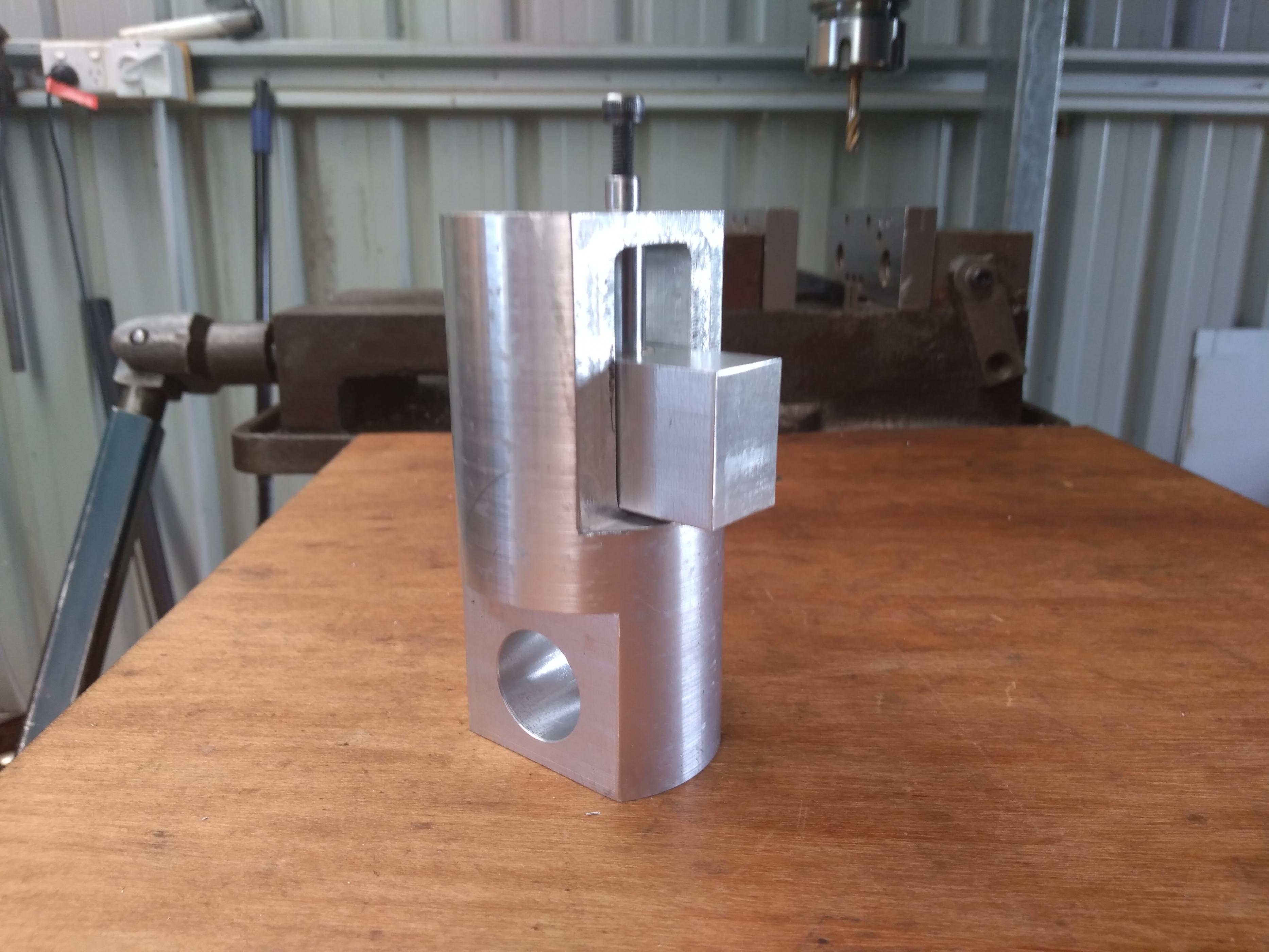

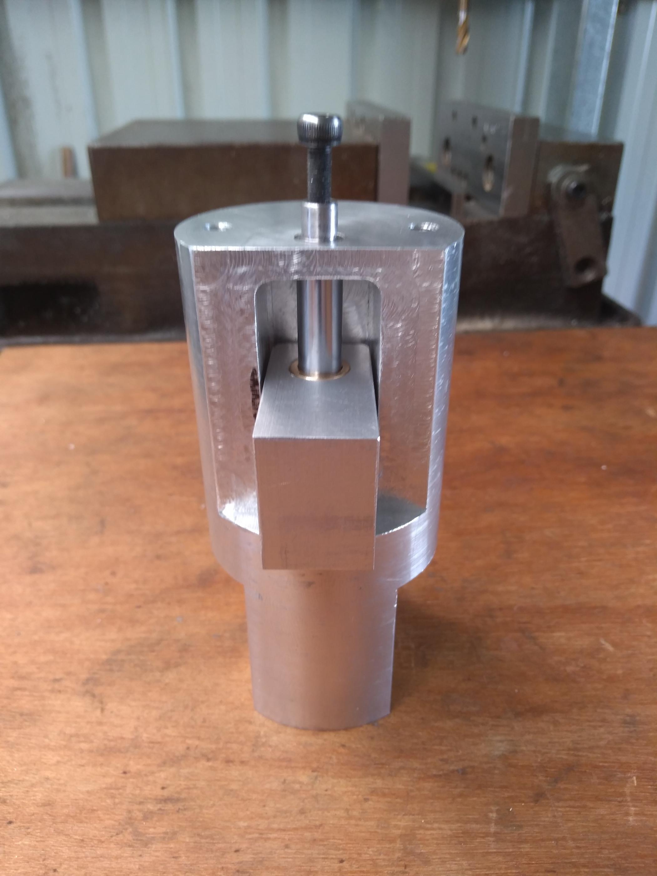

I like the idea of the spring I will give the one with the push screw a try. It will be easy to implement. I tend to over engineer things and make them complex. I like your simplicity. I have some 30mm OD Delrin I can make the base bushes from. Although the bearings I bought have no movement as they are industrial not average eBay units.
Here are the pillars with VTA blocks. I'll cut the VTA blocks shallower and implement Carlo's idea of the spring.

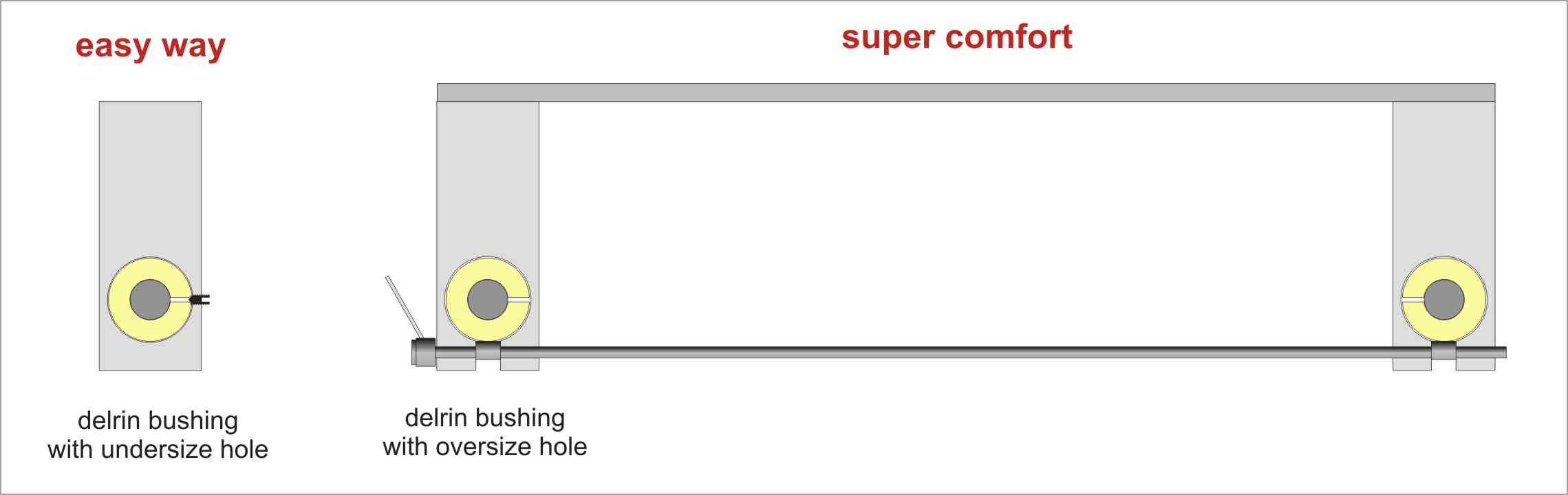

the pulling screw + spring doesn't ask any change of the block. If I were you i'll try this first.
turn the delrin bar with an inner hole 2-3 tenths smaller, and cut them longitudinally for fine adjustment.
Indeed - it could be done a lever to position the arm with an eccentric that tightens both the delrin bearings, blocking everything - no play, but easy sliding once rotated back

beautifull milling - all my envy -(a no milling machine owner)
Hi Warrjon,
Very nice work. +1 on the machine shop envy.
Many tonearms have a large adjustment range to facilitate easy mounting on a wide range of decks. As you are building specifically for the SP10 you only really need a small range of adjustment. I have an adjustment range of about 6mm of which I use about 1. I think your pillars have plenty of range to be able to fit the spring. Possibly cast the spring in some low modulus silicone to damp it and prevent it from ringing.
Niffy
I originally made the VTA blocks big enough to hold a 8mm linear bearing but changed to the brass bush so I could lock the block in place, I have about 10mm of vertical adjustment.
I'm going to leave the bearing part of the block at 25mm deep to keep a longer bearing surface, I made the bushes a loose fit (0.04mm) so they don't bind with temperature changes and only machine the front to accept a spring. Good idea I will cast the spring in silicone.
The one with the undersized hole will become loose on the shaft when the collar is locked. The oversized hole might work,,,, as the cam will push the bush up and lock it to the shaft and pillar. I would need a separate locking cam for each pillar, Ill give it some thought and see what I can come up with.

undersized: the screw is just to adjust the delrin bushing with almost no play, the rest is up to your magnet
oversized: if you need two cams the solution becomes too uncomfortable: that mechanism should be moved instead by the arm lift itself.
Otherwise you could have an eccentric to disengage your magnets, like that on a dial gauge base...
sorry - just a blah blah without knowing well your design.
carlo
silicone: an heath shrink tube works too

I had a good look and think today about the delrin bush and could not work an easy way for it to operate, there is not enough meat under the bush to install the cam. So I decided to keep the linear bearings for the moment.

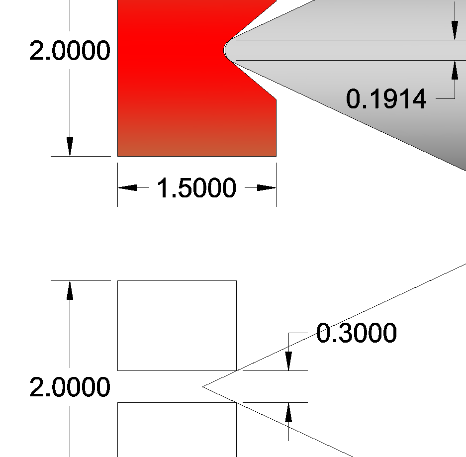

Given the difficulty of obtaining the Vee jewels, what if we make them from aluminum? a thick, hard anodization (AL2O3) has Mohs 9, like sapphire: in fact it is sapphire.
Running just one turn or two every LP maybe the wear is non significant, and we can turn many spares easily. Such small parts can be anodized simply with a car battery.

Notes: When used horizontally, the pivots should not bottom against the radius of the jewel. A degree of looseness is required which is called 'end shake'.
To DIY the true point alternative (the colourful one) is quite a handful but the bottom one isn't that hard to manage.
