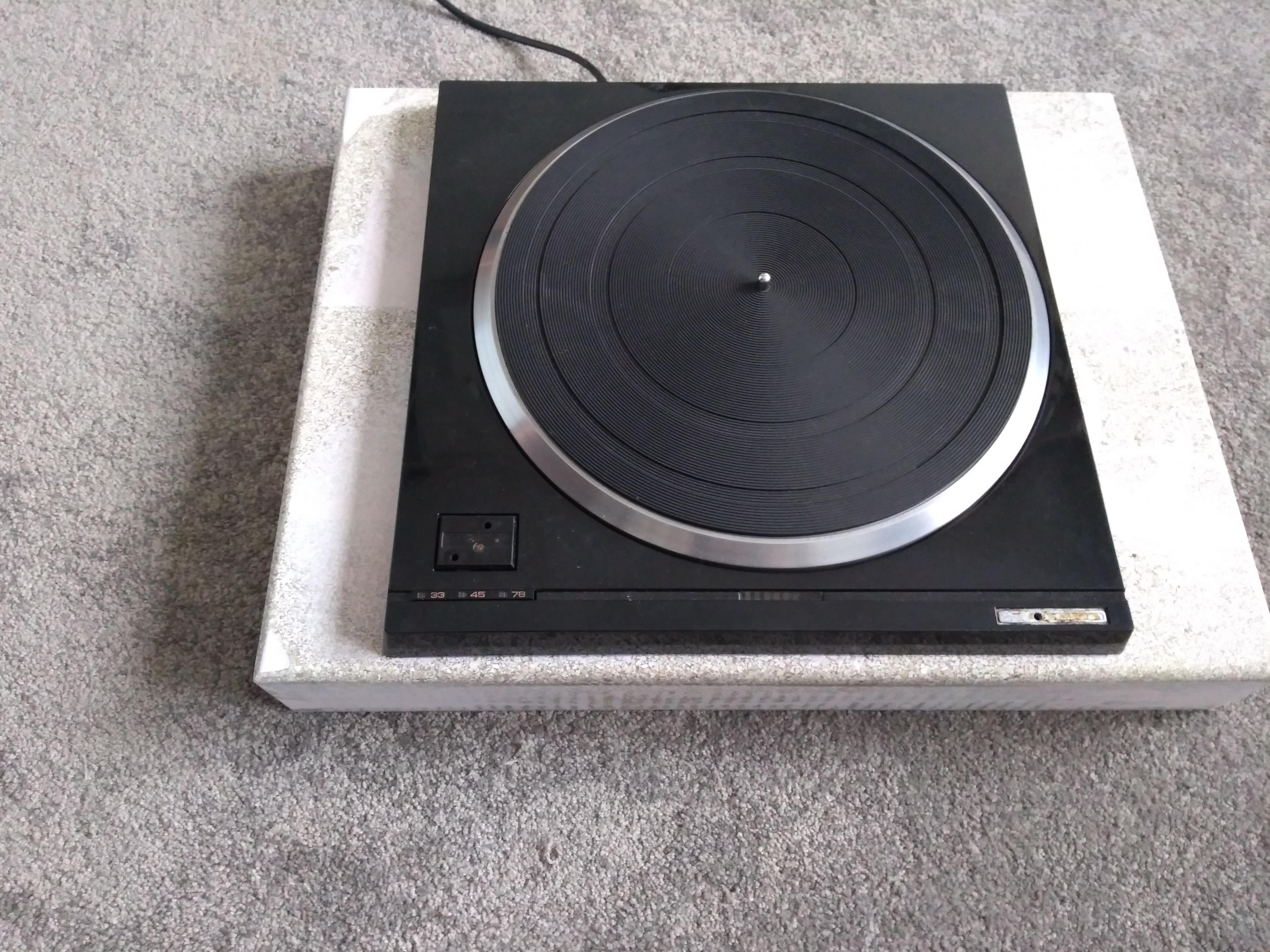

I see. After looking at his photo again, I realized that the table sits inside of the opening of the bottom plinth. So, I think it should be ok.

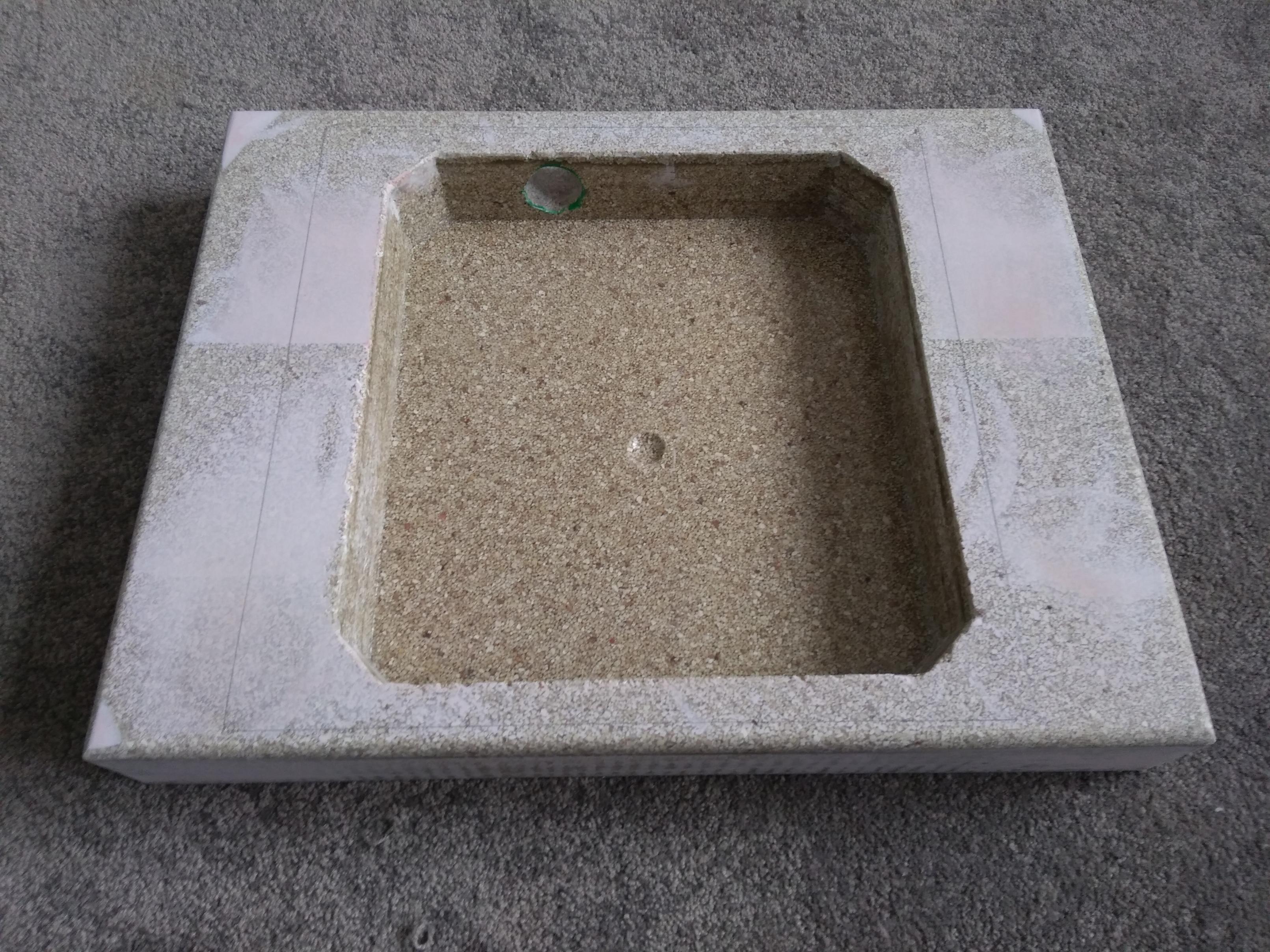

The SP10 is a motor only with no facility for mounting a tonearm and no suspension. The plinth this will be mounted in is 500x400x80mm resin/bentonite and very rigid and about 15kg. My suspension is between the TT plinth and the rack.

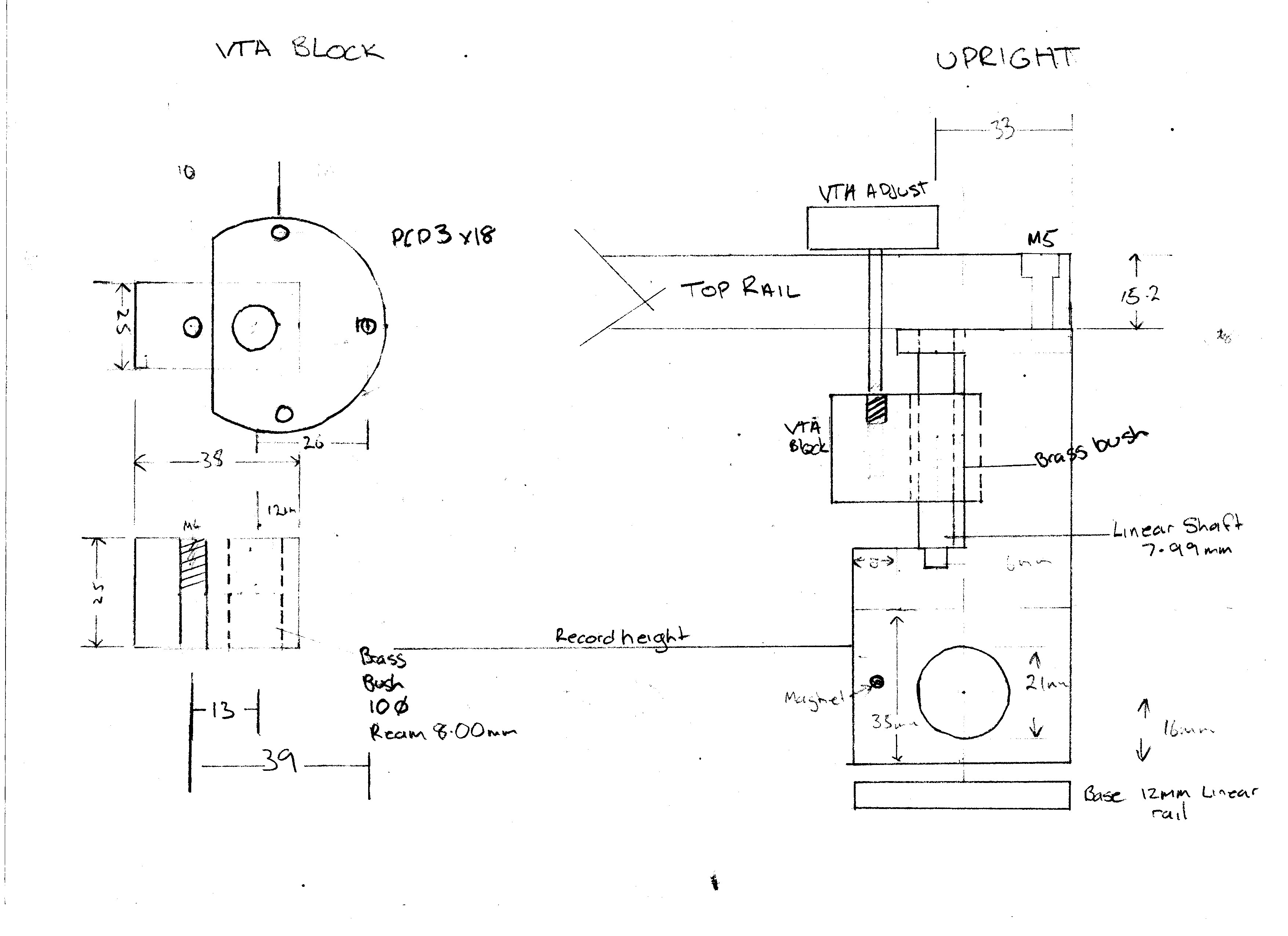

Jim what did you make the arm rail mounting from? I like the way you have done this. The arm rail hangs lower from the mounting.
I notice you have used linear bearings for the vertical movement. I thought about doing this but instead decided to use a hard brass bush. Locking the vertical movement will be via a set screw from the rear of the upright.

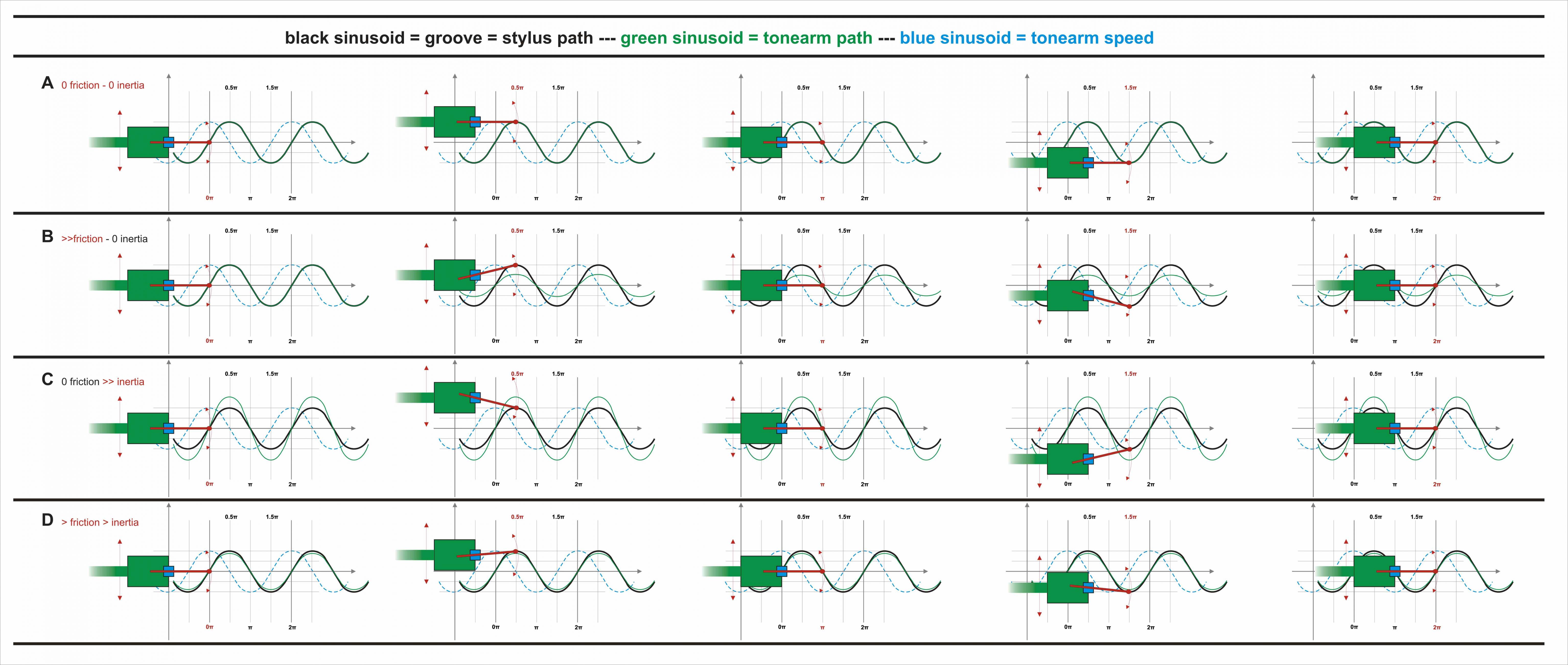

the graphs tries to imagine the movements of the tonearm (cartridge + shaft + carriage + CW) with respect to the stylus. For simplicity the eccentric motion is represented as an infinite linear sinusoid.
Some extreme conditions are assumed
A - zero friction - zero inertia - the carriage faithfully follows the movements of the stylus = 0 bending in each position.
B - some friction - zero inertia - the carriage follows the movements of the stylus with some delay = maximum bending at the turning point, zero in the center - The movement of the carriage is less wide than that of the stylus because the friction brakes the carriage
C - zero friction - some inertia - the carriage follows the movements of the stylus with less delay = maximum bending at the turning point, zero in the center - The movement of the carriage is wider than that of the stylus because the inertia continues to push the carriage even after the turning point
D - some friction - some inertia - the carriage follows the stylus movements with small delay, but continues when the stylus slows down = minimum bending in any situation - The movement of the carriage follows better that of the stylus because the inertia exceeds the friction when the side force tends to zero.
Certainly complex and variable movement which perhaps describes the one hypothesized by Niffy in the last paragraph. Tied to the amount of friction vs inertia

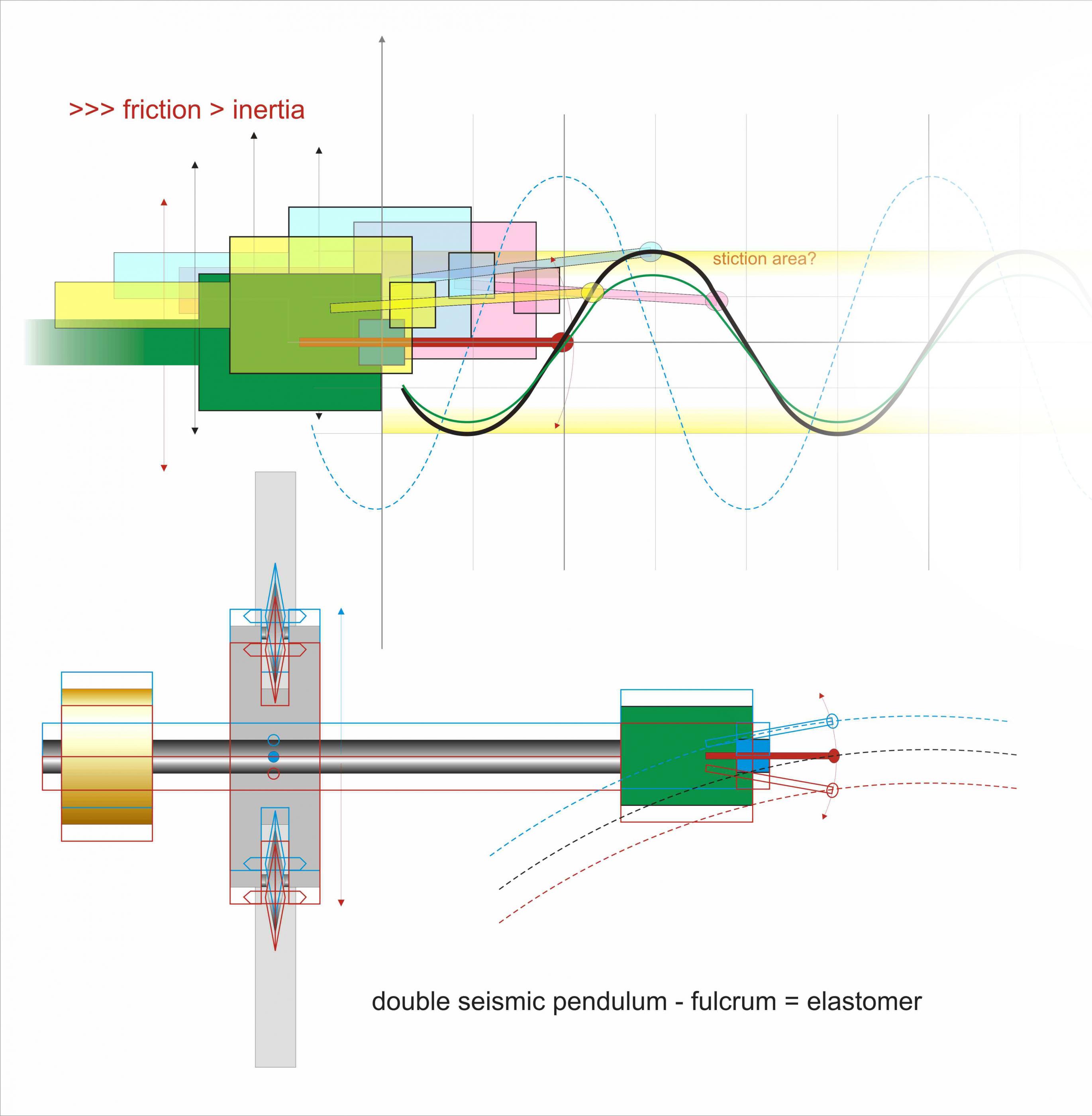

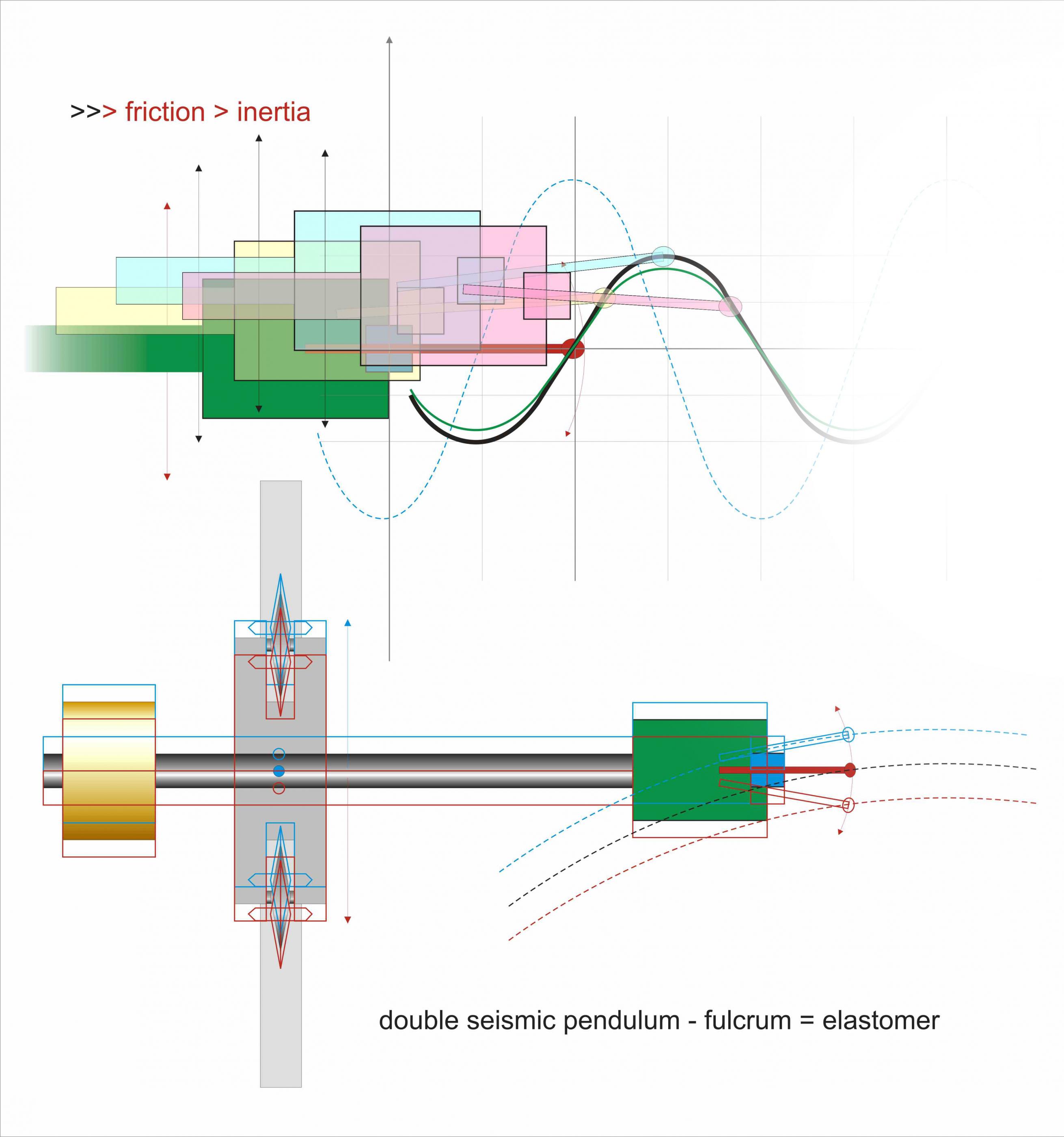

attachment 2
the graph tries to analyze the TA movement in the critical area of ​​the turning point. The speed of the stylus tends to zero and then accelerates in the opposite direction; inertia instead reaches maximum positive to become instantly maximum negative.
Seen from the front the cantilever seems to have practically stopped for some time, trying to reach the side force needed to push the carriage on the opposite side.
It is perhaps like a double pendulum: the stylus rotates on the elastomer and this transmits the side force to the mass of the tonearm induced to go back and forth. Very complex to analyze
Stiction: maybe with jewel bearing, the sliding contact area is so small that a minimum rotation is enough to overcome it.
With ball bearings the situation is very different. There are multiple stictions: rail/wheel contact + contact of each sphere on inner and outer ring + cage friction; and certainly they do not act simultaneously: this perhaps explains the "lurching" effect that we both have noticed

Hi Carlo,
Excellent summary of situation.
One minor point. When there is some friction the bending will not be zero at the centre as dynamic friction is still present at this point. Dynamic friction will oppose the motion of the arm, acting to the right the entire time the carriage is moving to the left. If we add in stiction it gets a bit more complicated.
Niffy
dynamic friction - of course, as well as other details that I deliberately neglected: I was interested in breaking down the influence of the various components of the phenomenon .
We should focus on the turning point area, where "strange things" happen. For example I wonder: the inertia to brake is somehow added to that to start again?

I made a hardwood frame to extend the top platform of my SME 20. The frame is low. I wish I could use aluminum but I don't have the capacity to do so. The rails for horizontal movements are mounted on the hardwood frame. I use lead screws to adjust VTA. The pitch of lead screws is 2 mm. I can adjust vertical movements at .001 in. I am afraid that set screws may not be easy to use and high recommend to use lead screws. I have done three versions of this arm. It is really a pleasure to use it now.

I originally considered using a lead screw but the upright does not have enough room to use a lock nut easily. So I decided to use a linear shaft with a bush. The drawing does not show the VTA lock screw but there will be 1 each side coming out the back of the upright so locking is easy with a thumb screw.
I like how you mounted the rail support to the VTA adjuster, my way was a lot more complicated so I will steal your idea.

Hi Jim,
Hi Warrjon,
I see what you did. It is nice.

Thanks a lot for your input, it's really appreciated. I guess I will rethink this project again to come up with a similar solution to what you have made.
No need to go the extra mile just to come up with the same solution later on. 🙂
Back to the drawing board again 😎

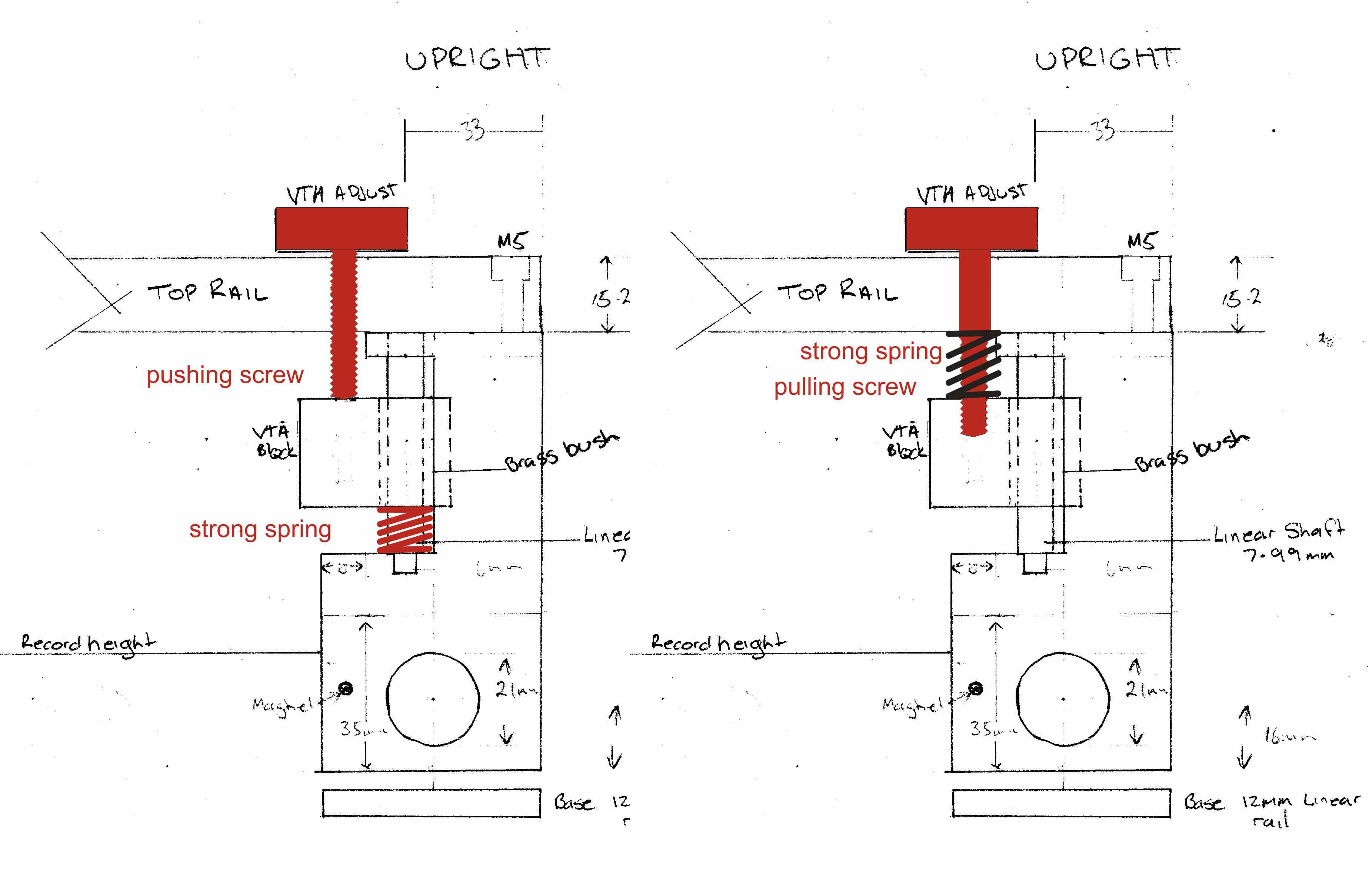

Hi Warren, a little mod could help to avoid any possible chattering - two counteracting actions: the ideal would be two screws one against the other, but a strong spring (inside some silicon glue) may work.
The same for linear bearings at the base: plastic Igus maybe better than linear ball bearings, imho
