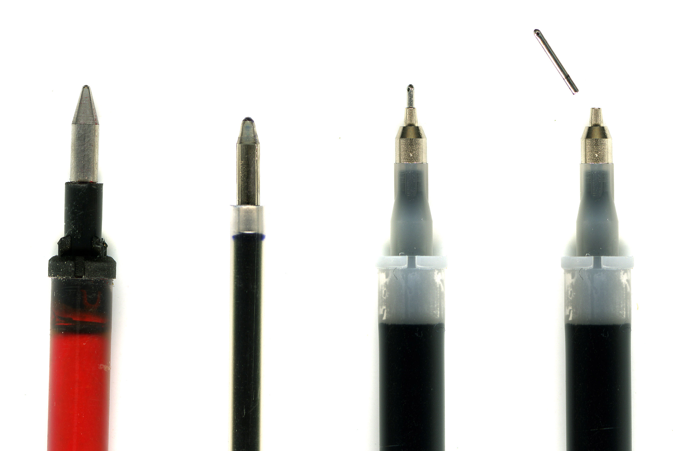

Making the Lil Casey mk2 with the parallelogram on pentips I have examined several. The Pilot G-Tec C4 seem to be made with a rough tech instead of the classic sophisticated machining: a micro tube with three spherical punchings as support for the sphere. But just look at the support sleeve*, turned with an incredible finish, to understand that the reason is simply to get much lower frictions, not to spare. The Pilot pens write much faster, and it's not just due their fluid ink.
Given the big stresses that can be generated on the parallelogram during the the arm handling, I couldn't use them due the weakness** of the micro tube, but for usual LT carriages some tests could be useful, since the cup becomes just a support, not a sliding surface
Fine line carbide sphere is 0.4 mm, the smallest around - a 12 refills box sells for 20 euro
carlo
* the micro tube (6,1 x 0,6 Ø mm) is easily detachable from the sleeve (pulling with small tweezers)
** relative: difficut to bend it while writing. or sketching

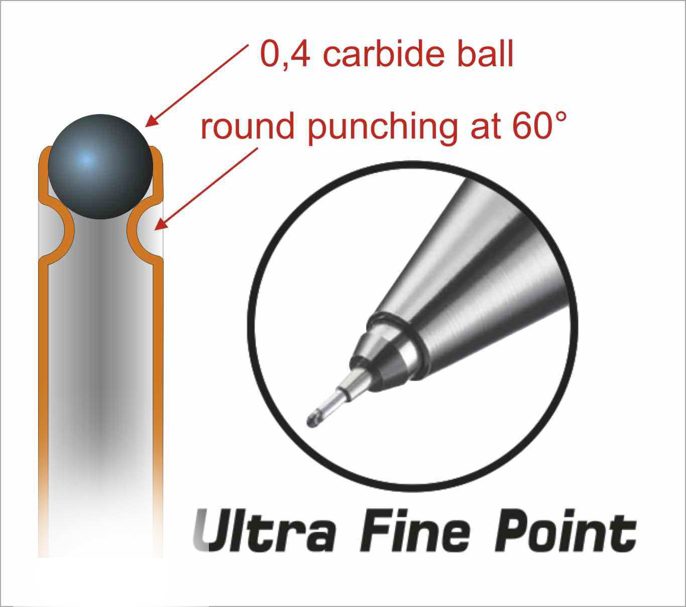

Found on web this description in good english (sorry for mine)
The G-Tec-C4 also goes by the name Hi-Tec-C in certain other markets - same pen, same ink.
The production of a 0.4mm ball point tip has been achieved using the 3-dimples supporting system technology. In this system, the 0.4mm carbide alloy ball is mounted by making three depressions in the tip of a fine stainless steel pipe, in contrast to the traditional system of hollowing out the metal tip. Since the ball will be supported on 'points' the reduction in wear surface allows smoother rotation. The resulting stroke width is just 0.2mm.

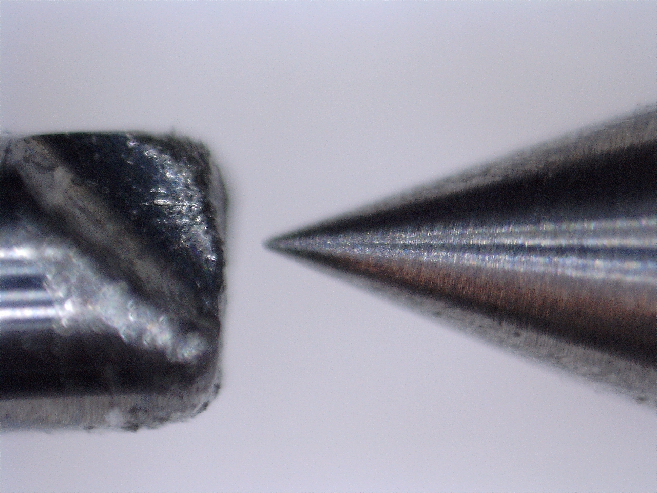

Next trial 🙂 Radius at ~0,03mm after switch to a finer grinding cup, no additional work done.
I belive the drill/dremel "prof of concept" is good enough 😎 So I have
ordered a couple of 2,5mm tungsten rods to make my own pivots. The drills I
have been grinding are only tungsten on one side and i rather fit just one
instead of two pivots to the "bearing wheel". I have decided to go for Niffys
"one ring/two rod" concept as well as I belive it has less possible fault percentage.

There is some confusion around: often the number refers to the line they can produce. 0,4 ball = 0,2 ; 0,7 = 0,4. difficult to find the ball diameter, but 0,4 seems the smaller.
Usual ball pen use mainly 0,7 balls - gel pens 0,5 but inside usual turned bushing.
I've used those Pilots for years at work, sometimes replacing more precise but delicate Rapidographs: if you don't press too much is difficult to bend them.
Who knows if they could be a poor man's jewel: they are available worldwide, and cheap too

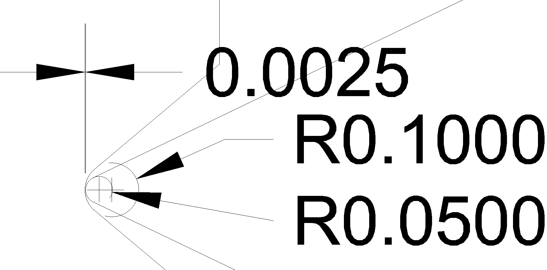

So I belive that I have missunderstood a statement regarding horisontally
mounted vee bearings 😱 This should be fairly correct I guess though. The
0,0025mm distance is not an exact number but it illustrates the necessary "end
shake". Correct ? 😎

Hi Dahlberg,
Spot on on the end shake.
I still reckon that the dimensions you've chosen are too small. If you keep the cup radius the same and increase the pivot radius to 0.075mm you will more than halve the contact pressure. This does give a ratio of only 3:2 which is smaller than the recommended 2:1 to 3:1 range. Making the ratio in the recommended range will give optimum friction to load. In order to obtain the best friction to load relationship you would need to make both the pivot and the cup larger. If you are building your own bearing components then you can make them to an optimal size. I made my steel pivots with a tip radius of 0.125mm and the grub screw vees with a cup radius of 0.25mm giving a ratio of 2:1. An additional advantage of the larger size is that they are easier to make. I ran these for probably 6 months before I finally upgraded to the jeweled bearing system. They showed no signs of wear or damage and were used with a carriage weighing 55g Inc cartridge.
If you use the sizes as shown in your diagram you will actually need to reduce the maximum weight of the carriage to only 10g if you want to keep the contact pressure and shear stress to the same level as I had.

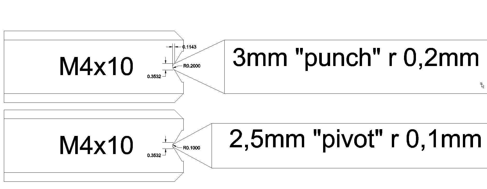

Using regular m4 stainless screws and at first grind them flat and drill a 2mm
hole in the centre. Manufacture a "punch" with the desired radius and I guess a
centering tool for the process to come. When this is done slam the punch with
an appropriated hammer 😀 to make a dent in the screw. The dent isnt that
deep or has a large diameter. The drawing says 0,35x0,1mm and that should be
possible since a 0,2mm radius is pretty sharp. For polishing I'm not sure but
some diamond paste in the hole and use the punch to grind it maybe 😕
Just rotating the punch would help I think.
I'm thinking to make the "punch" from a 1mm tungsten drill.

Hi Dahlberg,
I would not recommend making the punch out of a 1mm tungsten drill bit. If you hit it with enough force to indent the grub screw it will shatter. I used the shank from a 6mm cobalt drill bit. This will be much tougher, easier to work to the correct shape and much easier to hold whist you wack it with a hammer. Your drawing show quite an acute angle at the end of the punch. This angle should be 90°. Try and get the most accurate shape and best possible finish to the end of the punch. This shape will be imprinted into the end of the grub screw. Polishing is not intended to modify this shape, only its surface finish. The use of a soft applicator to apply the polishing paste is preferable (and much easier, I used a sharpened matchstick in a dremel).
The drilled pit in the end of the grub screw doesn't need to be as big as you have made it. I just broke the surface with a small centre drill bit making a pit just big enough to locate the punch. The vee is created by the punch not the drilling.
The use of a finer pitch thread for the grub screw will make adjusting the end shake much easier. I used 0.5mm pitch M3 grub screws. 0.35mm fine pitch M3 would be even better (if you can source them and find the correct tap for making the mountings).
I used stainless grub screws. Tensile steel grub screws (the black ones) could probably be used. The steel these are made from is harder so should work well. This grade of steel will rust so they will need to be used greased. I found that my steel vee bearings actually worked slightly better with a little bit of petroleum jelly applied.
