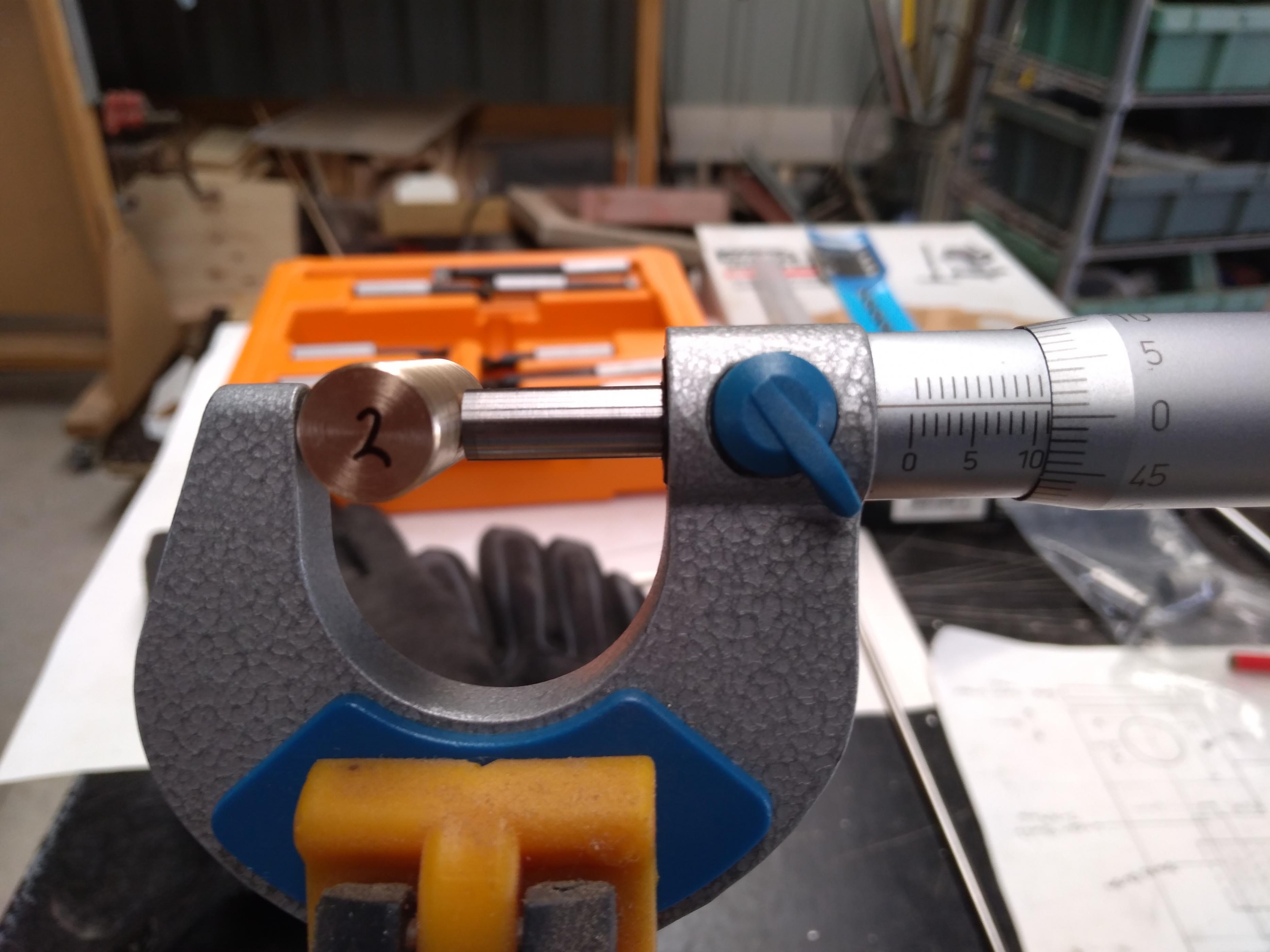

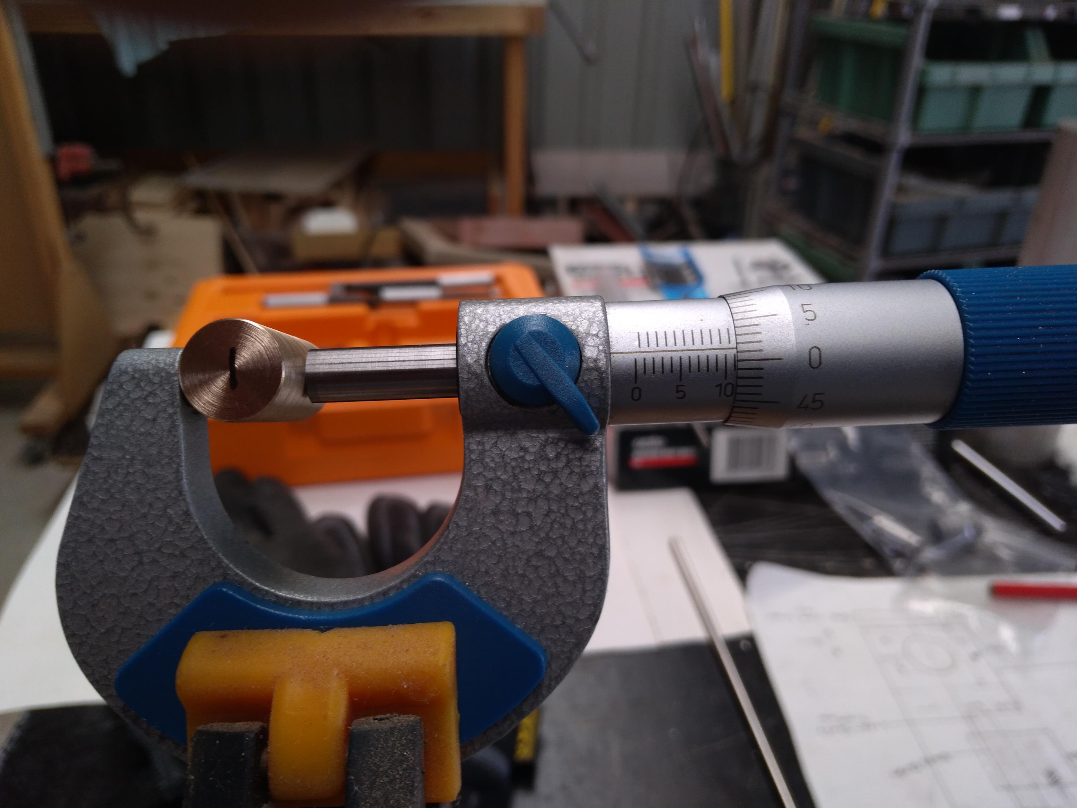

OK I'll bite.
These are photos of the brass inserts for the VTA blocks 11.011 and 11.015 - 4 microns between the bushes, machined on the lathe from12mm brass rod. Block bore was 10.970 for a 40 micron interference fit. To get tighter tolerance you need to polish with emery.

Warren, again all the compliments from one who knows how much skill and effort cost those results: not just due a very good lathe, as popularly thought, but having it set up and used up to those tolerances. We had to learn hardly the meaning of that numbers: i.e. my turntable project was never ended, without a suitable spindle (vibration pattern).

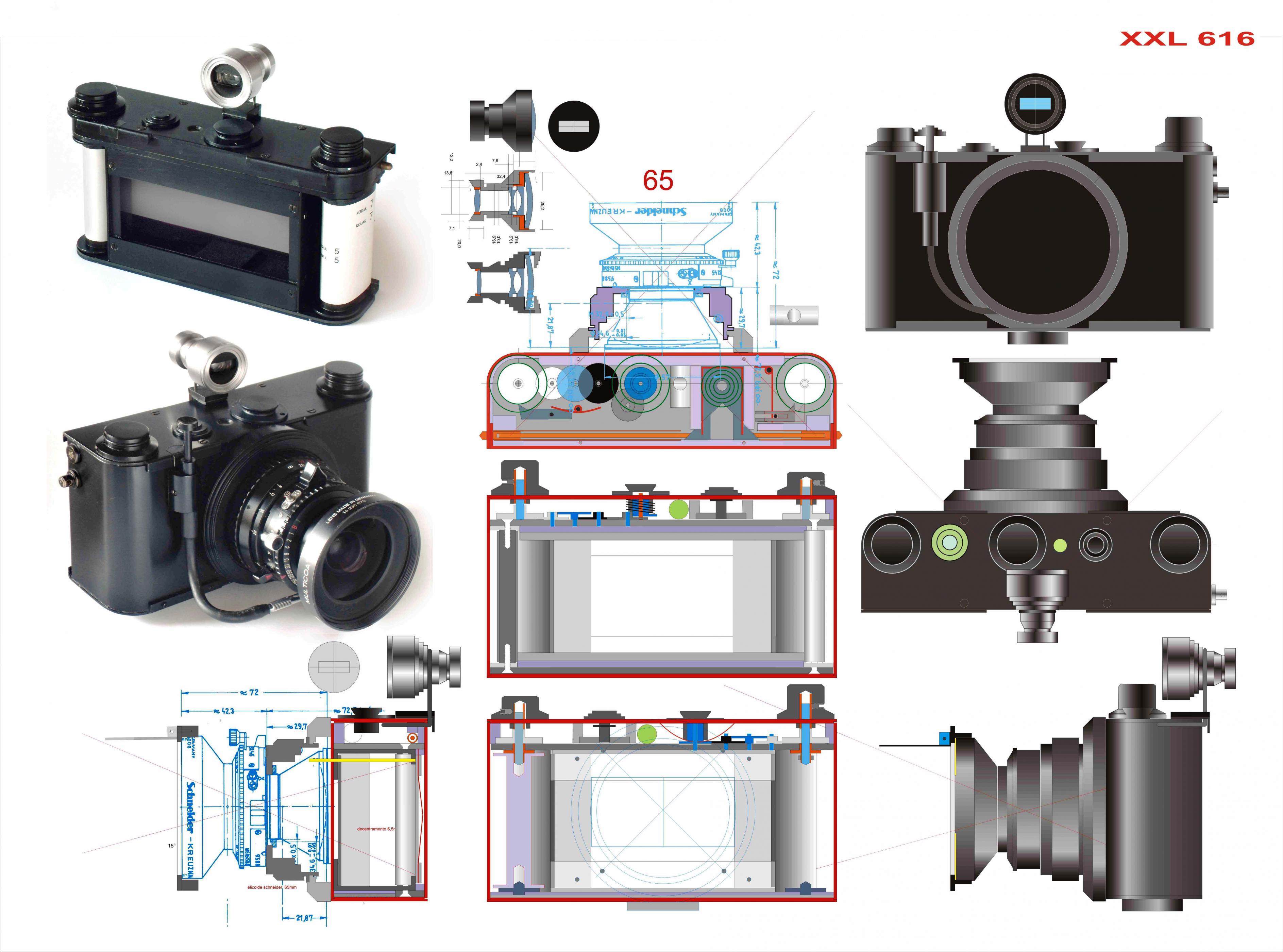

My school, 20 years ago, was this 6x16 panoramic camera (as product photographer I bought the lathe to make special accessories for my Sinars). I had to do it 4 times, but at the end it weighs and measures half of a Linhof 617, and with just 2 cents tolerances on the 55x155mm focal plane (better than hasslblad filmbacks).
carlo

Searching "Linhof 617" on web gives the reason for building that camera (just try to backpack it...).
Everything started with new clients in jewelry production, since large-format lenses demonstrated not enough sharp with so small objects. So I adapted the Hasseblad lenses that, used for macro, covered the 4"x 5" film at best. Then a lot of gadgets - studio photograpphy was a pretty complicated job before photoshop: no minimal flaw allowed.

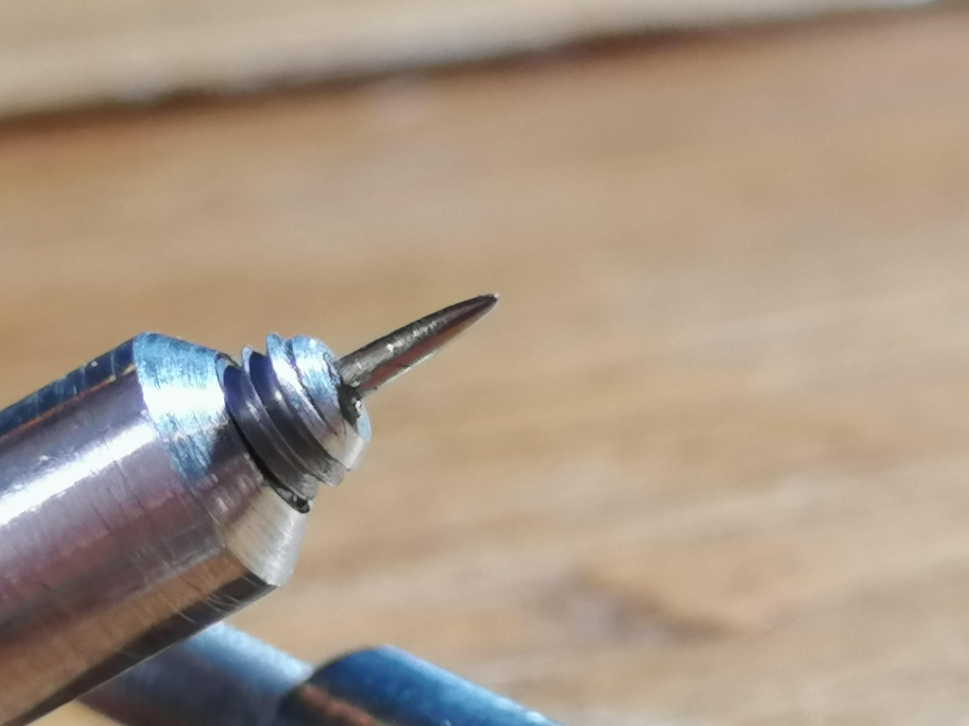

Hi Dahlberg,
You seem to be getting better results with your dremel than I did when I tried to use mine to make my pivots. My dremel wasn't centered anywhere near accurately enough and it's slowest speed was still way too high.
I ended up using sewing pins as they were already shaped most of the way to what was needed and are made of hardened steel. I rounded the tip by fitting the pin in a hand held pin vice, having cut the head off, and using a sheet of 1200 grit wet and dry paper. I started with the pin lying almost horizontally against the paper then dragged the tip across the paper whilst standing the pin up and rotating the vice between my fingers. I did this whilst applying only the lightest of pressure and rotating the vice between strokes. I also constantly checked both the size and shape of the tip by comparing it to the end of a 0.25mm drill bit.
To polish the tip I first used a polishing pad soaked in Tcut in the dremel and again used the pin vice to constantly change the angle of contact. Final polishing was achieved using diamond paste on a leather pad.
This method proved to be rather easy and effective and made very spherical tips.

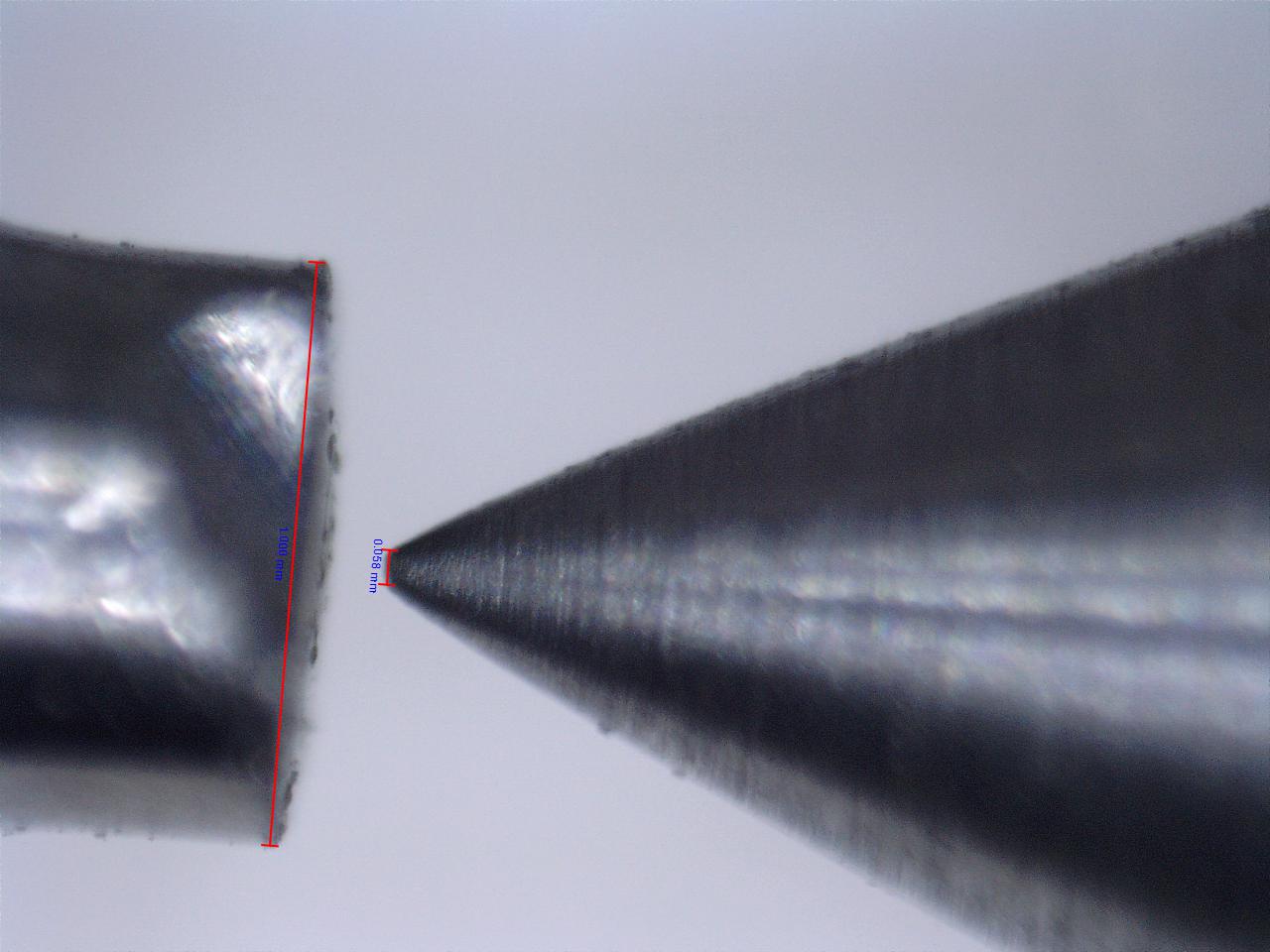

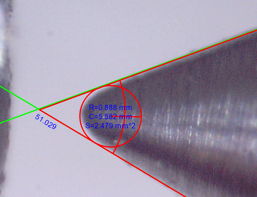

So finally back from work 🙂
I found out that it worked a lot better if I put the breaks on the dremel with my
index finger having it almost still when it entered and left the honing sharpener.
I also adjusted speed some during honing. I started of by hand grinding away
the rest of the broken 1mm drill so that I was fairly close to start with. The drills
seem to have really good tolerances to start with so that helps. Not sure about
the dremel bearings but I had some problem with a collet (not the dremel
original I think) that was solved using another one.
The software for the microscope is "Celestron micro capture pro", not sure if
the microscope itself is genuine though (it might be).
