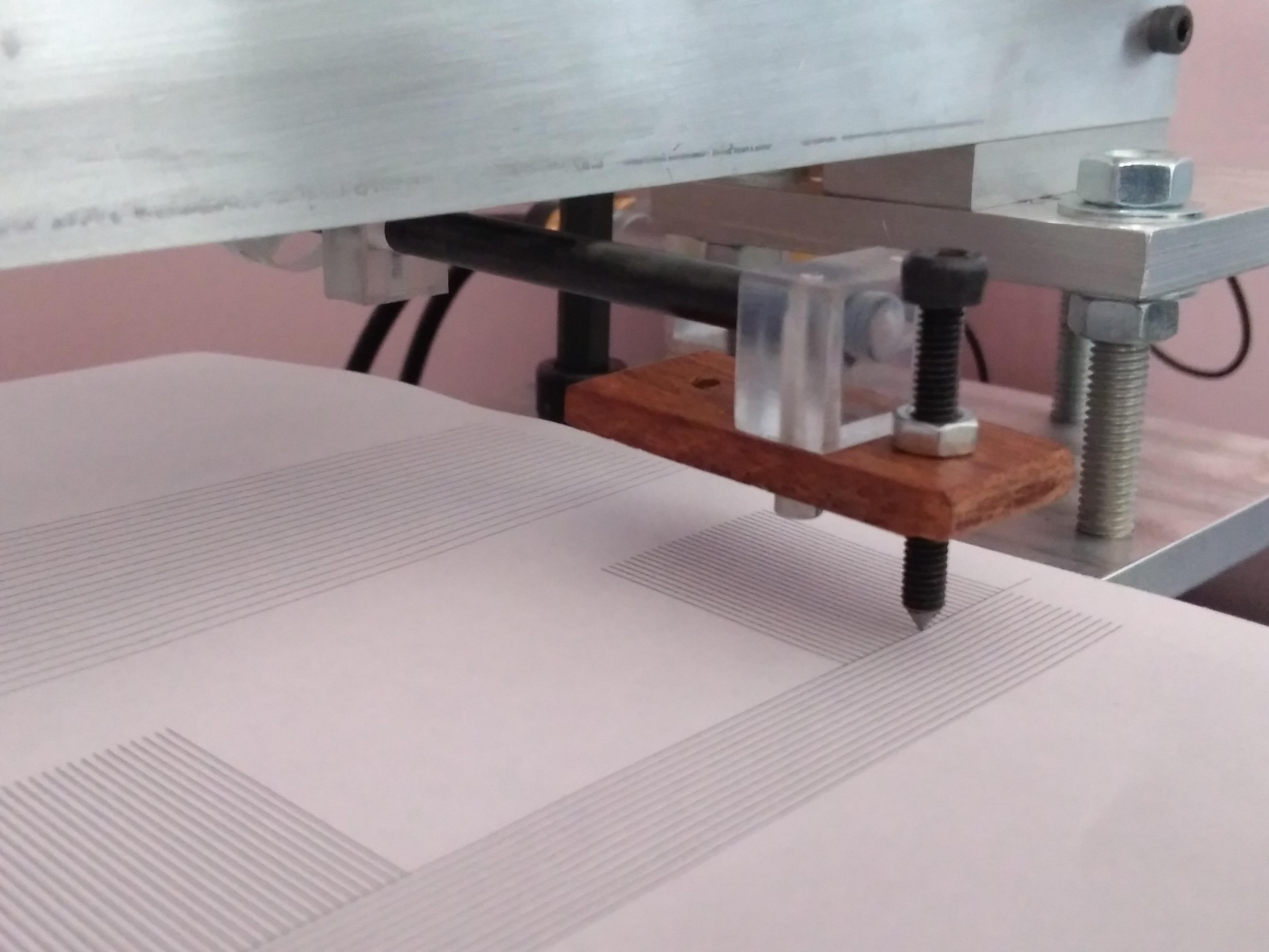

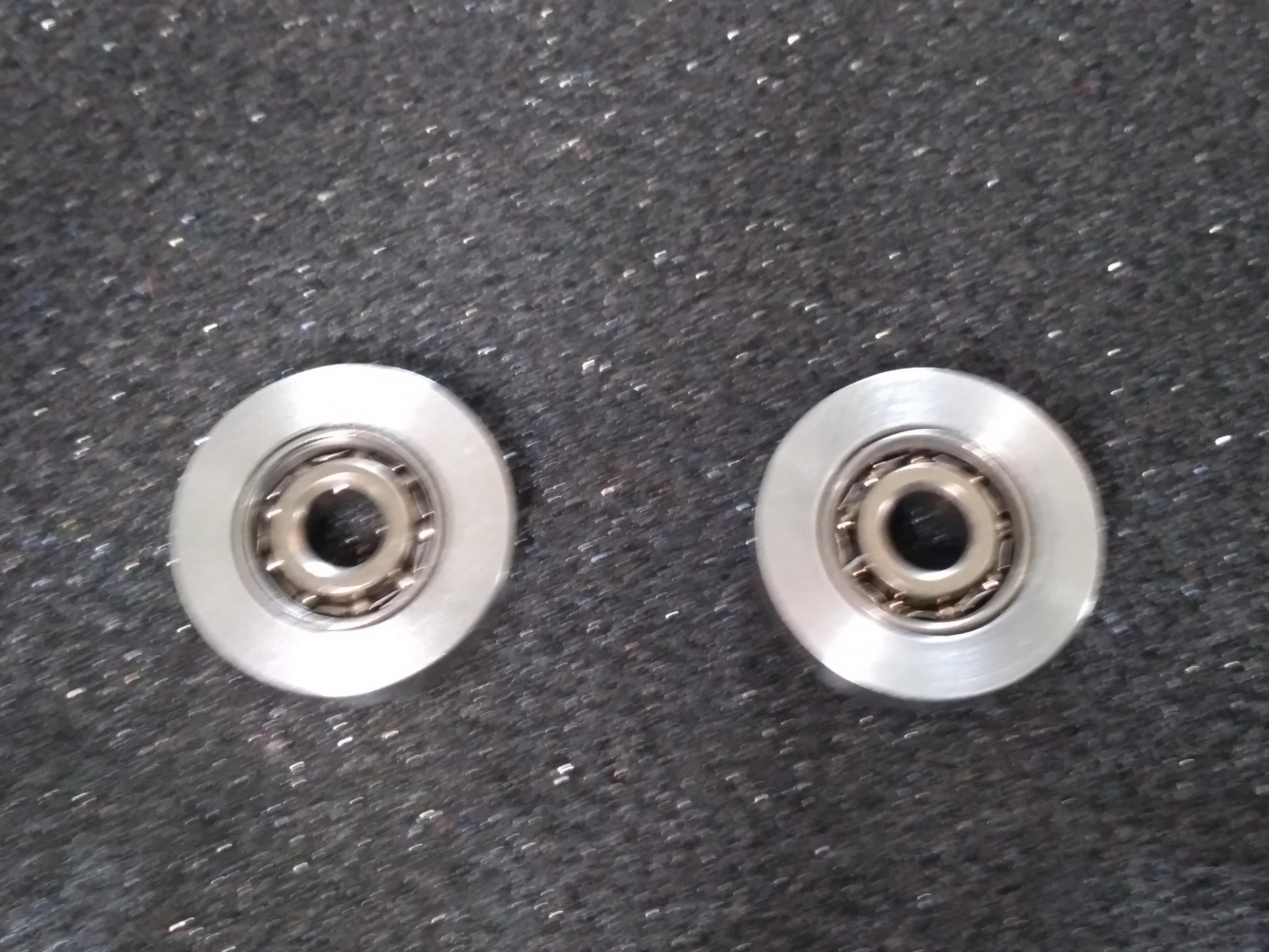

I made these today from 316 stainless bar. The wheels are 16mm in diameter and 4mm wide. They did make a difference, the XSV now tracks without miss tracking but the cantilever is still moving back and forth not the tonearm.
The other device is my alignment jig. The XSV stylus is impossible to see when aligning this makes it easy.
Before the wheel upgrade. You can see the arm jumping to the left.

Got it working with the Pickering.
I increased the radius on the edge of the wheels and polished them down to 1000grit. Then added the brush.
It tracks much better now. I did a back to back with the Technics EPA-100 with the same stylus in 2 different cartridges, these cartridges are so close channel balance is withing 0.1dB. WOW the difference is not subtle, the linear arm murdered the EPA-100 in both detail and bass punch.

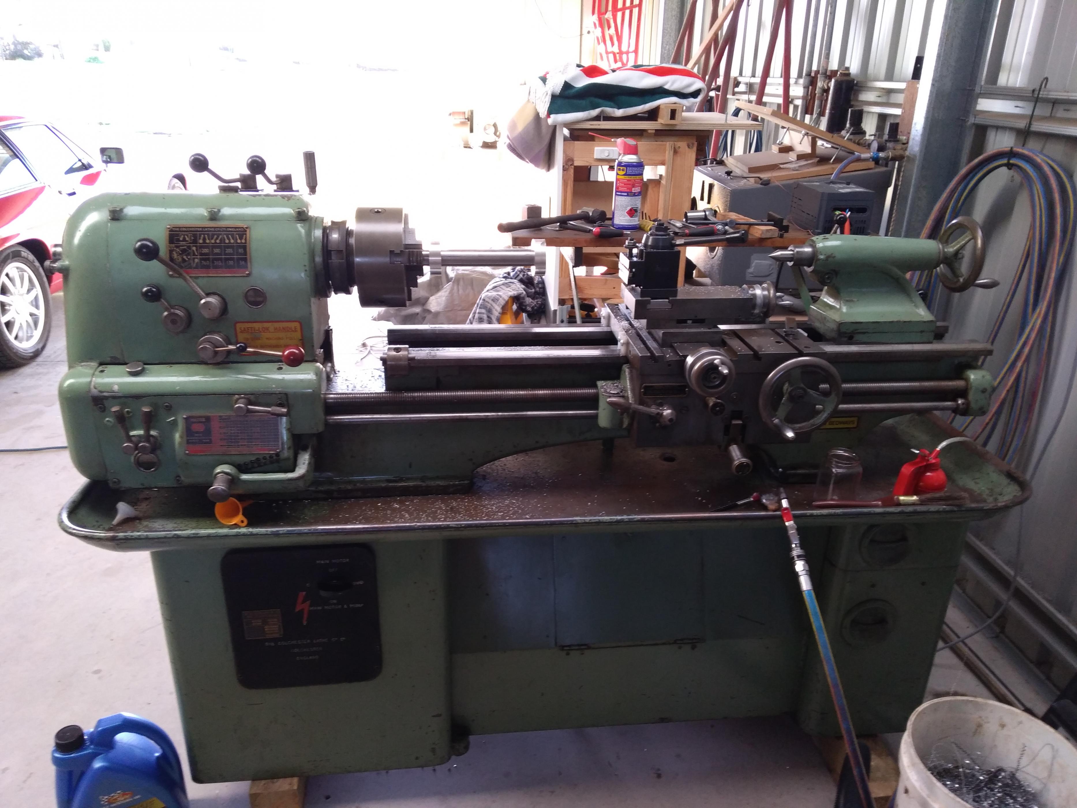

I use carbide insert tooling mostly. HSS is used for aluminium as it's sharper than carbide.
Good old fashioned Pommy lathe. Great tool.
Stainless work hardens so need to keep it cool. I don't use flood coolant as the pump in my lathe is shot I use coolant in a spray bottle

Hi Warrjon,
Great news about getting your arm singing.
With both the wheels and rails of my arm I polished the surfaces with diamond paste, gradually working my way down to 0.5um. This gives a much smoother finish than you will get from 1000grit paper and has a quite noticeable effect on the rolling resistance of the bearings. When you get the tungsten carbide rods and rings I would definitely recommend spending a bit of time polishing to the highest finish you can.

Hi Niffy,
I have ordered diamond lapping paste in 7 grits to 0.25um. I am going to make another set of wheels and polish them further. Dam the carbide rods turned up and they sent 100mm instead of 200mm, oh well waiting again.
This is a seriously good arm now, can't wait to hear the next iteration.

Knowing so little, I tend to believe in simplistic explanations: but won't it be that, more than for the Hertzian stress, the advantage of larger wheels is mainly to provide a greater torque to overcome the friction of the ball bearings? more or less the principle that led to discover the pin bearings...

Beautiful, rock solid lathe, Warrjon, especially compared with my poor chinese 9x20.
