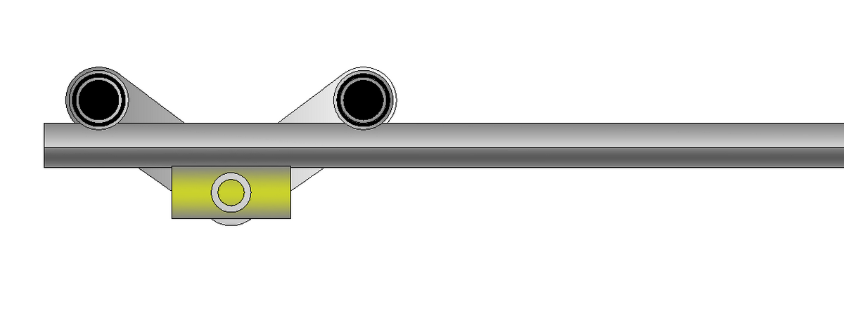

Hi Carlo,
In your last post you said "The only thing that still does not convince me is the vertical articulation on the two bars".
The obvious choice would have been to use a knife edge rail and wheels with a V groove. As long as the edge of the knife is not so sharp as to cause the contact pressure to exceed the strength of the materials used the lateral friction should be very similar to that of my current rail system. The vertical friction would be reduced to almost nothing. It would seem sensible to aim for the lowest possible vertical friction but there is a problem with this approach.
As a record is being played the arm will want to bounce at the resonant frequency of the compliance/effective mass tuning, normally around 10hz. This is true of all types of arm be they linear or pivoted. The arm will naturally want to bounce in line with the main restorative force which in the case of our arms is gravity. This means that the arm tendency is to bounce vertically. This is made worse by the fact that warps can occur within an octave of the vertical tuning frequency and can excite this tendency. Eccentricity occurs 3-4 octaves below the lateral tuning frequency so don't tend to excite the arm to anywhere near the same degree.
Even though the bouncing is occurring outside of audio band it still has negative sonic effects most noticeably in speed stability due to stylus scrubbing. In order to control this bouncing the arm needs to be damped. More damping is required in the vertical plane.
With my arm the damping is applied by the friction in the bearings. With the knife edge you have very little friction vertically so very little damping vertically. You could apply the vertical damping by adding a silicone fluid damping trough. This type of damping system will also add lateral damping. The lateral friction of the bearing hasn't been reduced by using a knife edge so neither has its level of damping. By adding a silicone damping trough you will end up overdamping the arm laterally.
By using the rail and wheel profiles that I have chosen I have greater friction and therefore damping in the vertical plane. I think that I probably have the optimum level of damping with my current design. It is possible that using 3mm rods and 1.5mm wide wheels might be a bit better. These would reduce vertical friction by about 25%.
When using steel wheels on glass rods I found that a smaller radius edge to the wheel sounded very slightly better. You can only do so much prototyping so I used the smaller edge radius when I built the tungsten carbide wheels.

Hi Niffy, that feeling was because - for relevant angles - the support on the two bars becomes not symmetrical, apparently tending to slide lower. But I said also that things must be tried before judging: it's one of the few things learned by making various TAs. Hornets do fly, and some mechanical nonsenses of the past sound better than some perfect designs; who knows why.
Maybe I'm still nostalgic for my 3009 (cursed be the day when I swapped), but I still consider the knife-blade the most "musical" bearing. I tried to use it even vertically, on a magnet ...
Personally, I do not use damping, not even on my last unipivot. There is no need when masses and pivot are in the right place, but it took 3 of them built to learn that sometimes "xe péso el tacon del buso" as people say in Venice - the patch is worse than the hole.
Warrion, poltruded carbon fibre isn't always really straight: for the rail of the lil casey I had to roll a dozen tubes on the bench to find an acceptable one: the kite shop assistant was about to call a psychiatrist. HSS for tools is instead well rectified; but you certainly know this better than me

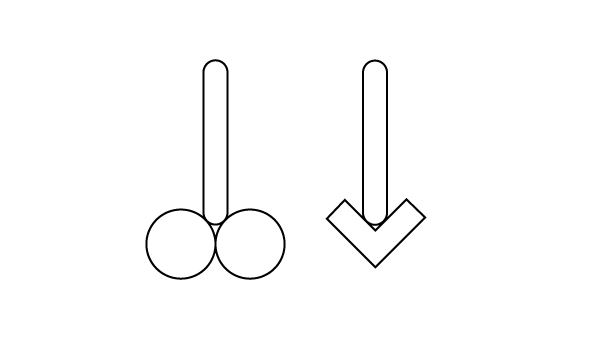

I highly recommend Niffy's style linear arm. However, I personally prefer angle rail. In my opinion, angle rail provides consistent damping in the vertical plane. Round bar rail may not provide same damping as angle rail due to the size of round bars and thickness of the wheels.
Another thing is very important, too. On Niffy's arm, the carriage won't drop off the rail due to a protection mechanism. If you want to copy Niffy's arm, you need to add a protection mechanism, too. Otherwise, it is very dangerous for your cartridge. I made a ball bearing and glass tube linear arm a long time ago. The carriage dropped off the glass rail on a running table. It almost destroyed my $2000 ZYX cartridge. This was why I changed the rail to Clear Audio kind and never want to make glass tube rail again.
