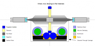

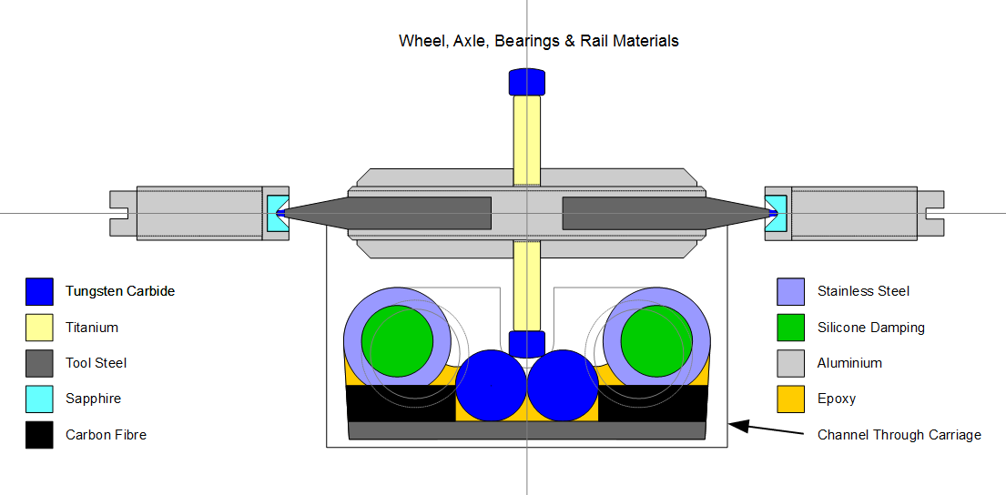

Hi Warrjon,
Both the borosilicate glass and tungsten carbide rods are solid. The rods were built into identical support structures as I wanted to be certain that any differences that I measured or, more importantly, heard was entirely down to the difference in rod material. The rail structure consists of a 1mm thick, 19mm wide base plate of tool steel. Along the edges of this base plate run two unidirectional carbon fibre battons, 2mm thick. The channel formed between the battons is where the rods are fitted. On top of the battons are 6mm diameter, thick wall, stainless steel tubes. These are filled with silicone rubber for additional damping. The rail has 10mm thick aluminium end caps bolted and glued to the base plate.
The rails are held together with epoxy adhesive. Each layer was individually glued, clamped and cured in an oven. The clamps not being removed until the rail had cooled to room temperature. This was to prevent warps. Heat curing epoxy massively improves its properties.
The rails are mounted with two M6 bolts at each end. Mounting the rail from both ends makes the whole structure much more rigid.
The rails are very inert and very rigid and just make a dull dump if struck. Dead. Of course the tungsten carbide rail is much heavier.
I don't think the rails will bend enough to be noticeable simply due to the mass of the carriage. It may seem crazy but the difference in rolling resistance is due to the material of the rail deforming under the wheels more with the glass rail. I performed many tests (I made 6 different rails and used many different bearings and wheels) and the results were all consistent with this being the case.

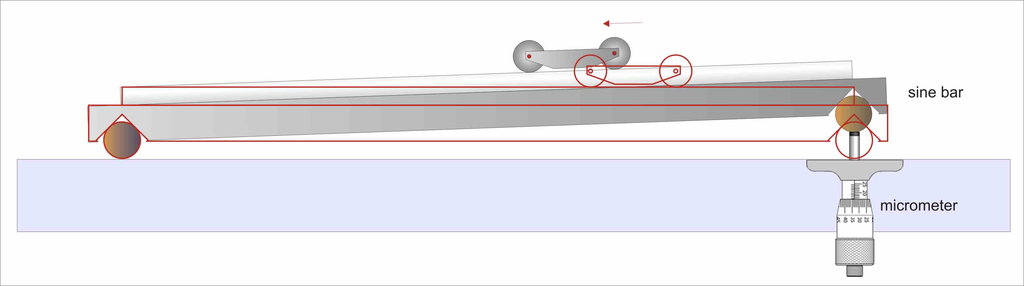

An idea for another measuring system for the carriage friction of an LT. The reverse pendulum works well, but the friction of the string introduces a certain variability, so an average of several measurements must be made.
Rail and carriage are secured to a sine bar (even diy) to measure the critical angle (movement start) with a depth micrometer ...
what do you think about?*
carlo
*this method doesn't consider the shaft lever

Hi Carlo,
The sine bar is an excellent method of measuring friction. When I made my reverse pendulum measuring jig I made it with 3 adjustable feet so that the rail could be leveled. When I initially set up the jig I experimented with tilting the rail to determine friction. It gave pretty much the same results as the pendulum but was much more difficult to make repeated, accurate readings. If I had designed it to use the slope to determine friction in the first place it would probably have been much easier to use. The sine bar could also be used to determine dynamic friction. You tilt the bar until the carriage just keeps moving after being nudged.
