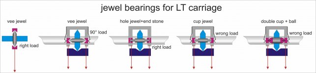

I keep getting a bugging thought about the vee jewel bearings.I read the article about miniature ball races in clocks(few pages back) and understand that a tiny vee point will have less friction than the best ball race.
But as I come from experience with watch repairing I cant understand why watches never use vee jewels for their balances.instead they have very slim pivots and use combined pierced jewel and a flat endstone.It results in the pivot being quite fragile hence why shockproof jewels were invented.
Im worried that a vee jewel with any slack at all will shake,and without slack will be tight.
maybe in the real world they work fine?

Fine adjustment of vee bearings is essential for optimal performance. You actually want a very small amount of clearance, I have somewhere in the region of 5um. Ironically, from the wording of your concern, this clearance is called end-shake. The load in our application is at 90° to the axis of the pivot so the contact points will always be under load. The spherical tip of the pivot still rests within the spherical portion of the vee. The contact point between the pivot and vee is very small. I did work it out for my arm but can't remember the exact size. We're talking a couple of microns in diameter. The contact pressure is immense, mega-pascals. There is nothing in the dynamic behaviour of the arm that is going to be able to cause the pivot to shake or vibrate against the vee.
I assume that your concern is with bearing wear. I have been running my arm for 3-4 years with the jeweled bearings and they haven't given me any cause for concern. My carriage, at 55g, is a lot heavier than most of the other carriages shown in this thread so my bearings are probably going to be more heavily loaded than yours. I also ran the stainless steel pin bearings for about 6 months before I moved to the jewels. I could not see any signs of wear or damage on these either.

Chrisinbrighton on #3174 posted an very interesting question.
That jewel bearings are better than any other type for small loads, has been proven since the mid-eighteenth century (the famous Harrison H4 sea watch), with billions of watches produced. I don't know anything about watchmaking **, but maybe the reason why watches don't use vee jewels (the only one I know is the incablock) it's because they have to work in any position. To get very, very low friction a hole jewel + end stone can be not tight on the pivot, because it is enough not to exceed the needed tolerance of his gear.
While our tonearms hate chattering.
The only problem remains that the carriage loads the vee at 90 ° and therefore we need a spring to keep it aligned, certainly increasing somehow the load and friction. (see attachment).
Always less than that of a ball bearing, which however needs greater clearance to run freely and so on: hence all the problems Niffy had clearly described.
carlo
**as a sunday machinist I have just to envy the boundless ability of those who know how to make a pivot with a handheld graver on a watchmaker's lathe, or to work on tolerances i'm even unable to measure
