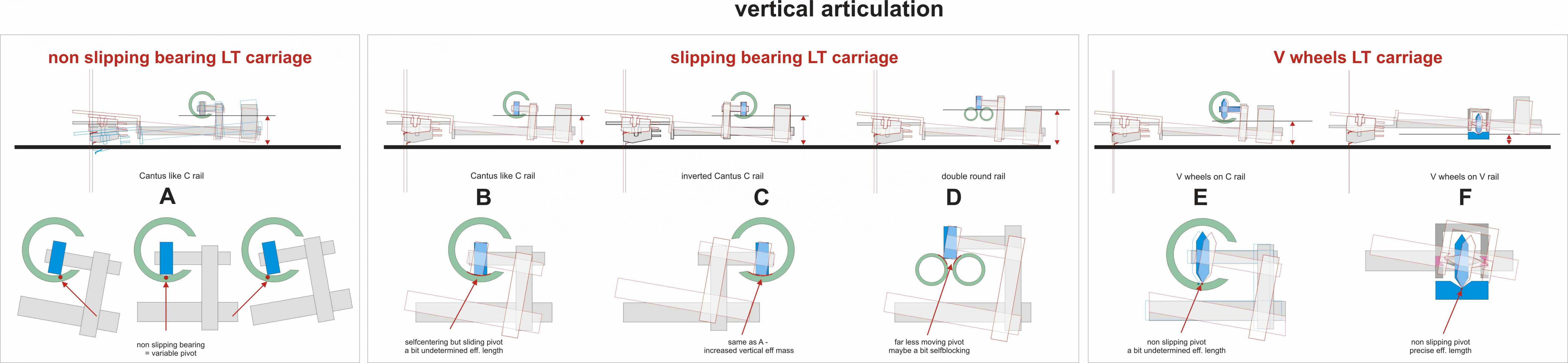

Since you're talking about, for me an opportunity to understand something more about LTs carriages (attachment).
There's always a great research on materials with very high Mohs for the rail-to-bearing coupling. Why? in order to reduce wheels friction? But there is no (or should not be) relative surface motion. Isn't it better for a wheel to rotate, instead of sliding? Or this low friction is necessary to allow the vertical articulation, due some slipping? At first glance the V wheels solutions (like those beautifully created by Niffy) seem to me the only correct. What i'm missing?
Another doubt - some linear trackers exhibit very massive headshells, or even weights above the cartridge, often together with tiny CWs placed very far from the pivot. Why? to increase the vertical mass? usually we look for the opposite.
Thanks in advance - carlo

Hi Carlo,
The reason for using very hard materials for the rails and wheels is not to reduce friction at the contact point. As you correctly point out there should be no relative surface motion. For lateral motion the coefficient of friction is irrelevant. What is important is rolling resistance. Very hard materials will have lower rolling resistance than softer materials. A good analogy, for anyone who has ever ridden a push bike, is the difference in how easy it is to cycle when the tyres are pumped up really hard compared to when the tyres are almost flat. It is much easier to cycle with the hard tyres. Similarly it is much easier to cycle on tarmac than grass. When cycling with hard tyres on tarmac you will have the lowest rolling resistance but the friction between the road and the tyre is still very high.
You might think that the difference in rolling resistance between steel running on borosilicate glass and tungsten carbide on tungsten carbide would be slight as both steel and glass are good and hard anyway. My measurements would indicate that the rolling resistance of steel on glass is 40% greater than for tc on tc. That extra bit of hardness actually makes a lot of difference.
Having a harder contact point also seems to improve mechanical grounding and has a definite positive effect on sound quality.
When it comes to vertical articulation of the arm the situation is a bit different. From your diagrams I assume that you are referring to the use of ball race bearings. With ball race bearings the vertical motion is not accommodated by the bearings sliding on the rails except when the vertical movement is large like when queuing or navigating a particularly severe warp. In normal operation the entire vertical movement is taken up by the play in the bearing. For the case of large warps where the play in the bearing is insufficient the sliding could be beneficial as this friction will act to damp the motion of the arm. With my pin bearing arm I actually use this sliding friction to specifically damp the arm.
Regarding your final doubt. The block type headshell, as used by clearaudio, is going to be more rigid and less prone to resonance than a thin flappy paddle type headshell as used in most arms and in this respect is a very good design choice. However making this type of headshell more massive is not the best way to increase vertical effective mass. It is much better to increase the effective mass by adding the extra mass where it will also increase rigidity, killing two birds with one stone. If you look at the pictures I recently posted of my lightweight carriage you'll see that I have used a block type headshell. You'll also notice that I have reduced its mass as much as possible by making it relatively thin ~5mm and by making it oval. The extra mass I required to get the best effective mass was obtained by making the front section of the armtube thicker walled. The exact effective mass was fine tuned by selecting the correct counterweight mass and distance from the pivot.

Hi Niffy,
thanks for your accurate and effective answers: the example of the racing bike (5-6 Atm!) is particularly convincing for anyone who has ever used one. My doubt is that maybe with ball bearings commonly used for those arms, their inner friction plays a much greater role than the possible difference between normal and sophisticated materials of the rail. Much differently from your jewel bearings + minimal contact point.
The observation on small warps dealt with bearing's tolerances is also surely right, but does not reassure me, because even in this case there will be some pivot shifting to alter the behavior of the stylus (= colored sound). Worse, if this trend exists it will also appear with the instant variations of the stylus drag, like in suspended arms. Maybe with very good bearings the easier situation to happen could be that of (A) case. On a short 70 mm arm, an average 1.5mm warp generates an angle of 1.5°, enough to generate that kind of wobbling.
So, I still believe that your V wheels carriage is the only one that can be seriously used to achieve the vert. articulation.
When possible a solid head shell is certainly beneficial (but things seem more complicated, have you seen Korf's work?), however I have the strange feeling that the trivial reason for those weights is to keep the CW out of the perimeter of the disk, in order to reasonably lower the vertical pivot, together with the CG.

Hi Carlo,
You are quite correct. The overall lateral friction of the bearing is comprised of a combination of the rolling resistance and the friction due to the rotary bearing element. With a ball race bearing the majority of the friction is due to the bearing element. The friction of this element can be reduced by selecting bearings with the hardest components, ceramic or hybrid ceramic for instance. The use of any lubrication will cause the bearing to become 'sticky' which will increase friction.
The rolling resistance can be reduced further by polishing both the rail and the outer race of the bearing.
With the pin bearings I found that the majority of the friction is due to the rolling resistance even when using tungsten carbide wheels on tungsten carbide rails.
One of the major problems with ball race bearings is that their friction is not consistent. Ball race bearings are designed for high speed and high loads. We are using them at extremely low speed and loads. The level of friction varies dramatically depending upon the angle of rotation of the bearing. The bearings actually show bimodal levels of friction with the upper mode being about 50% higher than the main mode. The overall friction actually varies by much more than this. This variation is probably due to whether there is a ball at the bottom of the race or the gap between two balls. The variation in the friction of the play of the bearing, that allows for vertical articulation, varies by even more. About 700% if memory serves me well, again probably due to the position of the the balls. When used at high speed the variation in friction averages out to give smooth operation.
With the bearing system used by the lil casey there is no rotary element to the bearing. It still has two elements, both rolling resistance, one between the lower rail and ball and one between ball and upper rail. As with the other bearing types the overall friction will be mainly determined by the hardness of the rails and balls. The use of larger balls can also help to reduce lateral friction but will likely also increase vertical friction. Unfortunately harder materials, especially tungsten carbide, tend to have high density. A design like the lil casey requires that the rails and balls be as lightweight as possible. A compromise between overall mass and friction has to be made. The bearing system used by the lil casey will have several advantages over ball race bearings. The overall friction should be lower and much more consistent. There will be no bearing chatter. The loose/unloaded balls in a ball race are an uncontrolled source of chatter.

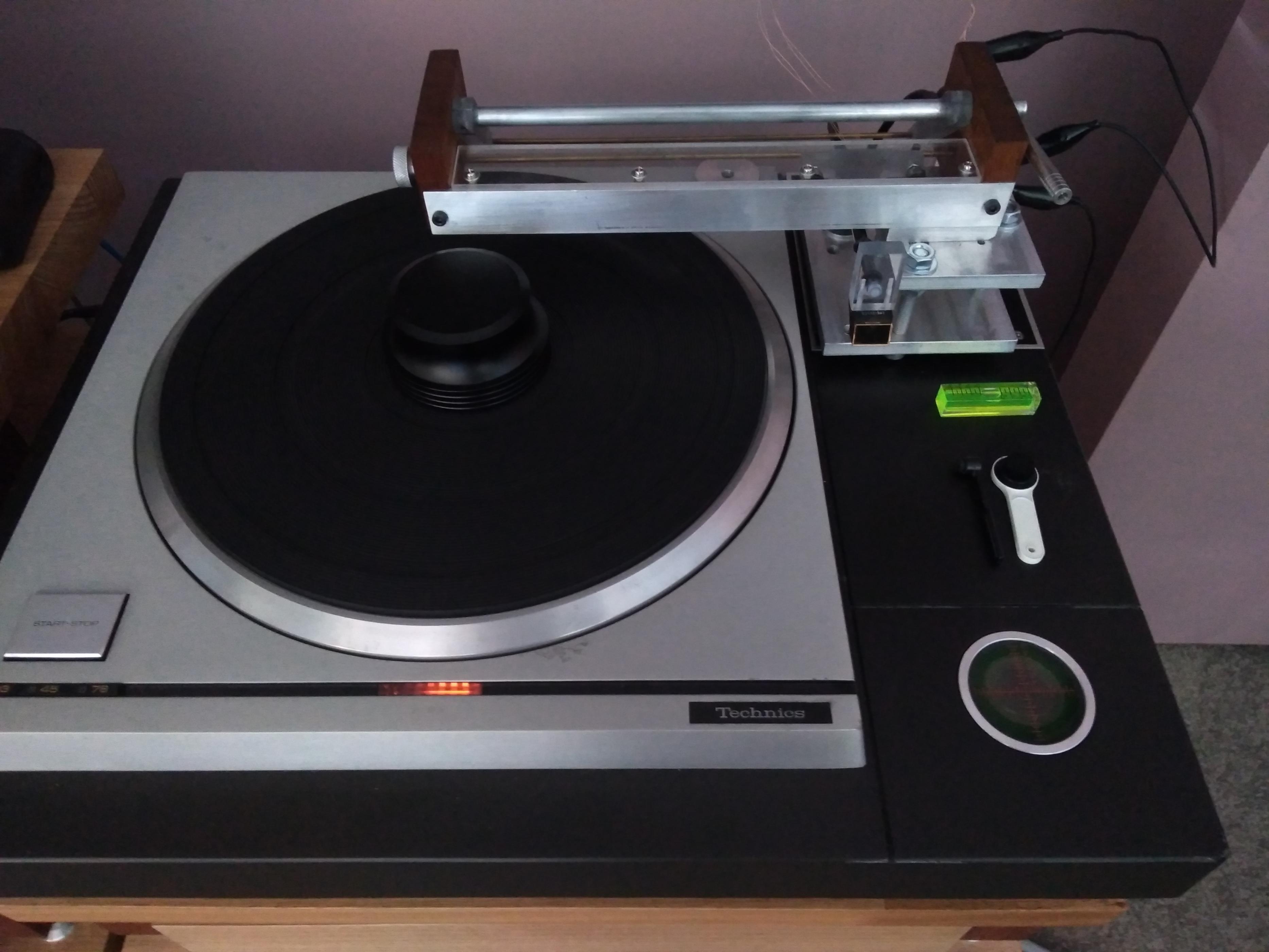

Finally installed the arm and aligned it with a USB microscope. Took a while to get rid of the hum. I ended up having to ground the SP10 chassis to the preamp ground. Now I have the grounding sorted I'll replace the alligator clips with spade connectors.
It sounds pretty good, bass response is better than my EPA100 although I have the EPC205 installed not the Stanton 881.
The only issue I have not sorted is the repeatability in VTF, this varies by 0.2g with multiple measurements.

Hi Warrjon,
Congratulations on getting your arm up and running, looking good.
Good bottom end is one of the defining characteristics of these linear arms. This is due to the high lateral effective mass that helps to control the lateral stability of the arm. Bass frequencies are cut laterally only with no vertical component.
The problem that you have with tracking force consistent is something that we all suffered when using ballrace bearings. This seems to be due largely to the inconsistencies in the bearings that I mentioned recently.
It is important that the surface of the pad of your scales is exactly level with the surface of the record. With most scales the measuring pad is much too high if the scale is set on the platter. . With your design of arm the scales will show a higher tracking force than you will actually get If the pad of the scales is too high.
I found that by repeatedly raising and lowering the stylus onto the scales the reading would settle down to a more consistent, but still quite varied, reading. I set tracking force as close as possible to the manufacturers recommendation using the scales then fine tuned by ear.

I removed the rubber mat and shimmed the scales to approx record height to set VTF.
I also found raising and lowering the the arm a few times the VTF settled.
I am planning to make a set of pin bearings and lower the rail to record height. This arm was a proof of concept to try against the EPA100 and it does out perform it in the bass. Next arm will be based on the Clear Audio TT1 it will be fixed at both sides and slide back.
Just need to find somewhere to buy the jewels.

Hi Warrjon,
The sonic advantages of placing the vertical pivot level with the surface of the record are not huge. The main advantage is that the arm is less likely to suffer from warp wow.
In order to lower the rail to record height will require the rail to be positioned past the edge of the platter. This will require that the arm has to be long, almost as long as a conventional pivoted arm. This will massively reduce the rigidity of the arm and increase its mass. The main advantage of the linear arm is not the reduction in lateral tracking error, this is just a bonus. The ability to utilise a short armtube is by far the main advantage of going linear.
If you are planning on making the arm slide back as with the TT1 you would be best to still have the rail above the platter but as low as possible.
As important as getting the vertical pivot close to the record surface is getting the center of mass close to the vertical pivot. This is done so that the tracking force doesn't vary as the height changes due to warps. With the rail located above the record is is relatively straightforward to get the center of mass level with the vertical pivot.
All of the negative effects of a short armtube can be reduced by using a warp flattening record clamp.

Thanks for the info.
I do have a home machine shop with Colchester lather and Bridgeport style milling machine so centering the pivots will be done on the lathe. I have thought about how I can make the vee. If I machine a pin with a 0.25 radius and harden it I can drill the brass vee and use the pin to polish the vee, then machine pins with 0.125 radius and harden the ends.
I'm still pondering whether the TT1 style or something more like the TT3 but modified to lower the rail height. The issue I see with a TT1 style unless I use solid aluminium ends is stability. It needs to hinge up or slide back. I am big on simplicity just need to think it through.
I also contemplated building my arm TT1 style. The advantage of having a support at either end of the rail is rigidity, a bridge is much more rigid than a cantilever. The disadvantages are that the sub-chassis will need to be larger in order to accommodate two mounting points. It also makes adjustment more difficult, you need to be able to adjust the hight and slope of the rail as well as lateral tracking. It is difficult to make these adjustments independent of each other with the TT1 style of arm. I ended up with a design that only mounts at one end but has a massive cantilevered structure that supports the rail from both ends. This makes for a very rigid structure with easy adjustability. Like the TT1 my arm slides to the rear for record changing. If you can design a working bridge type of mounting, similar to the TT1, it will probably be better than a cantilevered design.
Niffy
I have an SP10 so the plinth is quite large 500x400mm. I've built a mold to cast another plinth with the SP10 in the middle, this makes room to mount the arm either side of the TT. I have some ideas on how to make a bridge style easily adjustable.
I upgraded the bearings yesterday to the ABEC9 hybrid ceramic which made a noticeable improvement in detail.
