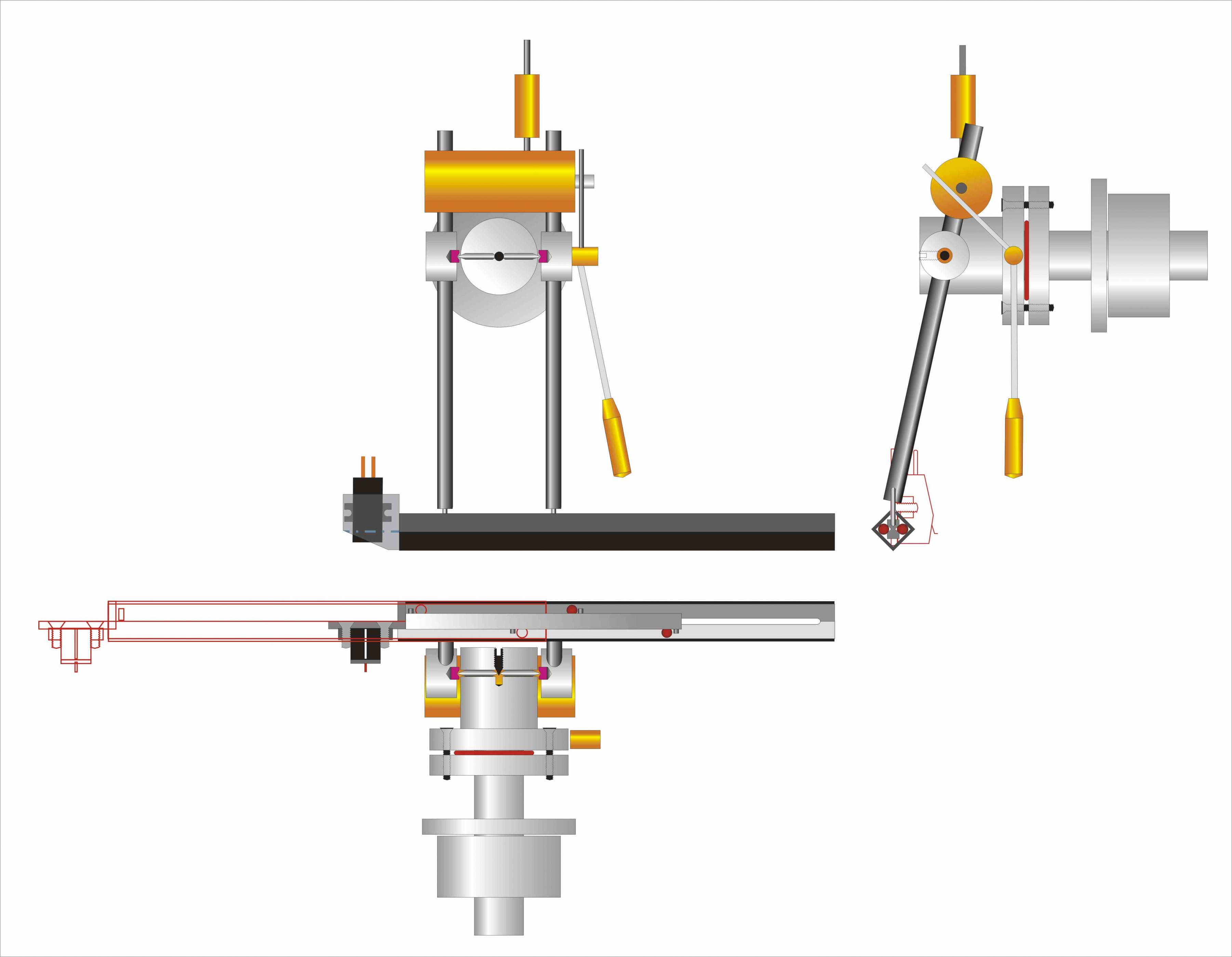

...that are made just for that, Dd. Some new food for thoughts: a slimming diet for vertical mass...
(non recirculating balls - rail can be shorter, since the balls travel just half length; with a radial rail there no need to shorten too much the shaft (no torque from the side force): as for the aligned articulations i like also least possible VTA variations.
carlo
but that long lever still doesn't convince me - may you post the diagonal one? i cant' imagine how it works
This is just a rough drawing. Obviously the vertical bearing angle needs to be offset to match the horizontal blade. And the counterweight also needs to be arranged accordingly. None of that is shown in the drawing. Obviously the structure will be hovering over the platter and a swiveling base is needed for changing records. Now the carriage can be as short as possible.

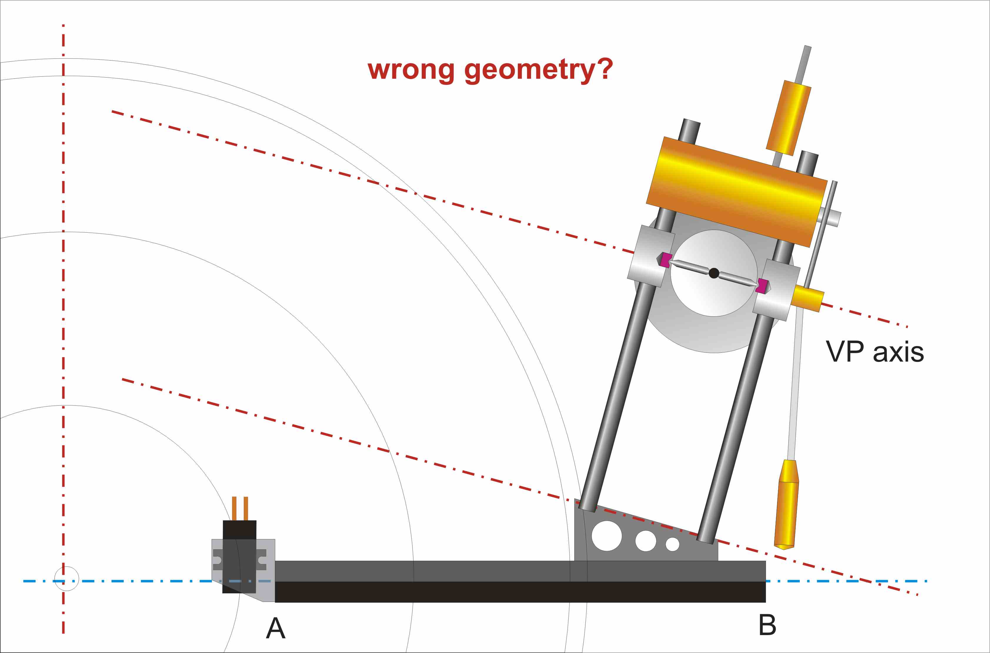

Rough but correct, imho.
Rotating the vertical pivot axis instead, it will no longer be parallel to disc radius. On warps the point A will go higher than B. (attachment)
Simple mock up: take a rectangular cardboard and paste on it a stick, rotated. Now push up the stick and see what happens.

Carlo, sorry for the confusion in my wording. As I said the vertical pivot angle has to match the radius so, yes, they have to be parallel. What I meant was the counterweight and all the attachments have to be angled. Bottom line is that the two pivots have to have equal mass distribution. It's not that much different than conventional tonearm with offset angle headshell and offset angle bearing so the counterweight has to be angled accordingly. Again, the vertical bearings placement has to be in parallel with the radius.

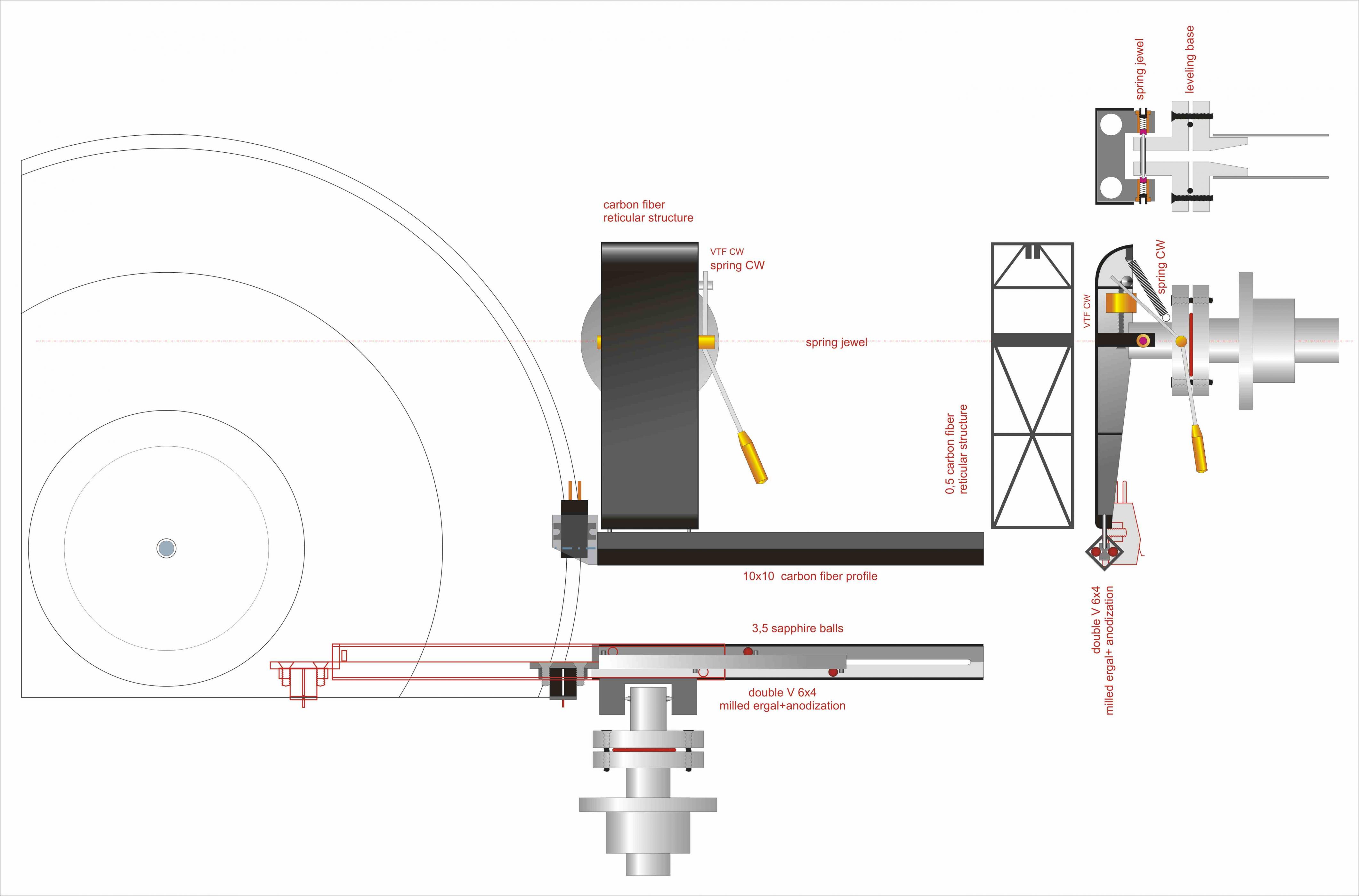

Thanks again for the new drawing, Carlo!
It looks very close to what I have in mind. I would have preferred the placement of the counterweight lower so it's closer to the center of gravity (red dotted line). Either that or a dropped down counterweight to make it closer to neutral balance.
CW - you're right; better an offset placement, without breaking the shafts, imho. Or instead, to reduce the vertical eff. mass, to use a spring CW, as once suggested by Walter for first Lil Casey.
The trickiest part to build is the carbon rail, to be milled or sawed carefully for the steel rods inserts. All the rest is diy machining (quite) as usual

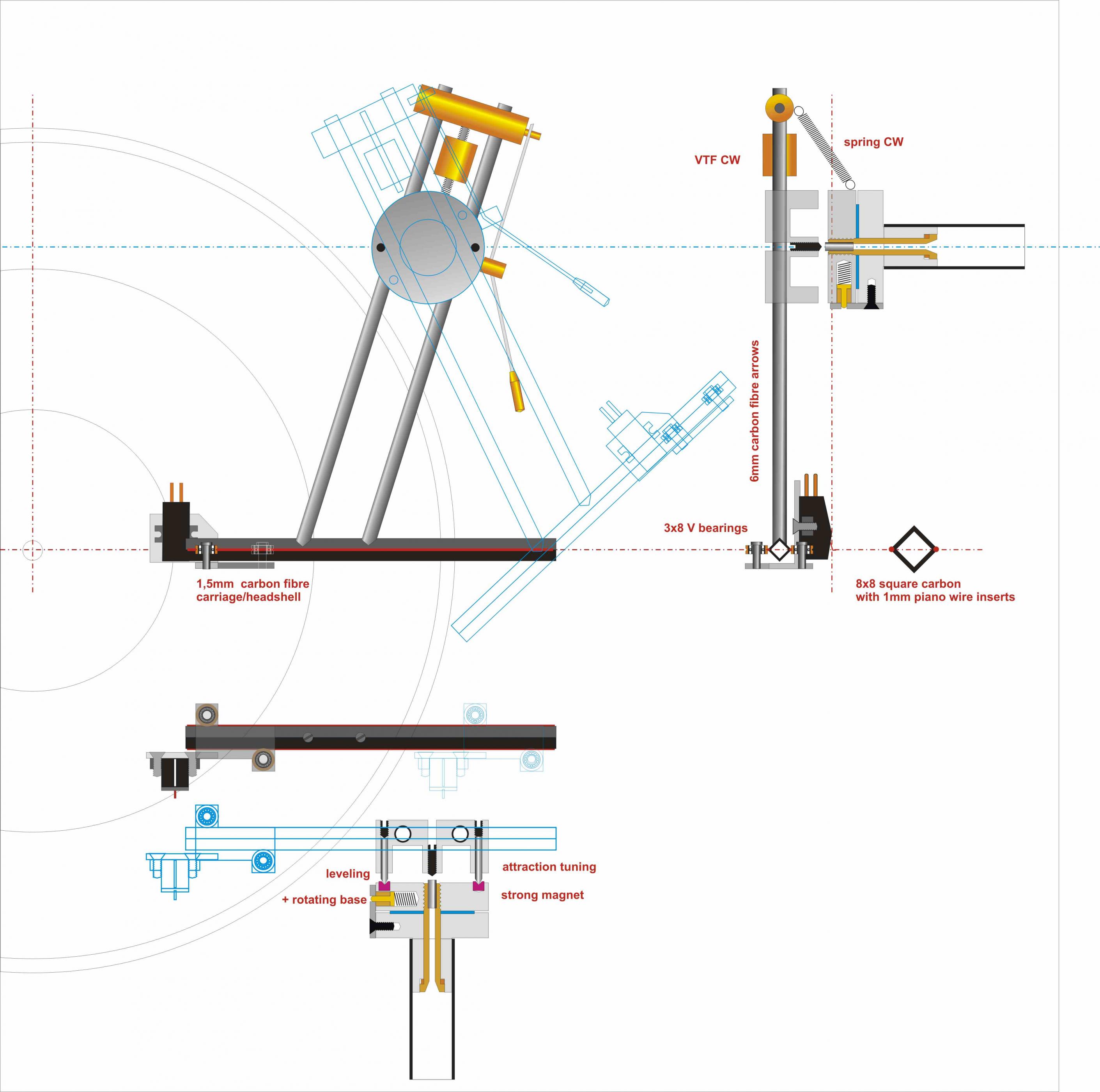

one more -slow- step
Designing is almost funnier than building, and much more comfortable, at this age: so thank you for bringing the ideas to the party.
I fear that carbon does not have the necessary consistency for a long-lasting V blade. But for this, as for the carriage shape and bearings (difficult to imagine the best way to share the weight on the wheels) better to ask our friend Niffy, and his great experience
The carbon fiber horizontal bar can be lined with 1mm tungsten carbide rods or ruby rods for the top and bottom. So the V-groove bearings will be touching hard surfaces and not on the carbon fiber parts.
The carriage you drew does not work because mass is on the right side of the top bearing and it will pivot to the left along with the right bearing. The idea of my arrangement is to use the least number of bearings, which is two, so three bearings are not necessary. In general, I try to use the least number of parts if possible. (It's like intellectual Jenga!) And that the top and right bearings are loaded provided the sum mass of headshell and cartridge is on the left side of the hanging bearing and heavier than the right side.
