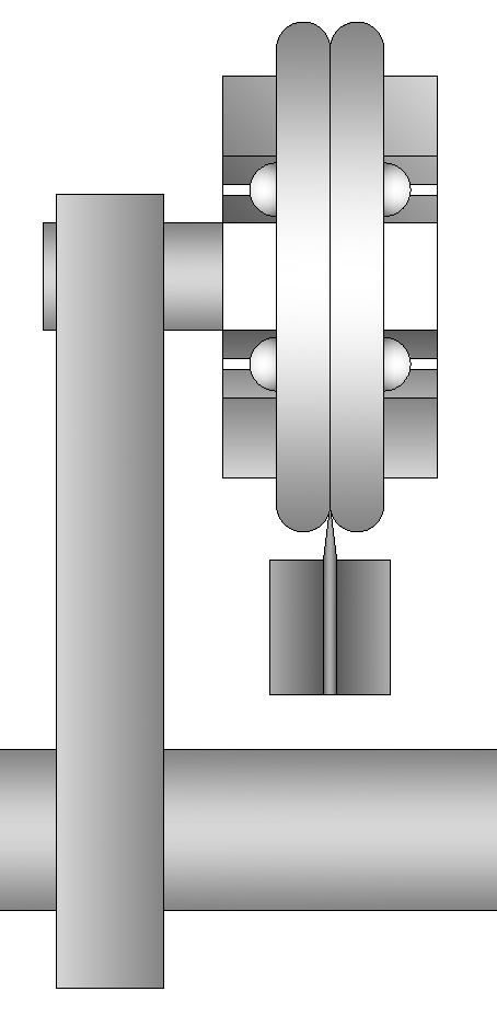

Next drawing. Dual abec-9 bearings pressed to a 9x15x8mmtube and two tungsten rings to form this contraption.
http://www.dahlbergaudiodesign.se/images/linear_5.png

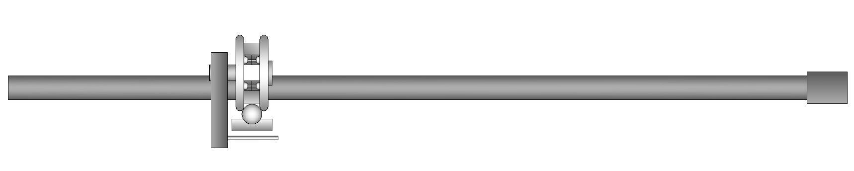

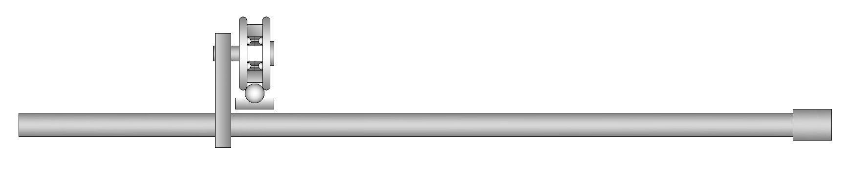

Yes very interesting. Have you thought about swapping the arm wand so it's above the rail. This way you can lower the rail and get the COM close to the pivot, this will reduce VTF variation as the arm tracks warps.
The only snag is making some mechanism to move the rail away from the platter for record changes.
Another idea, think slightly dulled down long carpet knife. The armwand is fairly
long so movement due to woobly records schould be quite small. It would make
record changes easier as well. Not sure about arm material but what I have at
hand now is the 200mm titanium rod (13.5gr). I'm thinking that a crossbow
arrow could make a decent arm as well if weight seems to be a problem.

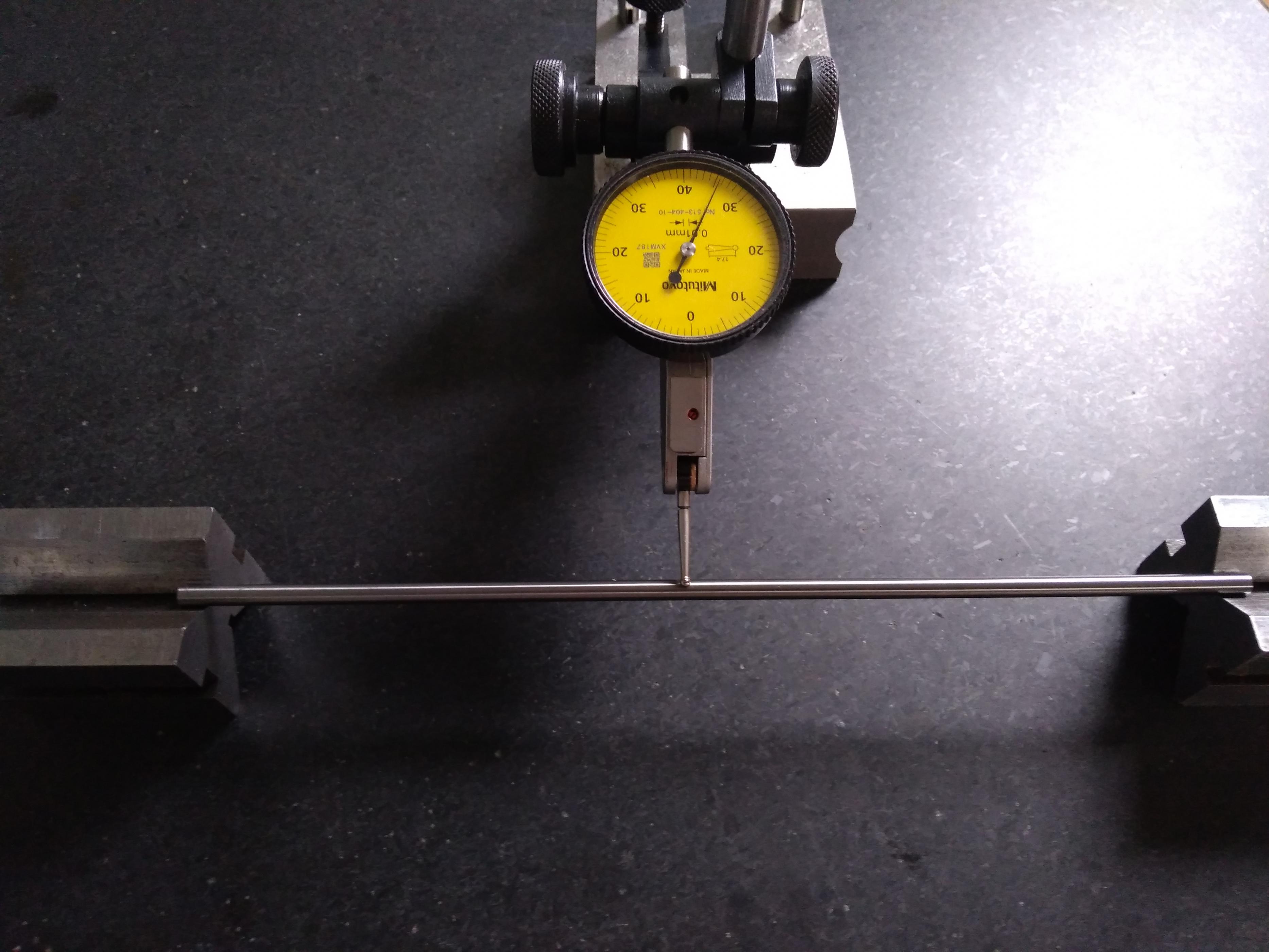

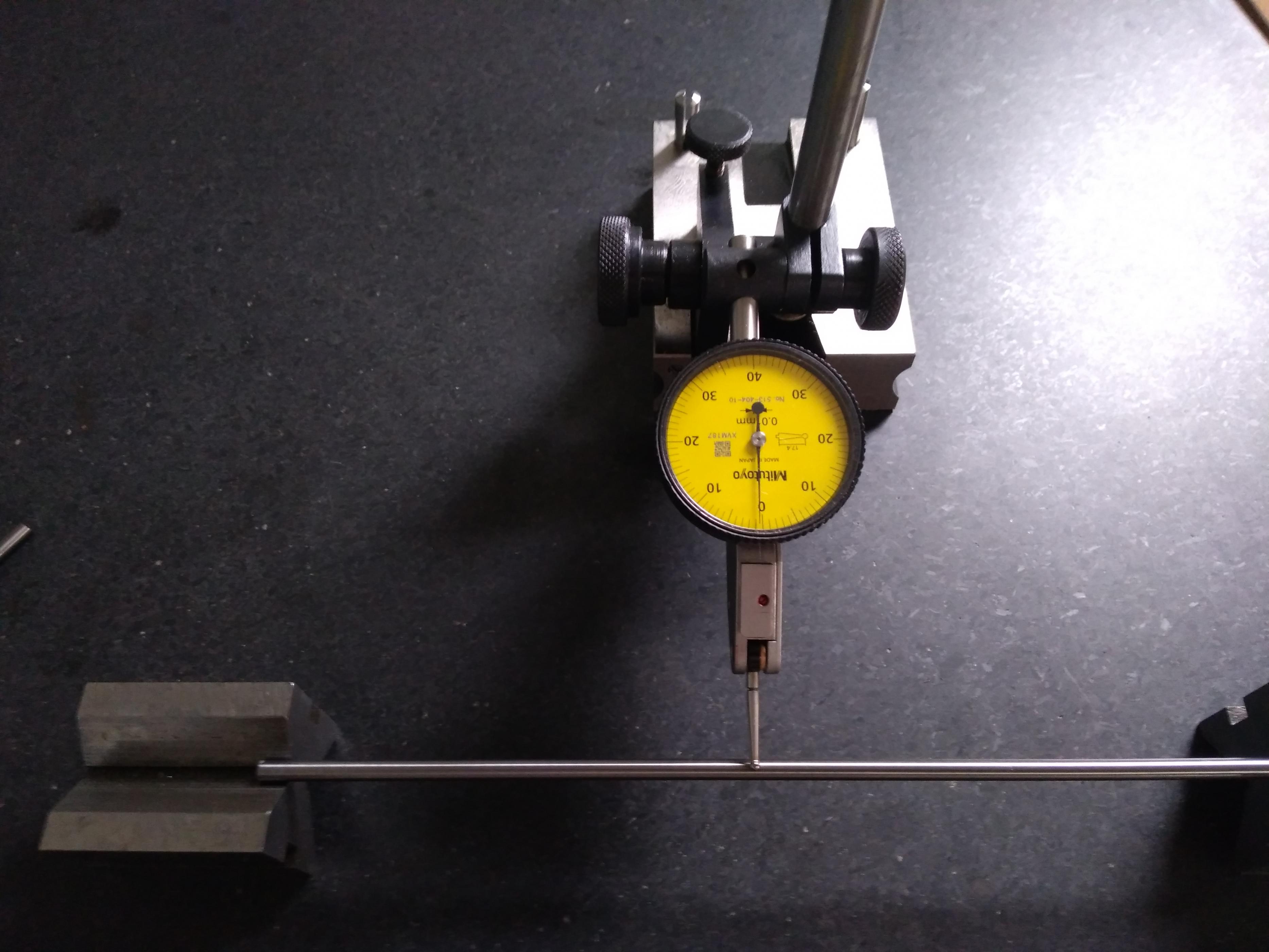

My carriage is 30g including cartridge. The main issue with the arm is the borosilliate tubes not being uniform, there is 1 spot on the rail where there is a change in diameter that before I made the larger wheels always made the arm jump and mistrack. The carbide rods arrived yesterday and out of 4 I ordered 2 are very bent and 2 will be acceptable 0.10mm deflection in the middle. The pics are of the worst one, it's so bad it will not roll easily on the granite surface plate, it rocks back and forth.
I bought a couple of sheets of carbon fibre 3.0 & 0.75mm to make a better carriage, The carbide rings I ordered I only received 1 so I have some 19mm 316SS tube I'll make my own wheels with this and 3.0mm carbon fibre for the hub. I started machining the new arm yesterday when I have it almost finished I'll post some pics.

Hi Niffy,
The difference is not subtle. The bass dynamics are where the difference is most noticeable. If the current LTA is this good with all of the deficiencies it has I can't wait to hear the new arm where I'll have most of these problems solved.
Hi Warrjon,
If the carriage mass is only 30g then the stylus deflection due to inertia on your torture record would be only about 8um. This would give an LTA error of 0.08° which is going to be completely inaudible. Of course the inertia effects with records with only average eccentricity will be much lower than this again. So don't worry about the inertia of the arm causing any problems.
Sorry to hear about your carbide supply problems. The rods I got from Joe were perfectly straight. They weren't polished to a high finish but an afternoon buffing sorted that. The rings were surprisingly round, varying by only about 10um.
Improving the quality of the bearings made a lot of difference to the sound of my arm. You're in for a real sonic treat.
