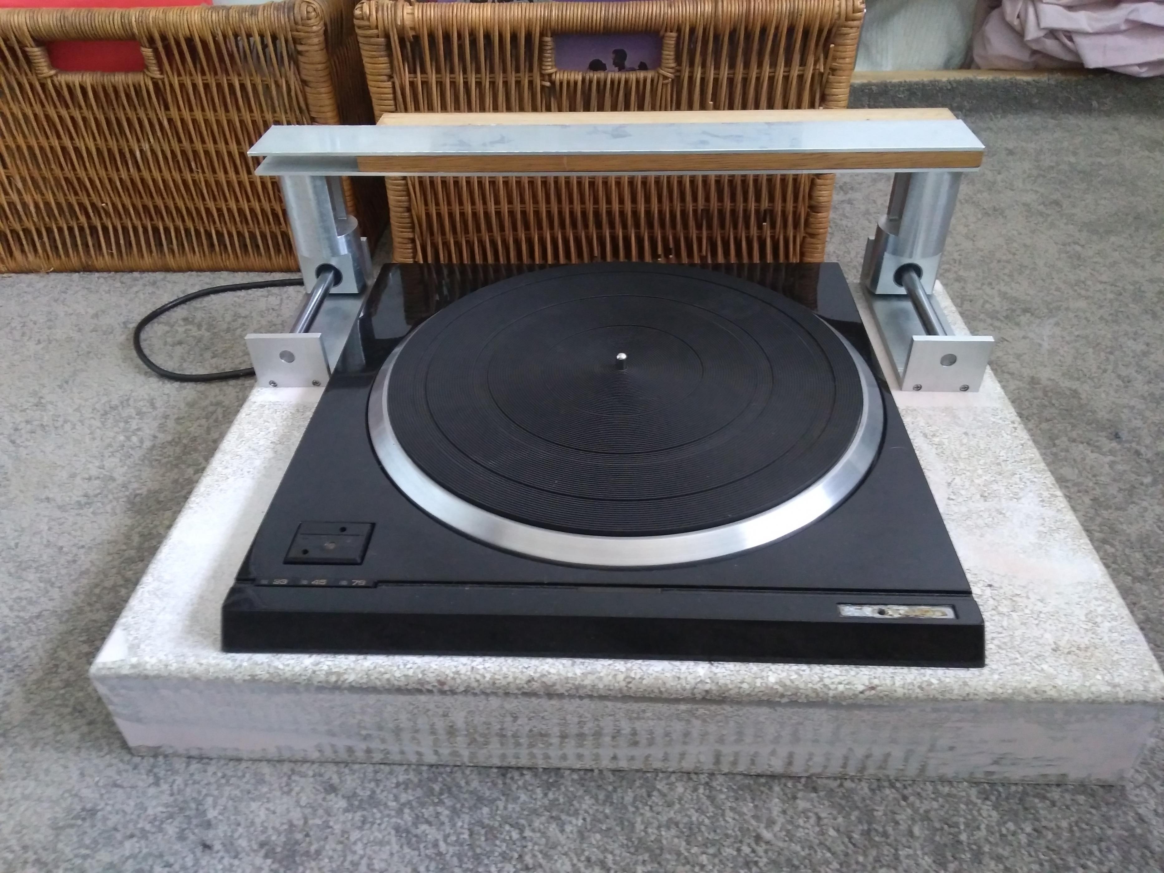

Made more progress on my new arm than I expected. A clear and unashamed Clearaudio TT1 clone. I figured CA did a lot of R&D on this arm judging by the price, so keep as close as possible to what they did.
