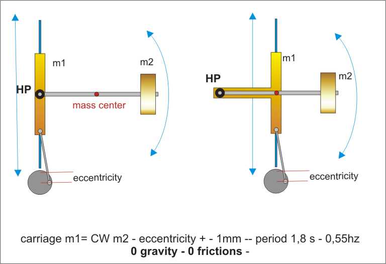

What we desire is that the motion of the weight is exactly out of phase (-180°) with the motion of the groove so that the motion of the cartridge is in phase (0°). As the driving force from the groove is at the same frequency as the natural frequency of the counterweight/pendulum the motion of this weight will actually be at 90° to the motion of the groove meaning that the cartridge will be moving at -90° relative to the groove. To make matters worse the system will be driven at its resonant frequency. Each revolution of the platter will cause the weight to oscillate further and further. A resonant system driven at its resonant frequency.
Niffy
Right Niffy, but is this new one still a pendulum? it can only move on the horizontal plane, so here the gravity has no role, just the masses are acting. Seems a completely indifferent system, driven only by the position of the stylus.
Imagine that both the carriage and the CW pivot are frictionless: when the carriage accelerates-decelerates following the eccentricity, how does the CW behave? Does it remain still by inertia? Rotates in the opposite direction due the energy conservation? And what happens at the mass center?
Would it behave like the pendulum of the video, as if the stylus had the role of the gravity in a real pendulum?
Maybe what happens (period, amplitude) is relative only to the balancing of the system (mass of the cart + mass of the CW + position of the horizontal pivot + position of the rail)
Unfortunately not even one of my few neurons still remembers of Mr Lagrange, and I have absolutely no tools to analyze it. And a practical test needs a highly sophisticated build for sure
carlo
Please, would anyone know how (better, would like) to simulate an inertial system like this in algadoo or similar? if I remember correctly the simulation also analyzes the momentum of the forces in selected points. (Linkage, which I know, works only on geometry)
It would be interesting (for me, at least) to understand what happens also by varying the ratio between the two masses, and /or the position of the horizontal pivot.
thanks in advance - carlo

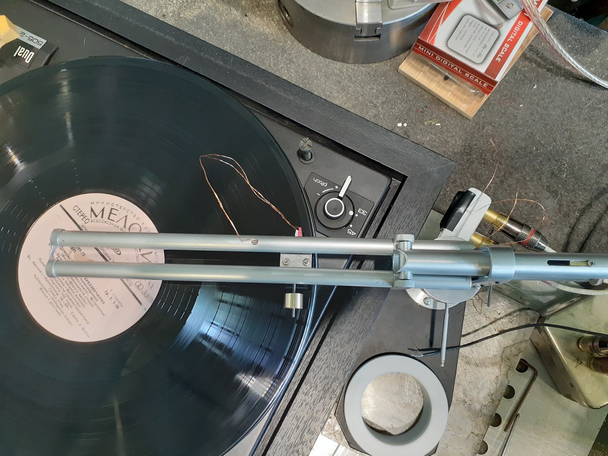

Hi, Carlo. Your last idea is interesting and IMO worth experimenting.
As to Lil Casey, here is a new, non tilting variant, using just double round tubes. Works very well, sliding seems not to be affected by doubling number of balls. More user friendly and easier to adjust, than single tube version.

Walter&Co, congratulations for the new realization, now you are a step forward from me. A non tilting carriage should greatly simplify the initial setup, and also improve the VTA stability. On mine there's no visible movement, but if the cartridge stays firmly in place, it's exactly what it has to do.
Did you use two T carriages in the two tubes? how is going with weights? frictions shouldn't get much worse, eventually put just the balls on the outer side of each cart. More balls than strictly needed may bring chattering. But i don't understand why the little CW is still there.
I'm still looking for a 10x10 or more square carbon profile to try the solution with the bi-cones, while keeping the current weights - maybe I found something in Germany - i'll see-

Hi Walter,
Great to see some further development. Are you using 4 balls in the new version? I would have thought that 3 balls, say 2 on the front track and only 1 on the rear, would be the best configuration forming an isosceles triangle. Why does the carriage still need the little counterweight that's positioned in front of the cartridge? If the centre of mass is between the two rails the carriage should be stable without this additional weight. As keeping the overall mass low seems to be a very important factor for this arm loosing the extra weight should be beneficial. I think the two rail version should have a definite advantage as long as its mass doesn't increase to much over the single rail version.
I look forward to hearing your listening impressions compared to the single rail version.

Hi, Carlo, Niffy. Yes, I thought about the points you mention. It is just another experimental version of Eduard, and not final. Both carriages are T-shape, each with 4 balls. I consider 8 balls are an overkill, and 4 or even 3 of them should be enough. However, current version runs just fine, with no sonic or tracking disadvantages. Mistracking on badly warped or deformed records due to tilt, disappeared. Small CW is there for the purpose to equally adjust load on both rails with different cartridges.
As for me, I would try my own version with two arrow tubes, those are very thin and rigid as well as lightweight. I also will try my new design of spring based counterbalance, which should maintain aqual VTF on warps. All tonearms with CW are prone to pick up rumble, and Lil Casey isn't exception. 15-20dB difference seems attractive to me, no matter how good turntable is. Reducing twice the vertical mass of arm also will not hurt.

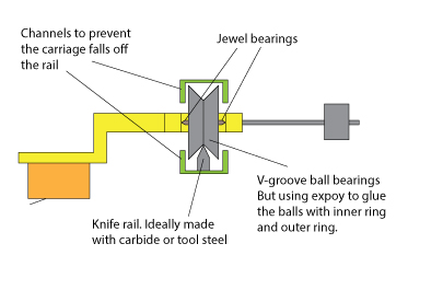

By the way, I think my idea with the knife edge bearing could work.
I tested a small piece of steel sheet with a hobby knife blade as edge and magnetized the steel sheet just a little. This keeps the blade in place and did not affect the friction , as far as I could tell.
Unfortunately I neither have the machinery or the skills to make the bearing with the necessary precision.
It should work. I have been thinking about mechanical linear arm for a while but I just don't feel the urge to make one. Here is my plan. For the total mass of carriage, I would say about 60-70 for a medium compliance cartridge. It is just an estimate. To magnetize the blade may not be a good idea since it may increase the friction.
