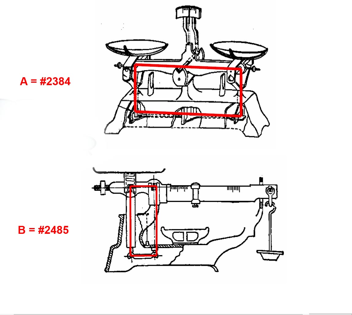

Steelyard were used by romans, maybe long before

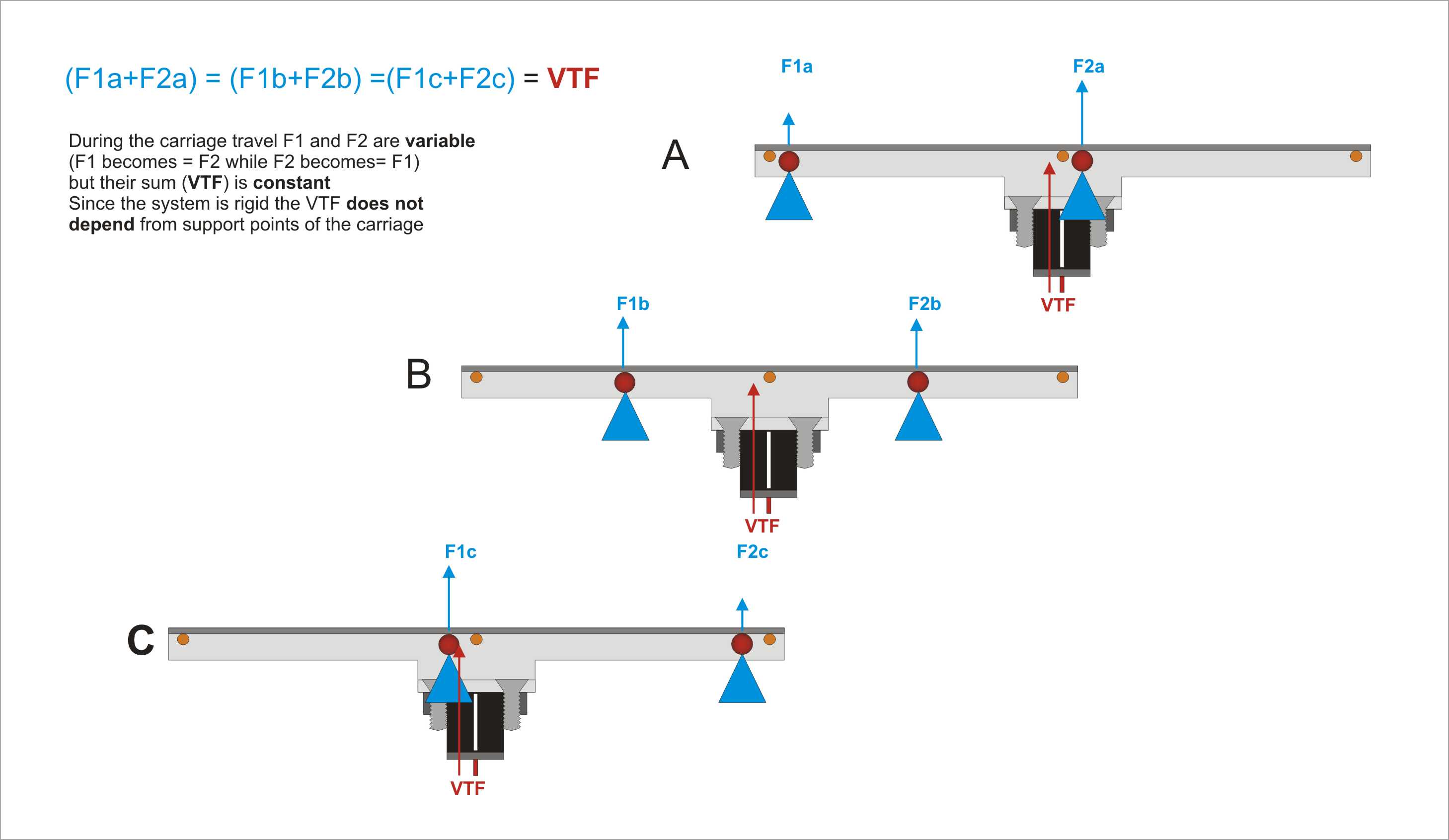

Niffy, the VTF variation when the parallelogram is inclined is that given by the small shift of the CG of the CW, as in pivoted ones. Here levers are much shorter and inclinations bigger, but this kind of VTF variation almost undetectable, imho.
Rail leveling instead is crucial, even more than in traditional linear trackers, for the reasons already explained - #3017 last paragraph

Carlo, your pics are convincing. I'm very glad I didn't promise eating my hat . Maybe while VTF adjusted too high, and left one of the support points starts loosing contact (A) and while carriage travels, both of them renew contact (B) in the middle, and later right one (C) looses it? Seems to be a decent hypothesis...
Anyway, I need to build my own model to experiment with.

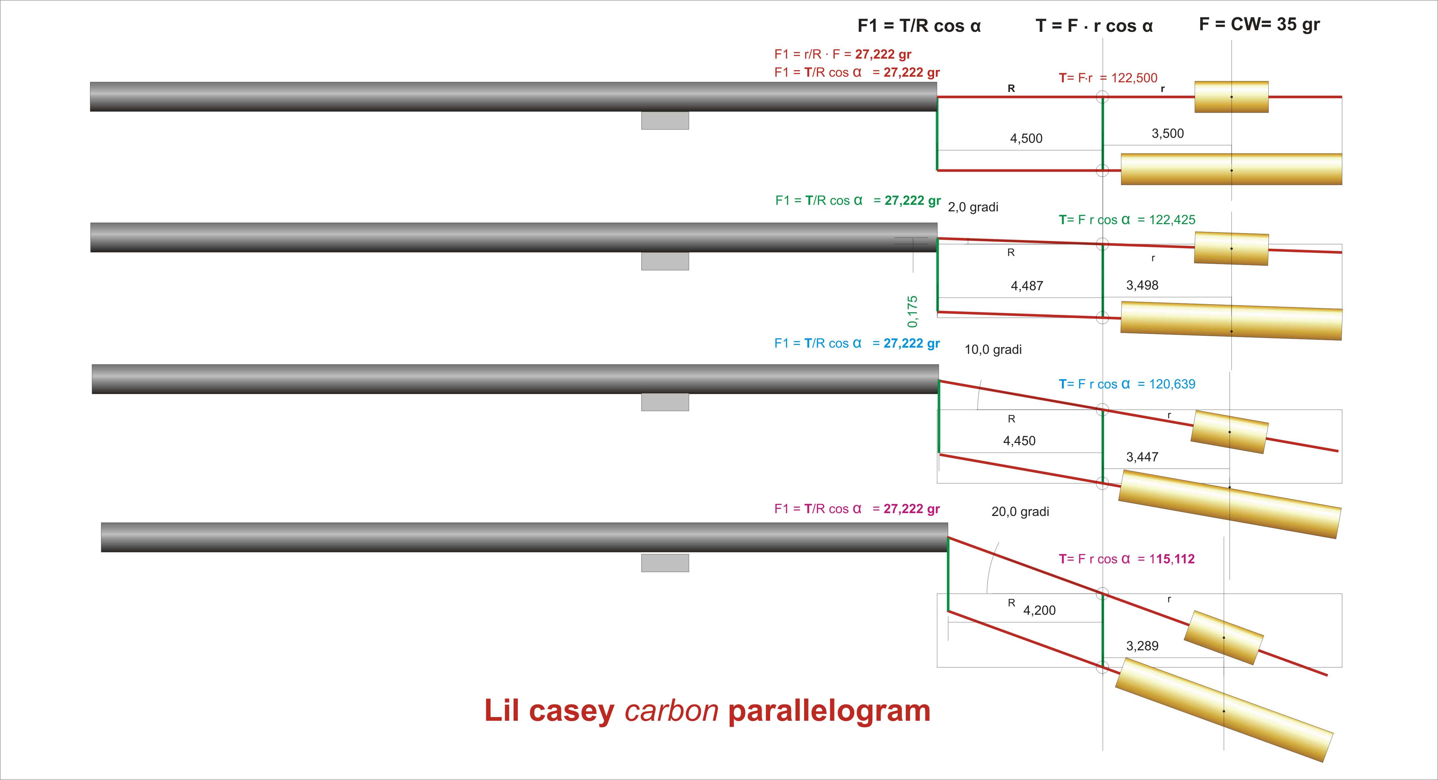

Hi Niffy, Walter, and someone else. Here a quick calculation (in grams, not mN!) of the behavior of the CW on my Lil Casey carbon parallelogram - real measures and weights.
Seems that there is in no VTF variation, even for large angles. Different from what I thought (very small at first, but increasing variations); maybe we can sleep peacefully, at least for this.
But, where i'm wrong?
carlo
carlo

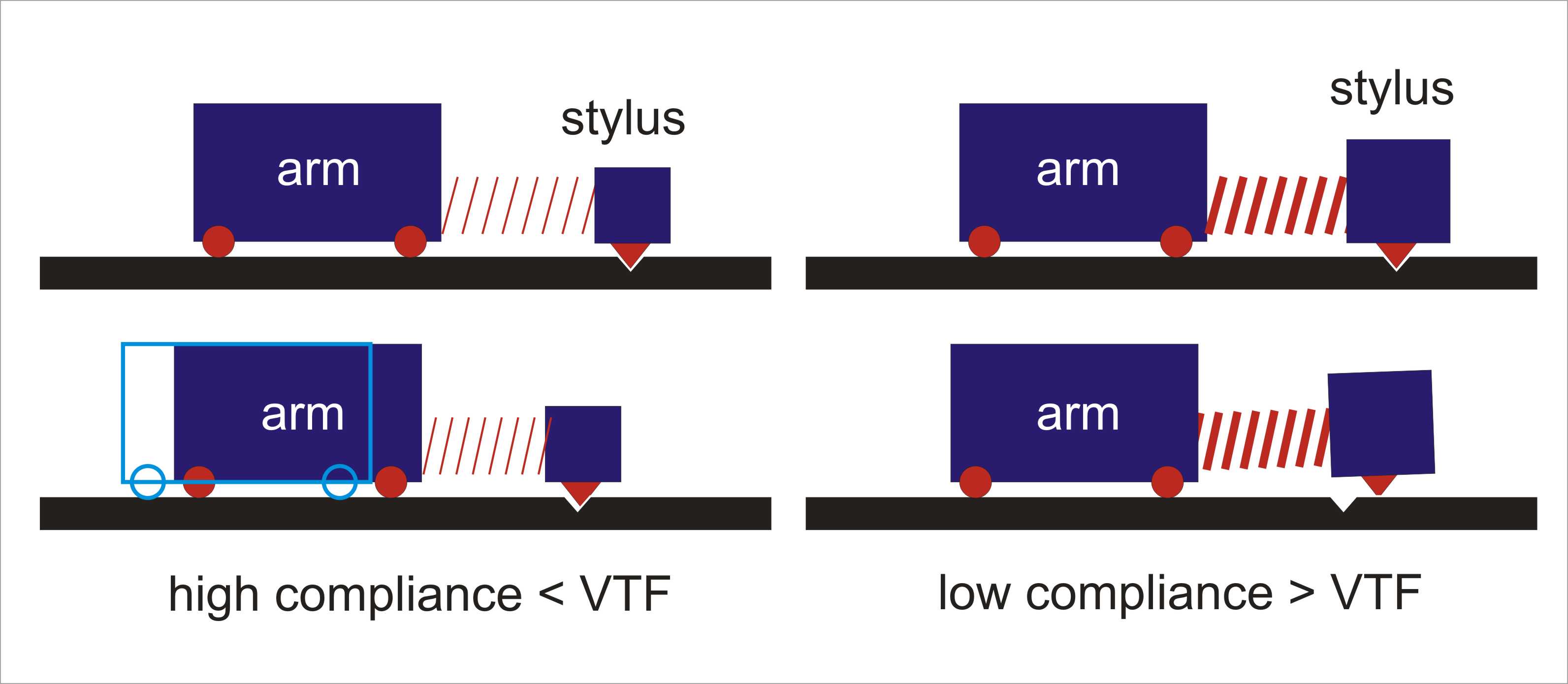

Hi, Carlo, Niffy. Excellent research. For now I would stick to my hypothesis 2022, because skiping occured on low compliance cartridge with 3- 3,5 gramm VTF required. Skiping near the inner groove was a reason for checking VTF on different diameters (because warps are larger on outer grooves, there no skiping occured). With high compliance carts no problems were encountered, even with 1gramm of VTF. Kind of paradoxal situation.
Walter
Walter
Yes, seems counterintuitive: greater VTF = greater trend to remain into the groove.
Me too had noticed that increasing the VTF over the recommended weight increased the skipping (it happened on the LC mk1, on steep warps). This was my reasoning: in presence of small defects the stylus tends to manage them with its compliance, before the arm with its inertia can follow him. Let's not forget that just a few microns are enough to get out of a groove. So a low compliance, that reacts more rigidly, tends to skip easier, if the arm doesn't follow immediately.
LC carbon has the effective masses reduced to 17 and 20, in any case not very low, and frictions are certainly not like those of a unipivot. Sufficient, but improvable.

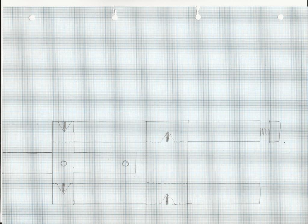

pentips: look carefully to Lil Casey carbon drawings and 3d visuals - on a post i've talked about the "tricks" of their implementation.

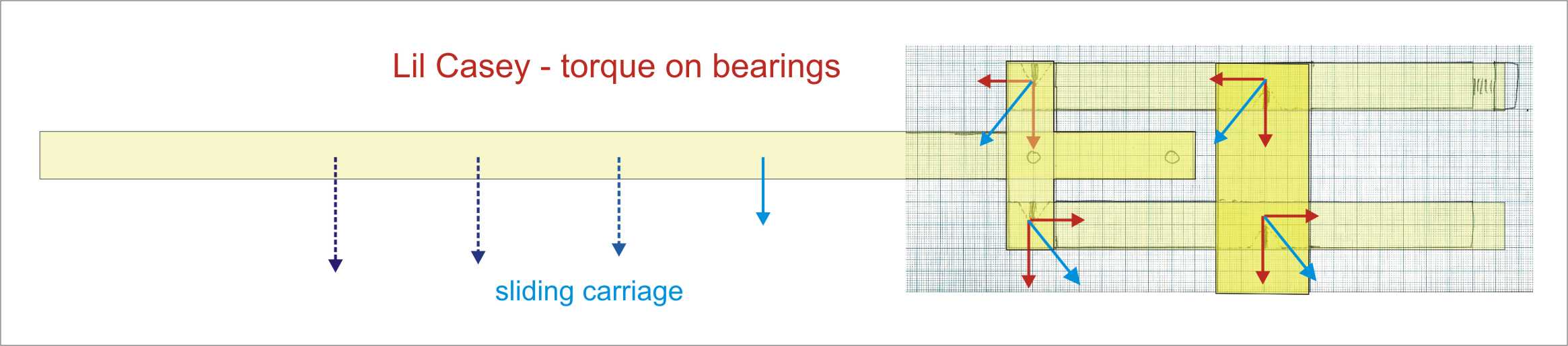

An advice: Lil Casey is mechanically simple, but needs tight tolerances for the parallelogram and the carriage + rail system. Build it as an experiment to be further investigated, as a challenge, more than your next everyday TA.

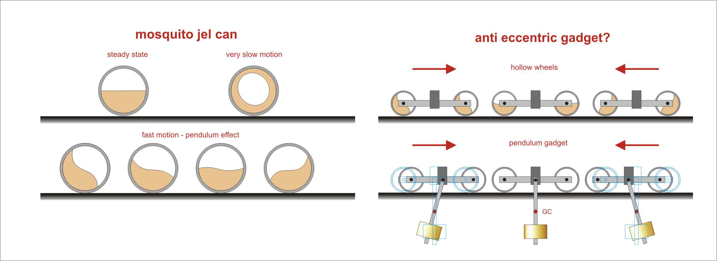

an eccentric idea*
background - yesterday putting a spray can of mosquito repellent on a table I saw it swinging several times before stopping: it surprised me, but that's the reason, probably. No magic, simply jel (attachment)
back to us - one of the bigger problems of linear TA comes from the eccentricities, that impose accelerations on the carriage often incompatible with its inertia / friction. The eccentricities are present on almost all of our beloved discs, and very difficult to overcome with practical systems.
However, unlike warps, they have two advantages: 1 - the amplitude is constant at any point on the disc - 2- the frequency is constant (one + - eccentricity every 1'/ 33.33). Every turn of the disc our carriage should move back and forth the same measure of the eccentricity, accelerating and slowing down with respect to the speed of movement due to the tracking.
This suggests that if we had a system that could "copy" this oscillating movement (small or large) and passively communicate it to the carriage, we could get an always constant side force.
This brings us back to my jel can: if the wheels of a Niffy's style carriage were hollow, and with a suitable viscosity jel inside .... without eccentricity the jel would spread evenly inside the wheel (with only a slight increase in friction) but at the first acceleration it would accumulate on one side and then synchronize with all subsequent movements. Easy to say, but not to do, you may easily imagine why.
Let's try another way. We have the usual Niffy's carriage, but connected to a weight W via a rigid rod. This creates a complex pendulum (to be set with a period = 1'/ 33.33) that oscillates on the CG. At the first eccentricity the carriage communicates the corresponding momentum to the pendulum. The pendulum inertia and sincronicity feeds back the movement to the carriage every turn...
