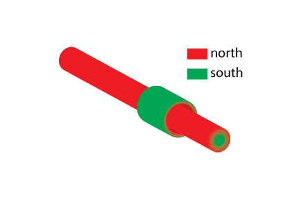

Question:
Did anybody try to make a linear tracker with magnetic levitation?
Best, M
Sorry Marik,
It's not possible passively using permanent magnets. Check out Earnshaw's theorem for the reason why. If you are thinking of something like those globe toys that suspend a sphere in mid air there are many Many problems to overcome. The globe toy works by rapidly modulating the magnetic field, basically dropping and catching the globe repeatedly. This will cause the levitated object to vibrate, not a good thing for a tonearm. Also a levitated carriage will not be held stably and would have a lot of freedom of movement in directions you don't want. You may have seen the recently introduced magnetically levitated deck. Check out the horrendous level of wobble the platter has. This is a purely gimmick product. Another problem is the strong magnetic field required. Do you want a very strong modulated magnetic field anywhere near your cartridge. And finally the arm would be completely physically disconnected from the deck leaving no possibility of mechanically grounding the arm. Good mechanical grounding is one of the most important design considerations.

I don't know if it works in reality, but it is just an idea. In reality, it may be just better to use air bearing the same construction as mine with low air pressure and almost noiseless air pump which can be placed in the same room as your listening room. Air force one table has an air pump which can be placed in the same room.
The strong magnetic field may be another problem.
Jim

Hi Niffy,
Yes, I worked with passive maglev for another application and aware that to make the passive system to be stable and not collapse we do need to have one axis support (even with Hallbach array). But we do have it--isn't the 'stylus/grove' system here is exactly the axis we are looking for?
Best, M
Hi Marik,
In order to make the passive system work and not collapse you have to constrain the system. You design the system so that it has a preferred direction in which it wishes to collapse then constrain the axis that aligns with this direction. This will result in a force being applied along/about this axis. The stylus/cantilever is attached via a compliant mounting. If the constraining force is applied laterally or downwards via the stylus will result in an undesirable defection of the cantilever. The magnitude of the constraining force required when levitating even a super lightweight carriage would almost certainly be so high as to cause instantaneous misstracking. Even if it didn't as soon as the stylus was raised from the groove the constraint would disappear and the system would immediately collapse making queuing impossible.
With a linear bearing the natural axis for collapse would be at 90° to the direction the bearing moves in. This would be forwards/backwards, up/down or an angle in between and not left/right. As the stylus is sliding in the groove it can offer no constraint forward/backwards. You cannot balance the constraint using stylus drag as drag constantly changes. Even if drag didn't change you would have to balance the magnetic field to the drag to an impossibly fine degree, even thermal noise would collapse the system. You cannot constrain vertically as the arm has to be able to move vertically to track warps.
The only way that magnetic levitation can be used in a passive way is to build a normal mechanical linear arm running on wheels with bearings and then use magnetic levitation to relieve some of the weight of the carriage. The friction of the bearings is directly related to the load applied. If you reduce the load you reduce the friction. So if you support half the weight with magnets only half the weight will be applied to the bearings and the friction of the bearings will be reduced to about half. The contact of the wheels on the rail will act as the constraint making the system stable.
I did quite a lot of work on this idea at one time. You do still have the same problems that you would with a normal mechanical linear arm such as bearing chatter if using ballrace bearings. It only works using magnetic repulsion. (I tried using attraction but this massively overdamped the system and resulted in worse overall friction than without it.) As the magnetic field is only working vertically, it doesn't have to deal with stylus drag, the gap between the magnets can be very small so only very small magnets are required. I had a row of neodymium magnets that were about 1mm wide and 1mm deep and about 5mm long. These have to run the full length of the rail. The carriage had two small 2mm diameter 1mm thick magnets attached in adjustable mounts. It definitely reduced friction. I abandoned this line of experimentation in favour of the pin bearings I now use as these gave a better reduction in friction, greater consistency, eliminated chatter and offered much better mechanical grounding. It is probably possible to combine the magnetic and pin bearings but with the design of my current rail the gap between the magnets would be too great. One probable downside of reducing the load using magnets and pin bearings is that the efficiency of the mechanical ground may be compromised. I feel that improving mechanical grounding made much more difference than reducing friction.
Niffy
Niffy
